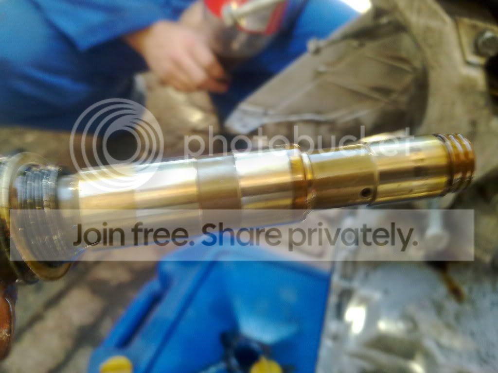

So yesterday we started stripping the ancillaries on the motor.
Due to the fact that as we strip we clean pack and mark it is at best a laborious and extremely non enjoyable undertaking.
Just wanted to mention that if you notice a leak under the Vanos solenoid do not bother tightening the bolts rather change the round gasket around the solenoid. They do leak from there over time.
Earlier I had mentioned that the left engine mounting was broken....not bad after 220ks
"Sweaty" front main oil seal. If this was any other car I would have said "failed main oil seal"
Right hand side chain tension piston.
No galling or scoring of any significance.
It will be changed for new on assembly.
Right hand cylinder head Vanos unit with solenoid still installed. Incidentally the motor is remarkably clean with zero sludge to be seen. I guess the 7000km oil change intervals are worth it.
