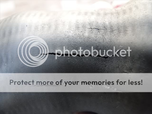

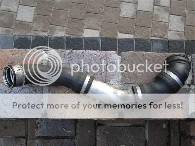

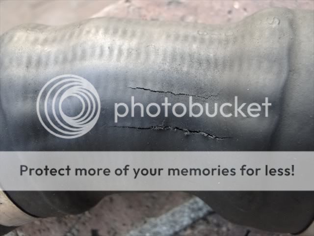

What we found explained the power losses and subsequent first gear hickups:
The chargepipe had various cracks of different sizes on all sides. The second rubber sleeve near the throttle body were literally hard baked. The car were obviously losing power for many, many months but I just did not notice:

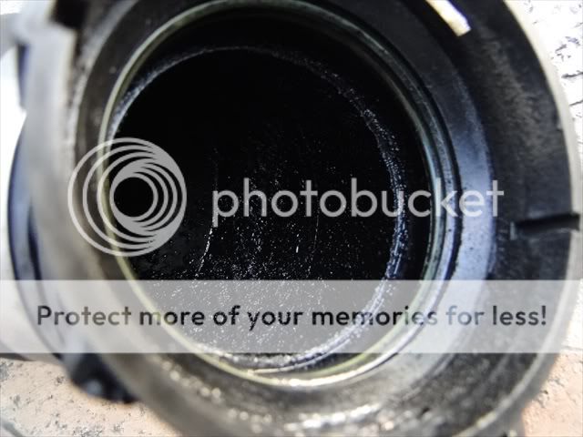

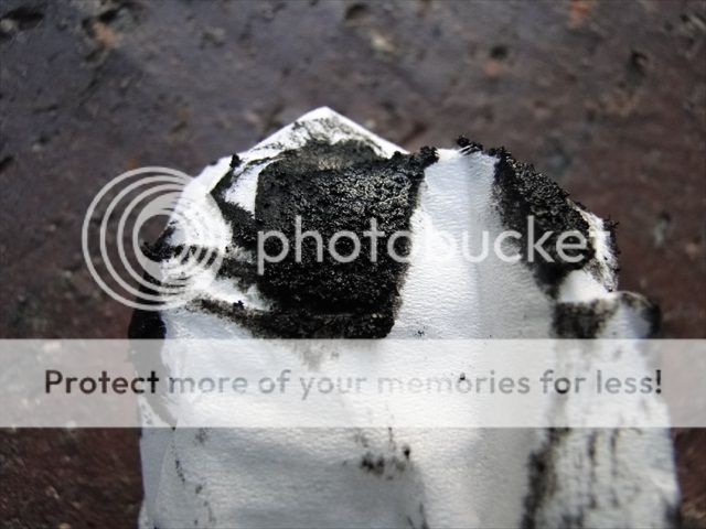

I was also concerned about all this muck in the flow pipe, affecting the performance of the trubo:
The pipe cost about R4,500 but it solved the first gear unpredicatable, jumpyness and pulls rather nicely again through the rev range without any noticable loss of power.
