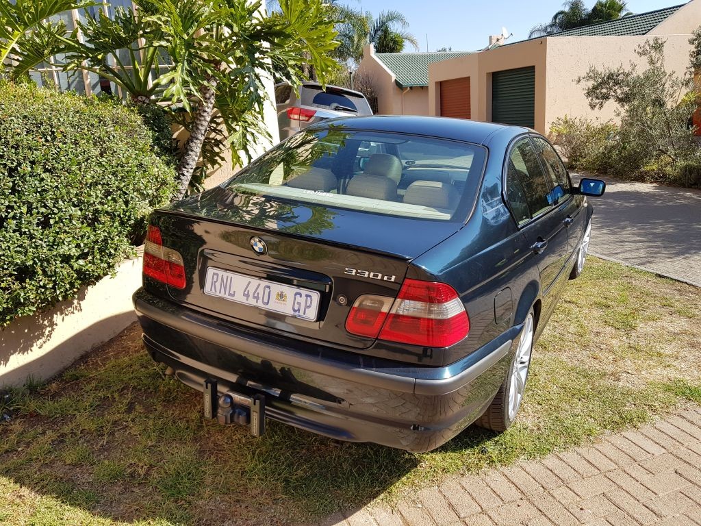

Yeah remove that towbar. It doesn't look good lol. Those inner tail lights might be leaking inside. My one had the same issue. I carefully separated it and washed it out then used clear silicone to close it up. Please be very careful when washing. I used warm water and dish soap. It removed the chrome. So rather use cold water and car soap perhaps.
Sent from my VKY-L09 using Tapatalk
Luigi_S
Yep, the tail lights need cleaning inside. I have something better than silicone that I have used on tail lights before called Bison plastic adhesive, which is strong and dries clear. Will get round to sorting that out once the interior is where I want it and all the mechanical issues are taken care of. The body will be getting a lot of attention in future to get her looking like new.
Nobz330i
Luigi_S said:
They on the bumper strip. The sensors were working perfectly when I had them off the car and testing, hence why I say they must be picking up the towbar.
Don't need the towbar so will be removing it. Will need to buy a new bottom Mtech piece for the bumper though unfortunately, the one I have was cut for the towbar.
Okay cool, yeah get rid of it.
Luigi_S
Thanks Gizmo. Please pm me how much you want for it.
Deleting the towbar is going to be a little expensive too, apart from the piece Gizmo has, I need to get me some rear bumper shock absorbers too. The prices that the scrappies here want, I think I might have to wait to get them from the UK. Me mum is on her way back in a couple of months so will get her to bring them along with a few other odds and sods.
On a positive note, yesterday I removed the frame mounted on the towbar with those upright pieces on and the sensors are all perfect, so really don't need to remove the towbar but want to as it's an eye sore and not needed at all.

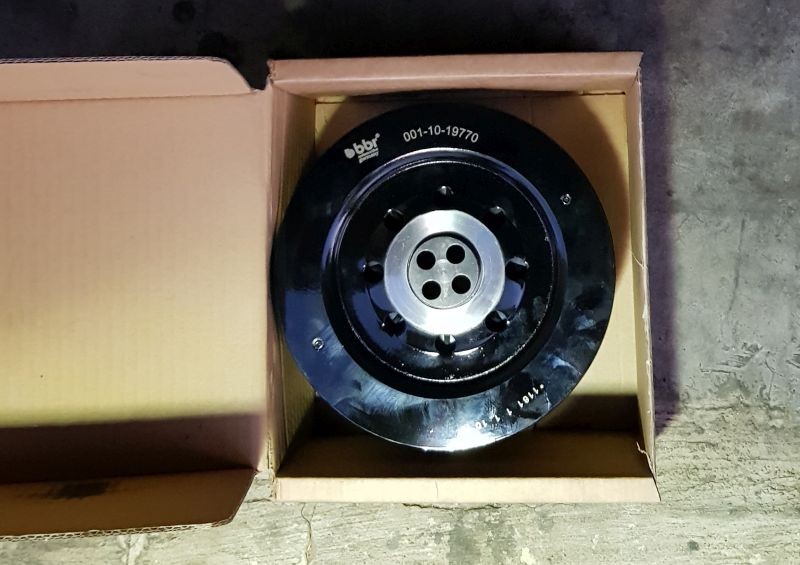

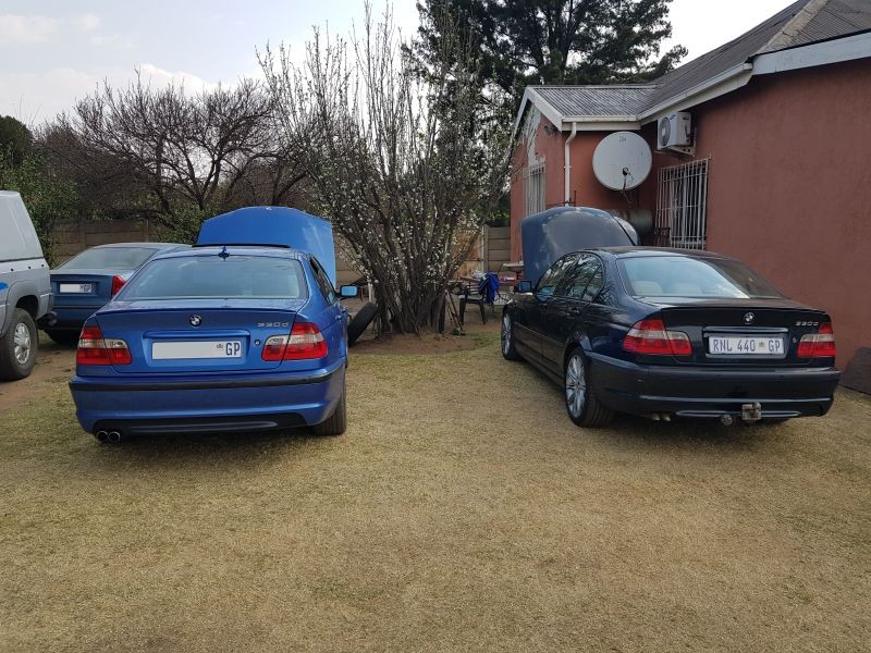

Had the opportunity to pop round Waseem's place and meet him today. What a top bloke. Took his time out to help me identify the idle noise / damper pulley issue.
Waseem what a pleasure meeting you earlier today, your time is very much appreciated. Will be in touch soon once I have researched the issues we spoke about earlier so we can get them sorted for you.
Waseem 333i
Thanks for coming around Luis. It's always good meeting like minded people. I'm still amazed at how good your car sounds. See you soon bud.
Luigi_S
Winning..................
I replaced the damper pulley today with one I bought from Goldwagen Delarey and the rattle noise has gone. The pulley I removed looks perfect, no cracks, nothing, but there must be something out of place.
So chuffed I can now drive around and the car won't sound like it's falling apart at idle. Waseem was bang on the money.
