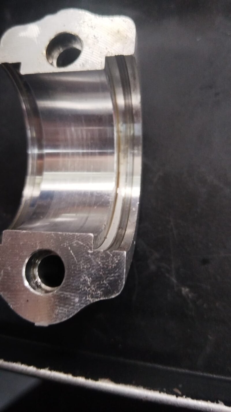

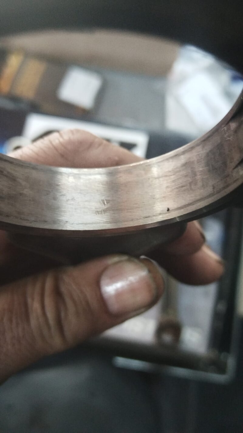

Hi all.

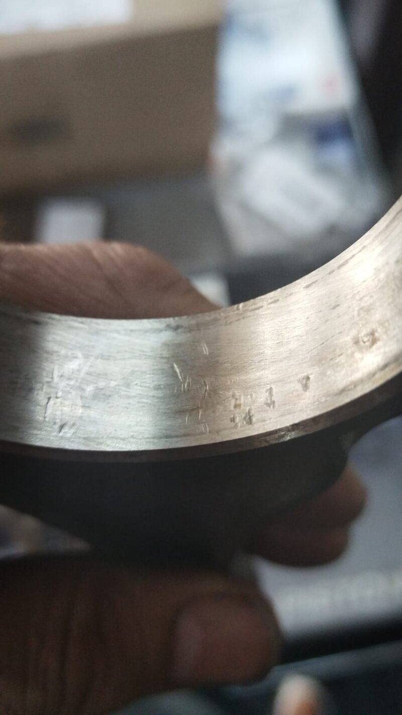

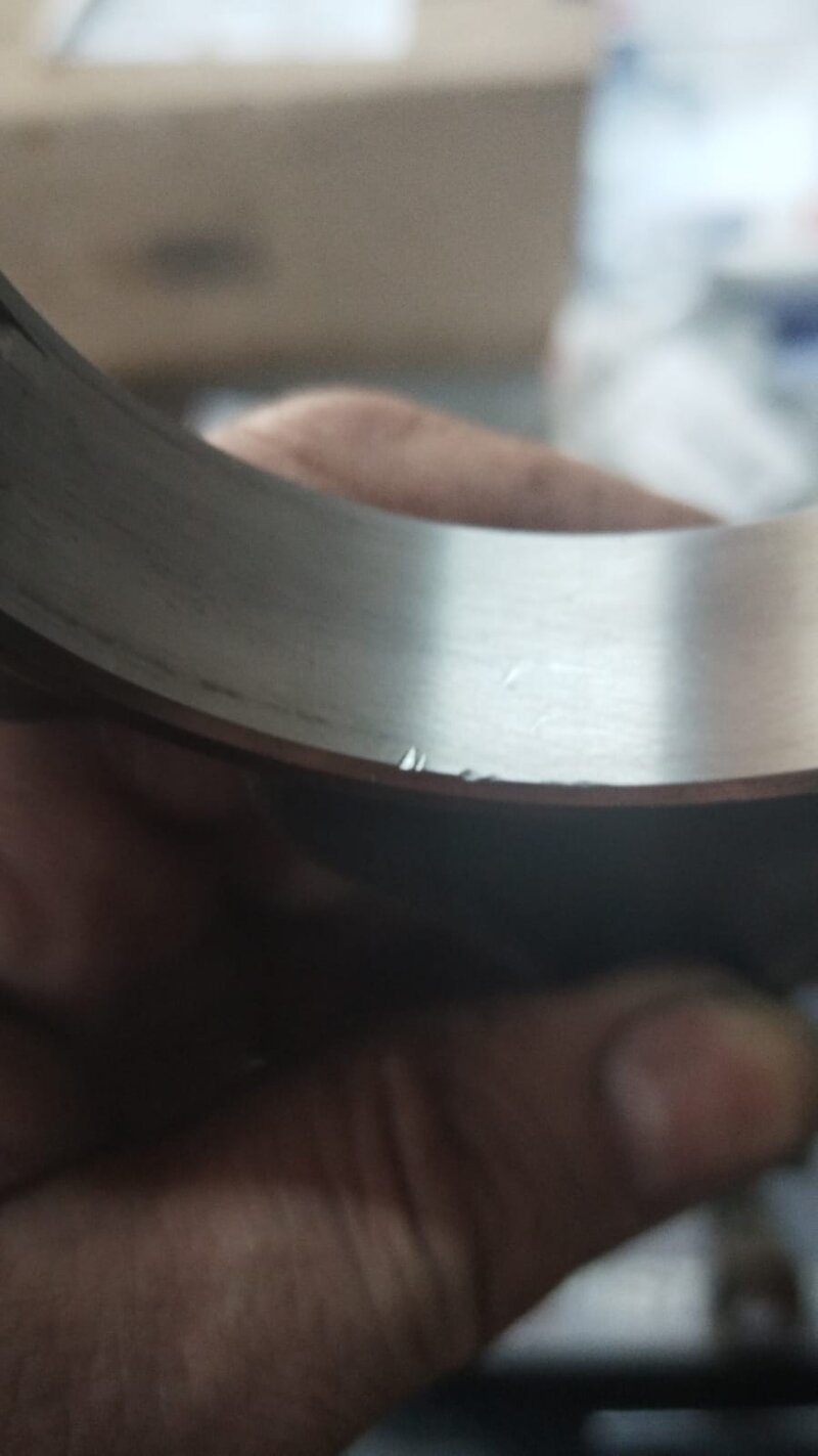

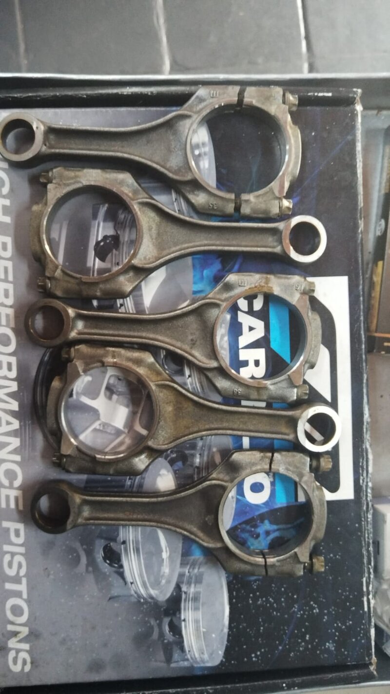

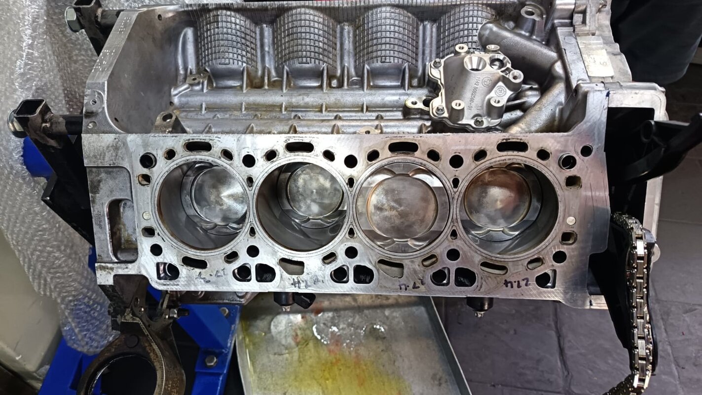

Some more progress from Budler, they seem to be making good progress.

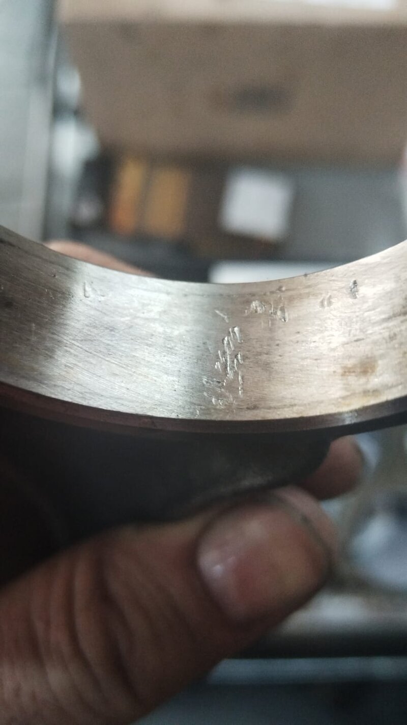

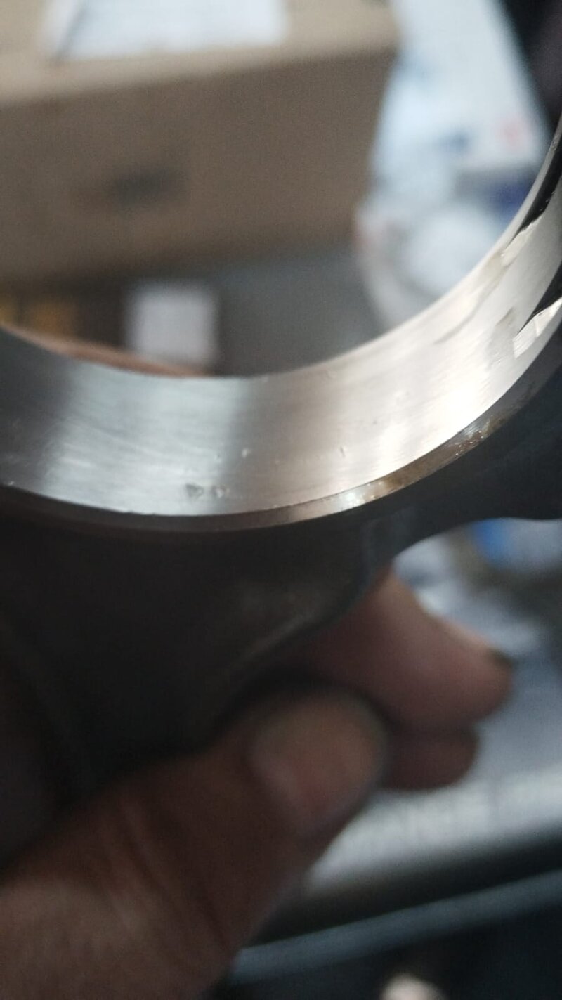

It was discovered that 5 of the 8 rods had surface damage. This would of greatly attributed to the wear on the bearings as this would of causes bearing clearence issues and offset the sizing. how some of these marks happened, is anyones best guess.

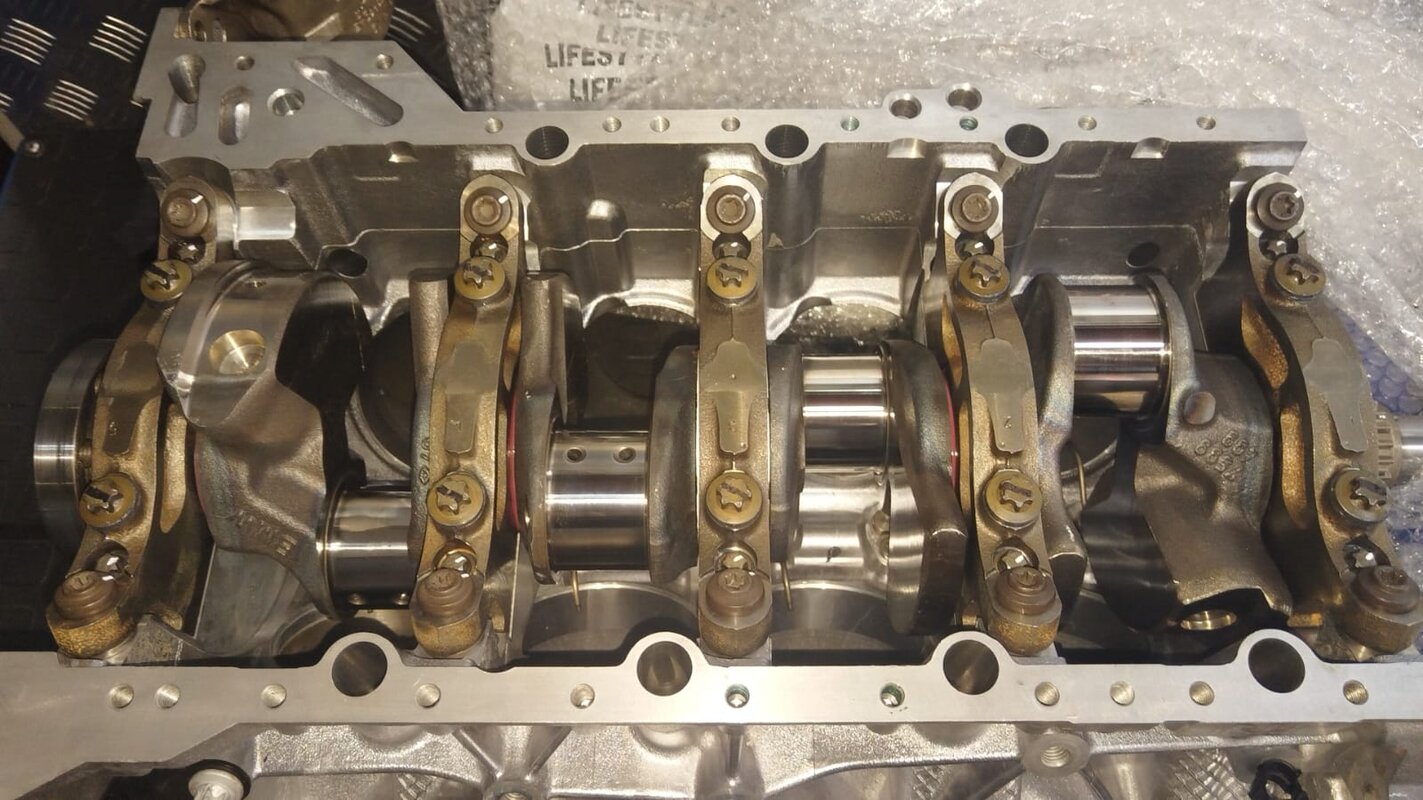

On to better news, Budler sourced replacement Rods already, and has continued the build, Pistons and Rods are in:

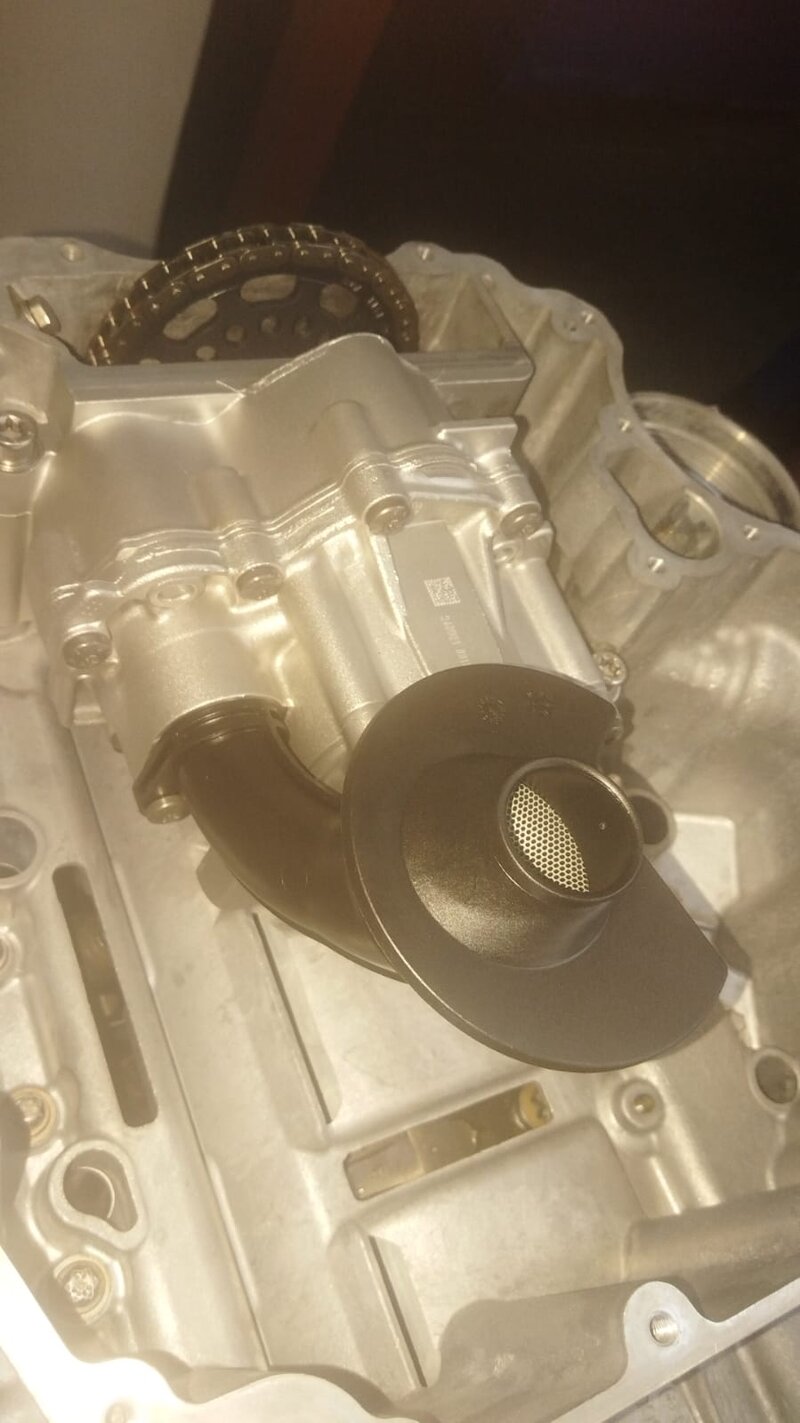

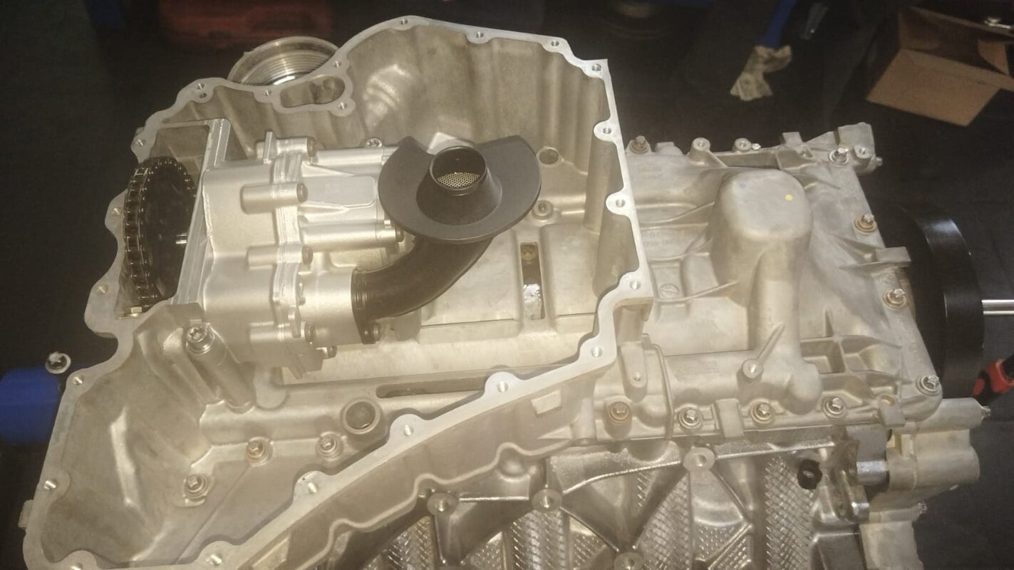

And so is the new Oil Pump, looking clean and fresh with the upper sump already in place.
Appreciate everyone's interest so far in the build, it seems to be taking shape very well, and the more i get updates, and the more i see, its clear, again, that the car is getting built at the best possible place.
Budler and the team could have been sneaky and re-installed the rods as they found them, but that's not how they work, and i value the transparency and honesty from their team.

Would agree with you that he is one, how can you install rods on an engine like this, looking like that. in fact any type of engine for that matter, where is the pride in "your" hand work/bussiness, building engines like this. Big up on the current rebuilt. looking good so far.

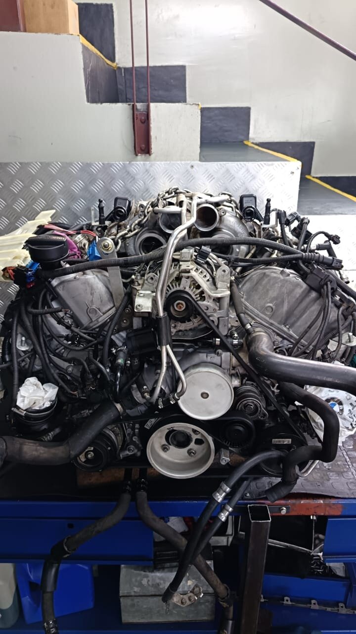

Morning kids.
So, the motor is fully assembled.
They found the following during the remainder of the assembly process, and attended to the issues and replaced:

They really are pushing along at full speed here, also they did tell me that all my injectors were not flush into their seats... welp, well guess thats on me as the cause of that particular situation, guess i wasn't as efficient as i thought i was when doing that job.
They will be busy with the motor installation currently, then will let me know once is all buttoned up for first start, and begin testing. they will ensure the run in is done fully, and the first run in service with oil change and more road time before making sure they are comfortable with the car to be released. they want to put on around 500 - 700km to make sure the car has no issues.
So again, will keep you all updated as i get more information.
