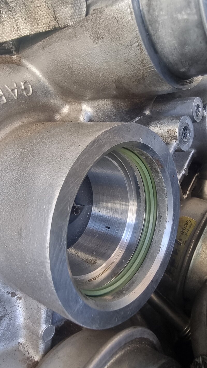

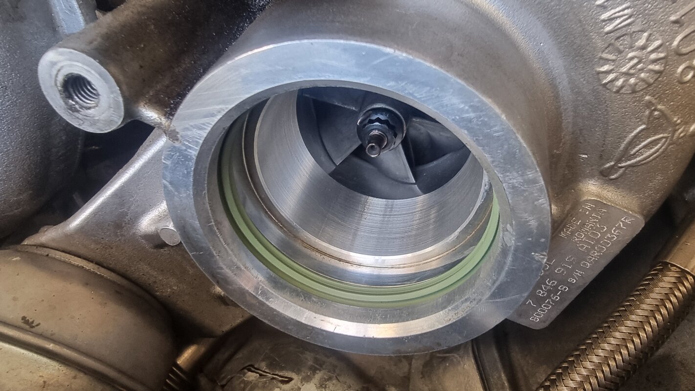

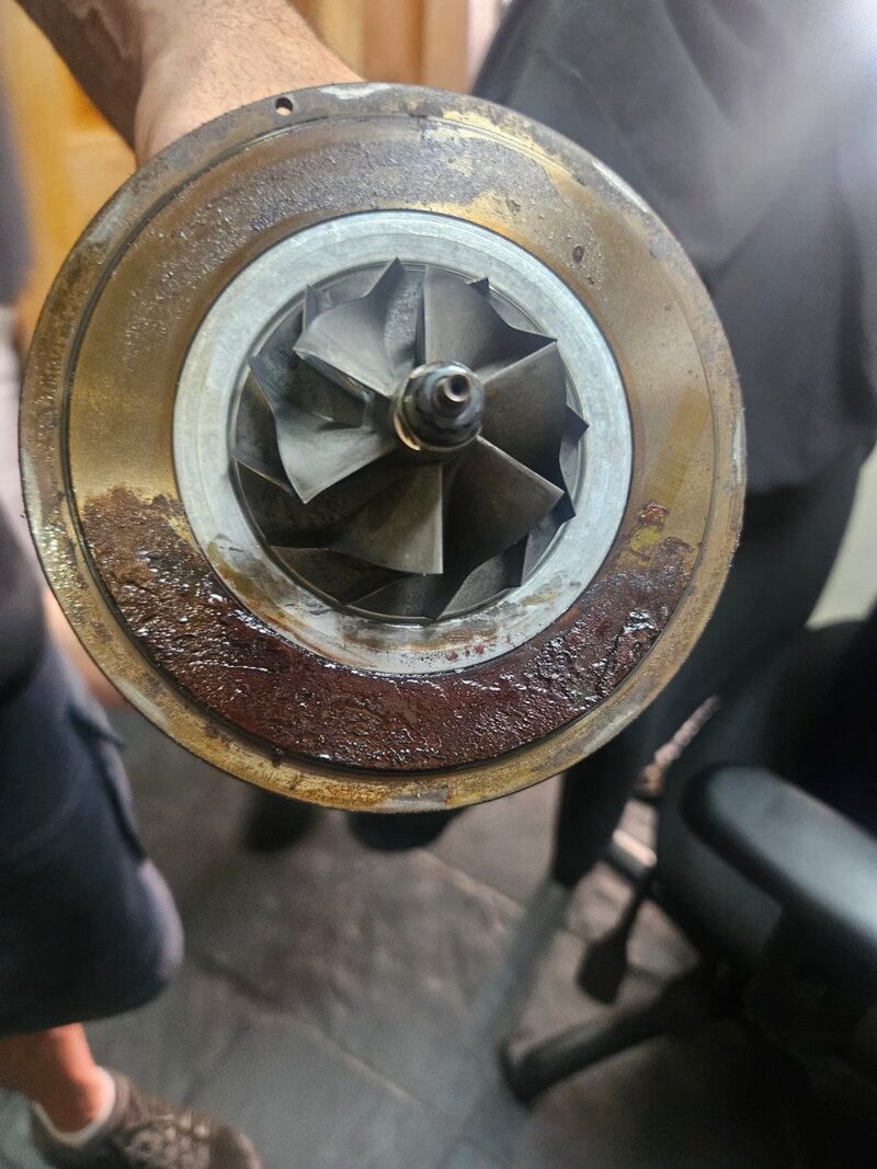

Can give a short update. Budler and the team stripped off the turbos as a first port of call to assess the smoking, and found the Bank2 (Passenger) turbo to be in bad shape, with very weird residue/rust.
Apart fromt he rust, the blades were dry from possible oil leaking. however if you look closely, there does seem to be some damage of bent blades on 3 of the blades.
these are the last images, and they did some testing, and although the power was back, the car was still smoking to both Budler's and my dismay.

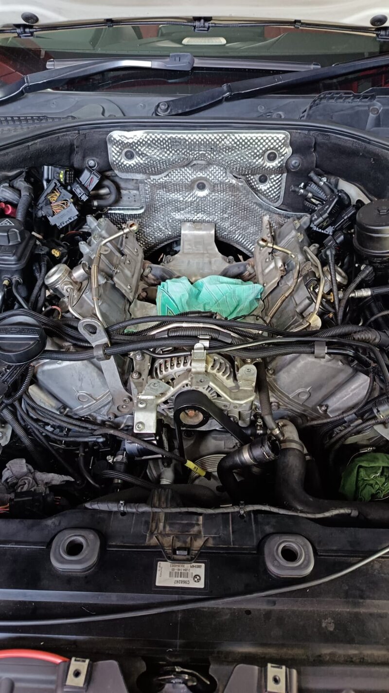

I was given a call Monday morning and the decision is to pull the motor again to investigate and find the root cause.
The motor should be pulled from today i believe, but they will update me once its out, so i believe only more information to be available from early next week.
No leak down tests or anything have been done as yet, so im leaving it in their capable hands.
