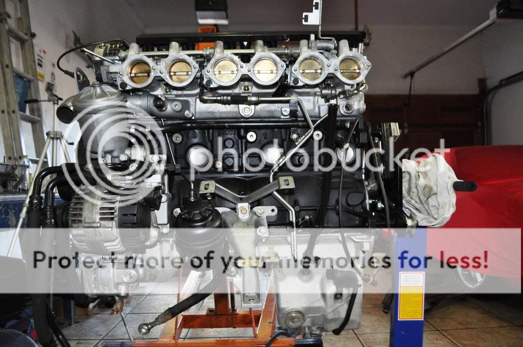

Engine almost complete.
Waiting for a few rubber hoses for the emmissions stuff and vanos work (must find someone to do it) and the wiring harness will go on and then we mate it to the gearbox.
Need to get a clutch kit for it first which I shall be collecting in the morning.

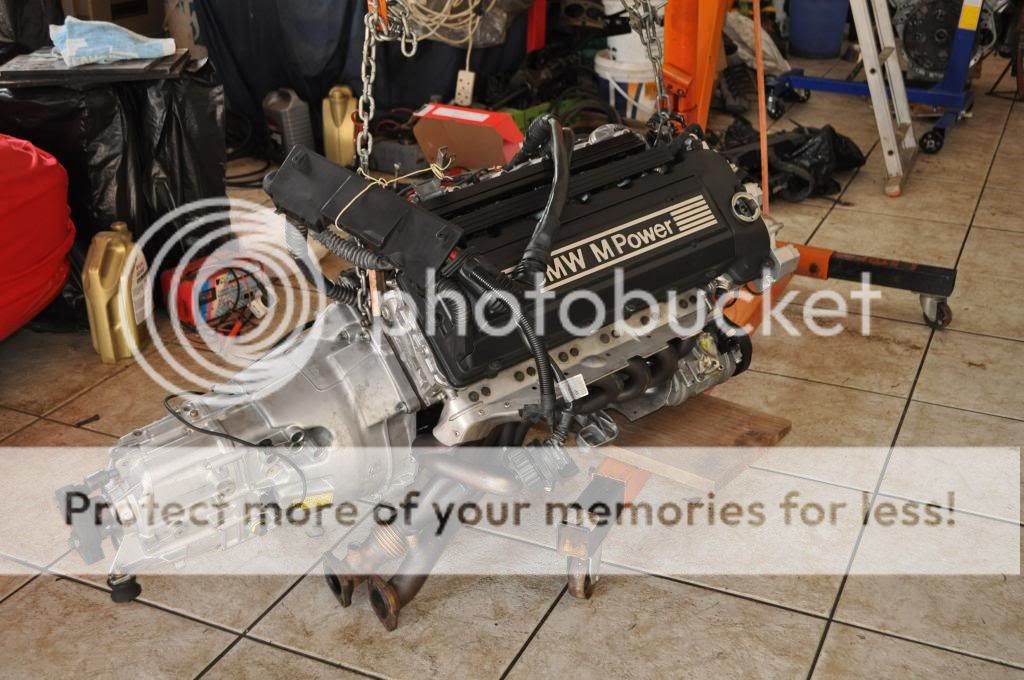

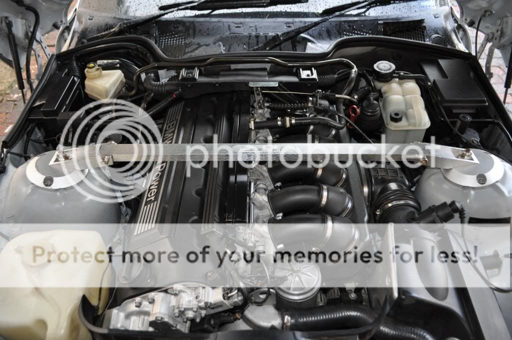

Peter@AEW
Engine assembled ready for installation.

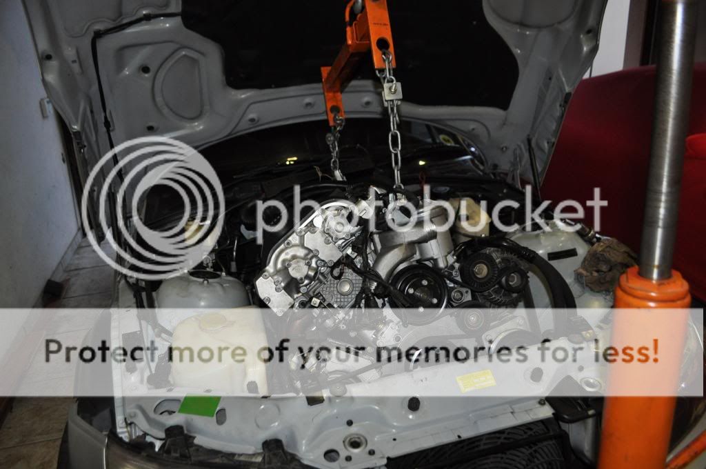

This is the point we got stuck without being able to sink it in all the way nor pull it out.
So we had to strip the front completely as well as the steering shaft to get it in and then with a bit of force 5lb hammers and angry talk we eventually got it in.
Not an easy installation even if you have the knack of it.
Finished product has just returned from a 300km trip.
Strut brace does not fit well so we will be looking for a new one.

moranor@axis said:
back where is should be :)
cant you alter the brace to fit better?
Not to sure actually might just take a look see this weekend.....if not I have a few pieces of angle iron and a welder and I am told Chris may stop by so we will get him to weld us a new one :roflol:
