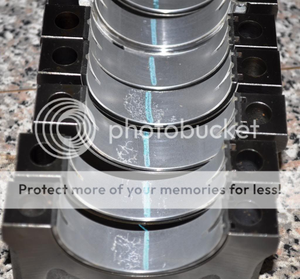

Bearings close to failure.

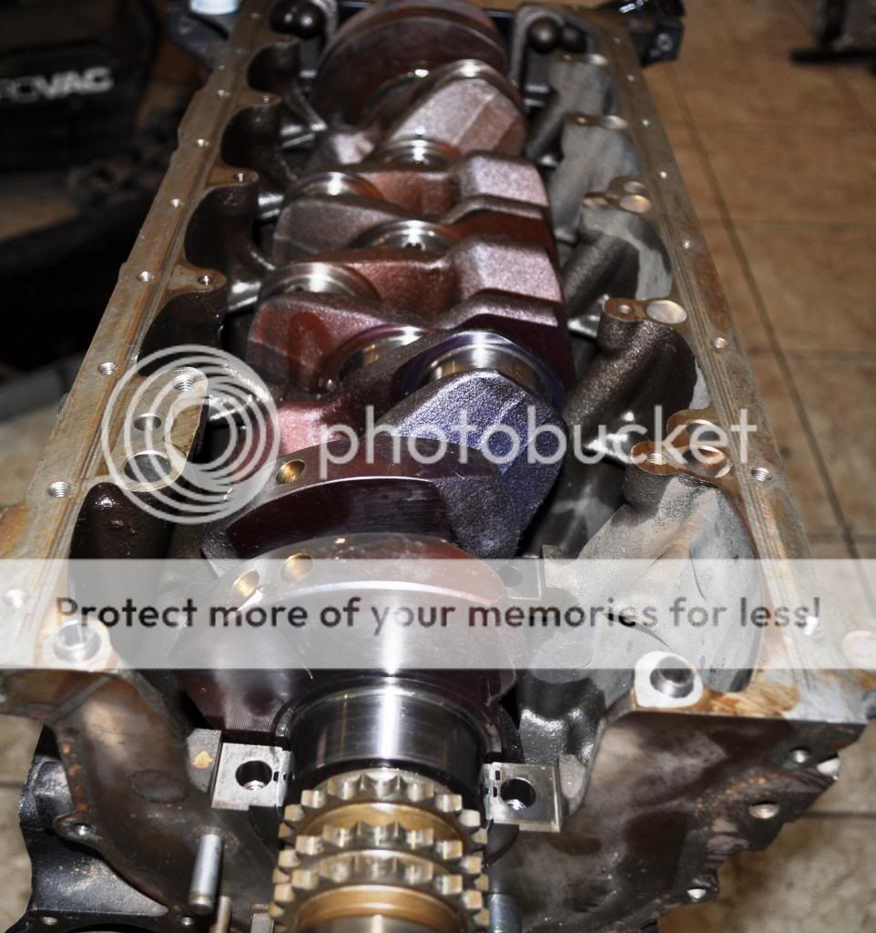

Currently all of the engine components are with the engineers. The block will be honed and the crank will be polished. The cylinder head will be tested for leaks and the valves will be lapped.

moranor@axis said:
lucky it was opened before to bearings spun...
Yes indeed. Once these motors spin a bearing things get expensive quickly. Often the crank gets scored and then no amount of polishing or grinding will save it.

The block has been worked on by the engineers and will soon be ready for collection.

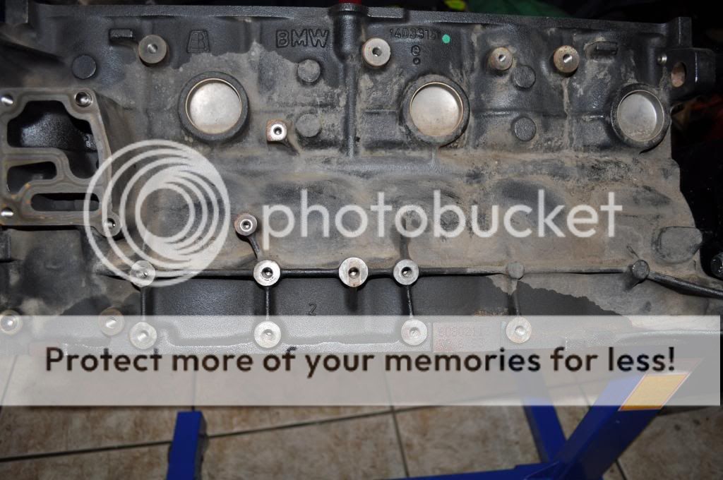

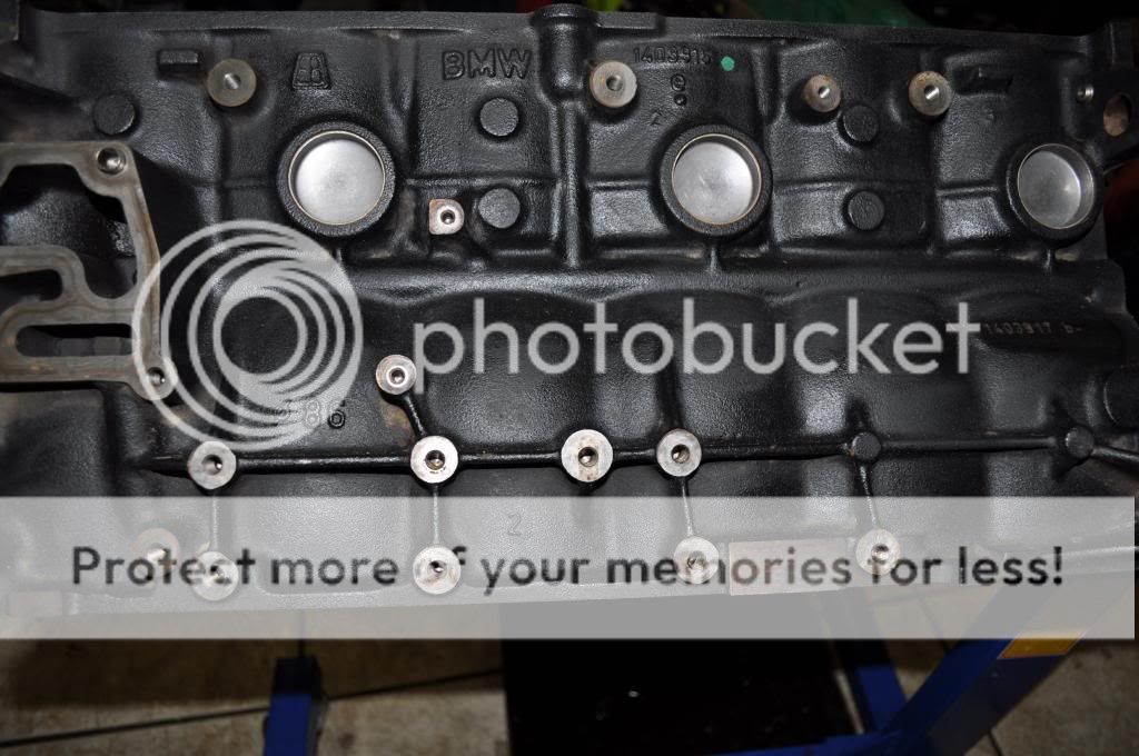

KING_Floris
the colour difference on 5 and 6. Would it not have anything to do, with different temperatures on the engine. example maybe the back is running hotter than the front
