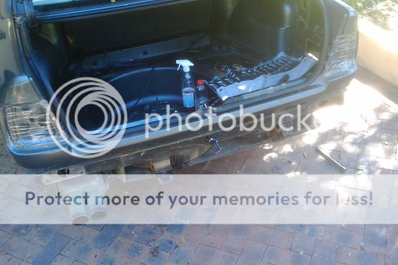

more pics taken today will upload shortly.....bumper off, back clean, found some rust I am not happy about, otherwise all good.....

ok, bumper is off...found some rust on the inside of boot and back piece will need to be cut and fixed before respray.
need that tape will check price here tomorrow....

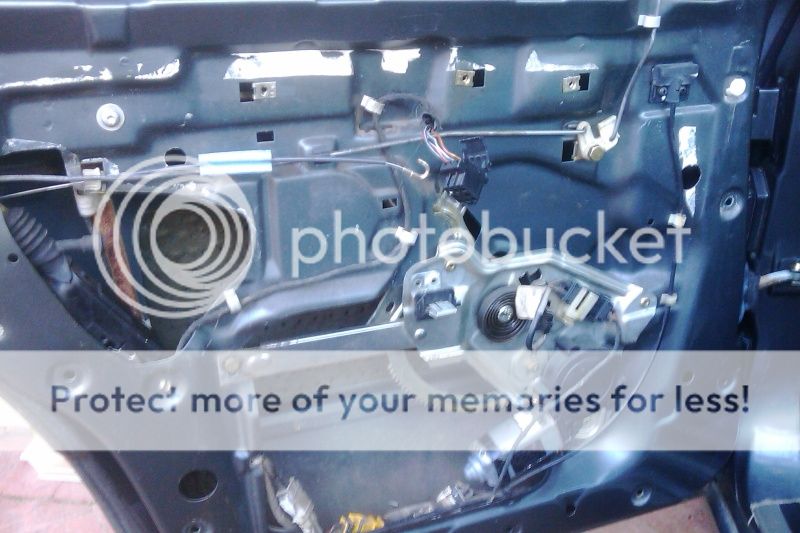

back door panels off, rust at bottom needs to be fixed....

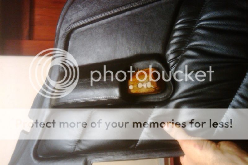

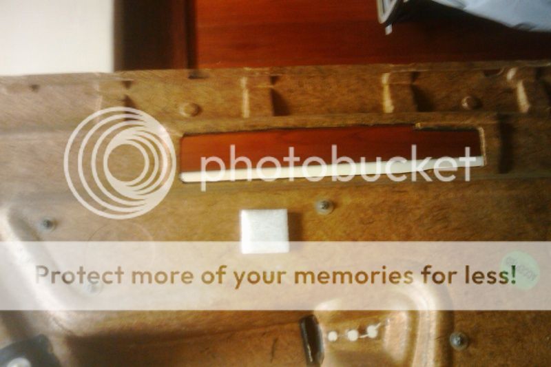

took door panels apart....
backing needs to be strengthend, will do teh same as i did with teh e12 boot covers will use that Kevlar glue stuff
