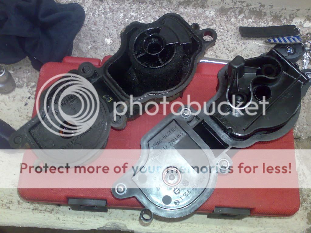

I removed the blades from the swirl flaps and popped the spindles back in and assembled the entire intake manifold, vacuum hoses and electrics. Also replaced crank breather valve with a new unit. Service procedures indicate that this unit needs to be replaced at every 3rd oil service. I cannot recall this ever being done by BMW, so further investigation might lead me into another battle with BMW re the link between the breather valve and turbo failure...

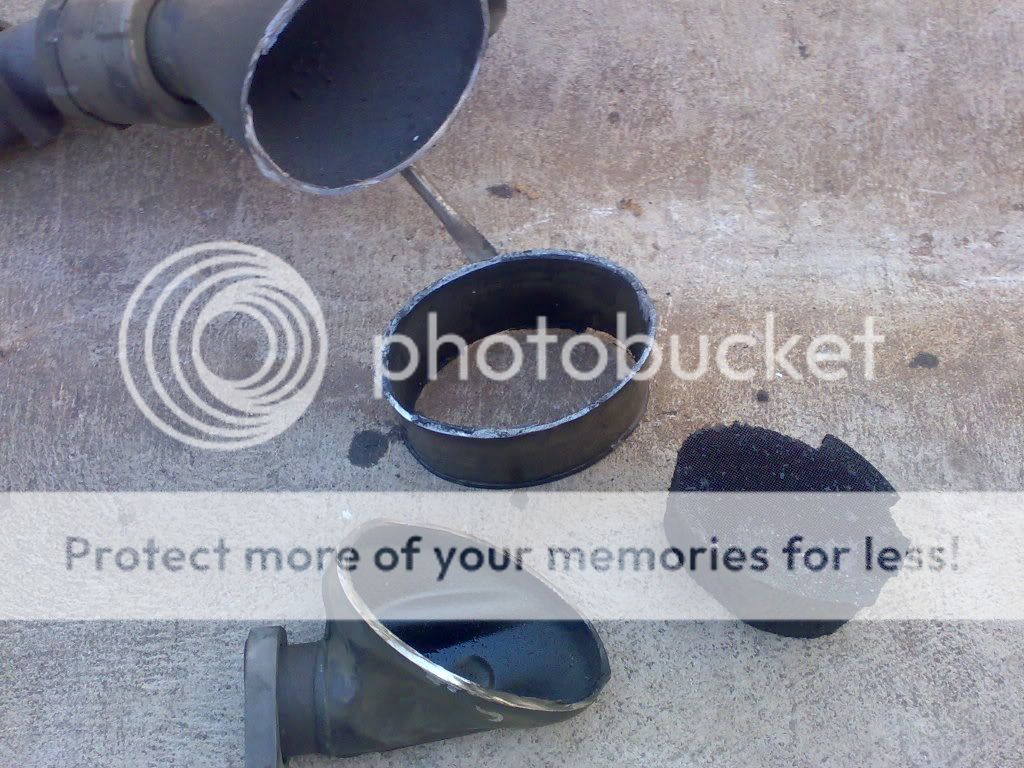

Lastly I took the cat that I decatted earlier to Speedy to ask them to weld the two seams back together and they wanted R228 for one cat's work. Took in home, fine tuned my welder and did a weld that will make even Bosal jealous. Saving money by DIY is definitely the name of the game!
