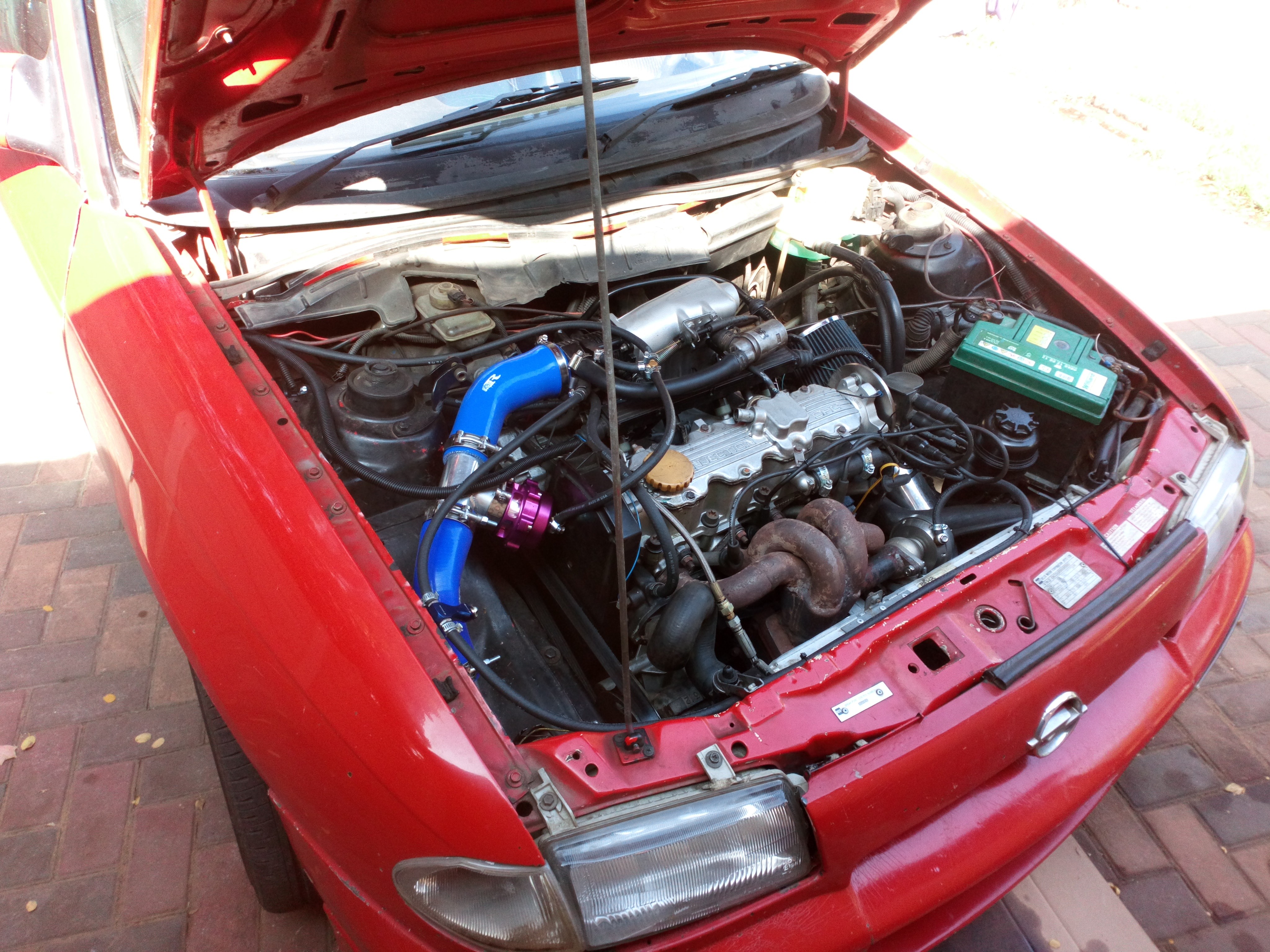

Gordvisr

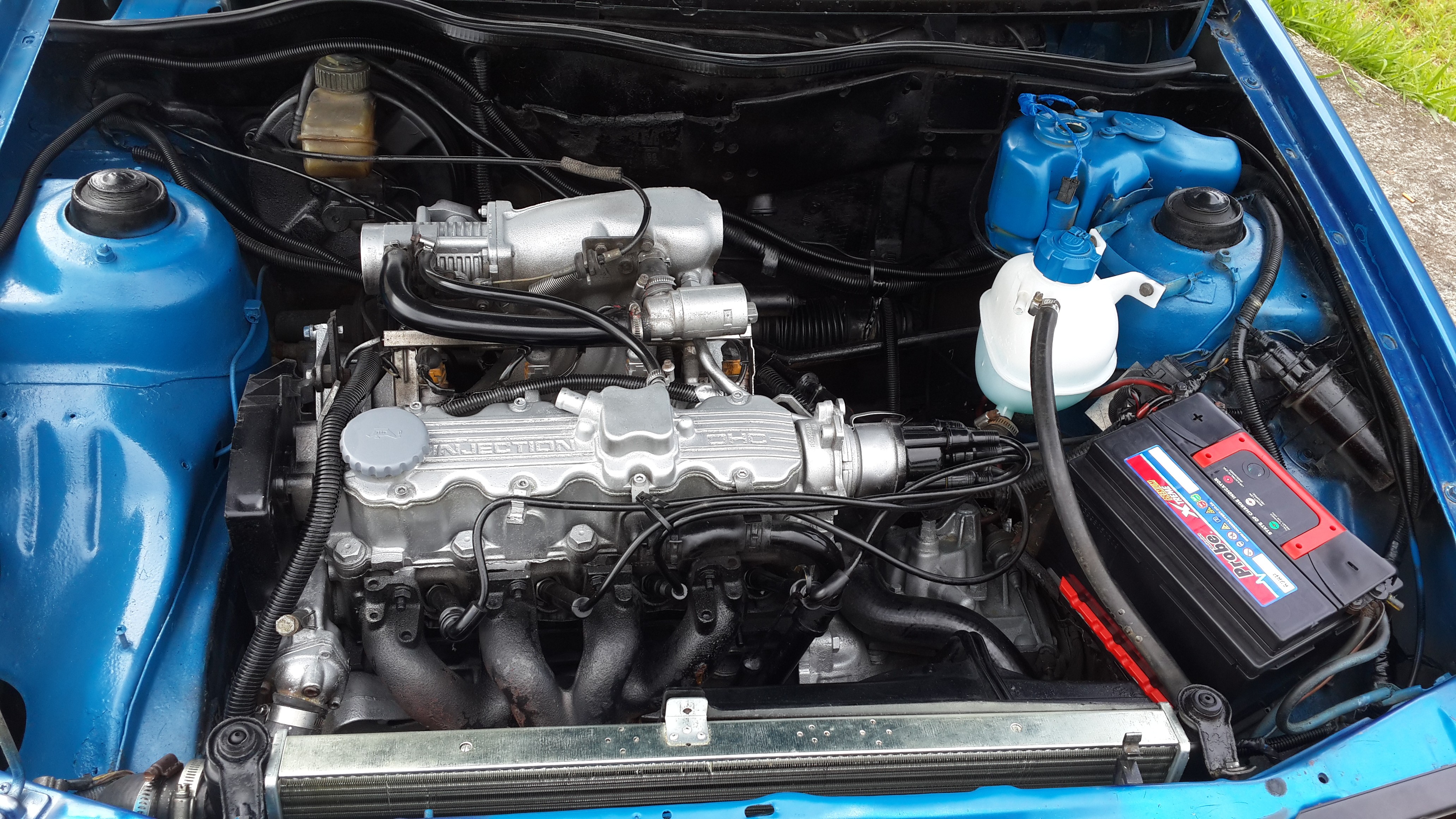

So she is up and running currently. Running Std management and std Injectors for now, will run like this for about 1000 Km then i will start with the mods on the nose for the Intercooler and the plumbing..... Cannot wait to go boosted, have done about 100 Km and all looking good, had some issues here and there with hoses, replaced them and went on. It has been a journey so far , the build started in Nov 2016 , learnt a lot during the build and glad i did not give up. Will update shortly after running in.

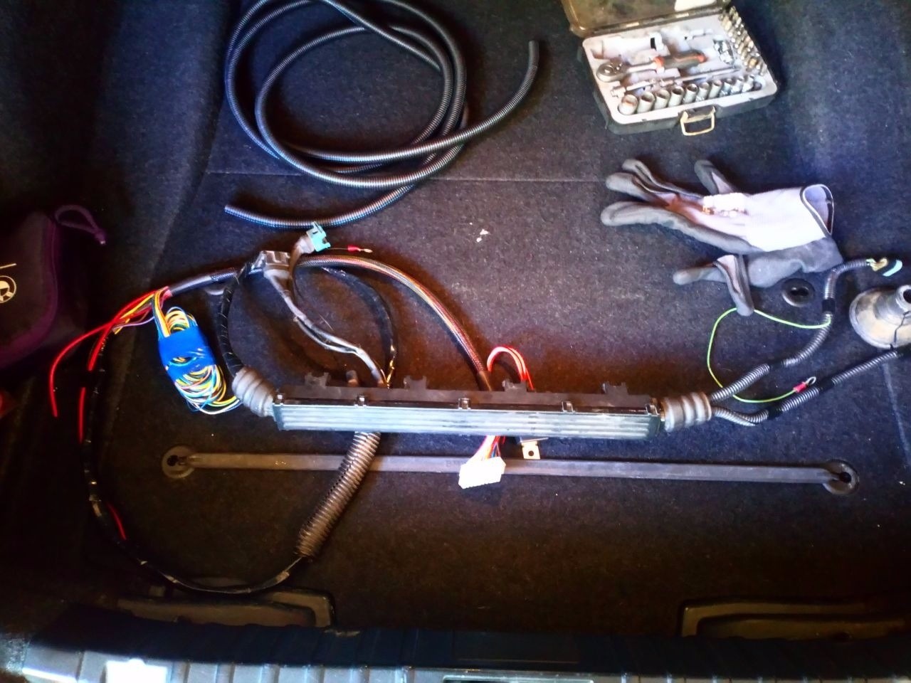

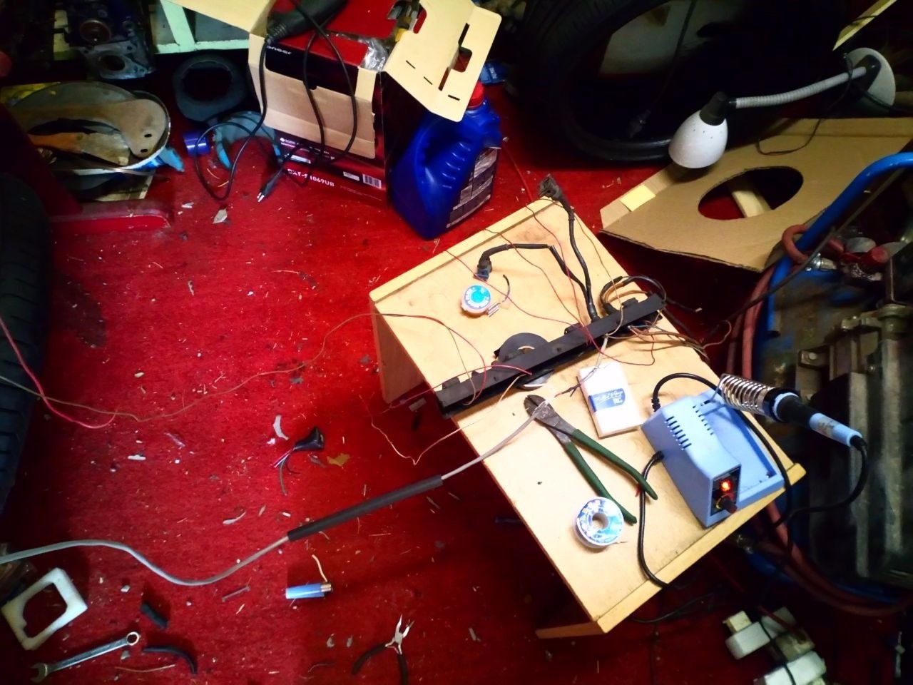

Had some spare time on my hands, Started and completed the Harness.

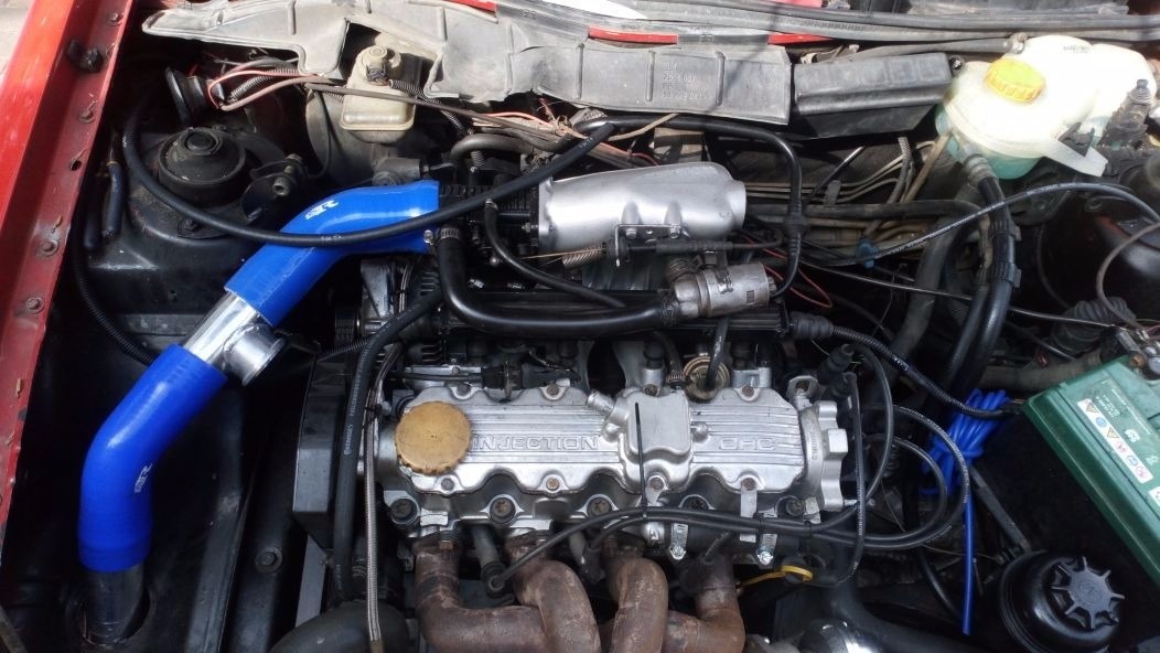

Then completed the Plumbing...sort off

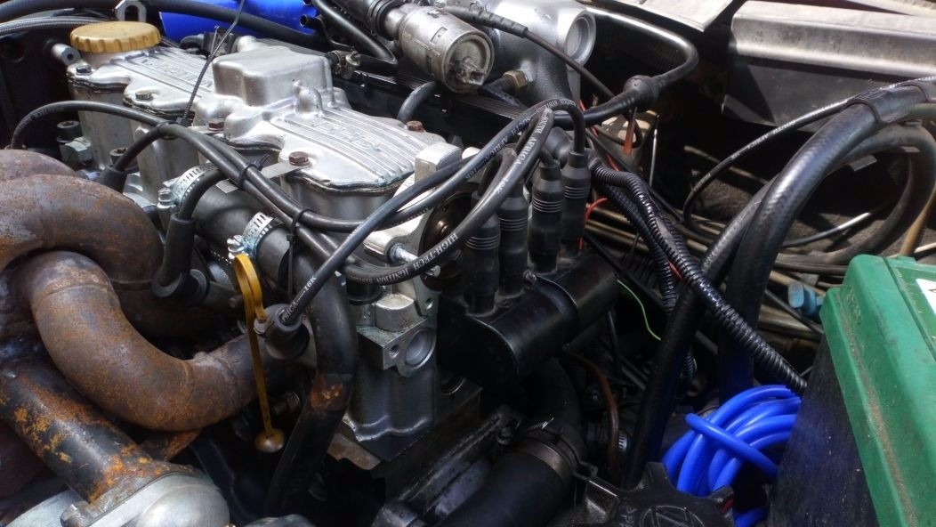

And fitted a coil pack instead of the dizzy, still waiting for the "new" back plate to be made up.
At around 16h00 on tuesday i finished installing the harness and ecu but still need to get the laptop sorted out, will do that when i have some free time on my hands again, currently running between work and hospitals, also a big thanks to DannyOpc for his input and help.
