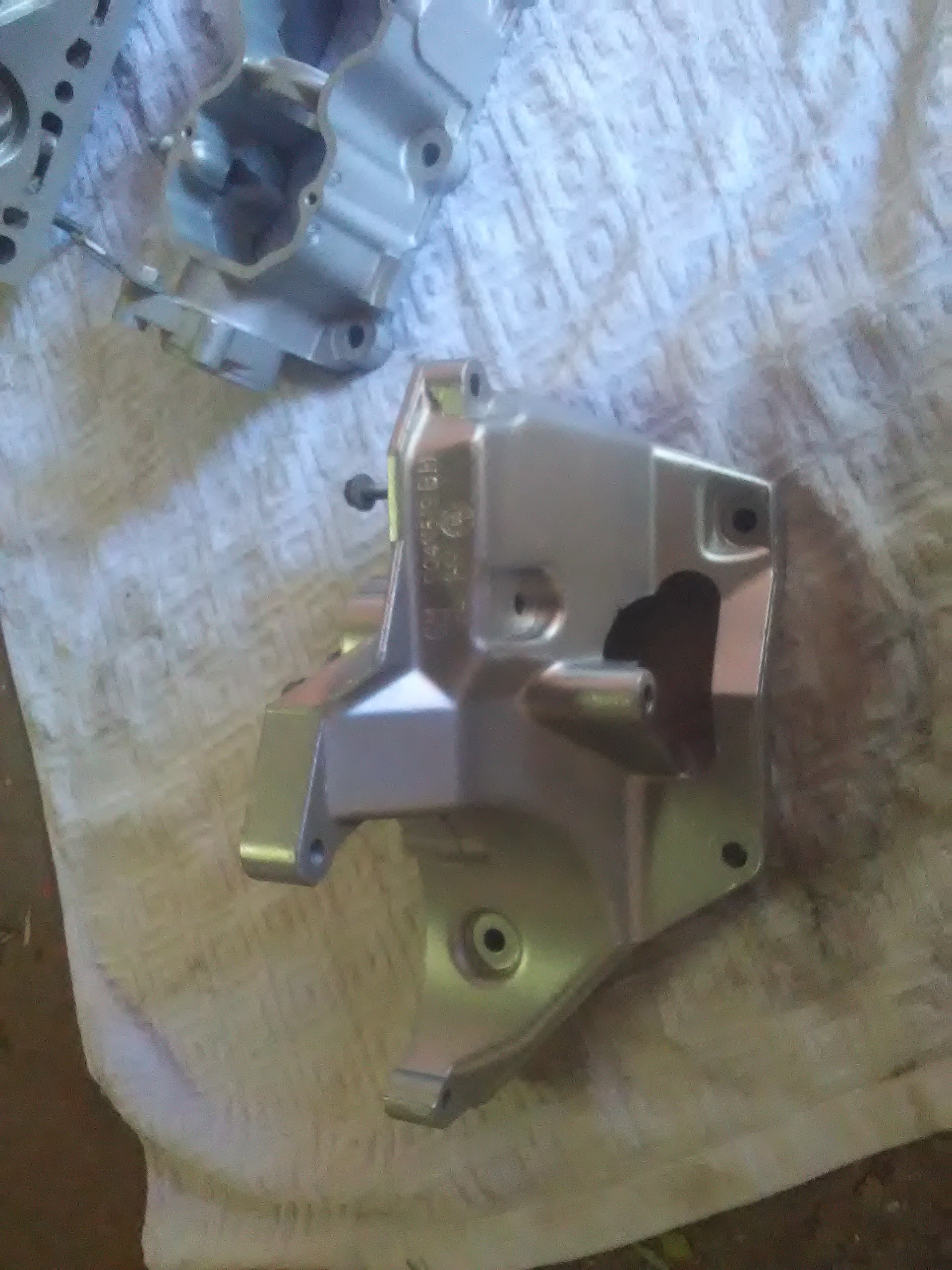

Made a short trip out to Krugersdorp and ot me this.
Looking much better that the first one i got.
Now the block need to go in to match the wall clearance of the pistons and awaiting delivery of the head, might receive it tomorrow.

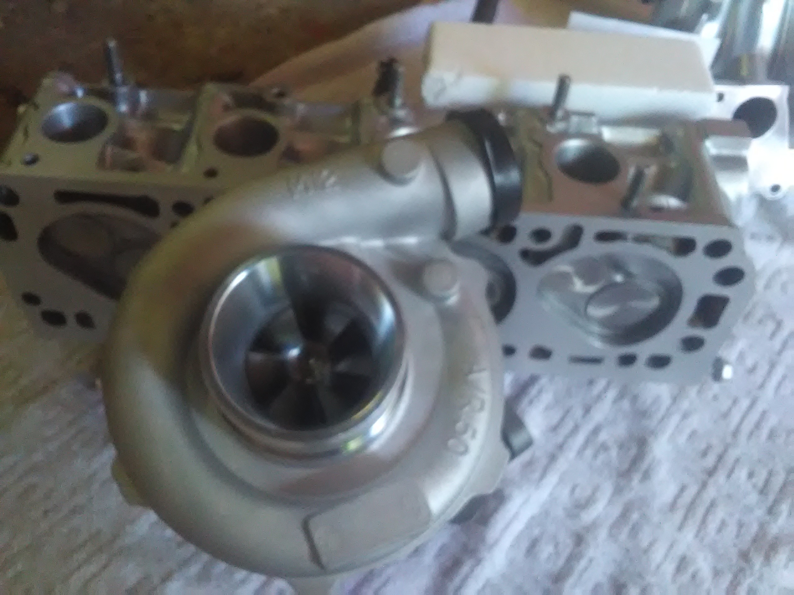

So had a few bumps on the road to sort out, the plug on the oil channel i wanted to use for the oil feed to the turbo was stuck, when trying to remove it i accidently drilled through it ( wanted to use speed out to remove it ) and shavings went into the oil channels, so had to open the block again.

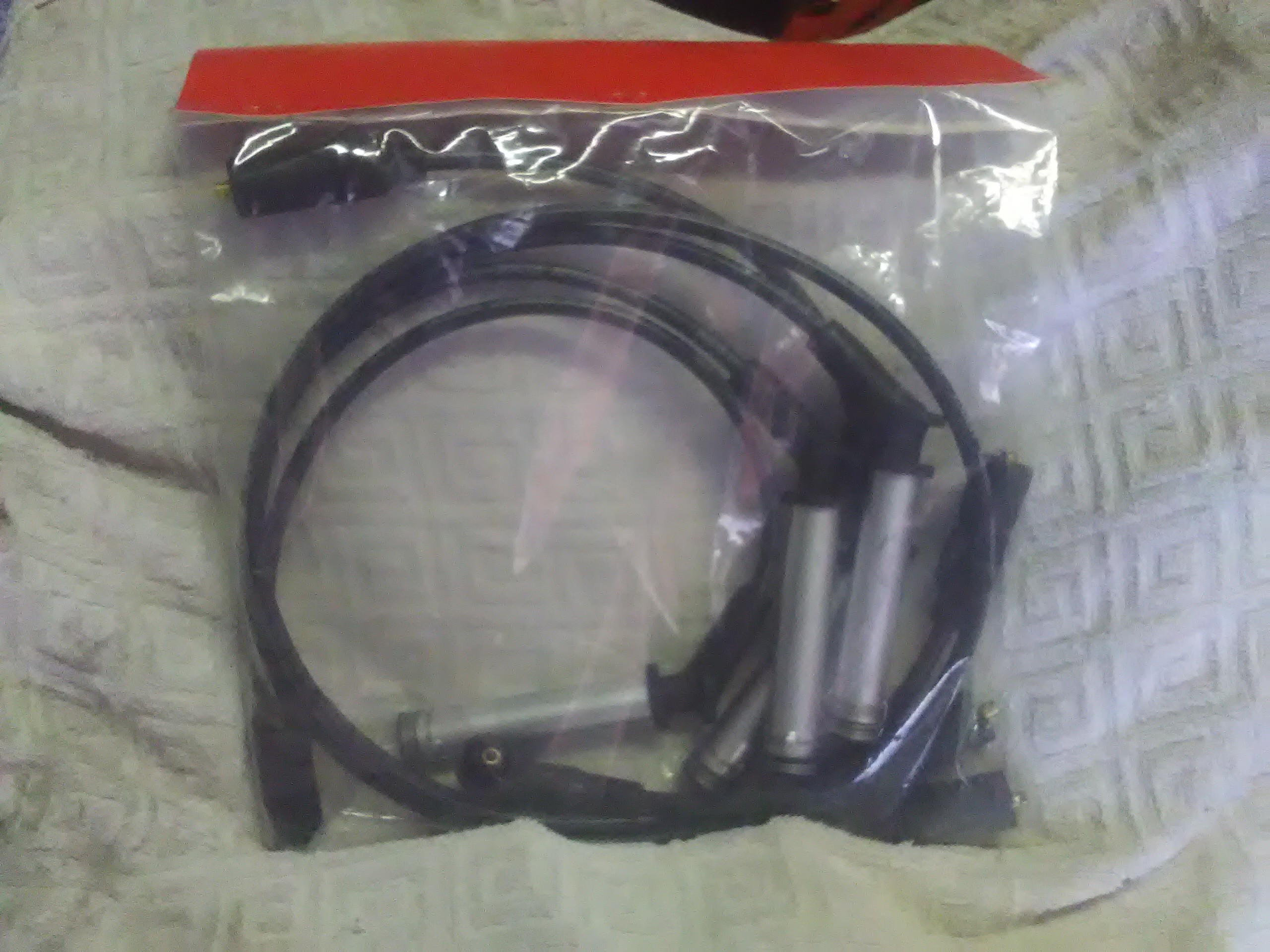

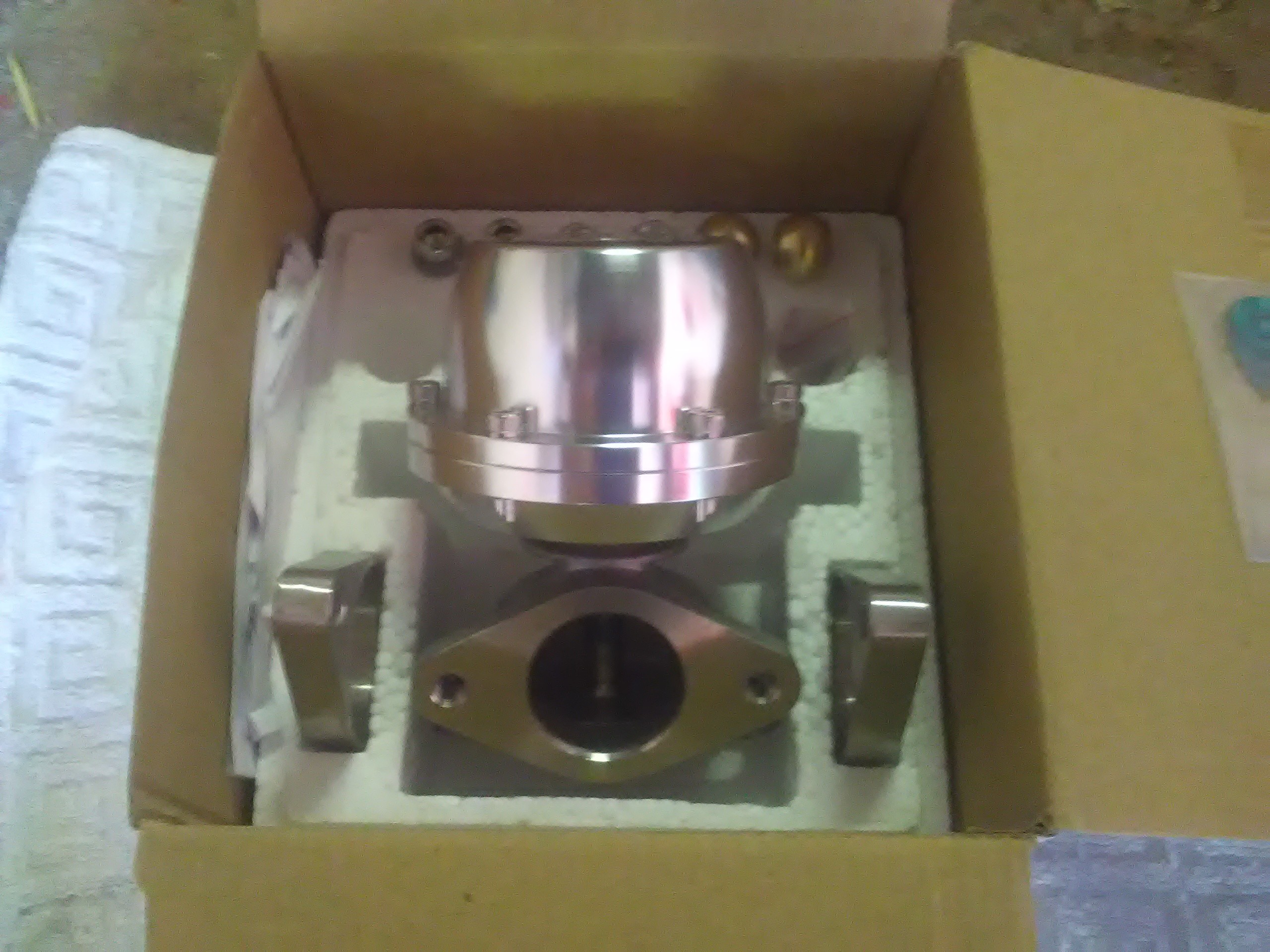

Had to make an reducer adaptor for the turbo to fit onto the manifold but this lowered the turbo to sump height and the turbo is to close to the block. So i exchanged the GT28 turbo for a T3/T4 unit.
I also went and fetched some other goodies needed.

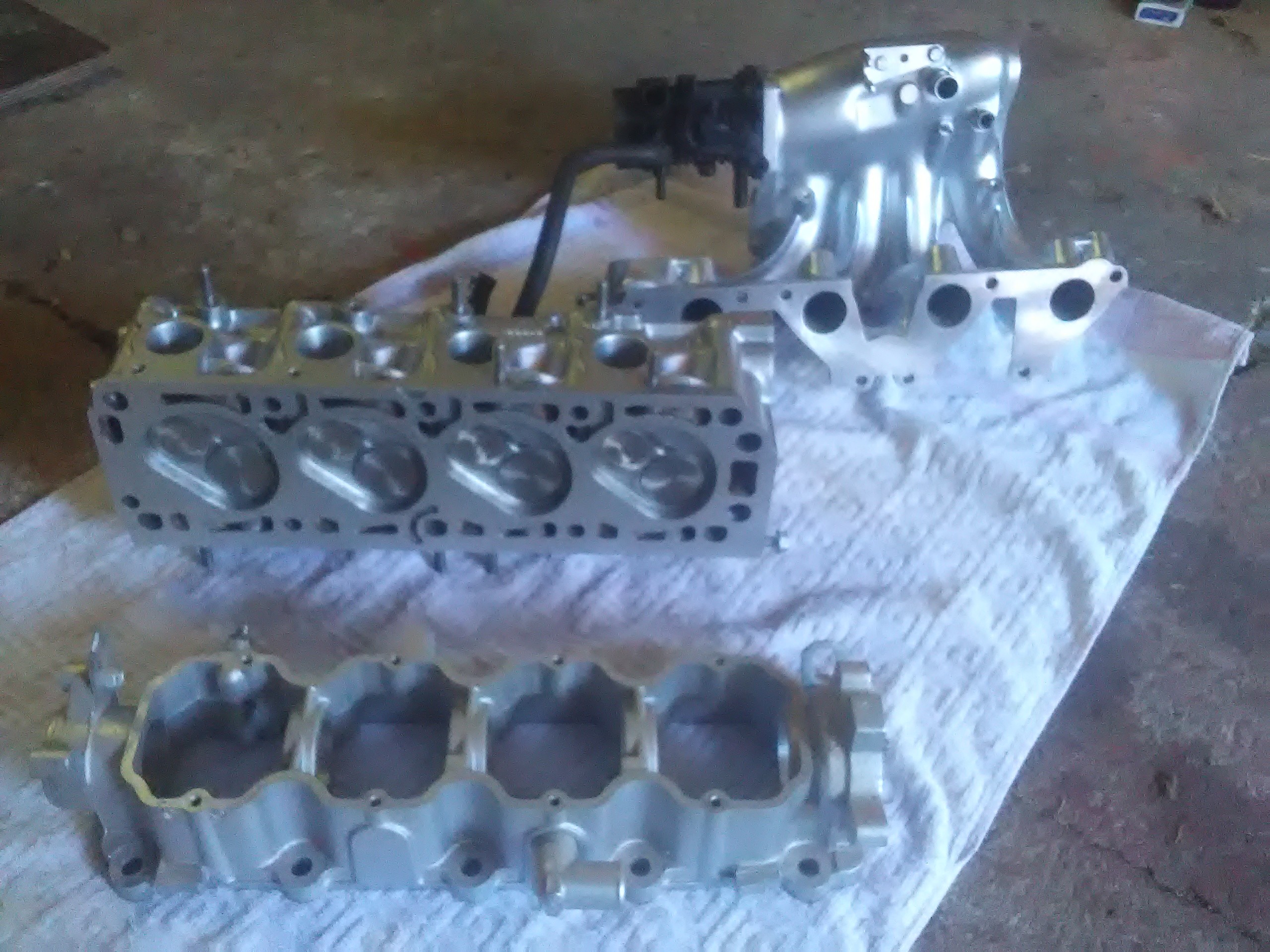

The head ported and sorted out with a few parts cleaned out.
Got a new cam-box also.

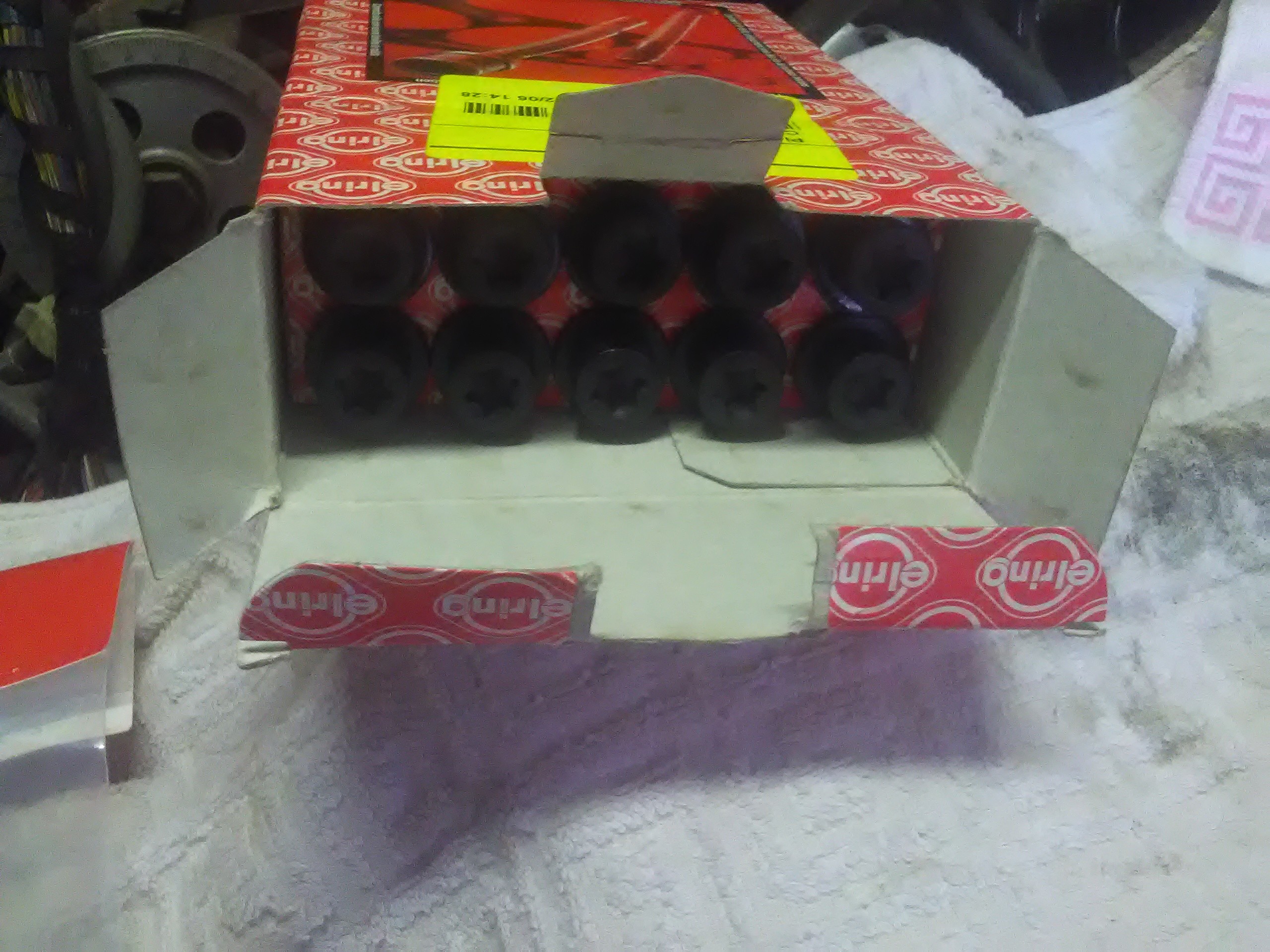

New head-bolts and leads.
the "dryer" :)
Wanted to install the engine this week to start with the wiring for the ECU but my off-time was not my time anymore so will get to it whenever i will be off again.

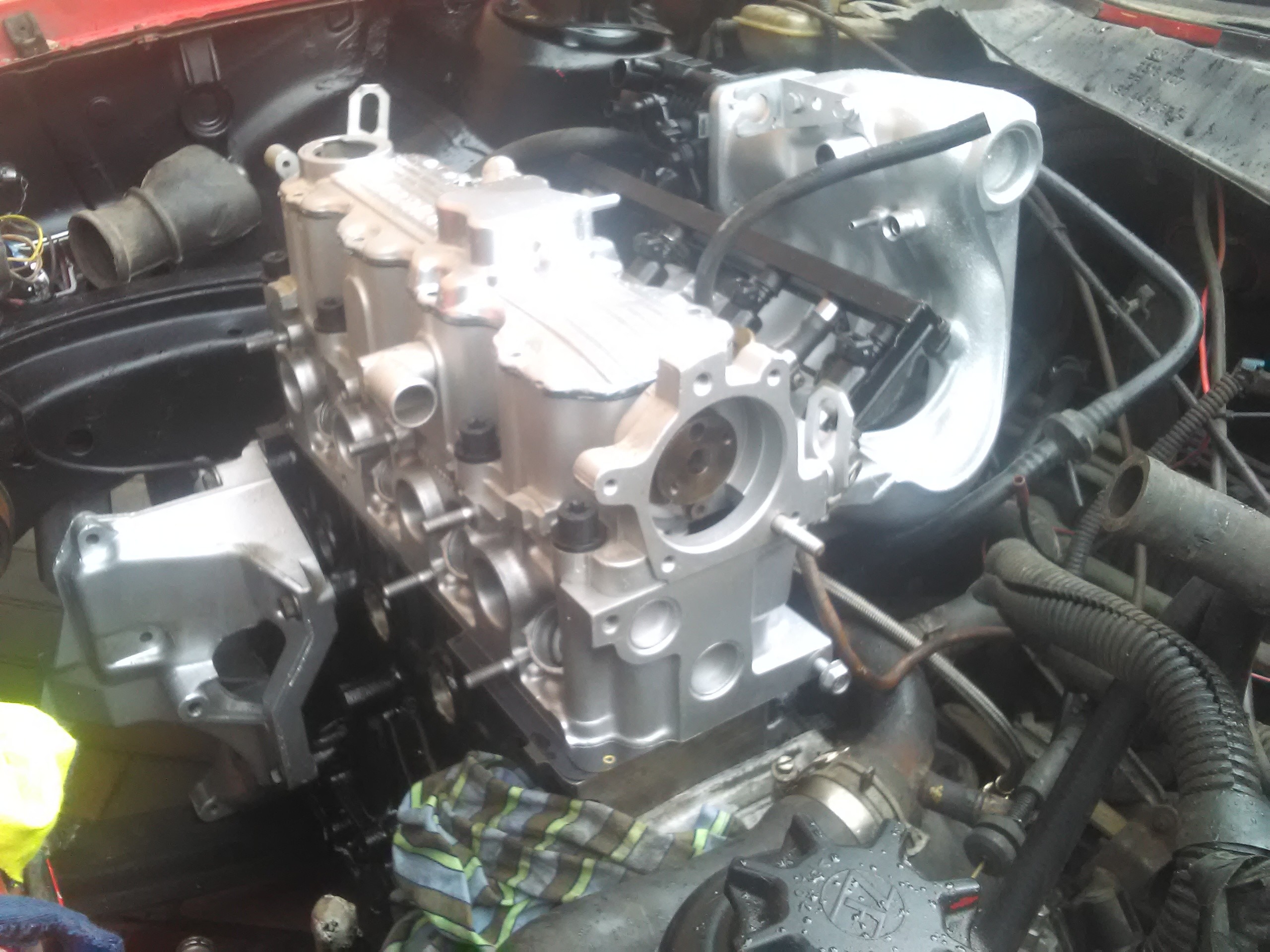

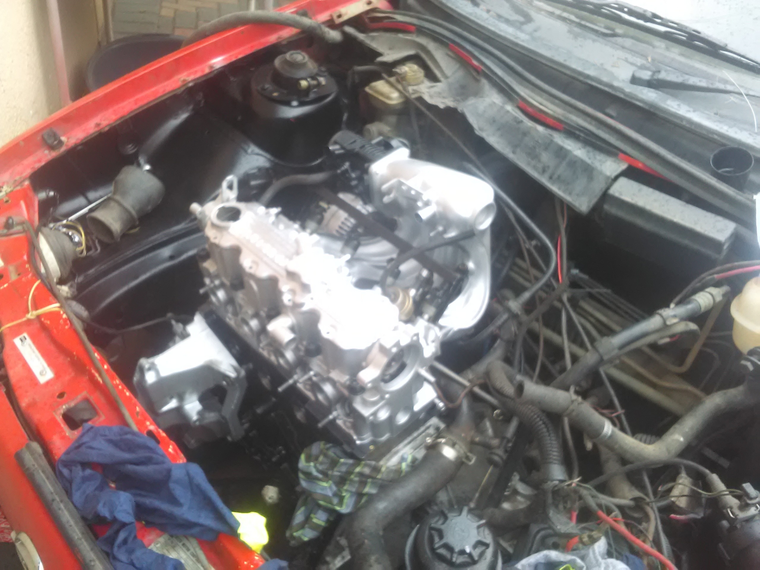

Had a little bit time off work so i spend some time on the Kadett again.
After finding a crank angle sensor and cleaning some parts here and there......
Would have liked to finish all the mechanical bits before Sunday but unfortunately duty called, Will hopefully resume soon.

Gordvisr

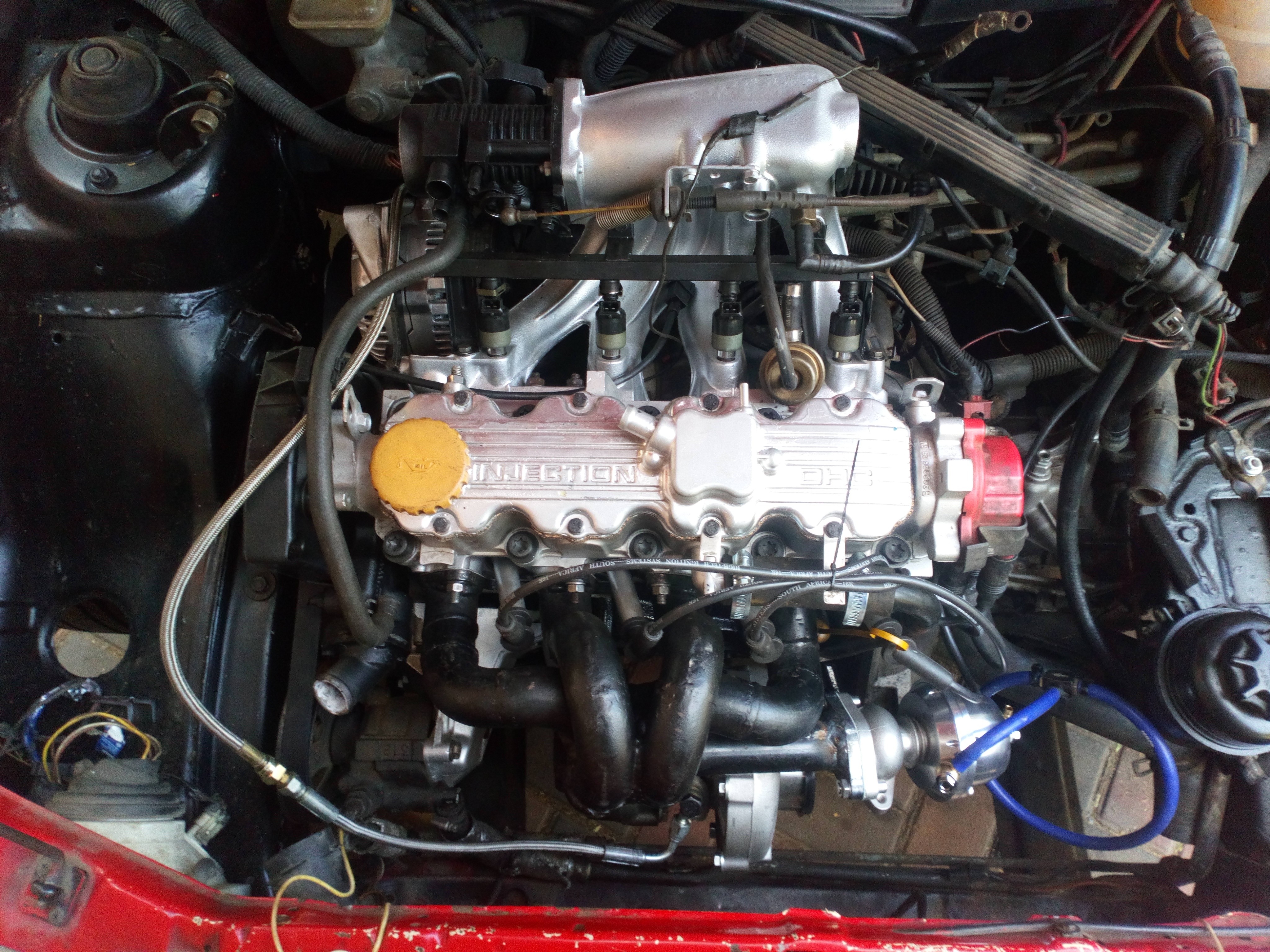

Started her up This week, unfortunately head gasket keeps on leaking, still doing some homework and problem solving around it, taking her for exhaust and plumbing Wednesday and when off again will start with the wiring for dicktator.
Shuaib1
Nice buddy, How much space do you have between your radiator? Mine was limited and went through 2x radiators thumbdo: as somehow in the drive the motor pressed a hole in them
Gordvisr
Space is limited, i can get a fist between turbo and radiator, the manifold is a bit closer at the top. We will see how it goes.
And share some pics of that one you refering to:=):
Fuzz123
Hey bud, very nice build!
Maybe double check that your torque setting for the head bolts are correct and check your torque wrench. It could be that the wrench is reading wrong and you keep on under torqueing the bolts...
2ndly make sure your block has the correct machined finish to work with the MLS gasket. If they machined it too smooth you will never get enough bite.
I have installed a couple of MLS head gaskets on 200sx's and never had a leaking problem.
Good Luck!:thumbs:
Gordvisr
So today i removed the head again, tried a few things but alas, not working, still leaking through, tomorrow if i have time , will remove the head and send it for pressure test, they never tested it :(. Will also send in the block to skim the deck.
