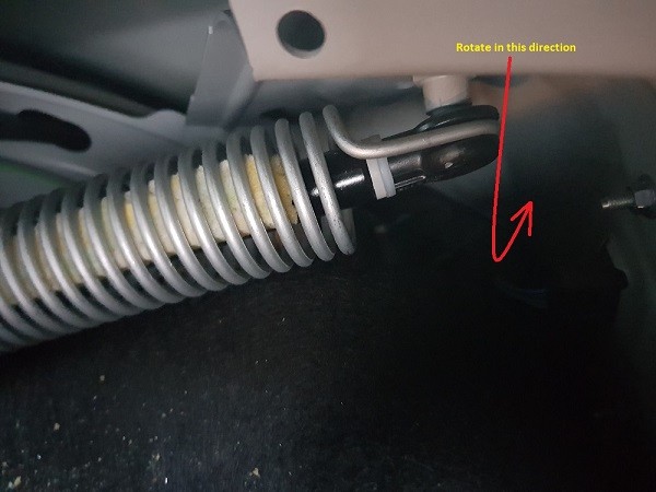

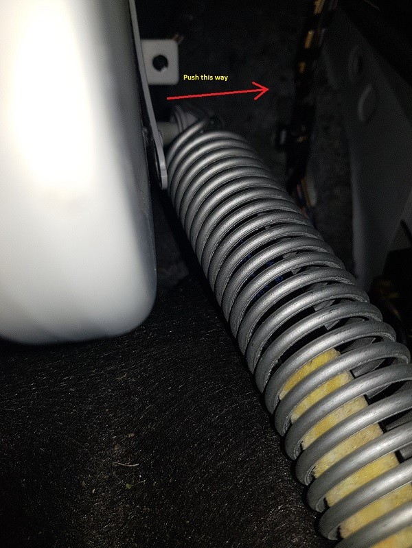

I recently got caught of guard when my boot tried to decapitate me while opening which then followed by a cringe when it bounced ever so close to the rear windscreen. Struck with fear of causing more damage I made it a priority to have it fixed.
So I ordered a new boot spring and replaced it, only to realize that I order the wrong side (Left instead of Right). I figured it's no big deal, I will just order the new one. To my surprise, no dealers in SA had stock of the part and it had to be shipped in from Germany, which took a few weeks. During that time I was extra careful when using the trunk and made sure my kids were far away.

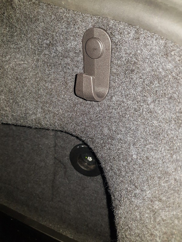

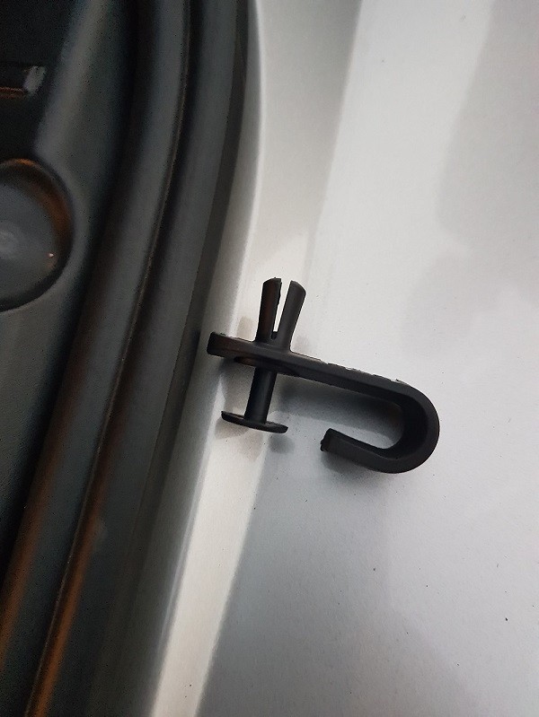

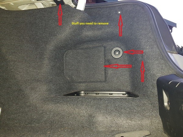

Another item that I wanted is really small but very functional. Its a parcel holder hook. The f10 for some strange reason only comes with one where the f30 comes with two (one on each side). Its something that I tend to use very often and figured I should tackle it during the installation of the boot shock as its one of the points that needs to be removed.
I rate this a simple job and was done in less than 10 minutes which included installing a BMW air freshener kit.
Once the clips have been removed, pull off the carpet to gain access to the spring at the back.
The parcel hook

I need to get my boot springs replaced as well. The boot has started to open quite vigorously and makes quite a big noise when it hits the point where it should be fully opened. Bounces about there 2 or 3 times as well.
. :eek:mgwaiting:
Rayzor
Yep, its scary AF :biglol: Almost feels like something is going to snap.
Here is the part number if you going with OEM: 51247204367

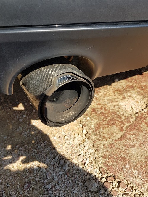

Also got some TLC work done.
sash
Nice Ray, Clean tail pieces really pick up the rear end.
Please send me the part numbers for the clip and the air freshner.
Rayzor
@Sash
BMW Natural Air Freshener Car Starter Kit: 83122285673 :thumbs:
@billionairebum So far it works as indented, I only got the first real use this morning on my way to work. I got it more for the slim design and look tbh
