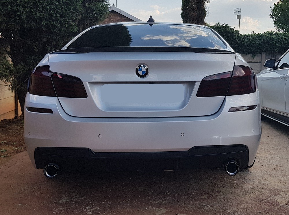

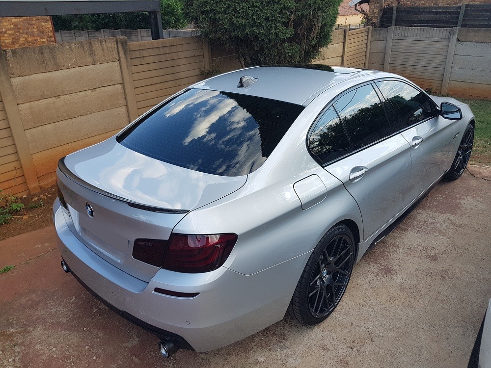

Engine flush and oil service was done a few weeks back.
Some random pics that I have takes since the then. :smilebounce:

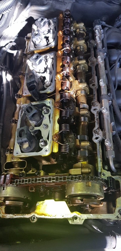

I Noticed that I had a leak from the tappet cover gasket and decided to tackle it before it got worse. Millage replaced: 164k km. I consider this to be a std maintenance item on N5x cars.

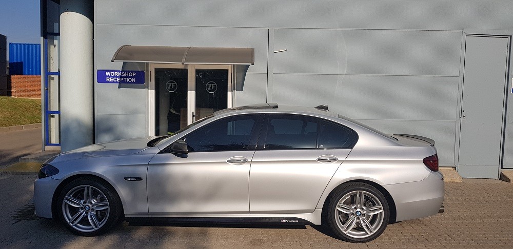

Visited ZF for an inspection and service, I was a bit concerned as my millage is a bit high now @ 170k km, The great news is that the box is in perfect health, I must be honest, I was surprised as the report came back better than my wife's lower millage 335i which got serviced last week.
These 8 speed boxes are amazing, I would recommend anyone with a high mileage car to go get it checked it, you might be surprised that the box is still in good health and can be serviced. :thumbs:

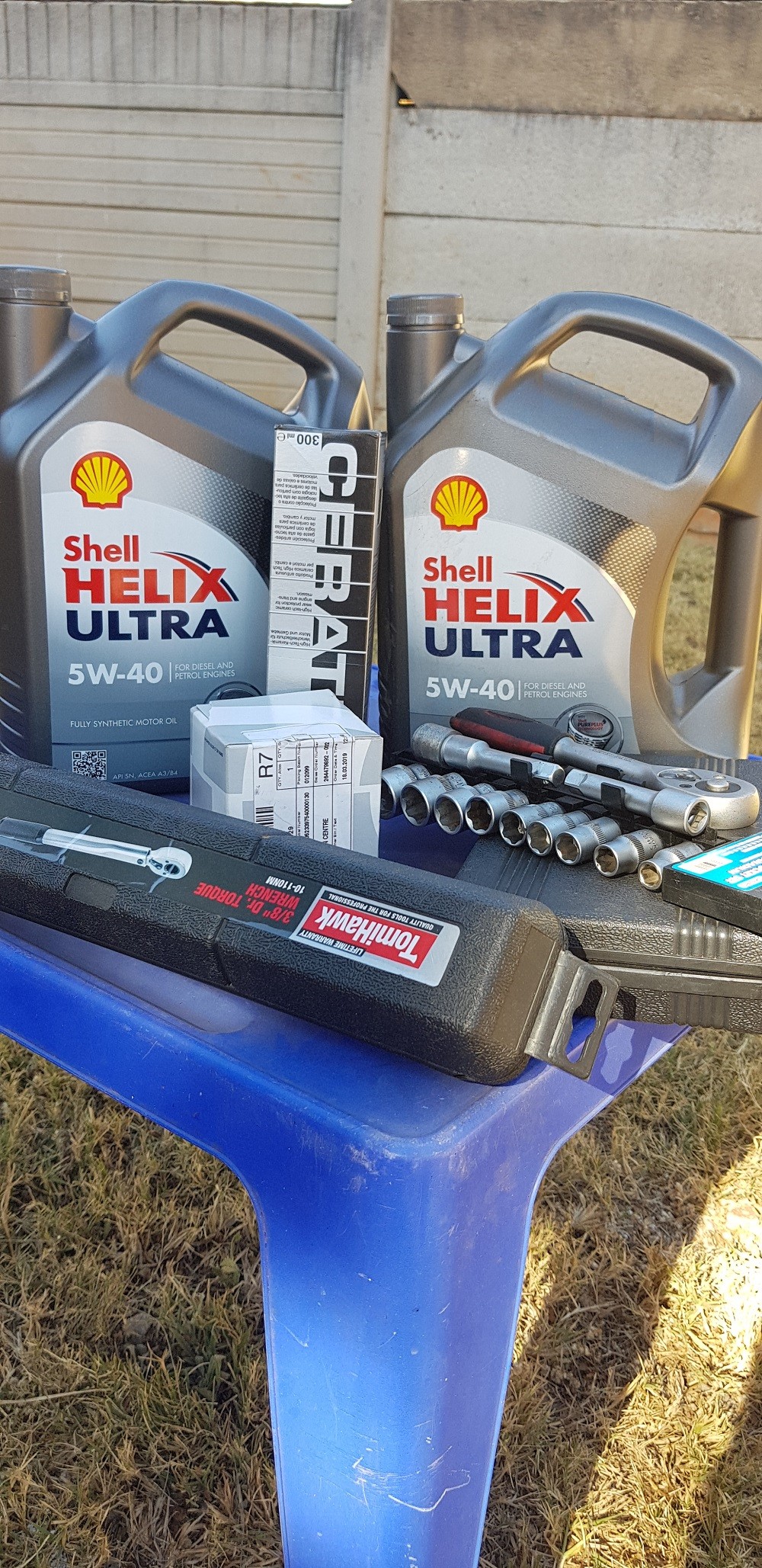

It was time again for an oil change. I decided to throw in a bottle of Ceratec this time around. It definitely works as intended.
I immediately noticed that the motor ran smoother and produced cooler oil temps.

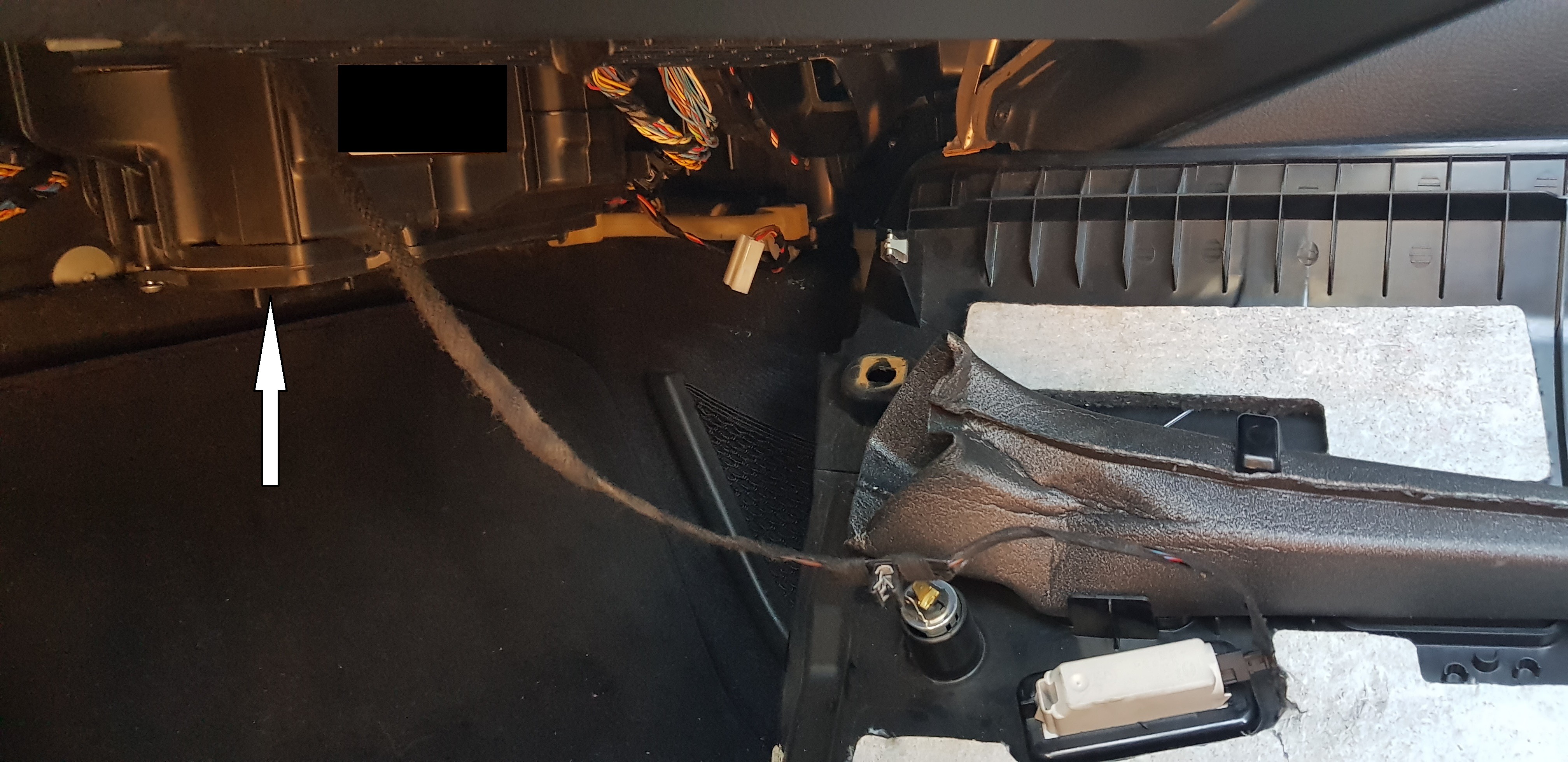

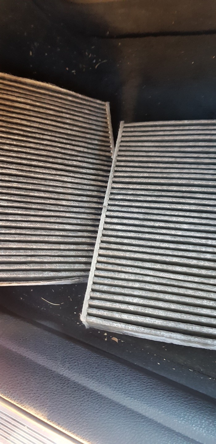

After the oil change I got busy with the cabin filter replacement, which in my opinion is a royal pain in the a$$. Like literately a pain that was produced while maneuvering into all sorts of positions to remove the panels to gain access to the filters.
If you own a F10 and plan on doing it, here are some pointers:
1. Disconnect the battery (Remove the negative terminal)
2. Remove the side panel screw located at the back of the center console
3. Remove two screws holding up the cover which houses the airbag.
4. Remove the four screw to the cabin filter housing bracket.
5. Remove the old filters
6. Install the new filters... IMPORTANT, make note that the new filter will have arrows which should point TOWARDS the cabin and INTO the car
See pics below. :smilebounce:
Equipment used..

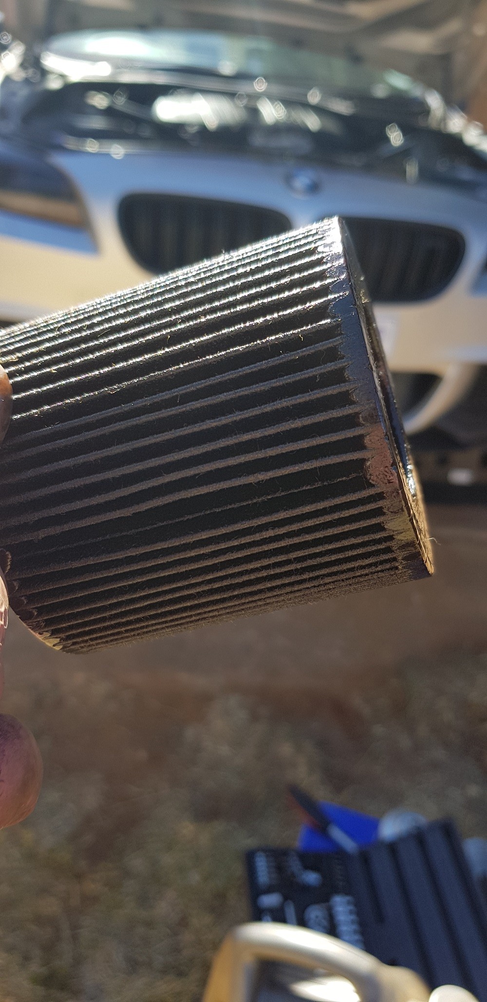

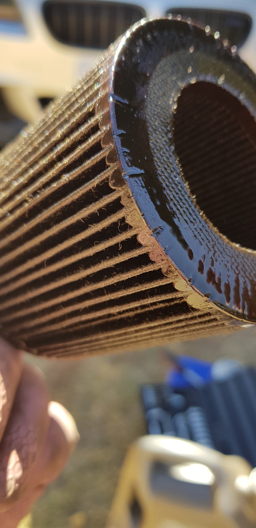

Old oil filter, still in decent condition :tiptoe:
