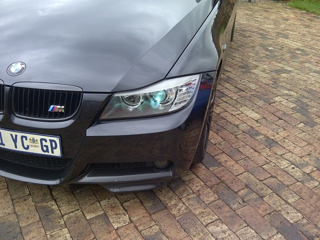

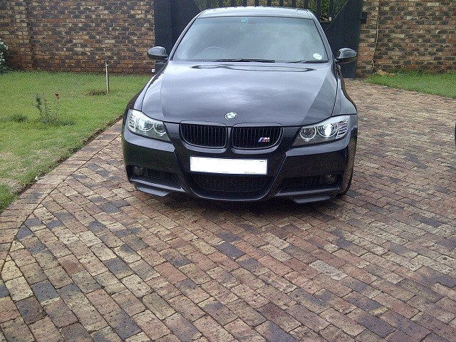

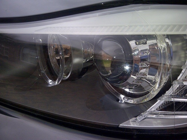

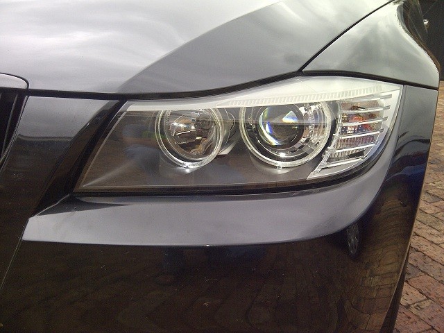

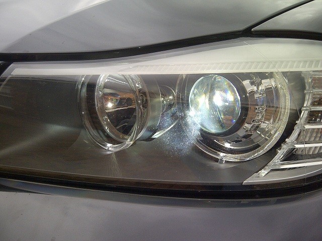

After buying my car with STD OEM headlights I had to do something about it. I came across Vishal topics to what he does with lights. I bought a pair of LCI headlights from a fanatic member, but the beams were STD. This is what Vishal transformed the lights into; all within 1 week (shipping to DBN, converting the lights and back to JHB). I recommend Vishal highly in all aspects.
