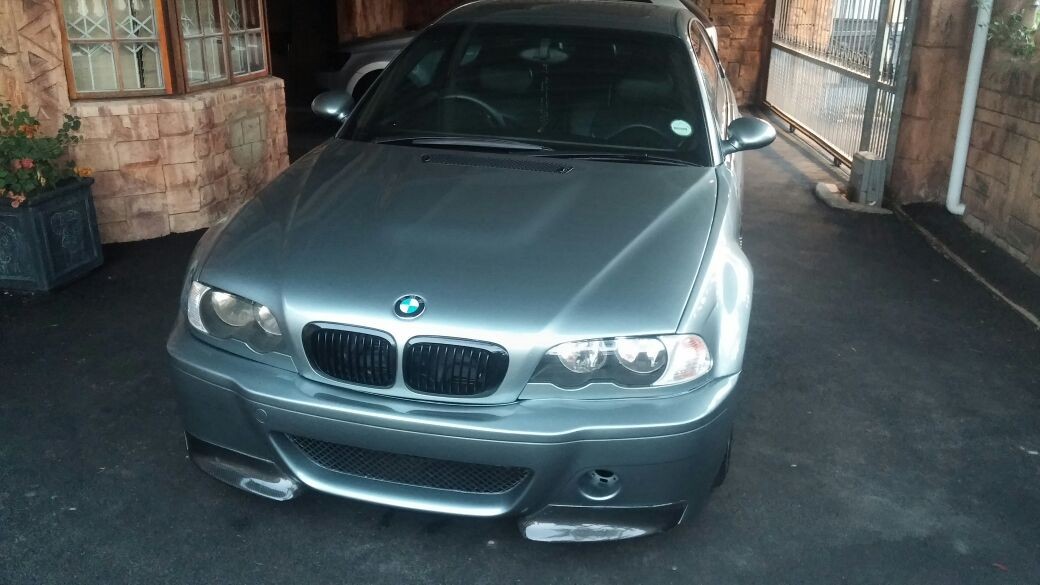

Hi peeps,
I come from the far East.. car wise not really from there.. has a R33 Gtr.. sold that last year.. having a look at a E46 m3 manual on Saturday.
I have read up on all the checks and buyers advice...
I know sub frame was replaced....thank God..
2004, grey, stock...hopefully it's good.

If that front bumper cover/spoiler is not OE put yourself down for R15k for the original M3 cover plus R2k for spraypaint.

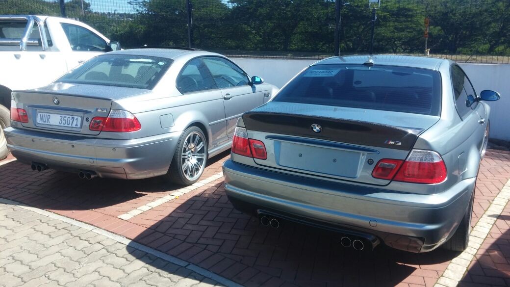

Not a fan of the rear spoiler, but hope the car is clean and sure you will enjoy the car. BTW, I saw a black CSL at automania in Kyalami. It looked a bit roughed up though. Didn't have a price on it so guessing it will go for some 'corrective' maintenance first.
Sent from my SM-N910F using Tapatalk
TBP88
I thought the CSL was a completely changed trunklid? Not just a spoiler stuck on?
Ga-3M
It is a completely changed trunk lid on the CSL, this one is aftermarket.:coolShake:

Gizmo@GARAGE46 said:
That is definitely no oem csl front bumper in the picture.
My thoughts as well, i asked for all invoices for repairs and extras.
the non OEM bumper is not a deal breaker, stock bumper is my preference.
this will be my first BMW,this is the only one i would buy... styling, icon... perfect balance between classic and modern.
