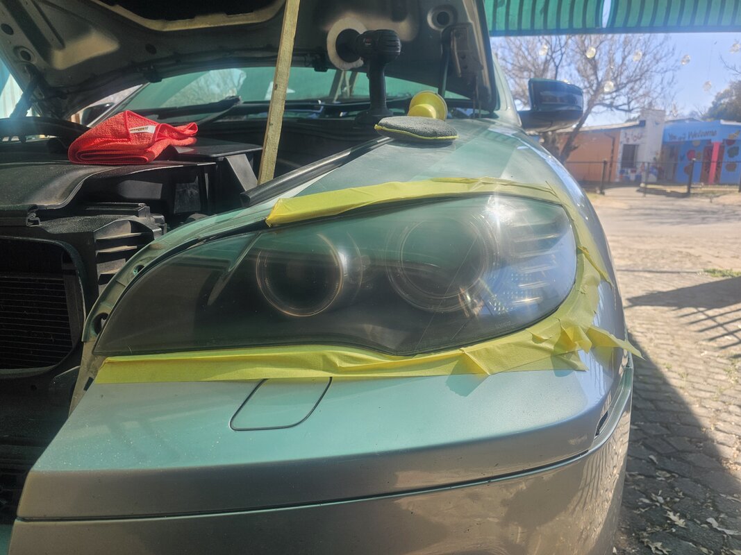

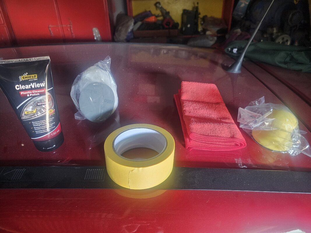

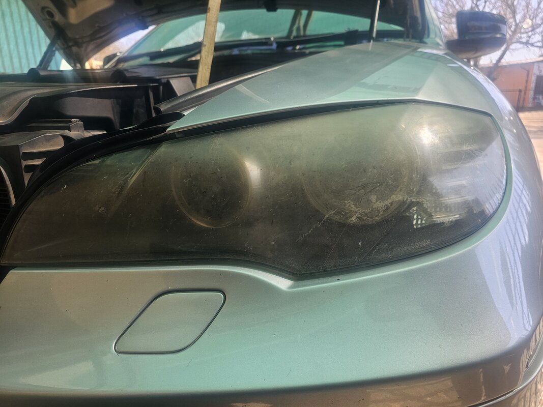

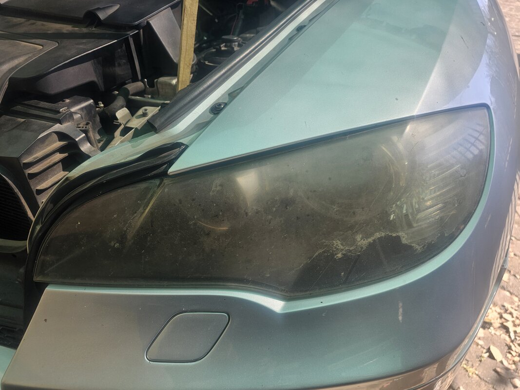

When we got the car it had this laminex or whatever sticked onto the headlights, they looked bad , i need replace the lenses soon as they have small cracks . So have tried this kit in the meantime and it worked quite well. 20260705_111517.jpg20260705_111519.jpg20260705_111541.jpg20260705_112131.jpg20260705_114940.jpg
