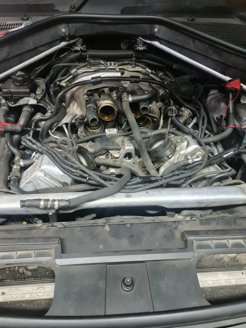

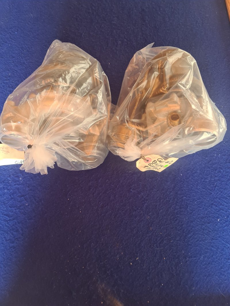

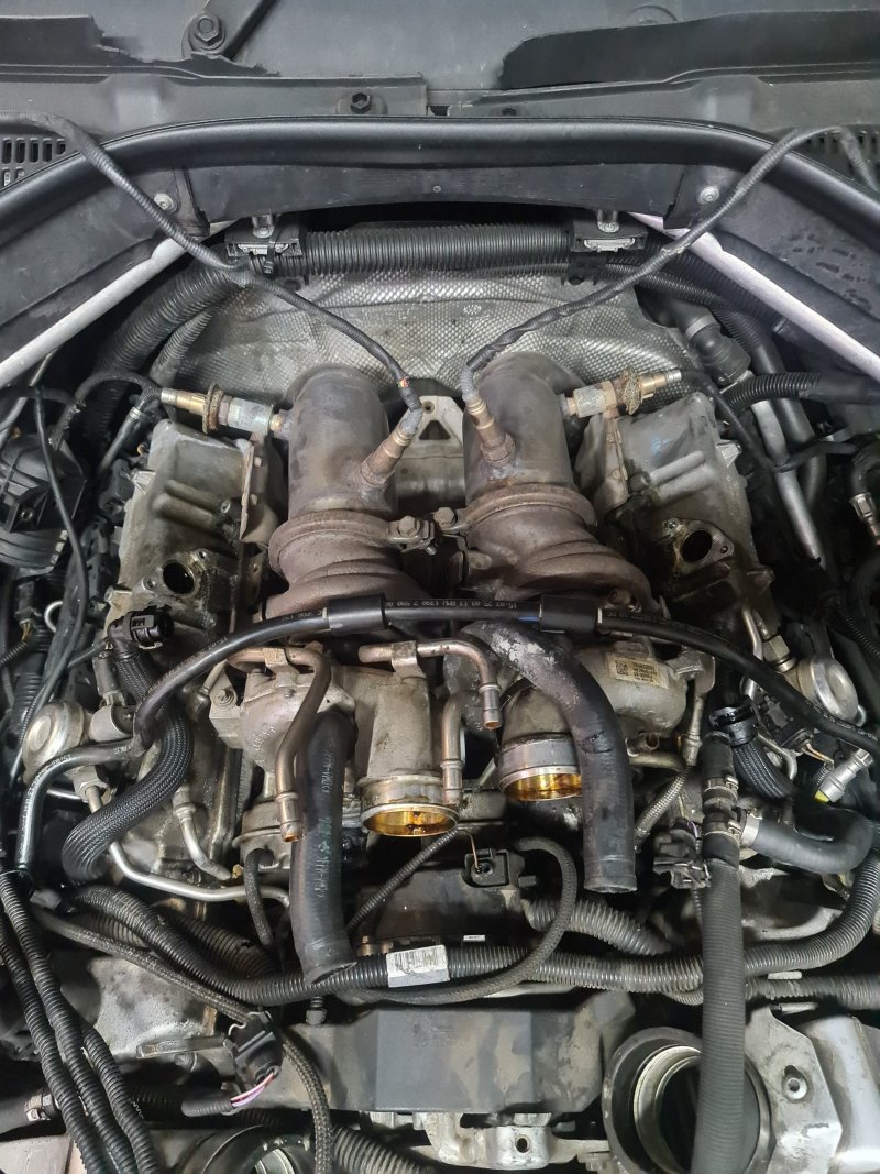

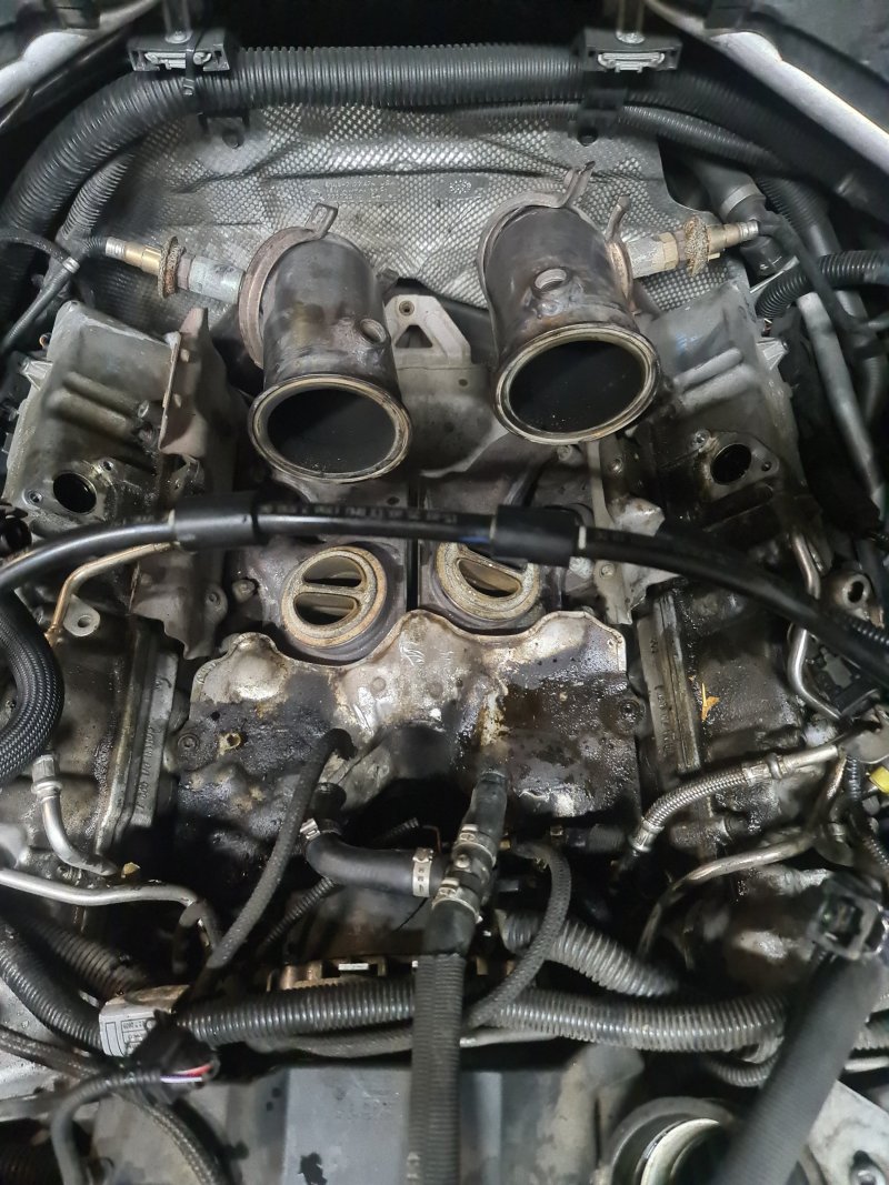

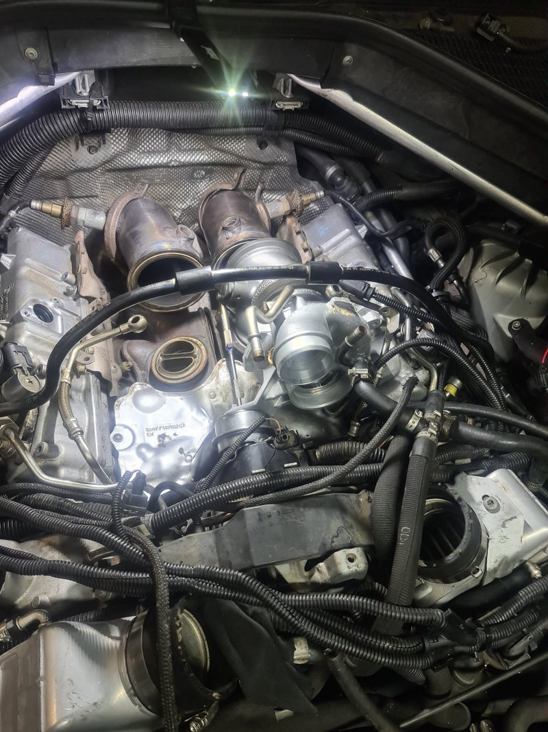

So first off we had a smoking issue but only on long idle. With past experience in smoking engines all pointed out to me that it has to be the turbo's. So did some homework firstly at agents for new units to have a base. One Unit was a tad over 52K. So searched the net to find out that the oem unots is built by Garret, Phoned their suppliers and Quoted me just below 20K a unit. By searching this forum and advice from fellow fanatics i have taken off the units and sent them to Gabby from Fastec. Both complete cores were replaced with OEM units, together with the Shaft repairs on Exhuast housing side and both cost me less than one new unit from Garret Suppliers.
Below some pics when removing the turbo's
20220818_103248.jpg12490-04d91a5faac16aeaf6781f1040fdb22f.jpg12493-a28f8e0911155704b8fa58b468c26777.jpg20221003_183414.jpg
Gordvisr
All seals and gasket were bought from agents, while awaiting the "new" units. I have used Real OEM site to know which gaskets to get.20221020_145937.jpg

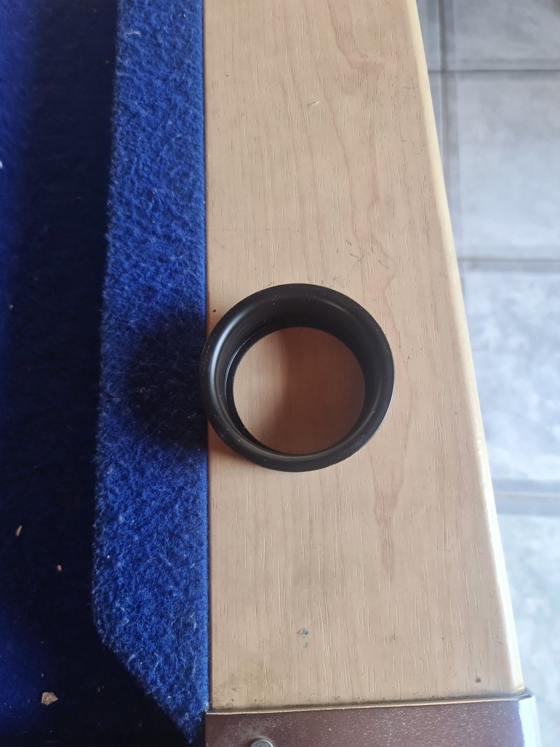

What i found also and this could be a turbo killer of sorts , below is a pic of one of the old rubber seals connecting the air intake tube to the intake of the turbo, these seals goes hard and shrink and then does not seal properly whoch can lead to failure of turbo's

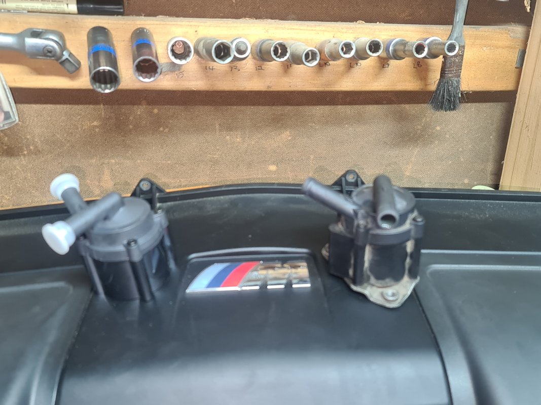

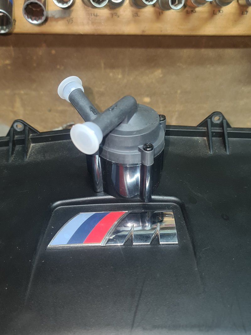

At times there was a strange sound coming from the engine bay that was not easy to trace as when trying to find out where it comes from it went away. So last week after the daily school trip the sound was back but this time more horrible. Traced it back to the turbo Auxilary cooling pump. Had it replaced with a new unit. The shaft had play and the sound was because of the impellor rubbing on the casing.
