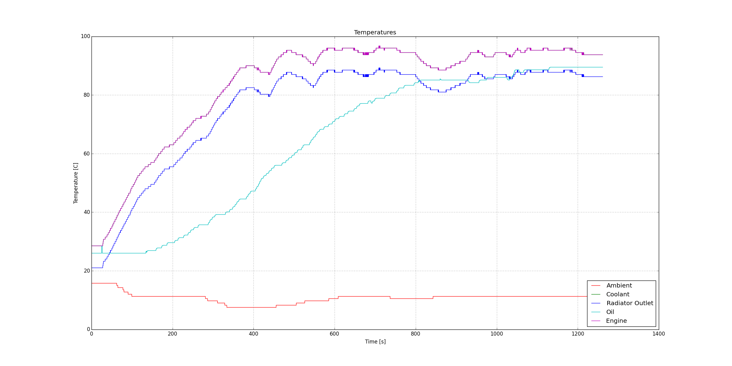

Hi Guys,
I have a E92 325i with N52 engine. I've never had an oil temperature gauge before so I have no reference, but it feels as if the oil should be getting up to temperature a little bit faster (see graph below). I've thought that it could be a sticky/stuck open thermostat but I am not getting any codes. I also don't have a long enough commute to see big drops in coolant temperature when I am on the open road.
Any thoughts? How quickly should my oil get up to the 90-95°C mark? I am using Shell Helix Ultra 5-40W.
Thanks!
