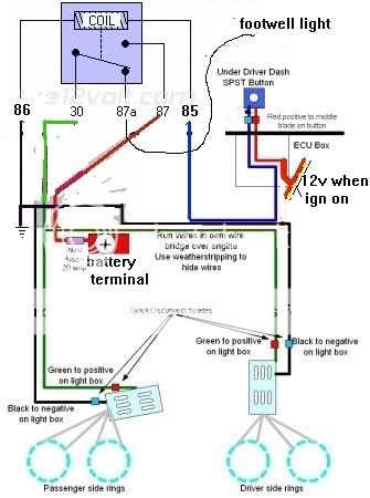

no you see, once you open the door, your auxiliary circuit becomes active for about 20mins, so as long as you have tapped into your aux, then they dont go off immediately, they will also stay on for a while once you lock your car, as the aux circuit stays active for that 20mins odd
