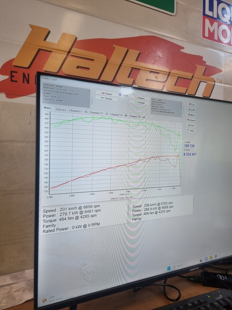

For the past 4 tanks, I've been running Liqui Moly Octane Plus (supposedly 99 RON if mixed with 50l of 95 pump fuel). I was interested to see if there was actually any difference so I took the car to Ian's Auto Clinic for some dyno runs and logging. This is the same dyno (Hyper Power Dyno) I used previously.
Car made 279.7 wkW and 464 wNm
The shop had just finished up on a hybrid N55 M2, which made 220 wkW stock on the same dyno.

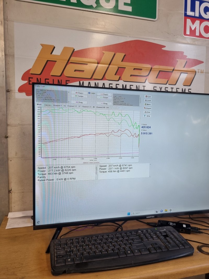

Previous pump fuel only run for reference:
Granted the sensors on the dyno were starting to fail when I did these runs (these have been replaced now hence the smooth graph), you can see how the OB doesn't necessarily make more power but rather more consistent power. Safe to say I'm happy with the results.
Regarding the effect OB has on plugs etc, I'll have to wait and see. Will check tomorrow and report back. But for now, I plan to run the OB on every tank and throw in some Liqui Moly Pro-Line Fuel System Cleaner every now and then.

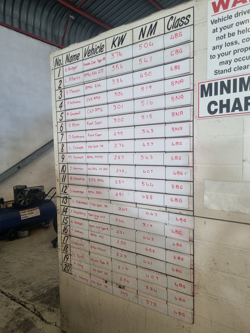

Old Leader Board:
Happy to report that the logs (ignition, fuel, delivery, requests, motor specific torque limiter etc) look great too! Nothing out of order and the car is behaving as expected from an OTS Stage 1 tune. There is a little room for improvement to refine the graph but I'm not too concerned at the moment with the car running stock hardware. Possibly custom tune if I go down the headers + middle box route.

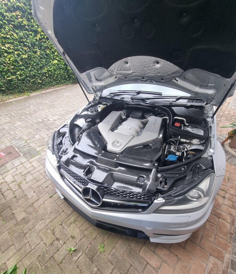

Over the weekend, with the help of a friend, we managed to install the carbon fiber "snorkels" for the intake. Fitment of this unit was okay but required some drilling and tweaking. I must say that it was quite rewarding working on the car and figuring out how to get the kit to work. On a side note, I never realised how sore one can get from working on a car ๐Ÿ˜‚
Took a bit of trial and error but we finally got there. The only issue is that the piping that goes into the airbox is a little too thick for the engine cover to sit flush so I'll be looking at sourcing some thinner piping to get this to work. Will also source some cap screws to replace the eye sore machine screws that came with this kit.

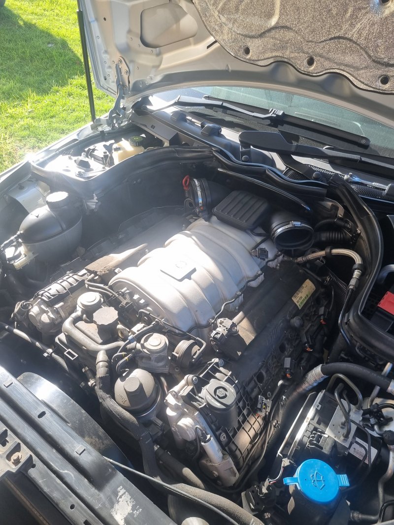

Filters in the airbox still look new (replaced in June 2023). These are OEM filters but will look at replacing them with some BMC filters later this year.
While the airbox was off, we decided to take a look at the the spark plugs as well.
Bearing in mind that these were replaced in June last year, they don't look too bad (to my eyes at least - please chime in for us novices ๐Ÿ™) There is a significant deposit of orange particles (I'm assuming it is from the MMT in the octane booster) but besides that there were no cracks on the porcelain or signs of damage on all eight spark plugs. Will replace these plugs in about 5 000 kms.

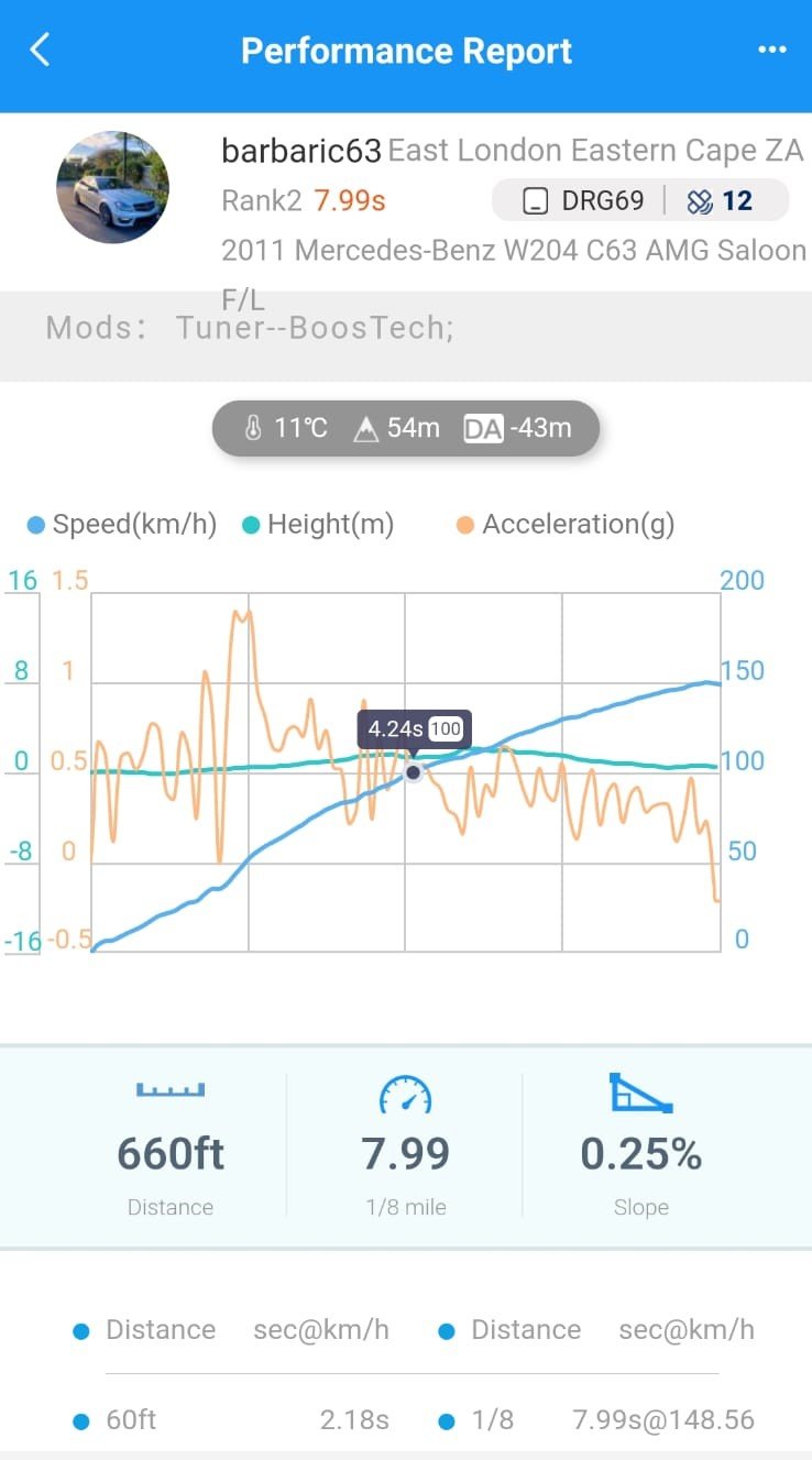

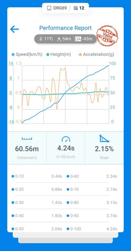

Did some Dragy runs over the past two weekends. Was quite impressed with the 0 to 100 time in particular. Even with an open differential, the power is put down quite effortlessly which pretty much goes against every W204 C63 review out there saying that these cars are undrivable.
In all honesty, I feel like the W204 C63 doesn't get the praise it deserves. Sure, it doesn't handle like an M3 but it holds its own and with some decent tyres and traction control in Sport, the power is both playful and useable. Traction off (especially with a tune) is another story though ๐Ÿ˜…
0 to 100 km/h

1/8 mile
