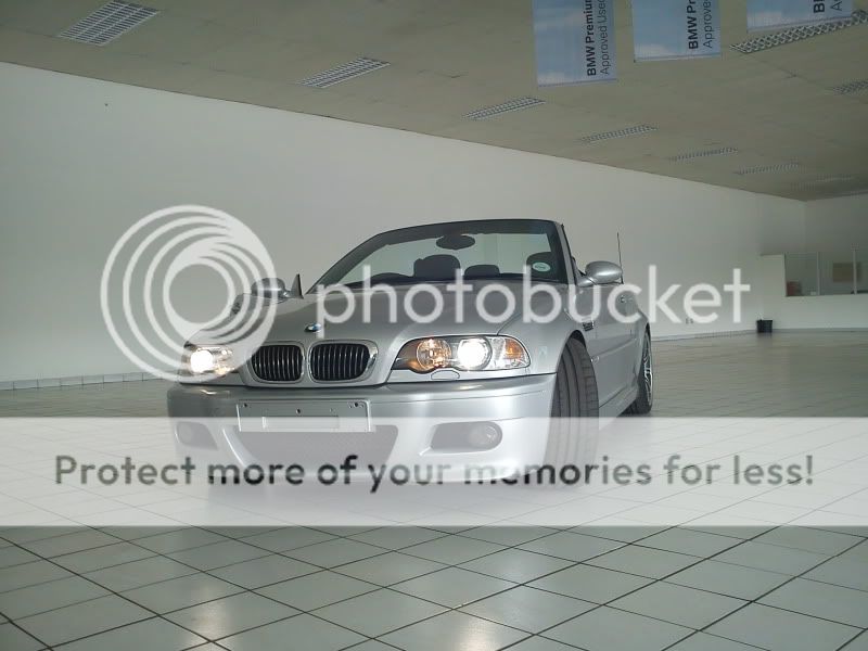

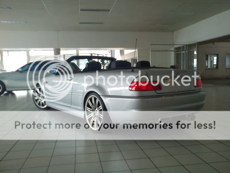

hey guys finally landed my new car, have a look, any tips and tricks please do share

That showroom looks like an ideal place for a small demo with your M......:)
Congrats....love the drop top M's especially that stock wheel, wicked :thumbsup: :thumbsup:
Matt Q
Welcome to the club - that is a super sweet ride you got yourself there :)
