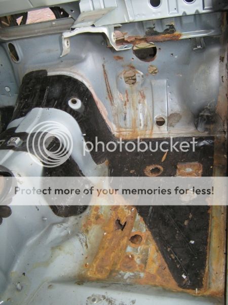

The reason I stopped on the engine is I kept finding water in the drivers footwell, and this ended up in me pulling the carpet to discover some serious rust right by the accelerator pedal. So before it gets too much worse. Planned body work mods started.
