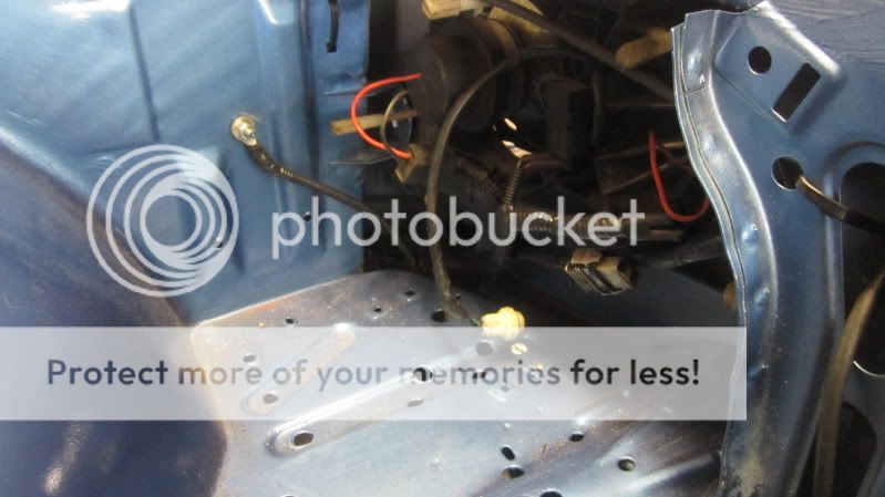

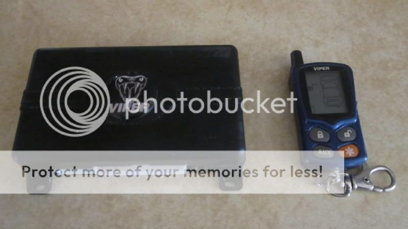

wiring that still needs to be done
viper 791xv

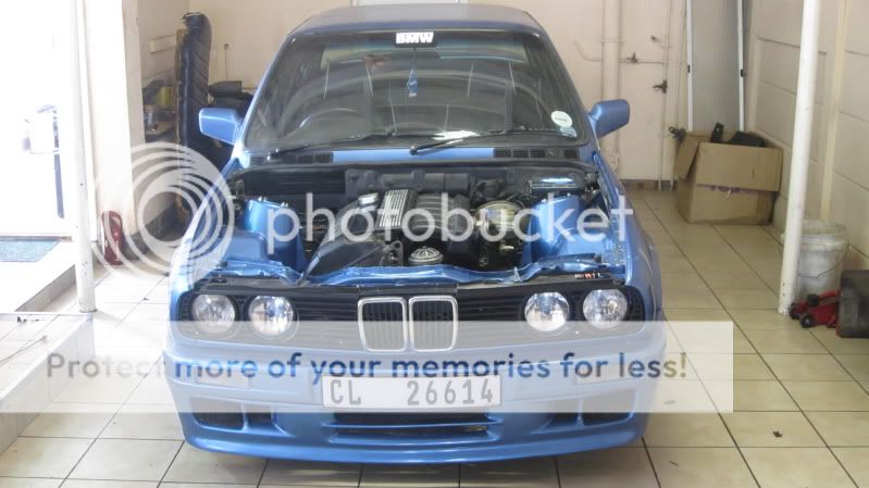

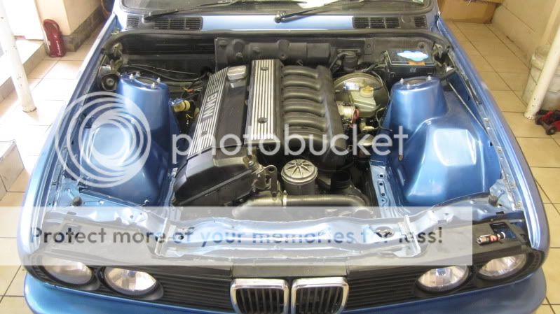

rhett325 said:

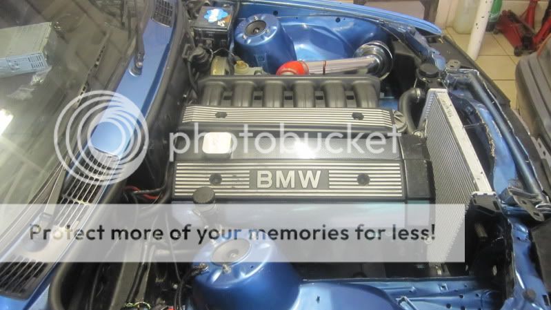

Is that the radiator placed way forward? Where you gonna put the cooler now?
Looking nice. Did you get my PM??
No, the radiator will still bolt into the stock location, there will still be place for an intercooler somewhere.

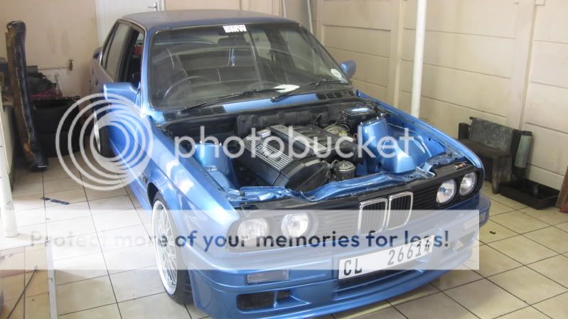

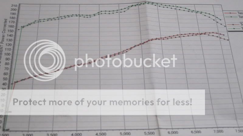

Finally finished my project!
Dyno results
148,7 kw (200hp) @7363, 214nm (158ftlbs) @5897, at the wheels.

:praise::praise::praise:
Sorry but M50 engine is that an E36 M3 engine ? Sorry for my lack of knowledge but if it is :praise: Damn this thing must fly .
Nicely finished off too , well done

nope its the E36 325i engine.

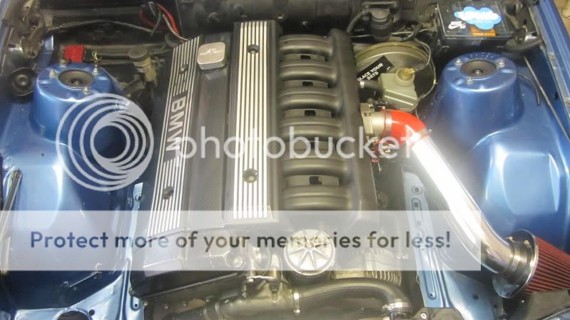

There must be a turbo lurking in there that I can't see , cause my e46 325i doesn't even make that on the engine . He's giving me hope here :rollsmile:
slowe30
haha no turbo kit hidden anywhere, not yet at least :idea: The motor has been completely rebuild and is running very strong, with 255/245 cams, a raise in compression, 7,700 redline, and really nice tune, im sure ill be able to squeeze a bit more out with larger injectors and a decent header.:thumbs:
Raybimmer
The M50 non vanos motor normally revs to 6500 , so 7700 is high !! Power is 138 Kw at flywheel at coast so about 112 Kw at wheels .
If cams , management and exhaust add another 35 to 40 Kw at wheels that is good .
What cams are you using , are they Schrick copies ? I would expect up to 280/290 degrees , but 245 etc may be good for turbo power later !!!!
Total cost of engine mods excluding motor ? ( have e360325i as donor !!!! ) :fencelook:
