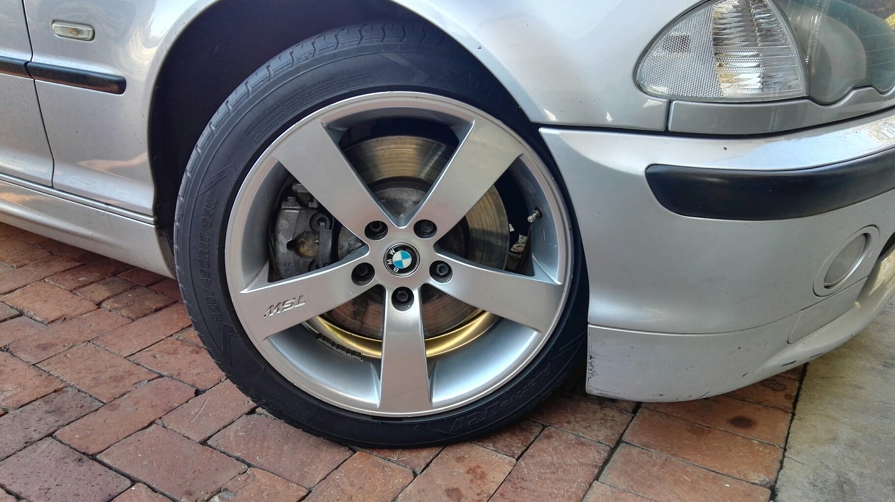

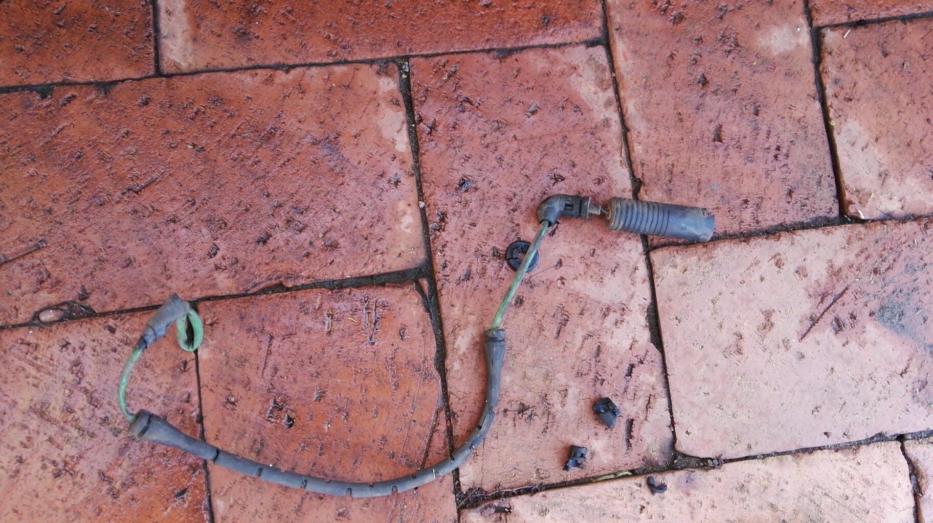

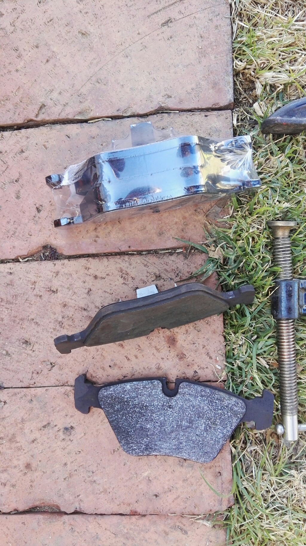

Front brake pads replaced. The previous owner /mechanic decided to cut the old brake pad wear sensor off instead of just replacing the (cheap) component.
Decided to go with Meyle HD because I have only had positive experiences with their products and associated quality. Will provide a review after a couple months.
Also did a full brake and clutch fluid flush.

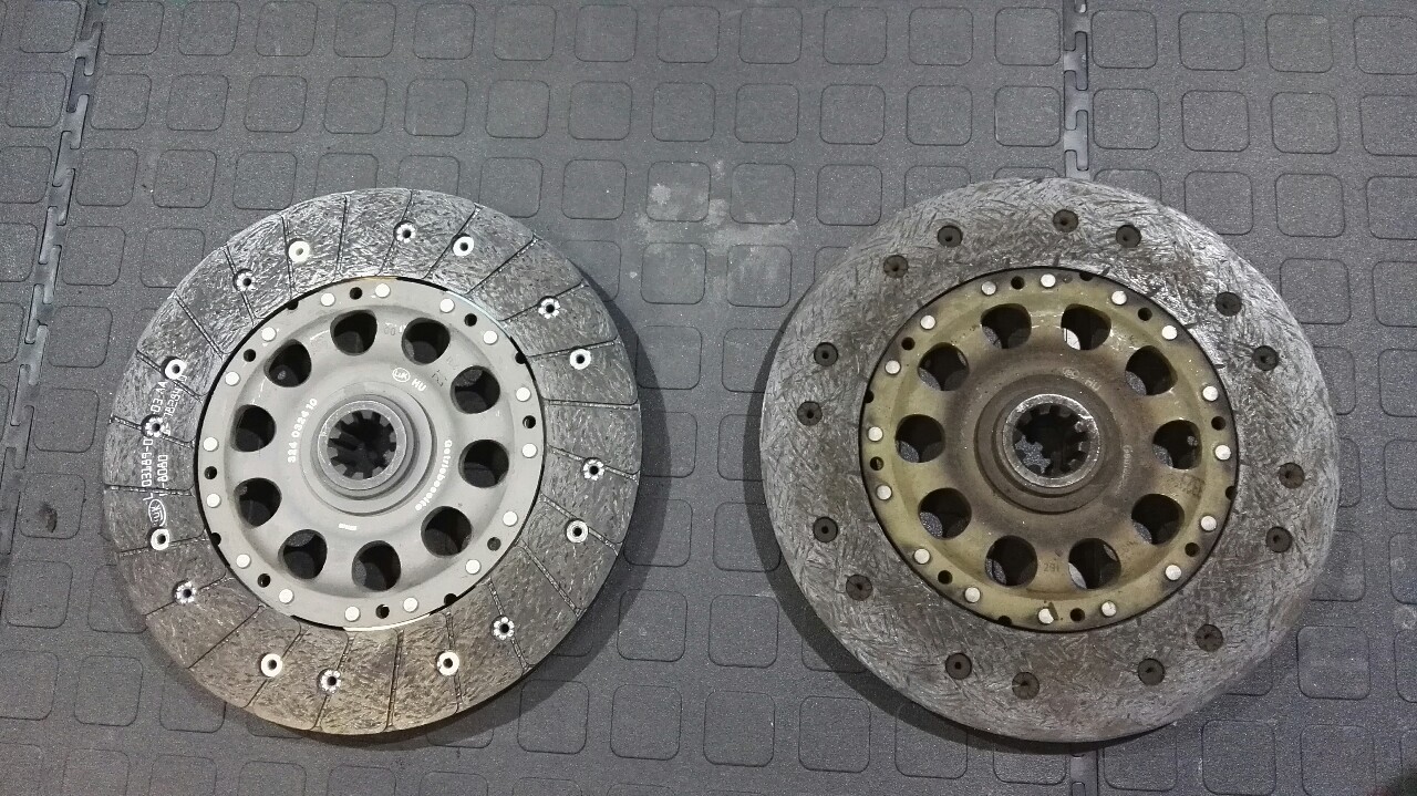

So my clutch has been slipping for at least the past 6 months, every single gear and right at around 2000RPM to 2500RPM where the max torque starts rolling in. Additionally, the dual mass flywheel has been worn out since I purchased the car owing to the infamous vibrations and shudder on take-off unless you ride the clutch at 3000RPM. So a much-needed clutch and flywheel change has been on the cards for a while now.

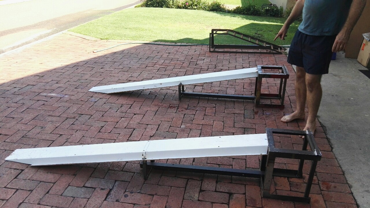

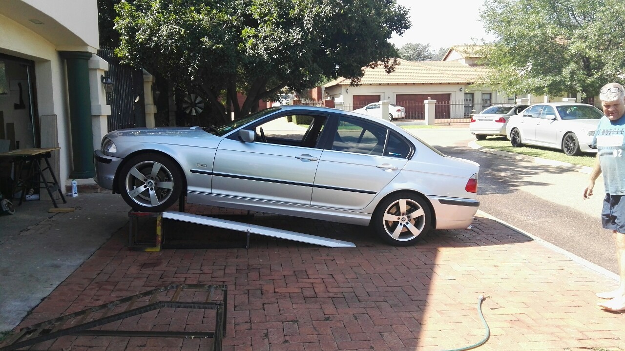

First off, here's the vehicle ramps I built with some of the stuff I had lying around.

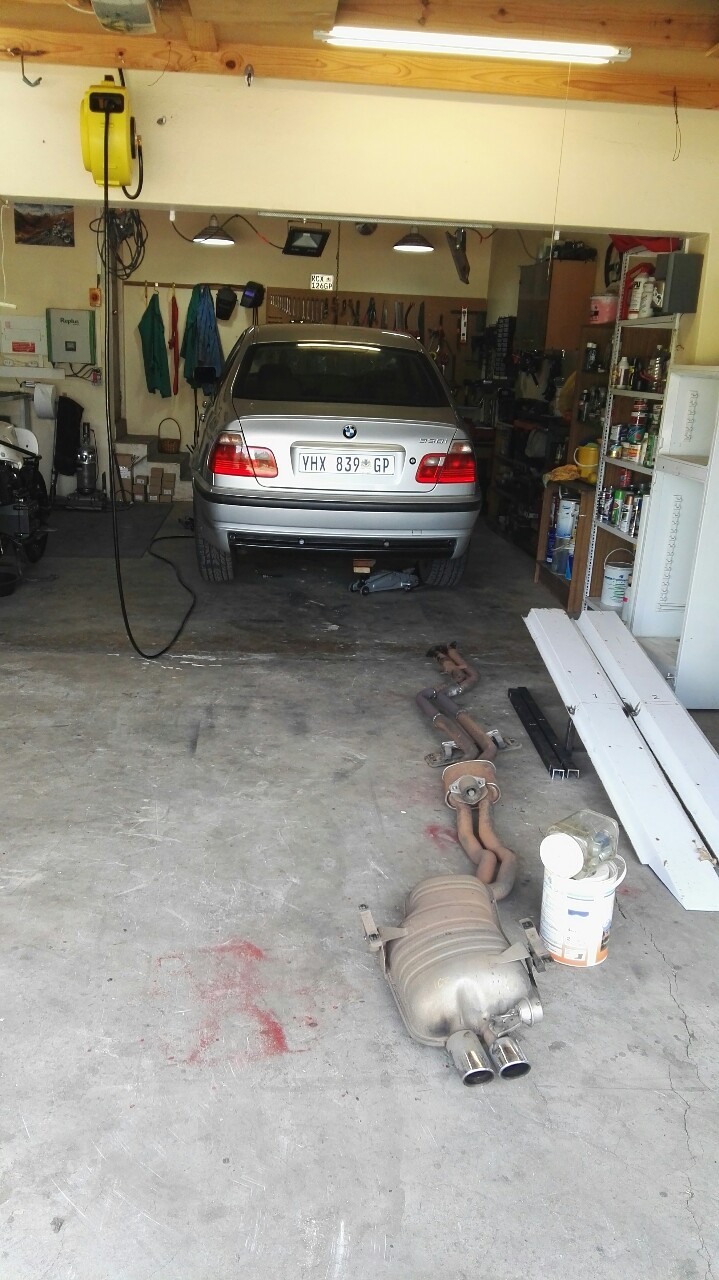

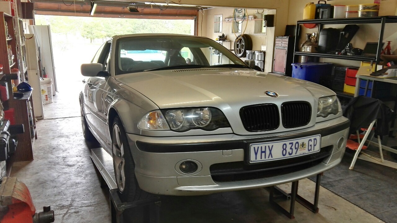

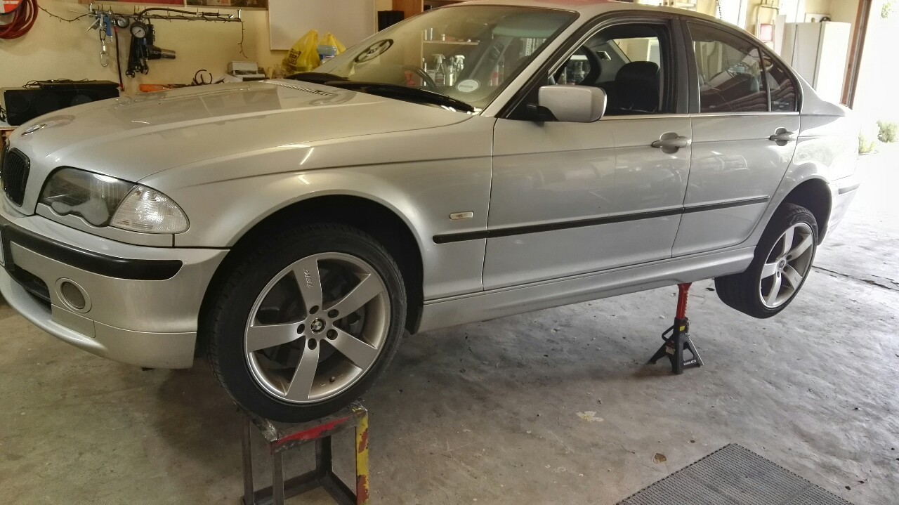

And finally in the garage with the rear jacked up and on axle stands:

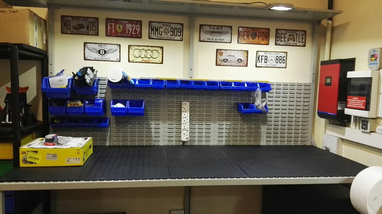

Here's the workbench all cleared up:

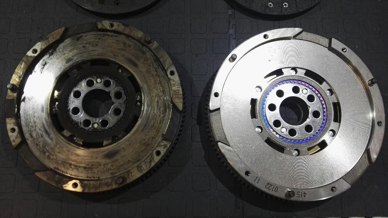

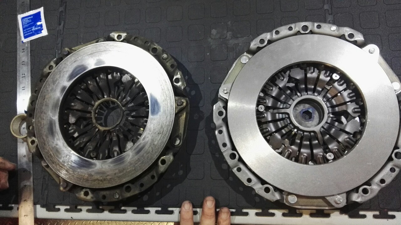

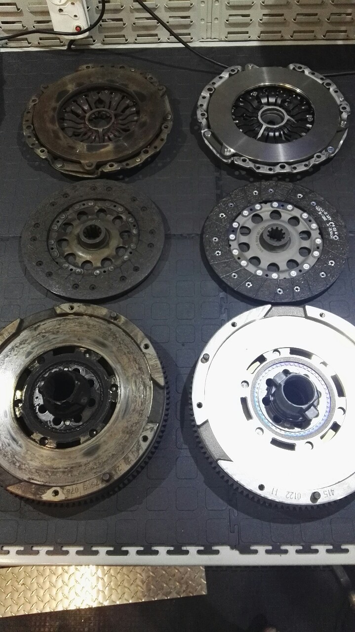

The new OEM clutch (Self-Adjusting) and flywheel (Dual-Mass):

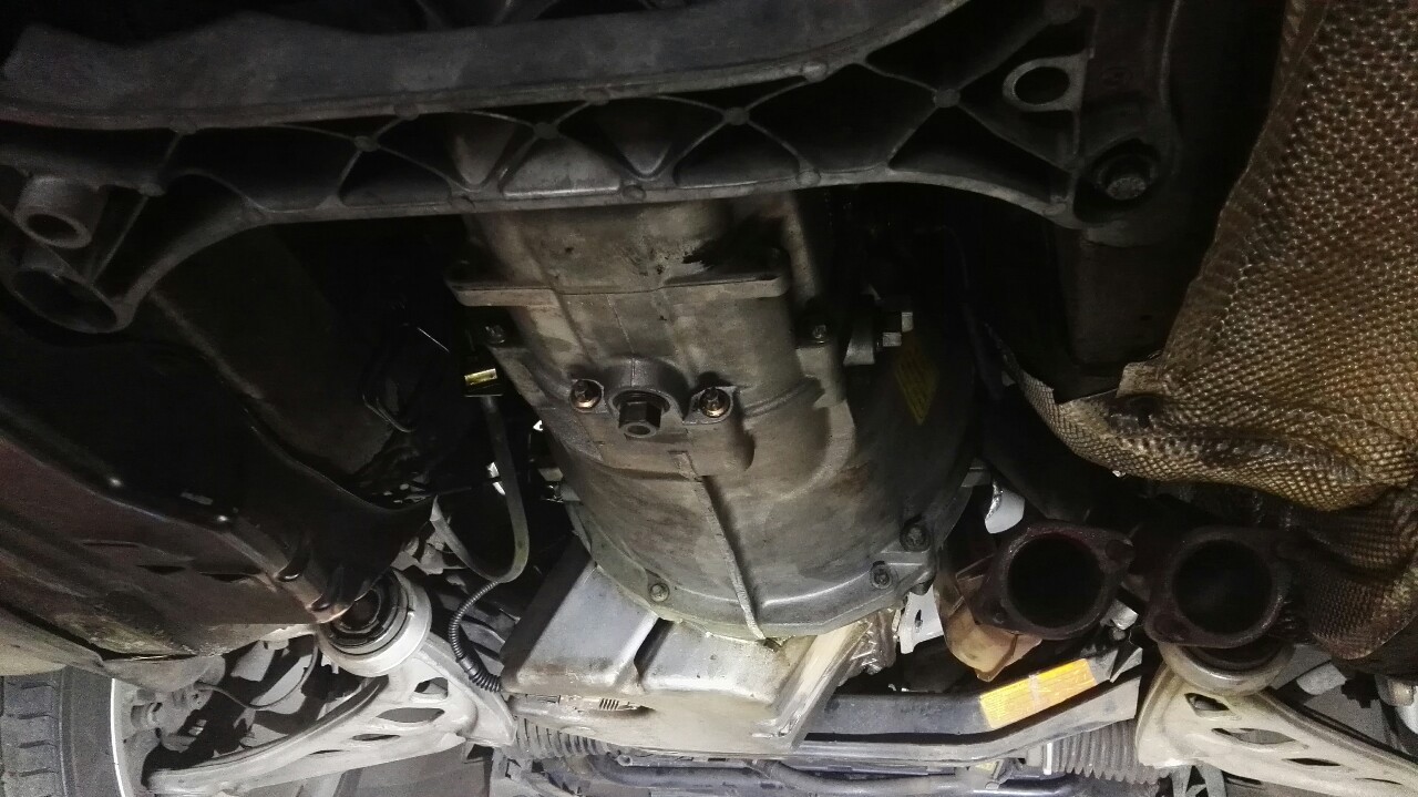

So exhaust out, prop-shaft and centre bearing disconnected, and onto the transmission removal!

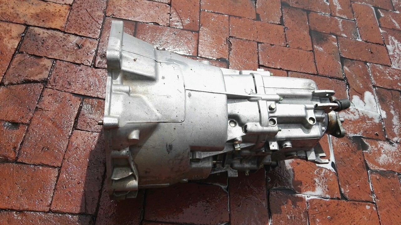

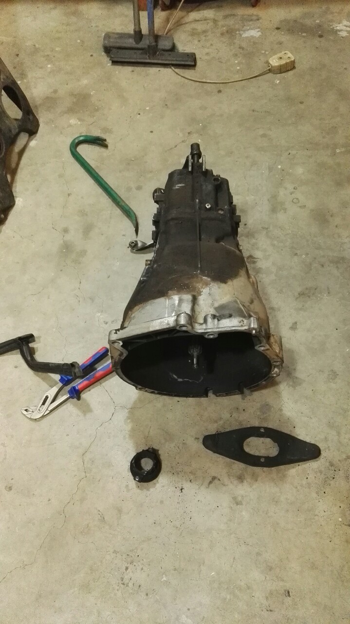

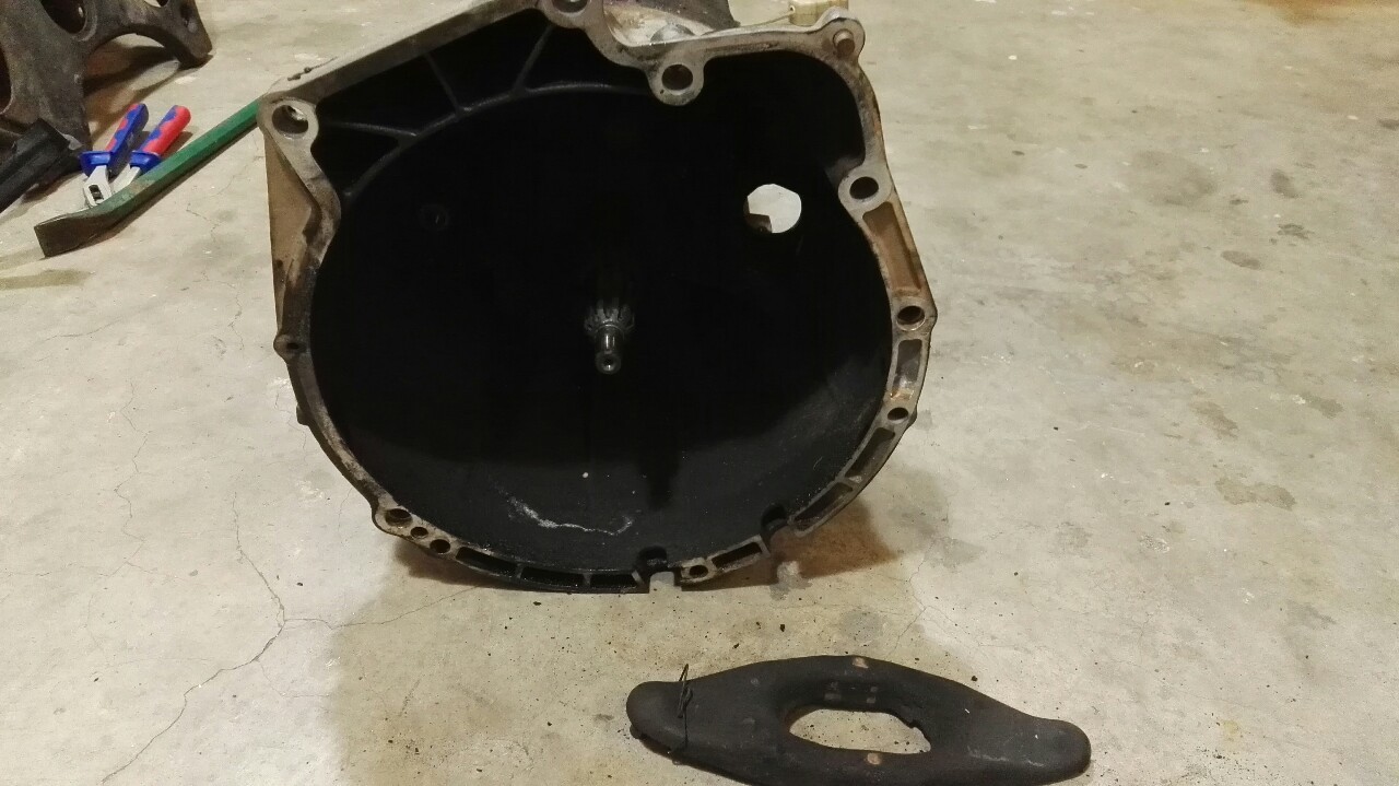

Transmission out:

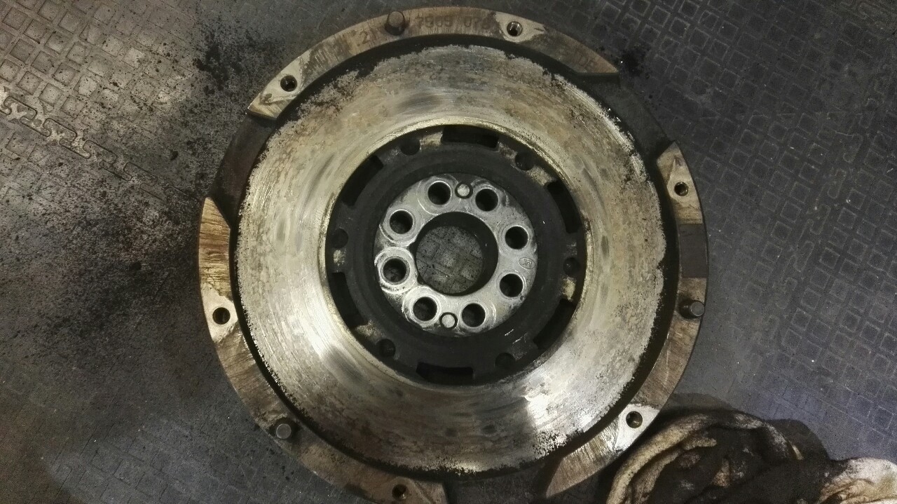

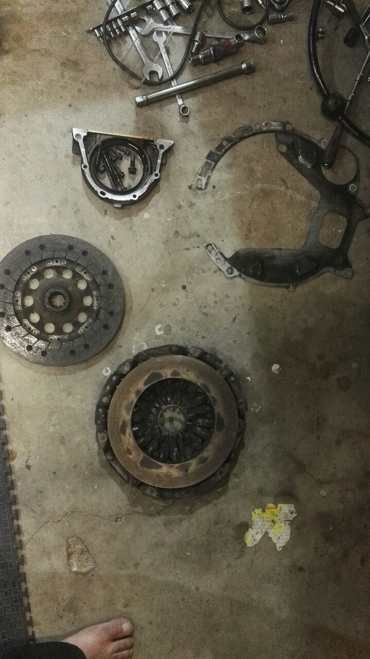

Clutch and flywheel out:

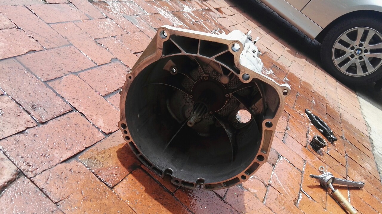

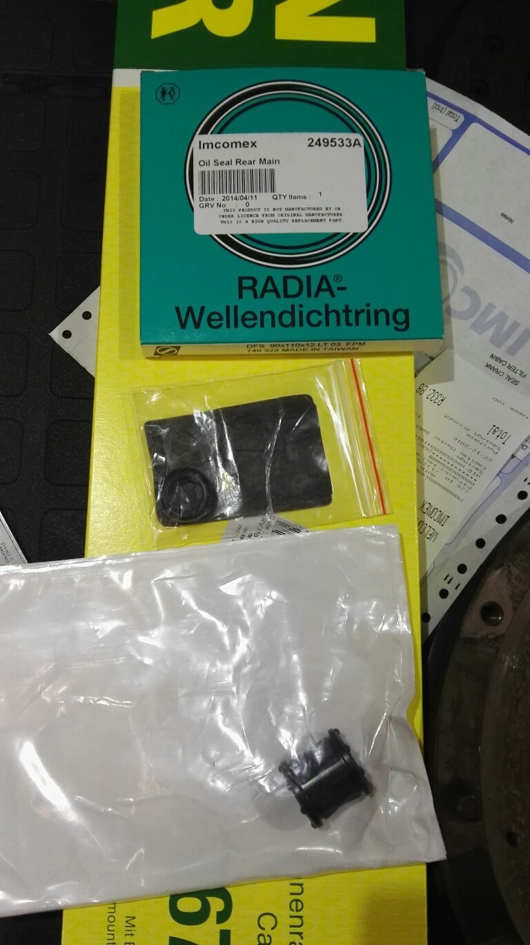

So rear main seal and gasket have been replaced (got the parts from Imcomex). In the picture below you can see the selector rod seal, shifter bushing and a new cabin air filter:=):

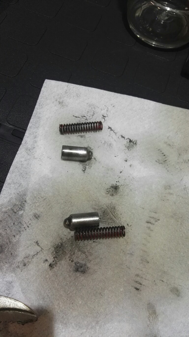

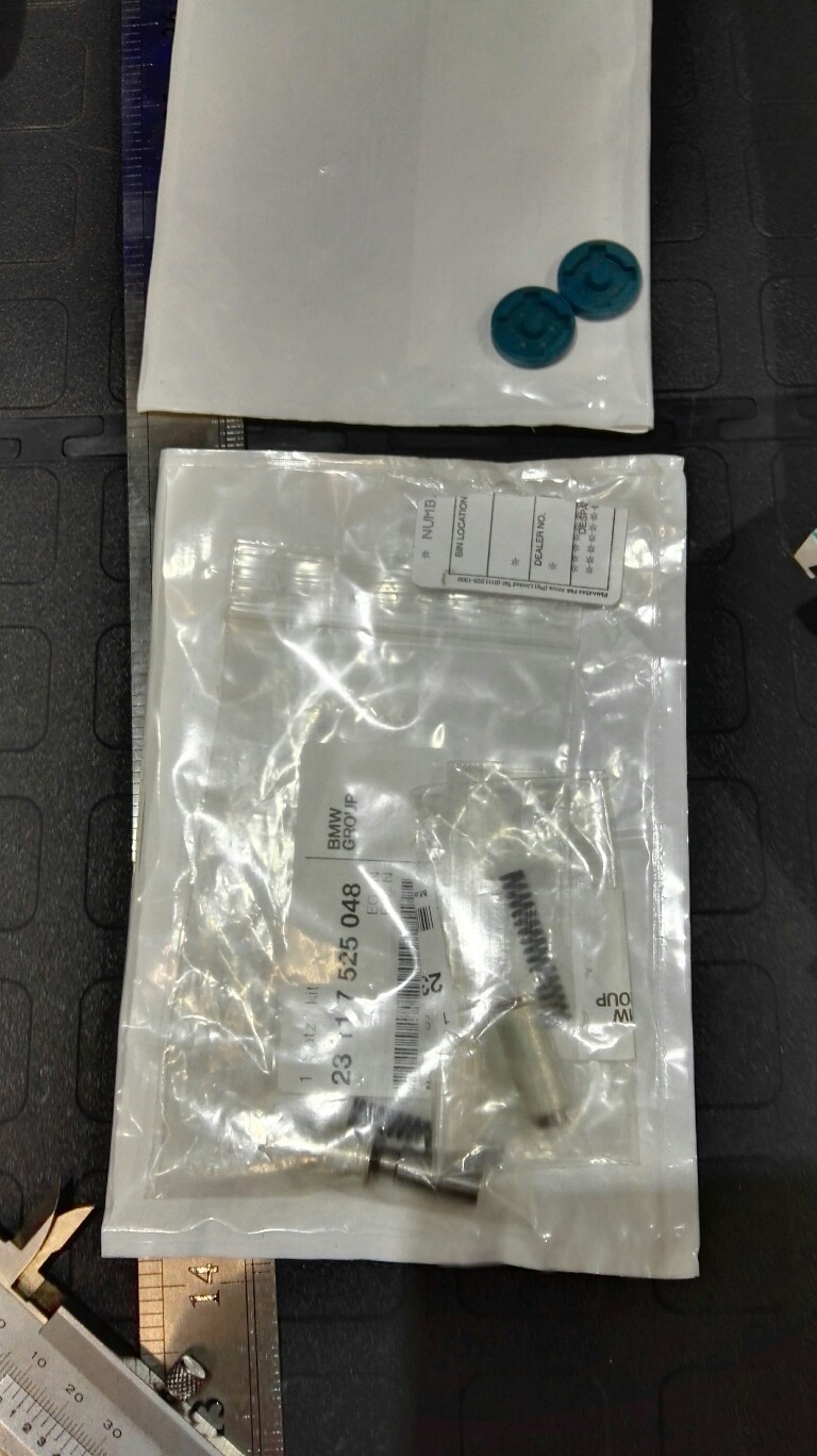

Here are the revised detent pins for the transmission:
And two of them that I removed:

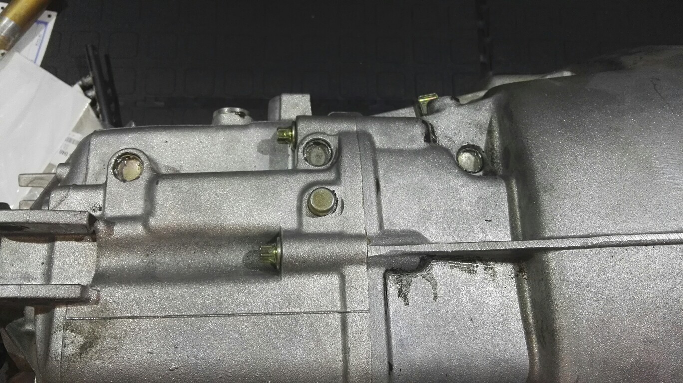

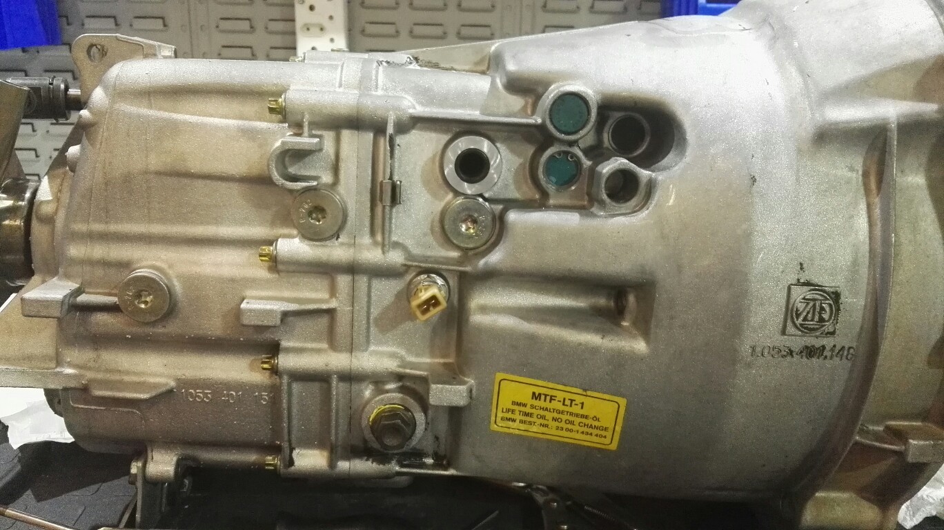

We also tackled the 5th gear and reverse plane pin components. We removed the pistons and then honed the bushing surface with some fine sandpaper while in the gearbox. The process is explained and detailed here: http://www.unofficialbmw.com/phpBB/viewtopic.php?t=33179
Another good DIY: http://webspace.ringling.edu/~dplassma/bmw_diy/shift_pins/shift_pins.html

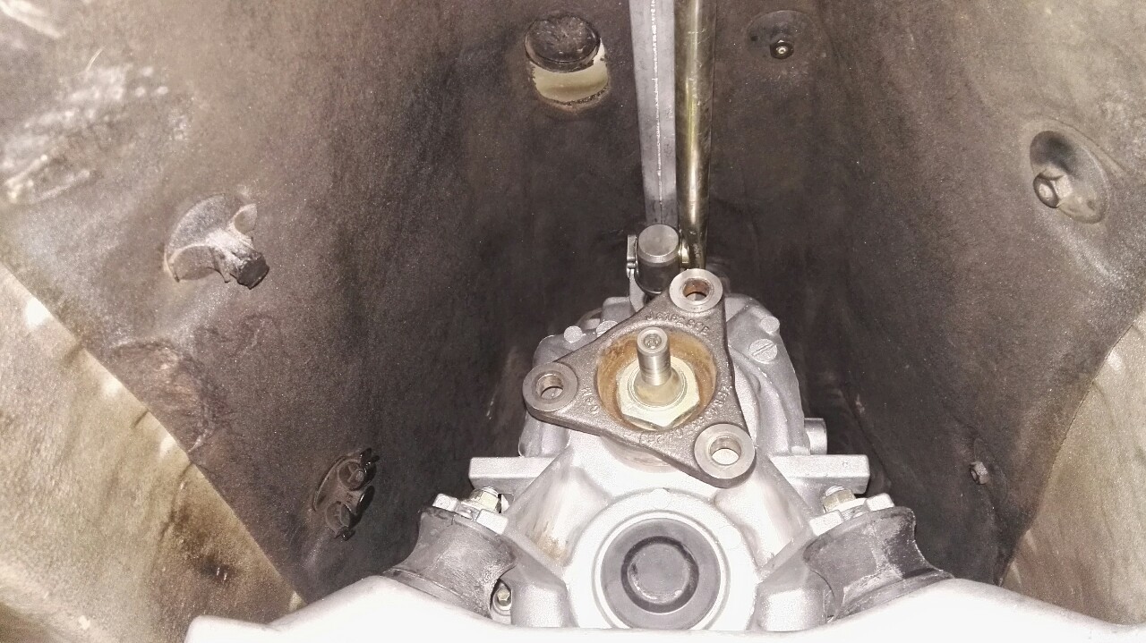

Below you can see the caps retaining the detent pin sets and then followed by the side of the transmission which house the 5th and reverse plane piston sets:

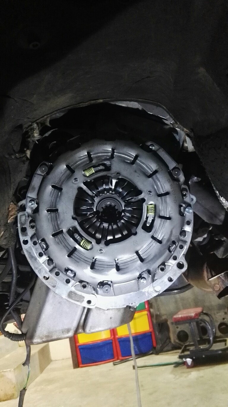

Now, finally a pic of the flywheel and clutch installed:
Some last photos of all the reassembly:
First test drive review: The result in the shifter is incredible. There is a lot less play in the shifter, there is no more hard notchiness and reverse is a lot easier to engage now! The 5th gear plane spring action is working perfectly and the entire shifting experience feels superb. The vibration, flywheel chatter and shudder on take off has completely vanished with the new DMF and no more slipping of the clutch in the torque band. Take-off is now smooth, quiet and effortless.
