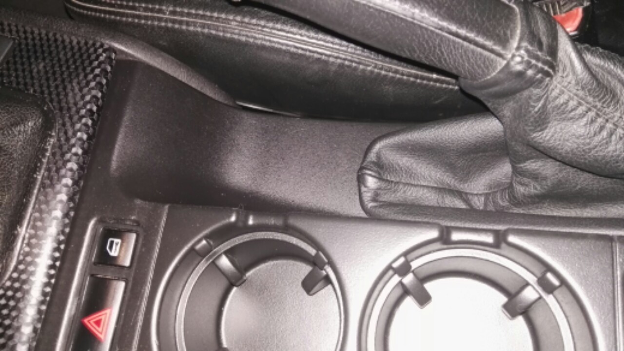

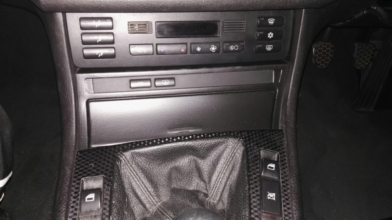

Have plastidipped center console and ashtray console. Very impressed with the results. Looks like new!
Pictures to follow

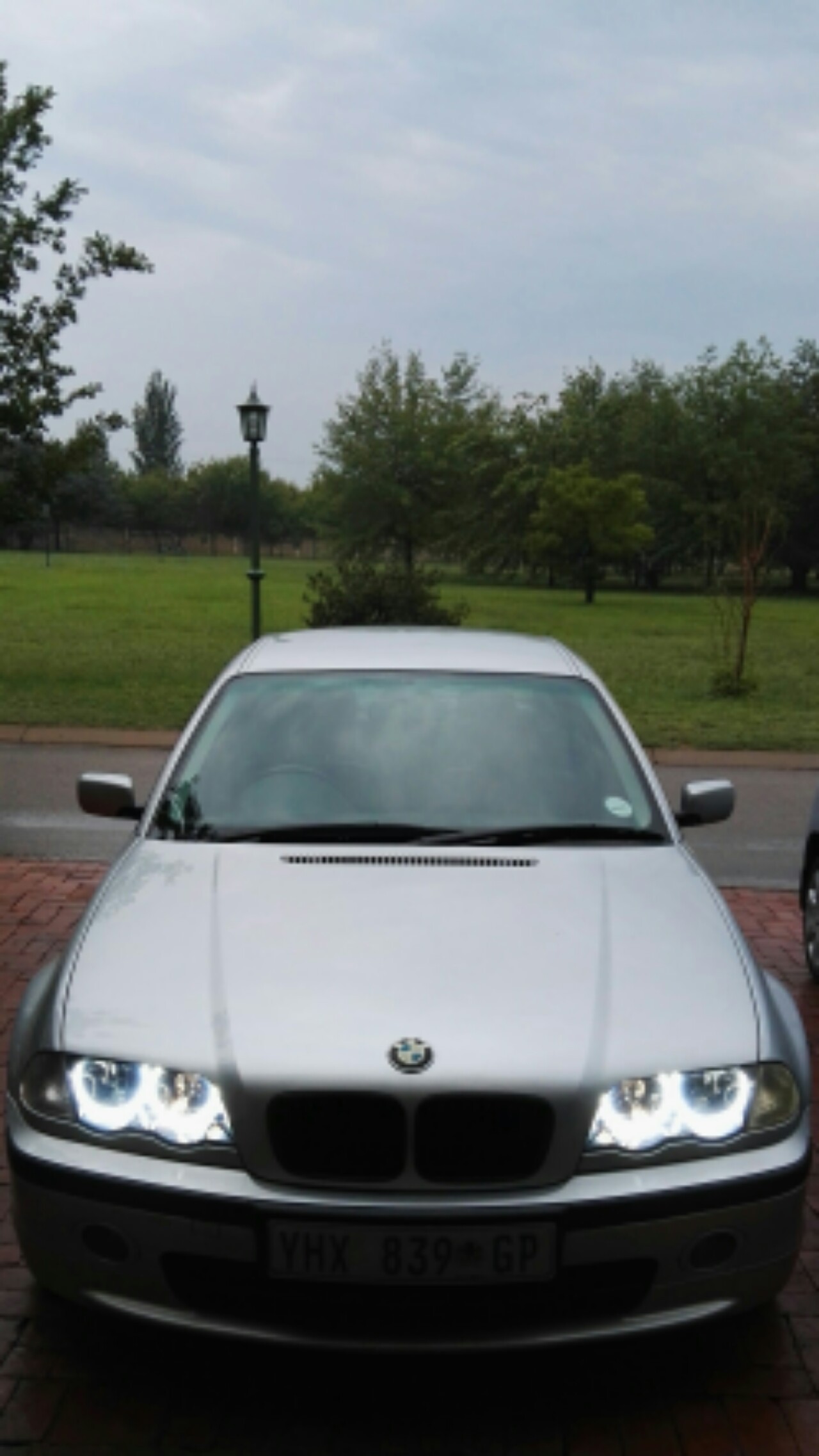

And another picture of the angel eyes :rollsmile:

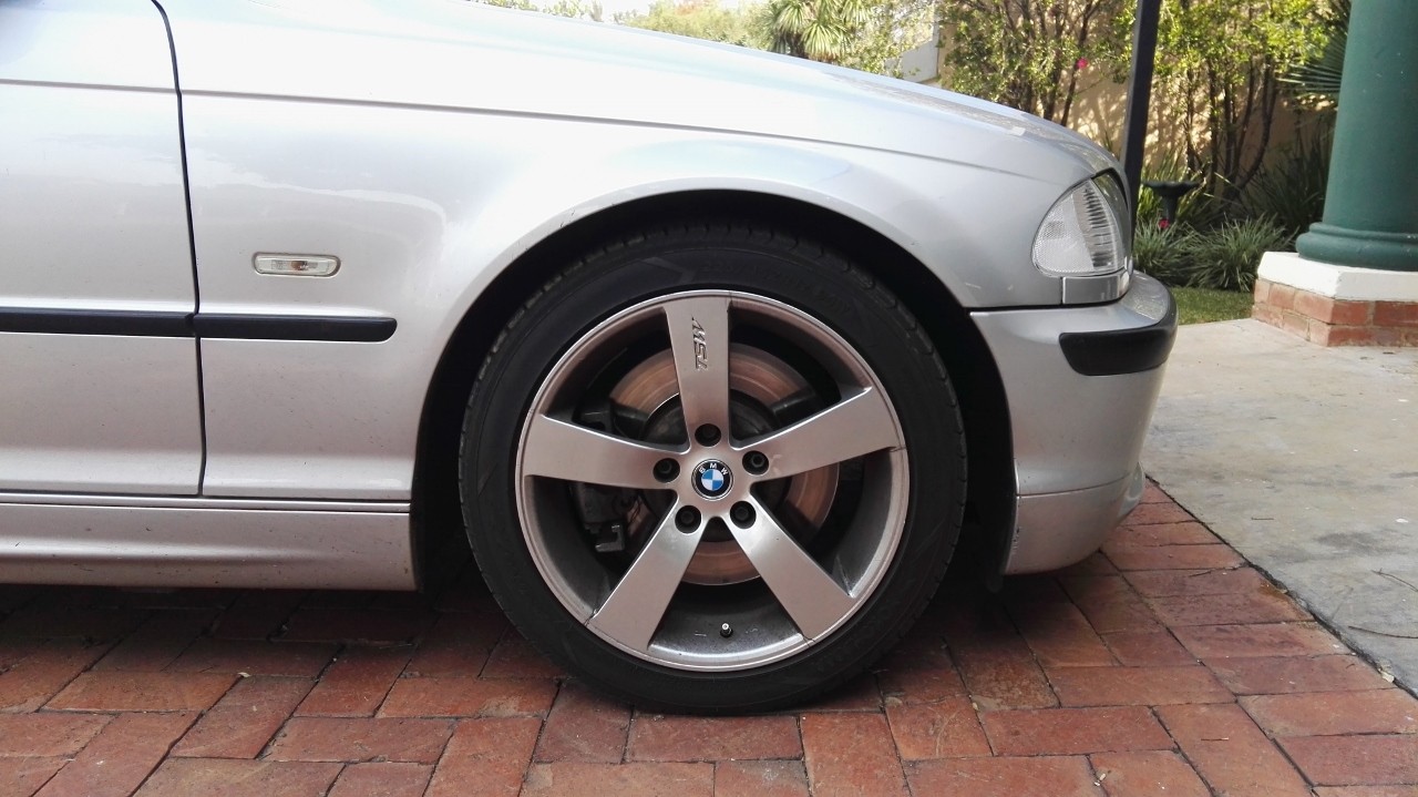

So car has new clear indicators, new bonnet emblem and my wheels have new BMW stickers (Custom 45mm order)
Sorry, car is filthy, but stickers!
