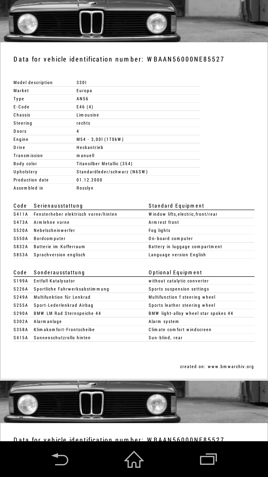

With regards to my VIN printout, it says that my car came without Catalytic converters. Could someone please verify what this exactly implies. Does my car only have resonators then and does it imply that my branches do not have cats in them or the entire exhaust system is Cat free?
I haven't done a thorough visual inspection but I'm certain my car had some cat-like looking things in the main section.
Any thoughts?
