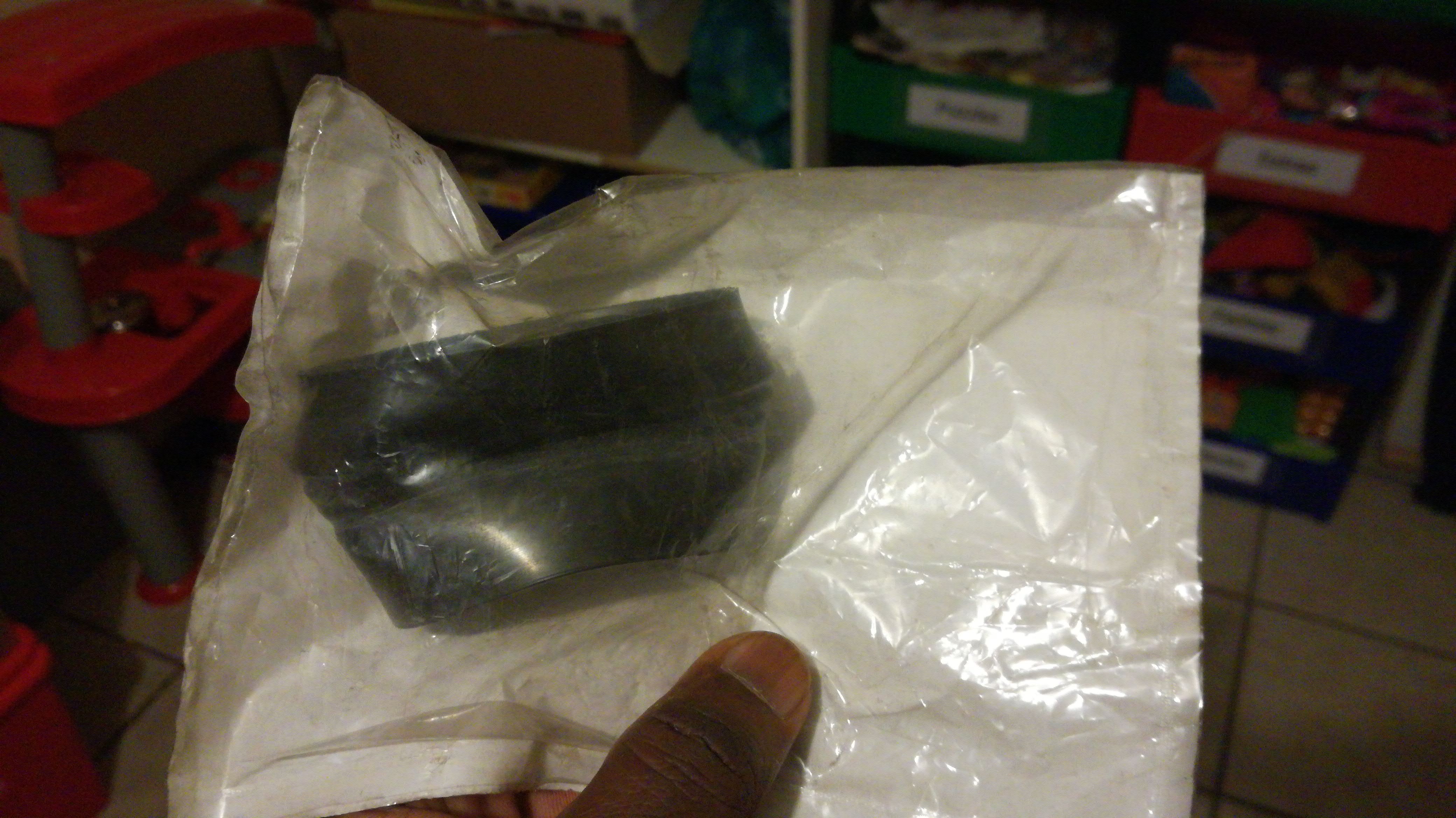

Have to say, the meyle part supplied felt more durable, thicker than the OEM, but I felt no.difference. I felt an annoying knock on the suspension every.now and then which I cant seem to pin point, I have changed everything except the shocks, springs and steering rack. At the last suspension check,I was told my powerflex bushes and other parts that were changed are worn, yet there's not enough movement to substantiate that, or could they replicate the noise and isolate it to a specific part.

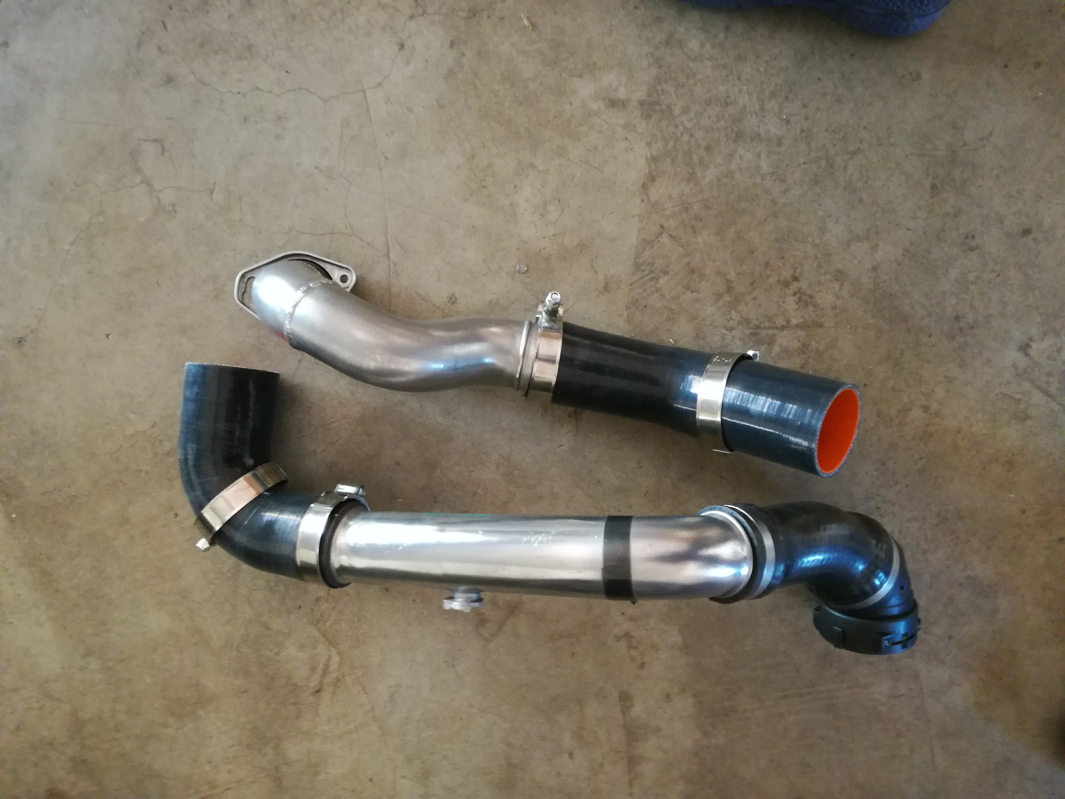

The next thing that was annoying the hell out of me was the boost leak, even after changing the intercooler and putting new OEM seals.... here you can see almost half the seal was split. Thanks to Danny for finding this as I had previously inspected and didn't notice the seal was split.
Sent from my HUAWEI VNS-L31 using Tapatalk
So new seal in thinking all is this.good, I check again after a few weeks and the drip tray has a wet spot.....
Took even longer to find the time to strip again but when I did find the seal split again.
This time I took note of the wear on the clip, the other.side clip does not have this wear and is not leaking.
Thinking I could order a new clip I called BMW, only to be told, clip is not sold separately, only with the pipe....At 6500ex vat.... WTF.
Chatted on the group's, got.some suggestions but eventually Jerry from Leo haese organised some clips, but unfortunately, they don't fit. The e60 uses a different design. Even the part number I find it for the other side of the pipe and it won't work.
So I am still looking for a replacement clip

The clip I need is straight on the sides. At this point, I found a replacement pipe on eBay that comes with the clip, which I.might order if I don't come right soon.

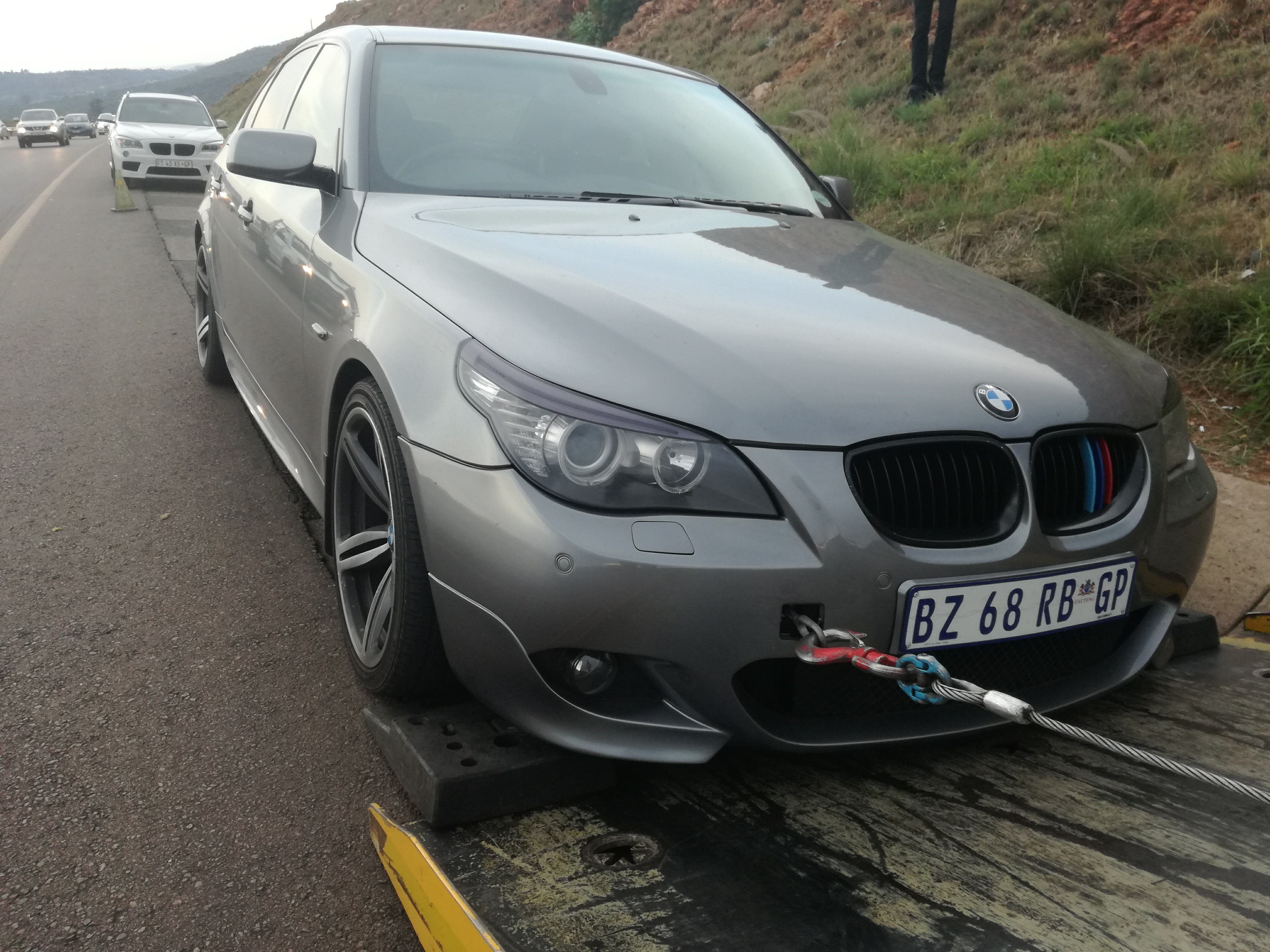

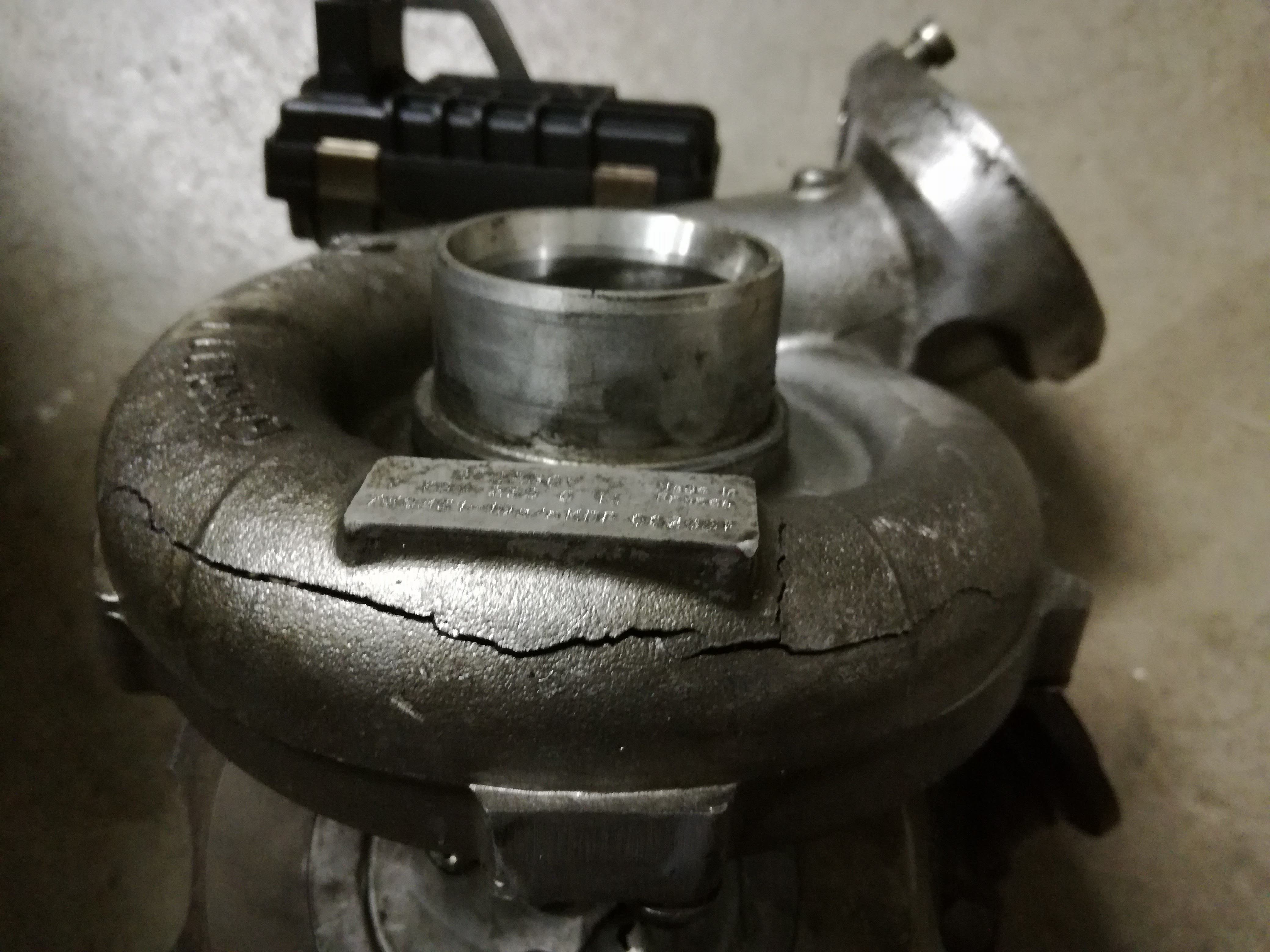

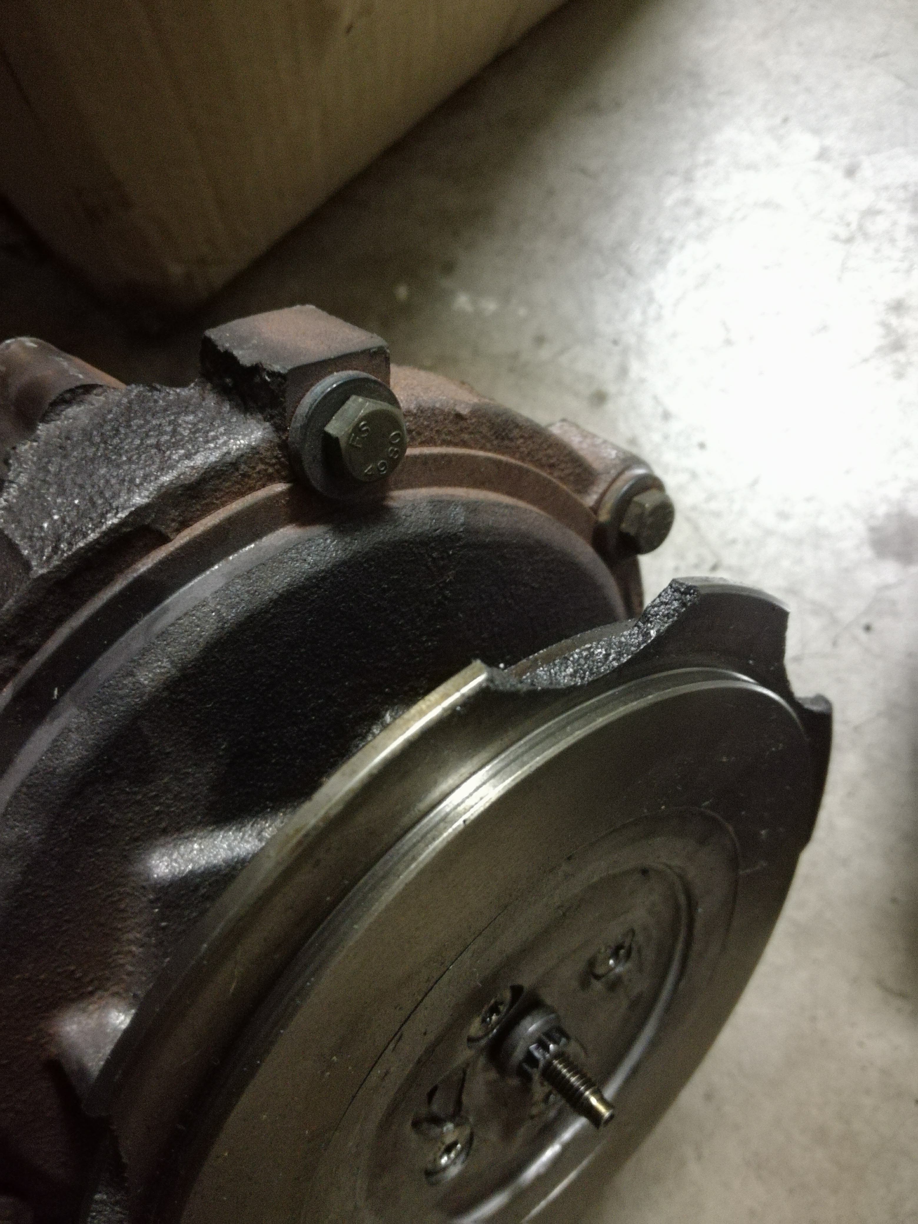

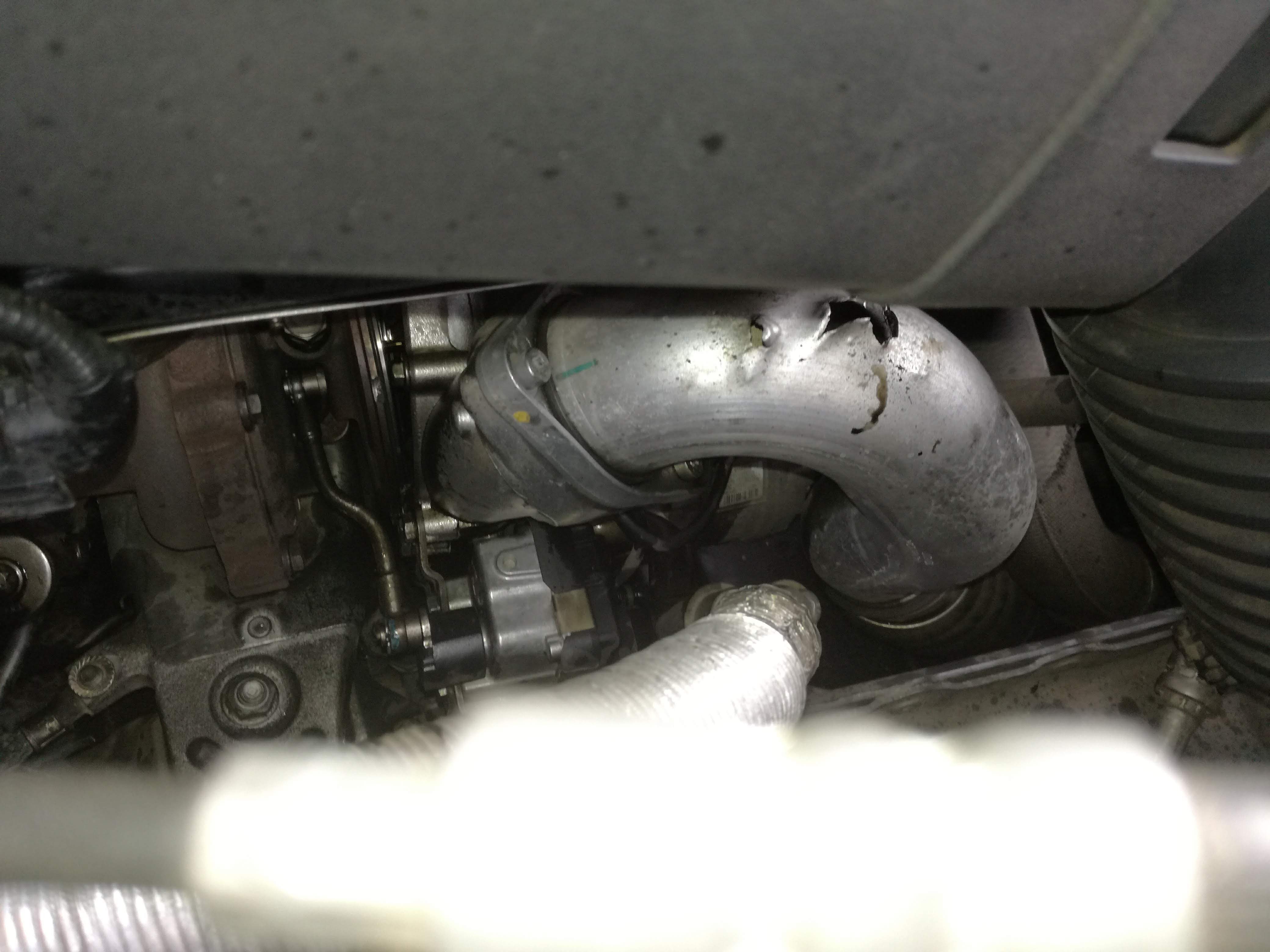

It hasn't been that long since this thread was updated, but it feels like ages and like so much has happened. Many already know but on the 31 October 2018 my turbo was laid to rest..... in pieces.... in my intercooler.... and out of the boost pipe

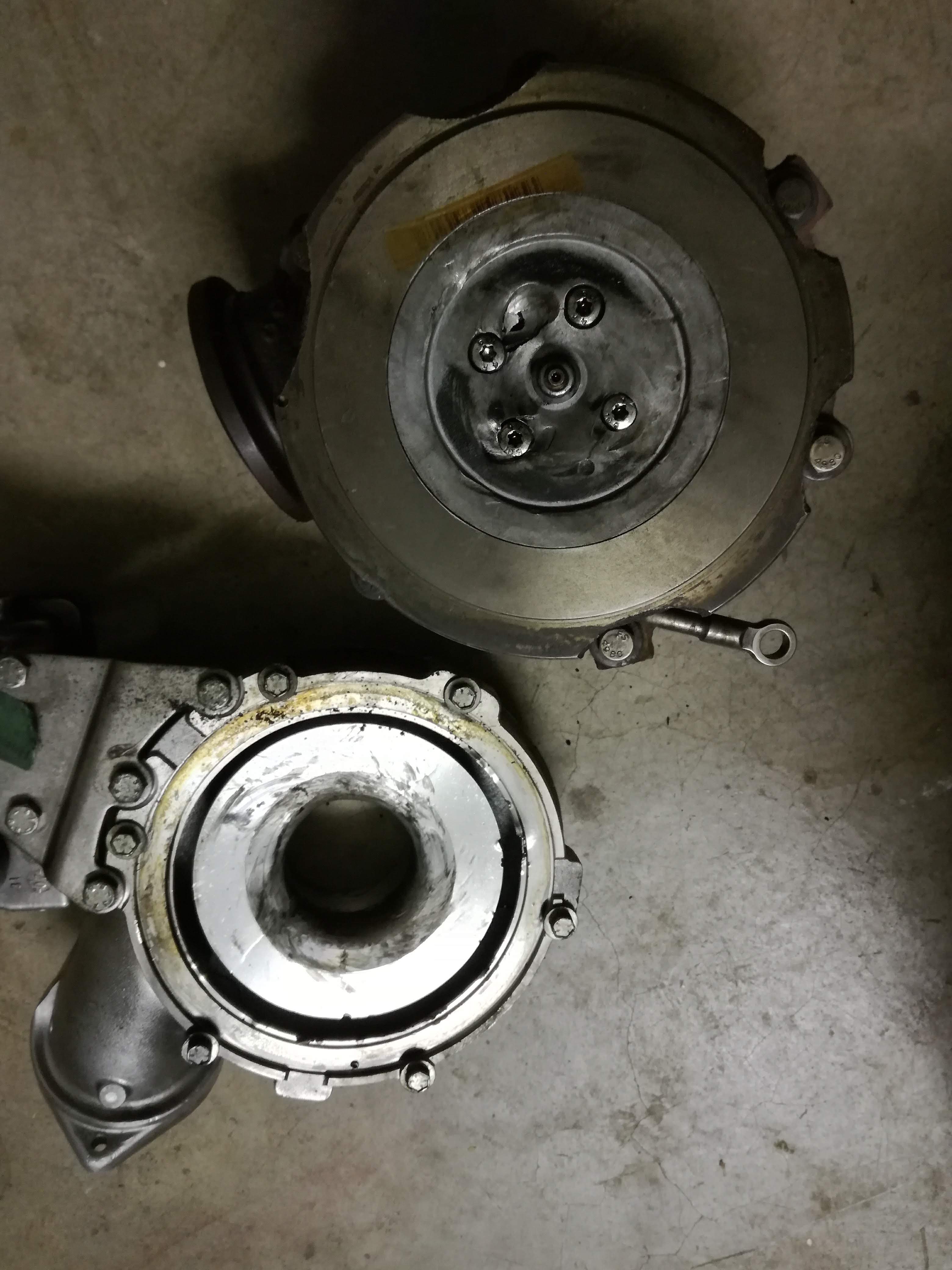

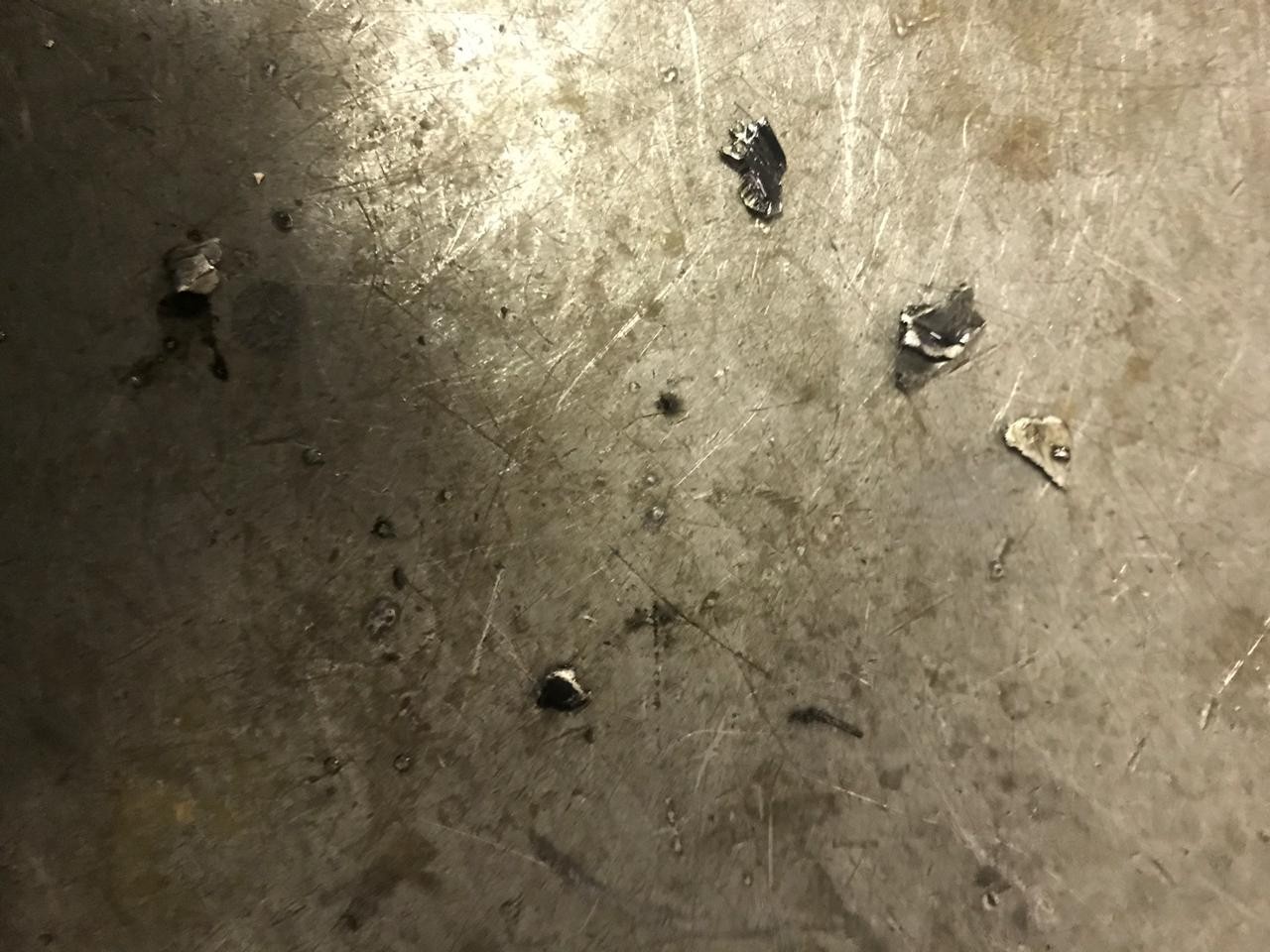

First of all, my mileage was on 204000km, original turbo, which had a whine from the day I got it (117000km), the whine got louder when the Downpipe was done, which was acceptable. The car was modded from around 125000km and as far as I am concerned, the whine never got worse. I did struggle with boost leaks, initially the seals were changed, intercooler cleaned, but everytime i opened the underride covers i would still see a leak. Eventually I noticed the intercooler was also leaking and changed that along with new seals, but it still leaked, it also was going through seals. So even though I hardly drie the car hard, i'm sure this had something to do with its demise.
It was a sad sight seeing her on the side of the road, bleeding oil after her somewhat major injury
To make matters worse, she wouldn't start to get her into neutral so the tow company had to arrange for dollies to get the rear wheels off. All this meant more time at the side of the road, the only person able to pick me up was my wife, who had already picked up my kids, so I made a decision to let the tow company sort the car out and get it to the mech.
The mech of choice was DVN automotive in boksburg and he came highly recommended. Denis assisted in opening up the shop afterhours to receive as well as do an initial assessment on the damage. He advised that there was some oil in the intake ( which is why it didn't want to start ) and a worst case scenario is that I might have to consider a rebuild. I never planned to sell or get rid of the car, so I advised Denis to move forward irrespective, I am keeping the car.
Over the next few days he was able to tell me that the compression in all cylinders were the same which was great news and we should sort the turbo out and take it from there. The turbo that came out was a sight .....

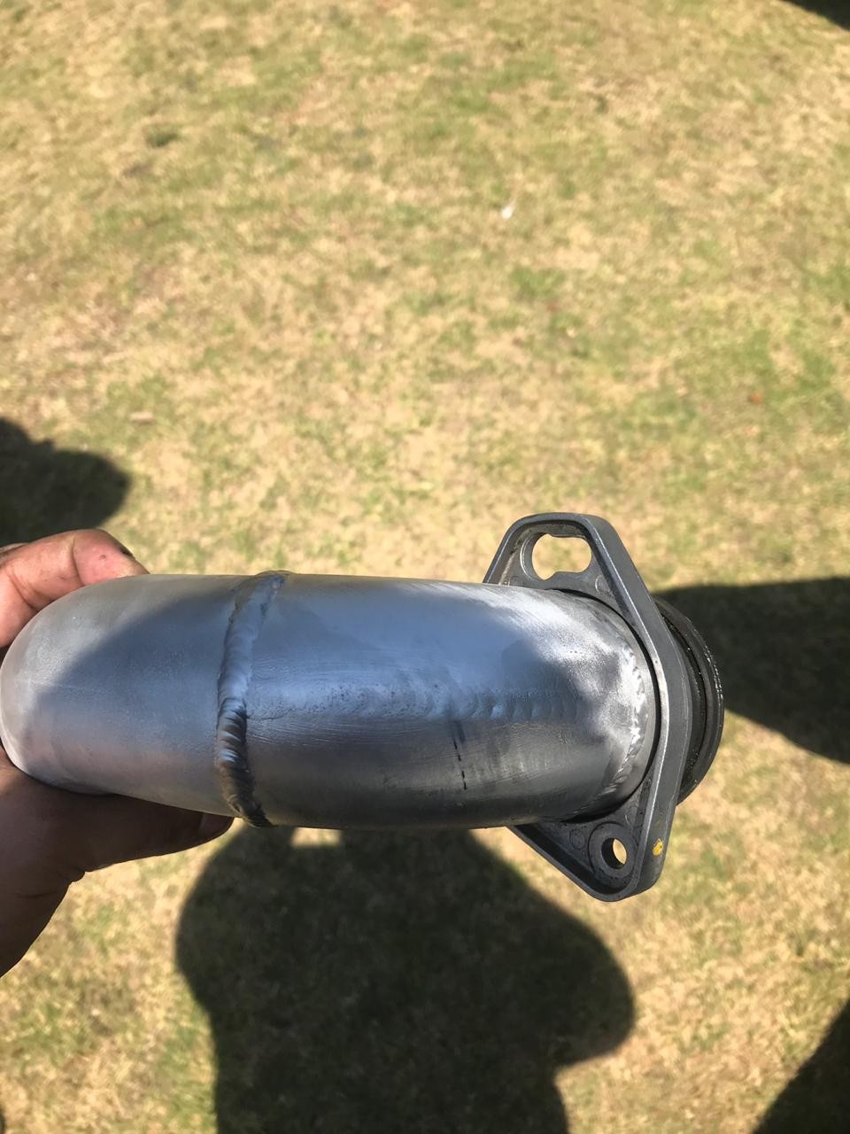

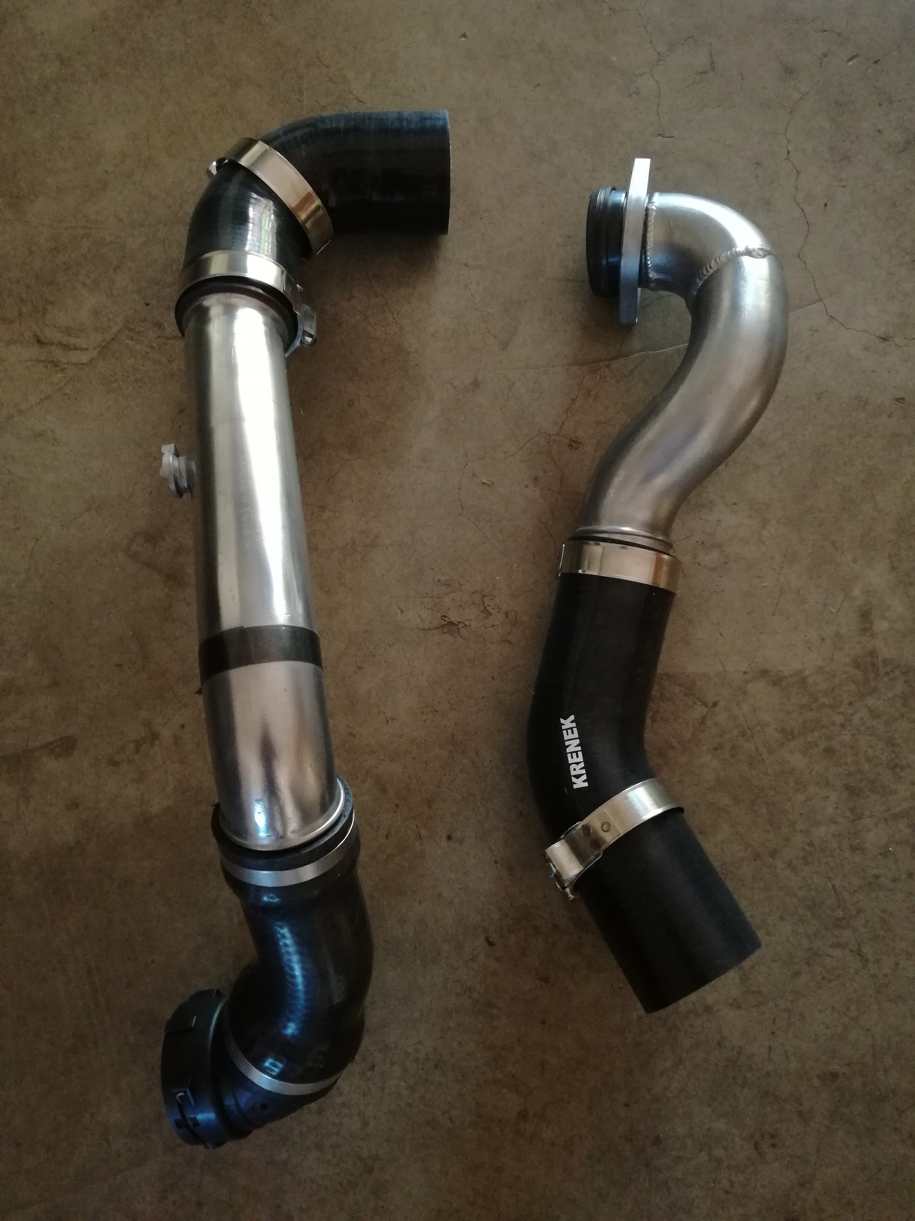

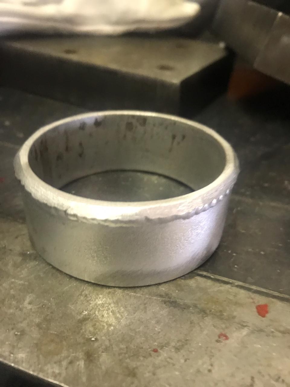

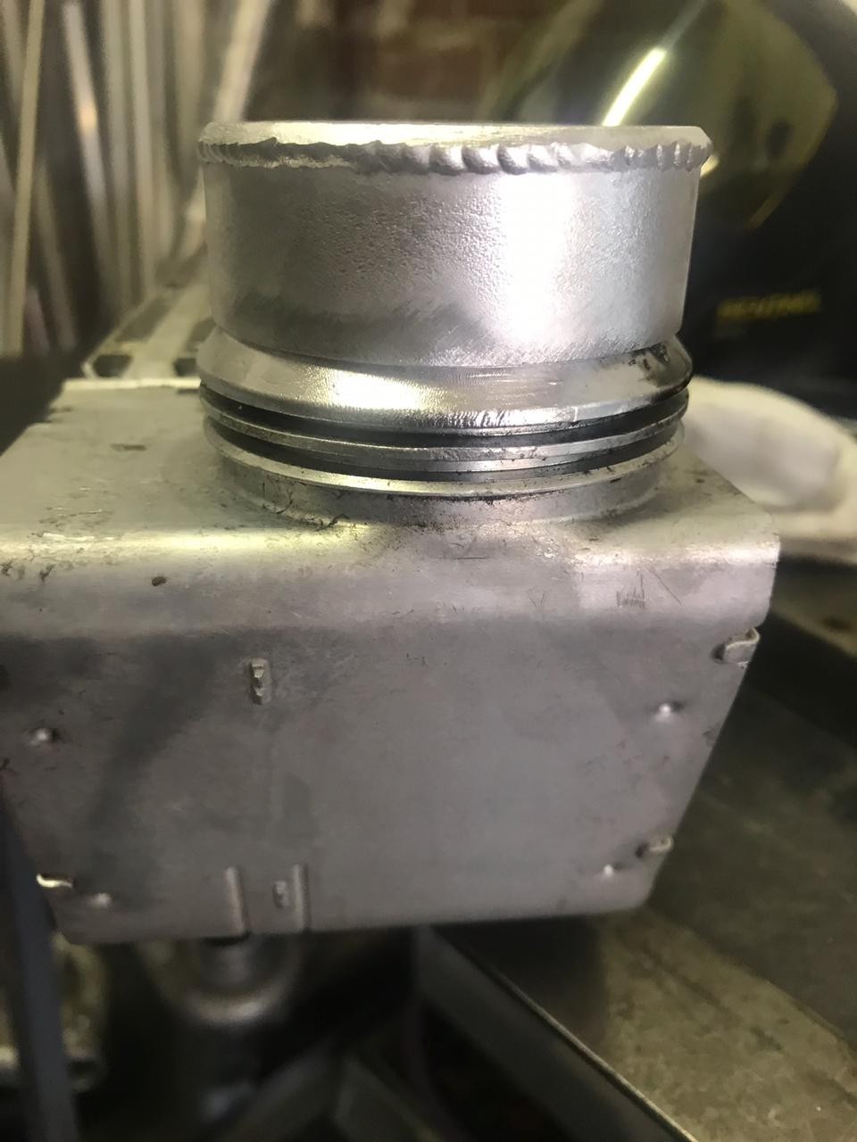

While Denis was busy assessing the damage, I had contacted Danny from DSC Motorsport as he was previously helping me diagnose the boost leaks. After our discussion he was more than willing to assist with repairing the boost pipe as well as change the ends of the intercooler to accept a normal silicon pipe with a proper t-clamp. Keeping in mind that I am in Centurion and the car in Boskburg, Danny offered to pick up the pipes. The boost pipe was repaired
The intercooler modified
Went with new seals on the turbo side
and sourced appropriate t clamps for the job
Boost pipes after repair and some cleaning

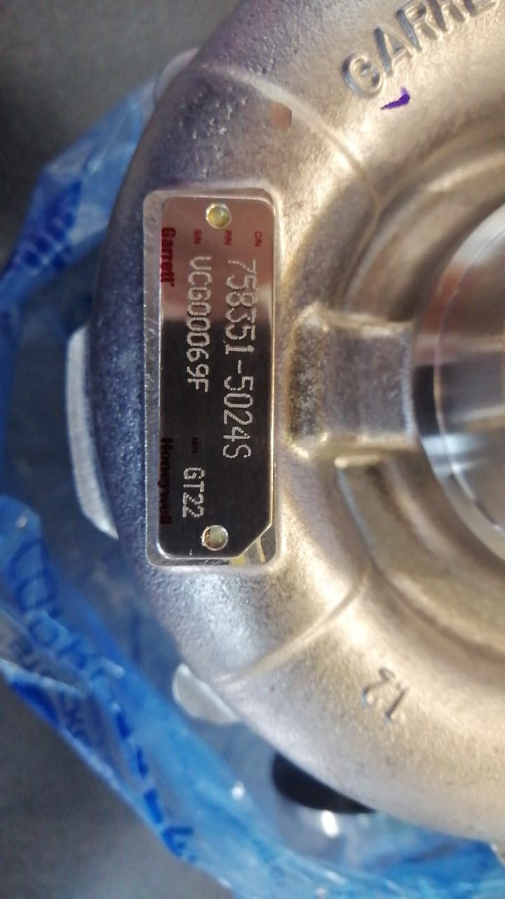

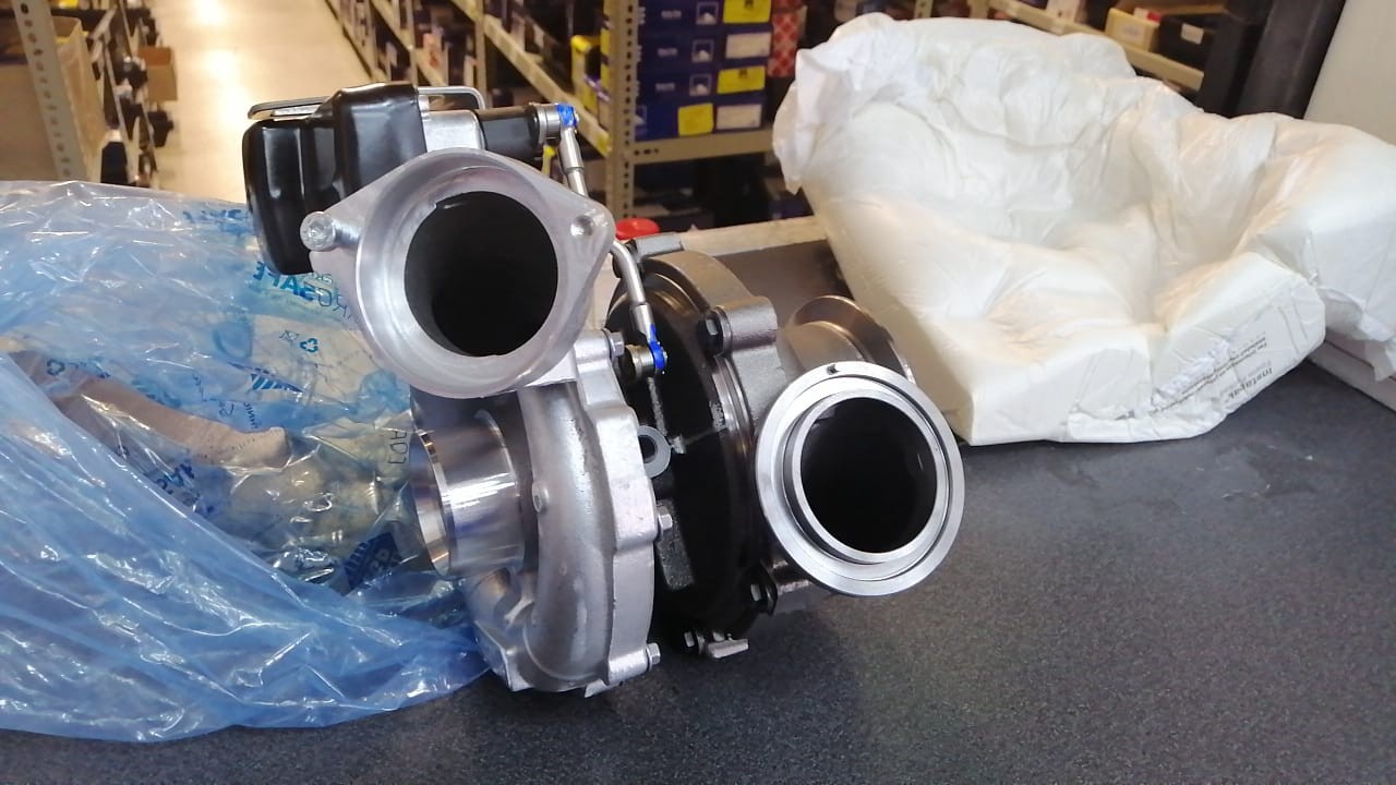

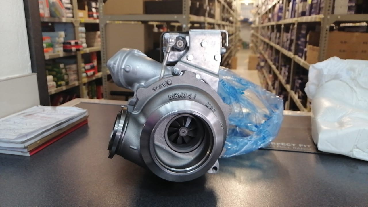

After alot of back and forth with various turbo dealers trying to source a good second hand turbo that i could overhaul, i gave up. There were many 3.0d turbos, but none from a e60, while I was under the impression that more than one would work, I learnt that the inner parts vary, which is confirmed when you look at the interwebs for part kits for the various turbos ( the ones that were looked at was the E46, E53 and E83).

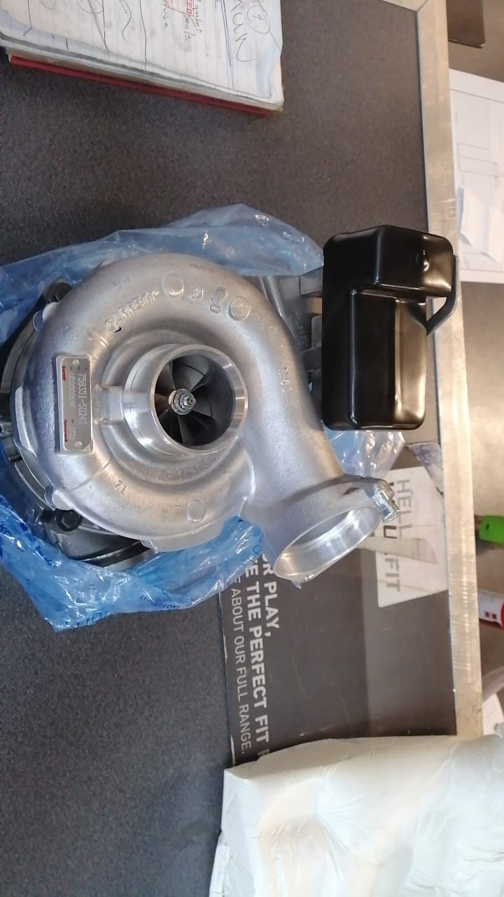

I then turned to sourcing a new turbo, which also seemed to prove difficult as some shops mentioned the different versions ( even though i supplied a VIN). After a wrong one was ordered at one shop I managed to find the correct one ( hopefully) at Goldwagen Kyalami. Thanks to @Nikhil for introducing me to Zammo at GW Kyalami, best service, always seems to source good quality parts and is way more knowledgeable than most 'parts guys' i have come across in recent times.
After having paid upfront for the turbo it was ordered, took just a day....oooh..... so shiny...
had to be sure it was 100% correct. This is a proper Honeywell Garrett turbo with all the part numbers as my previous turbo
good thing that the turbo also comes with the gaskets to mount onto the exhaust manifold.
