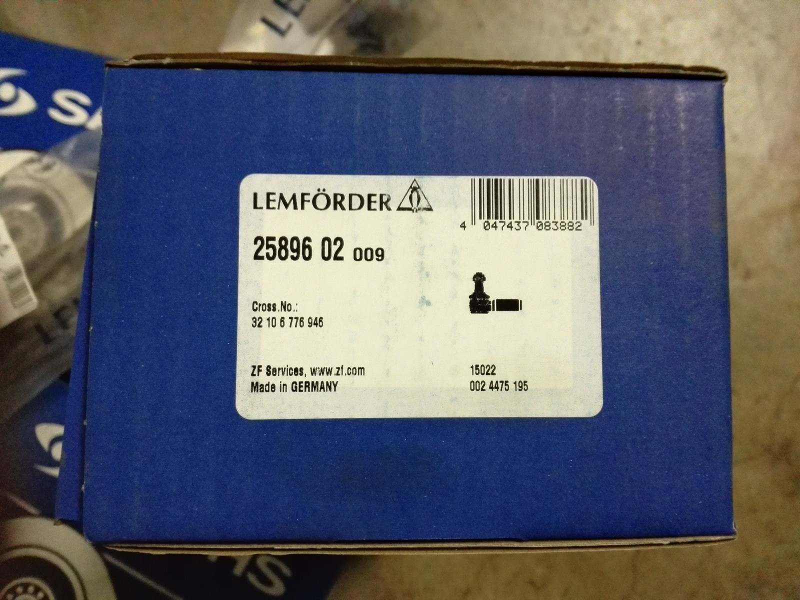

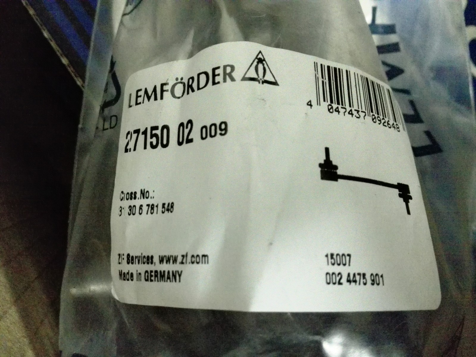

I kinda forgot about this update but there was an annoying knock on the front suspension and since i had already changed LCA leading and trailing, I had the car checked by Syds Suspension in PTA on their wonderful machine that is able to put the suspension through its paces.

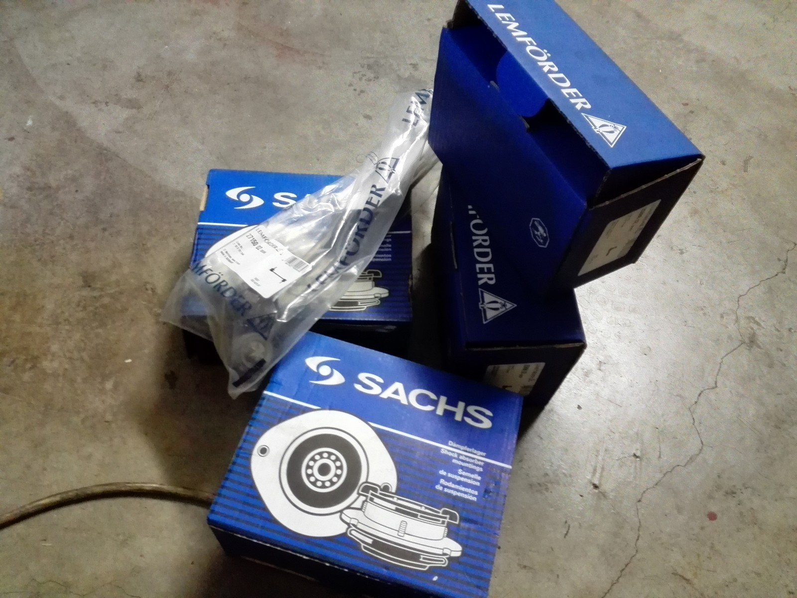

We noticed the one of the swing supports needed to be replaced and the ball joint+ rack ends seemed to be on its way out. I was also recommended to replace the shock mounts as this seems to be a common issue on the 3.0d.
After recovering from the shock received from BMW on these parts I contacted Axis, who managed to source Lemfoerder and Sachs parts (made by ZF).
No pics of the install unfortunately as I got someone else to fit them . Best part of this process was the fact that I was quoted less by Syds Suspension to replace the worn parts( using partquip parts) than BMW, but I managed to get better parts(in my opinion) from Axis and with the labour to fit it still came in considerably less than what Syds wanted to charge.

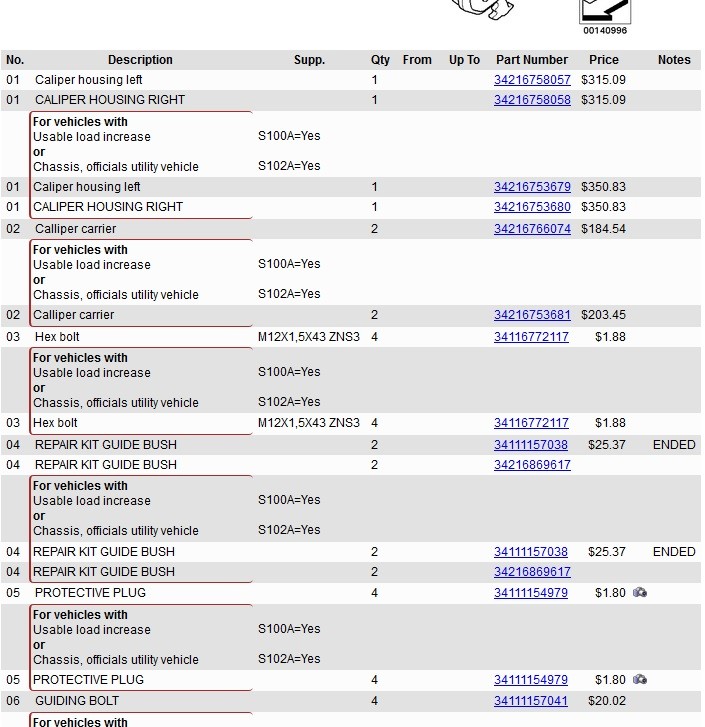

While doing all the research required for sourcing the brakes i noticed that alot of the items on RealOEM had multiple part numbers. Initially it seemed to be confusing since it wasn't easy as options like active steering, folding mirrors that the car would be with.
Now while many now this already, it confused the hell out of the parts sales people as i always try to correlate the parts back to the OEM part number.
I refer to the part enclosed in a bracket with
For vehicles with
Usable load increase
or
Chassis, officials utility vehicle
For those who didn't know, if the vehicle was being built for official purposes and I know in the UK the E60 ( in my case) was often used as a police vehicle, the vehicle would be built with these parts. They are essentially parts from a higher specced model, in this case 540i, 545i or 550i that are installed into a lower specced model.
The results is different calipers, bigger i assume, with bigger disks and pads. The only parts needed if you wanted to upgrade are those mentioned above.

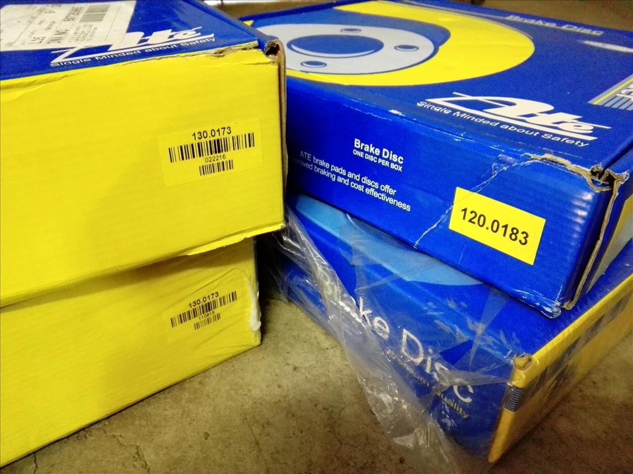

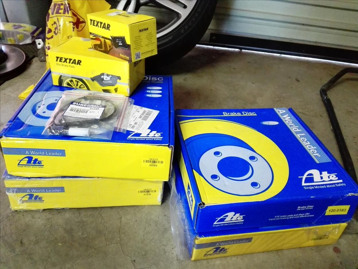

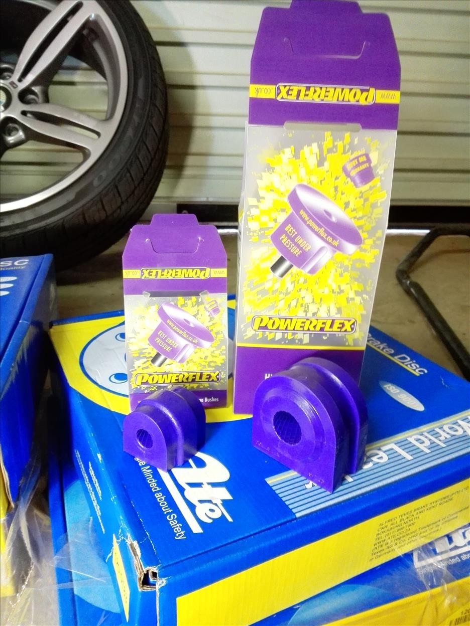

After lots of calls and comparing prices( its in my blood) i ended up with
ATE disks front and rear and Textar pads front and rear, with the brake sensors as well. I had also ordered powerflex bushes from Axis and they were sitting in my garage so decided to fit them too.

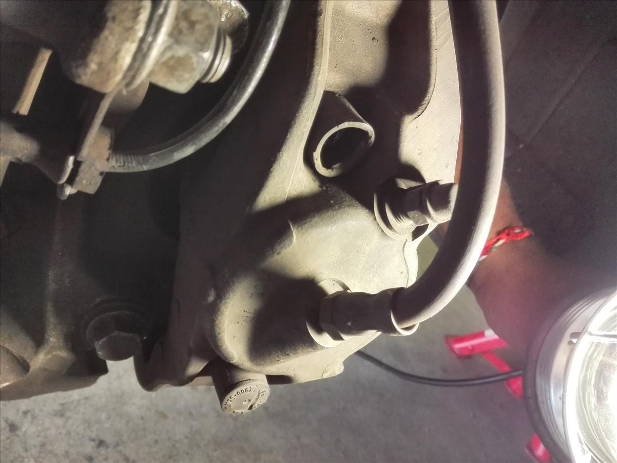

I decided to jack up the car and put it on stands so that the entire front would be off the ground. Stripped off the wheel and was greeted by this.

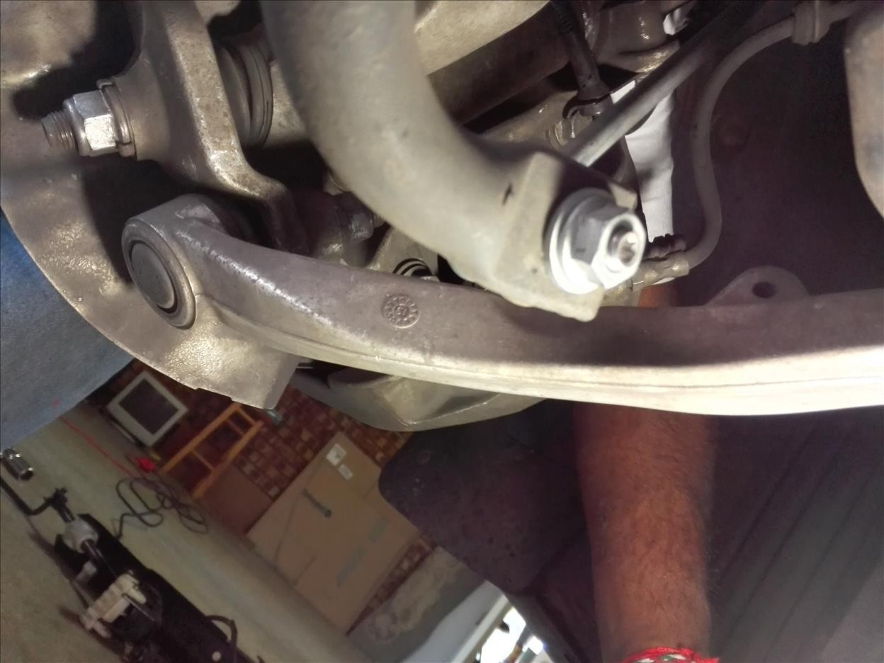

Since i was doing the ARB bushes loosened the stabiliser link nut as well ( 16mm wrench with T30 torx in the middle)

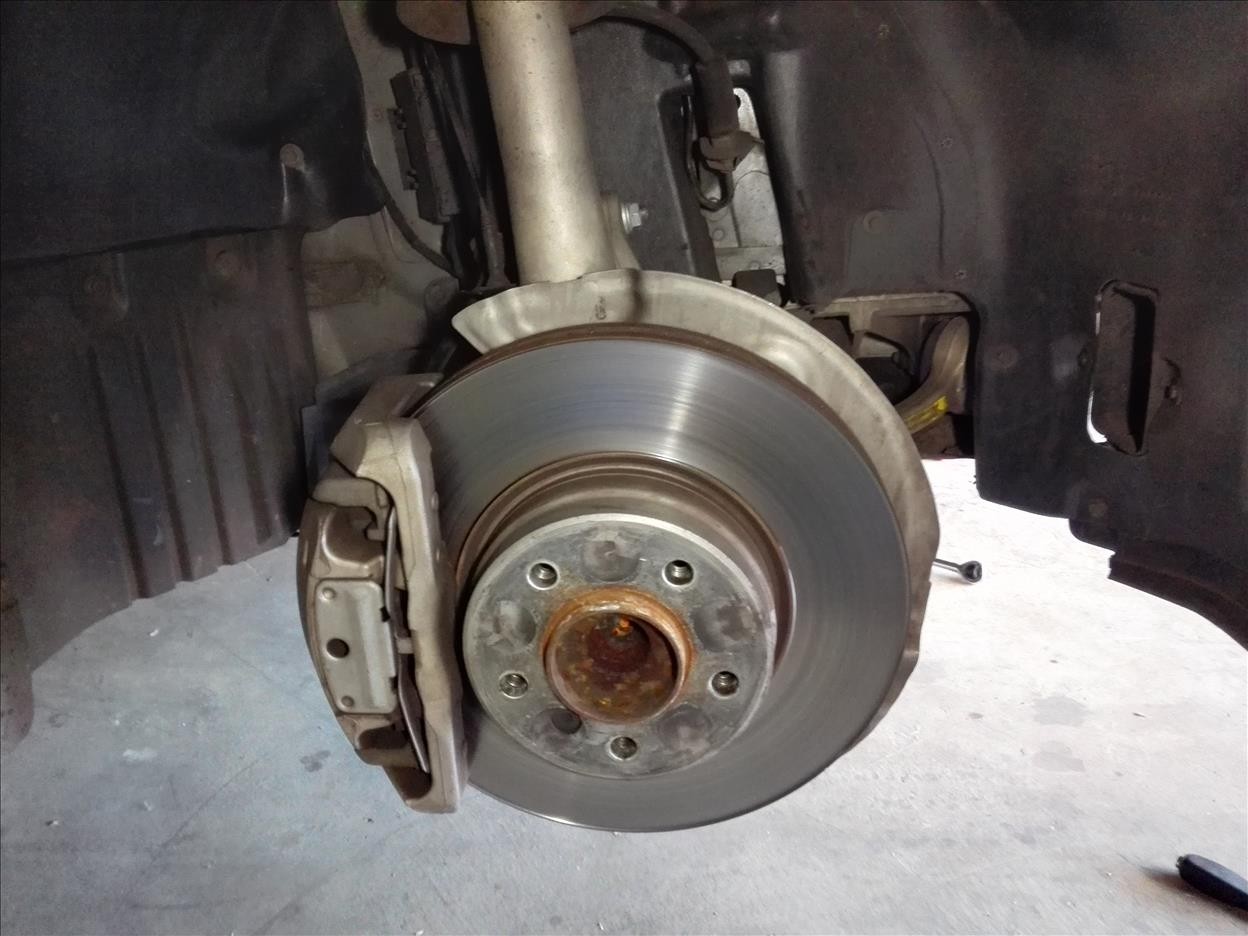

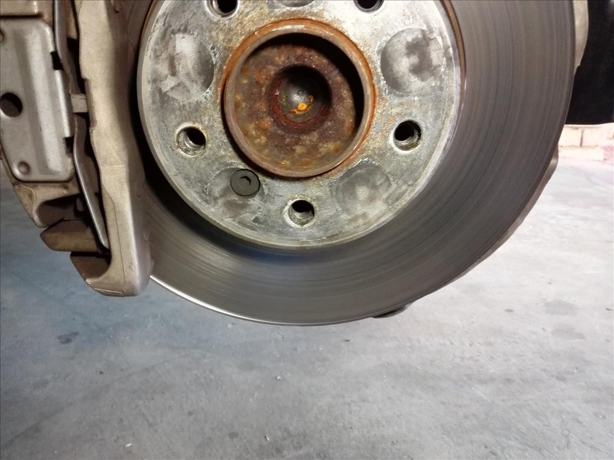

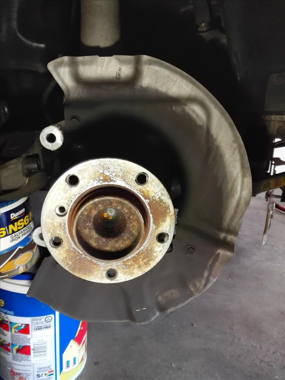

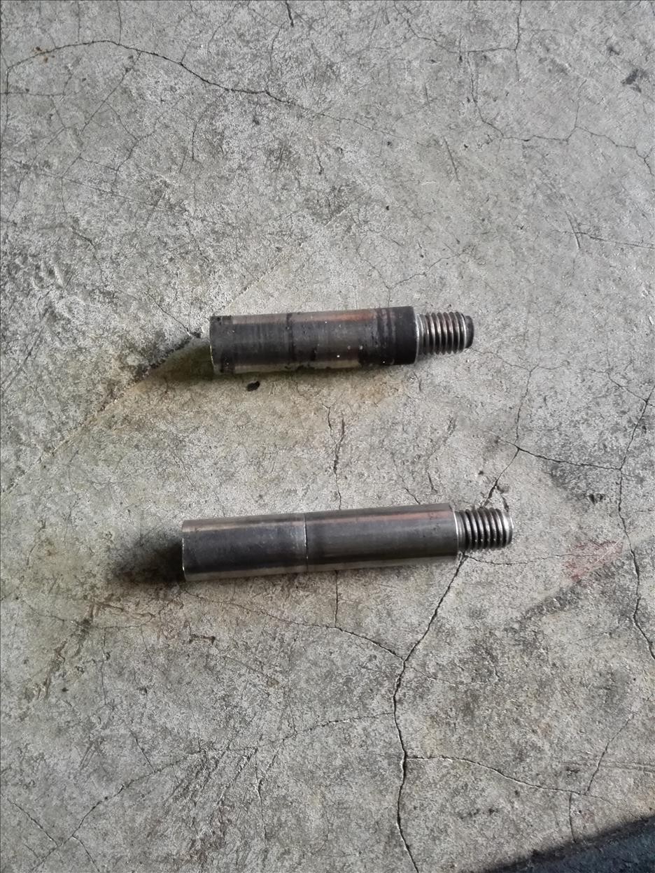

The guide bolts are different lengths for the top and bottom, I cleaned parts as I removed or refitted, old vs cleaned

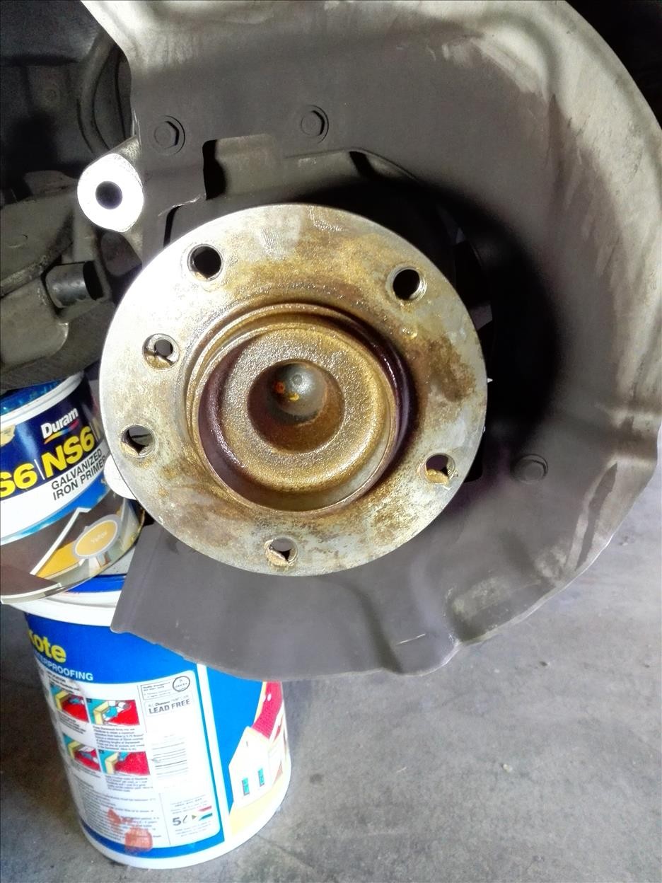

With the caliper and carrier off the disk is able to just pop out, didnt even require a tap. Had a little rust but nothing serious.
Cleaned and greased

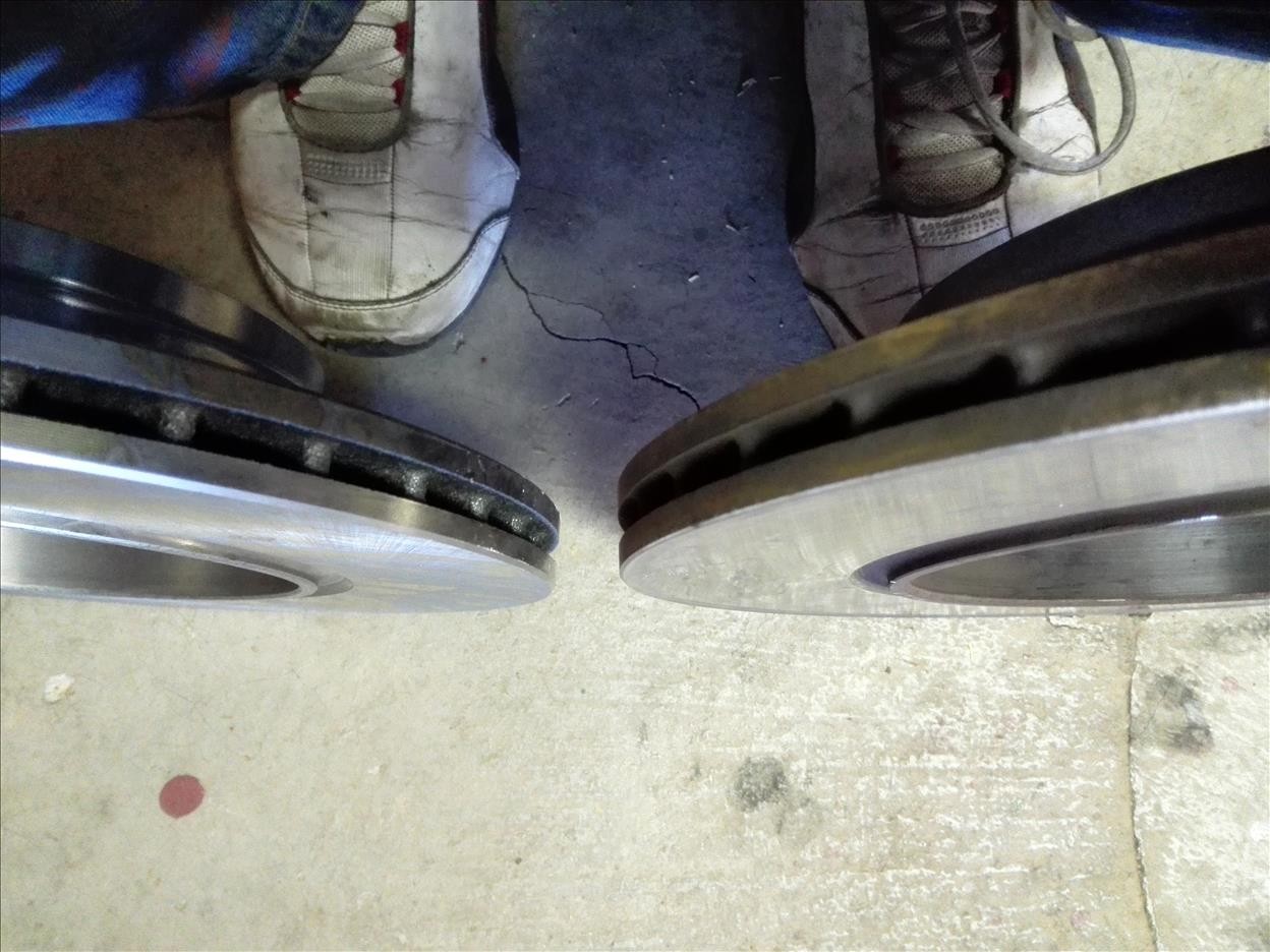

Old vs New
Quite a ridge on the old disks

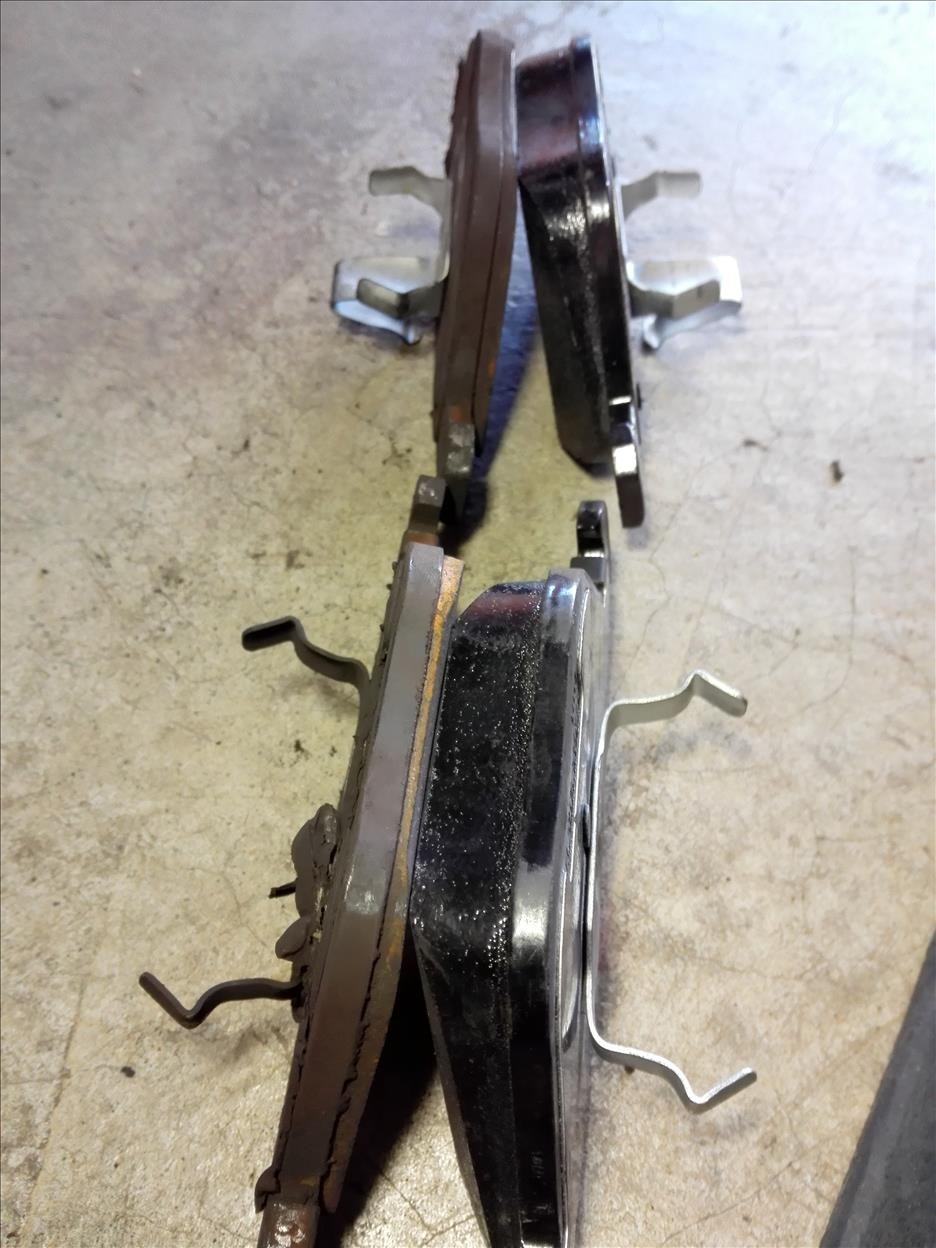

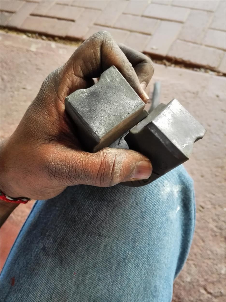

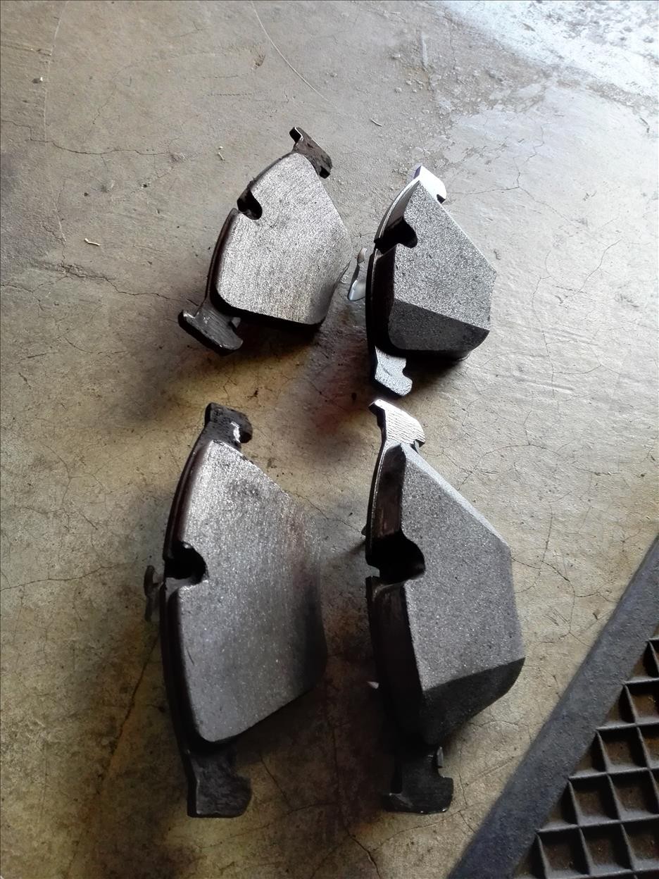

Pads out of the caliper, Old vs new

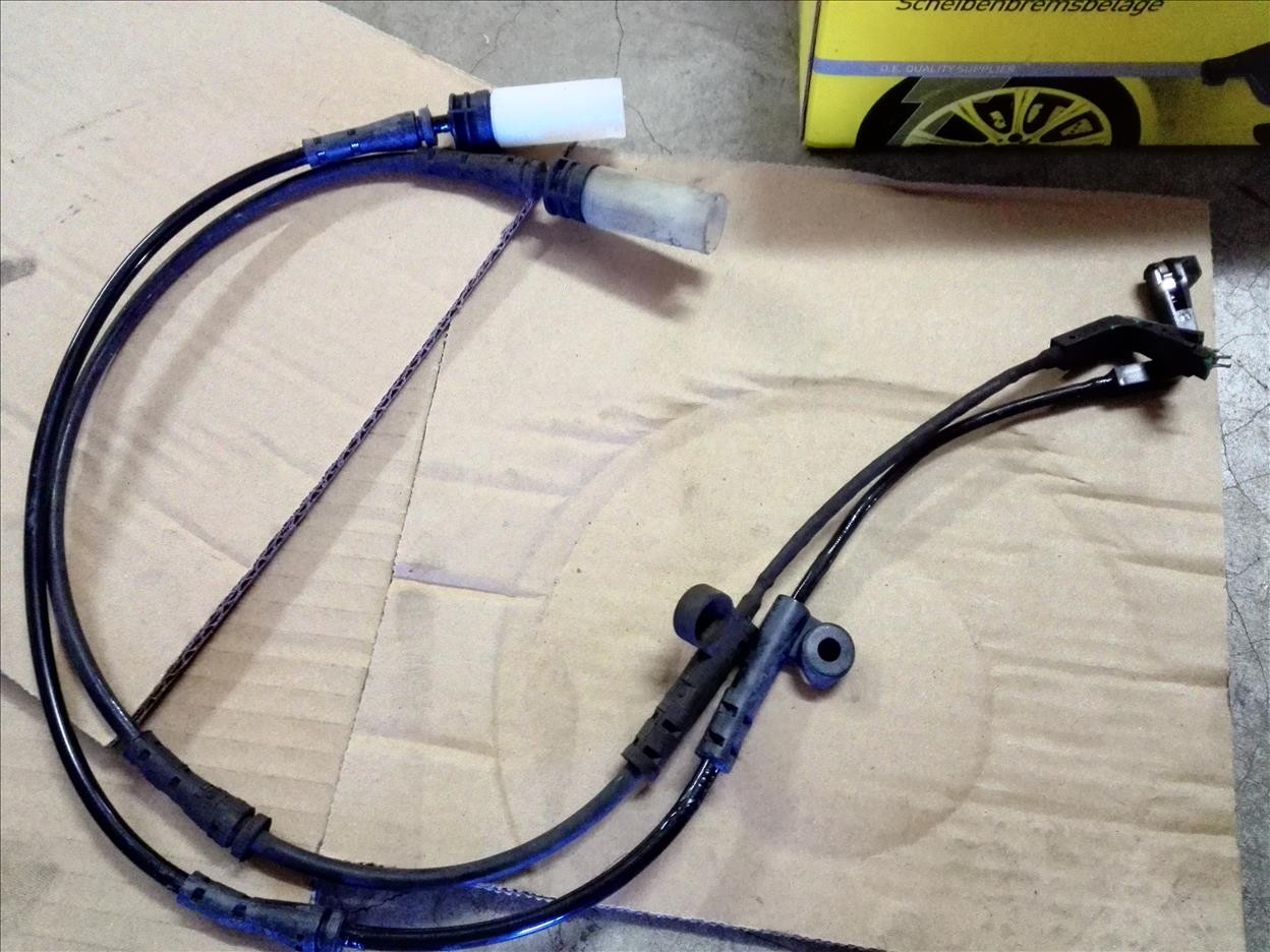

Old sensor removed and new one fitted

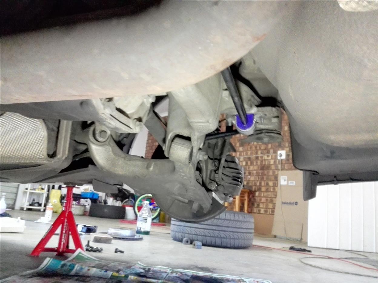

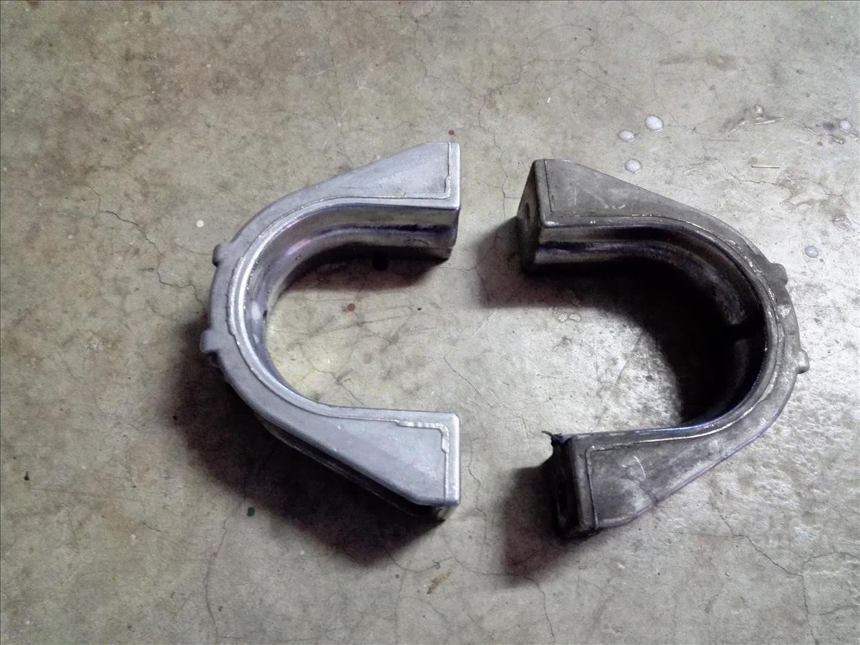

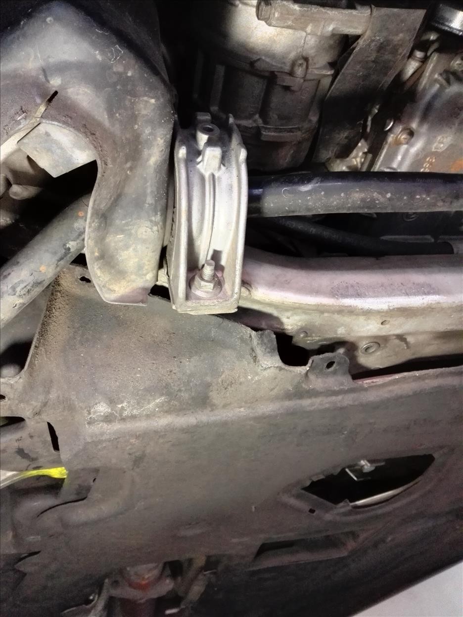

To do the front ARB bushes I loosened the stabiliser link nut ( 16mm wrench with T30 torx in the middle)
The brackets were removed thereafter ( 13mm wrench)

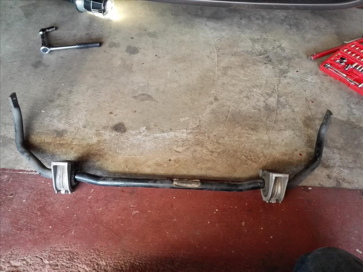

ARB out

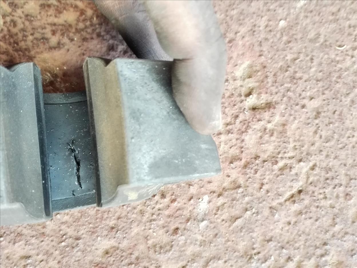

Front bushes had some wear on it
Surprised at the amount of flex it had

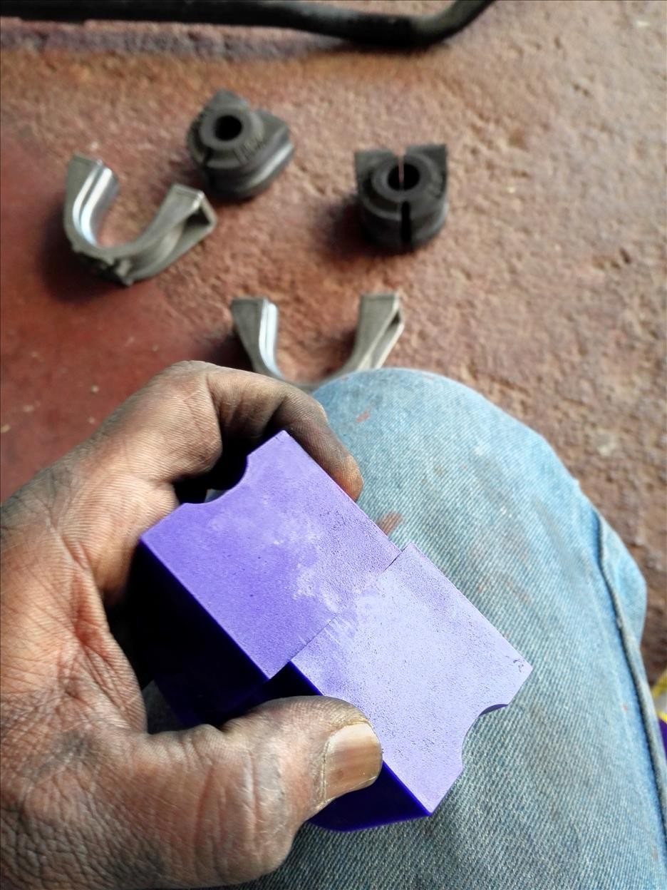

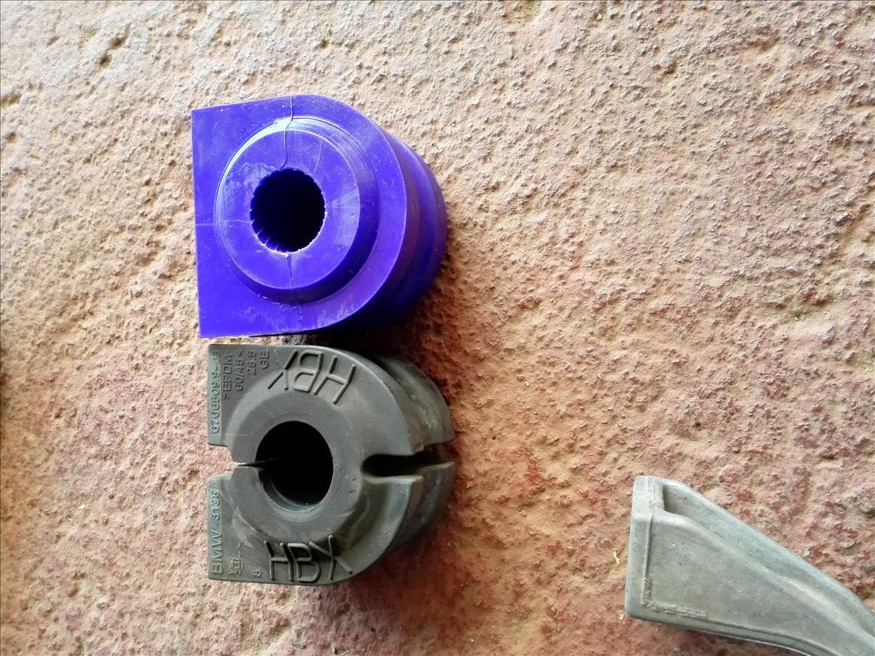

Old vs New

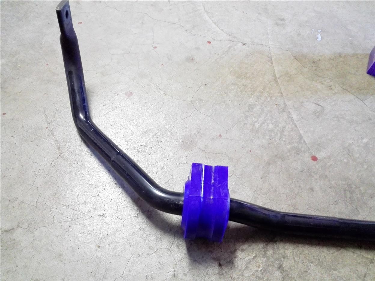

Powerflex has significantly less flex ( I was trying my best to twist with one hand, with 2 hands yes it could be flexed more, but the OEM one could probably be stretched 180 degrees with 2 hands)
Cleaned up the brackets

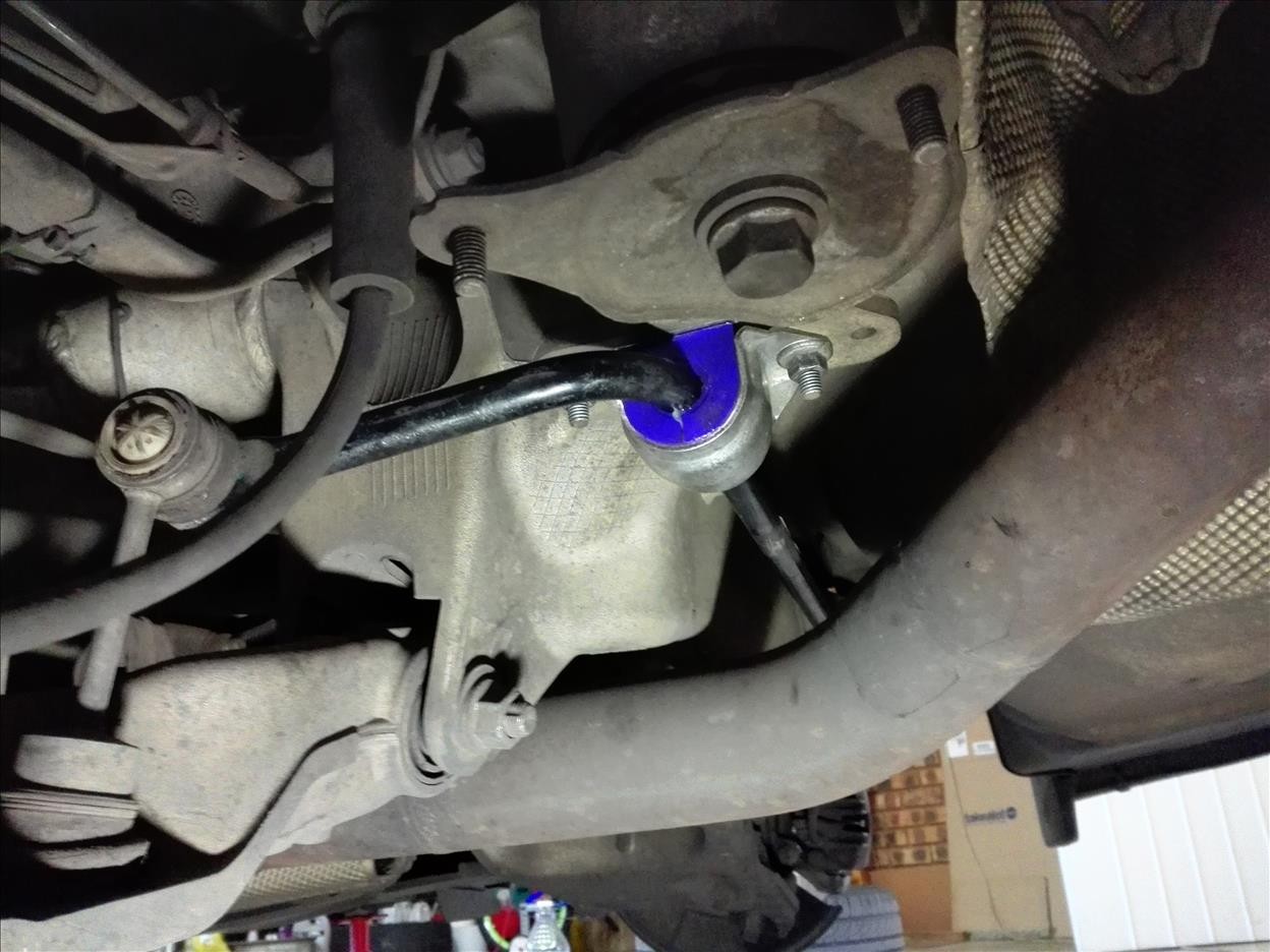

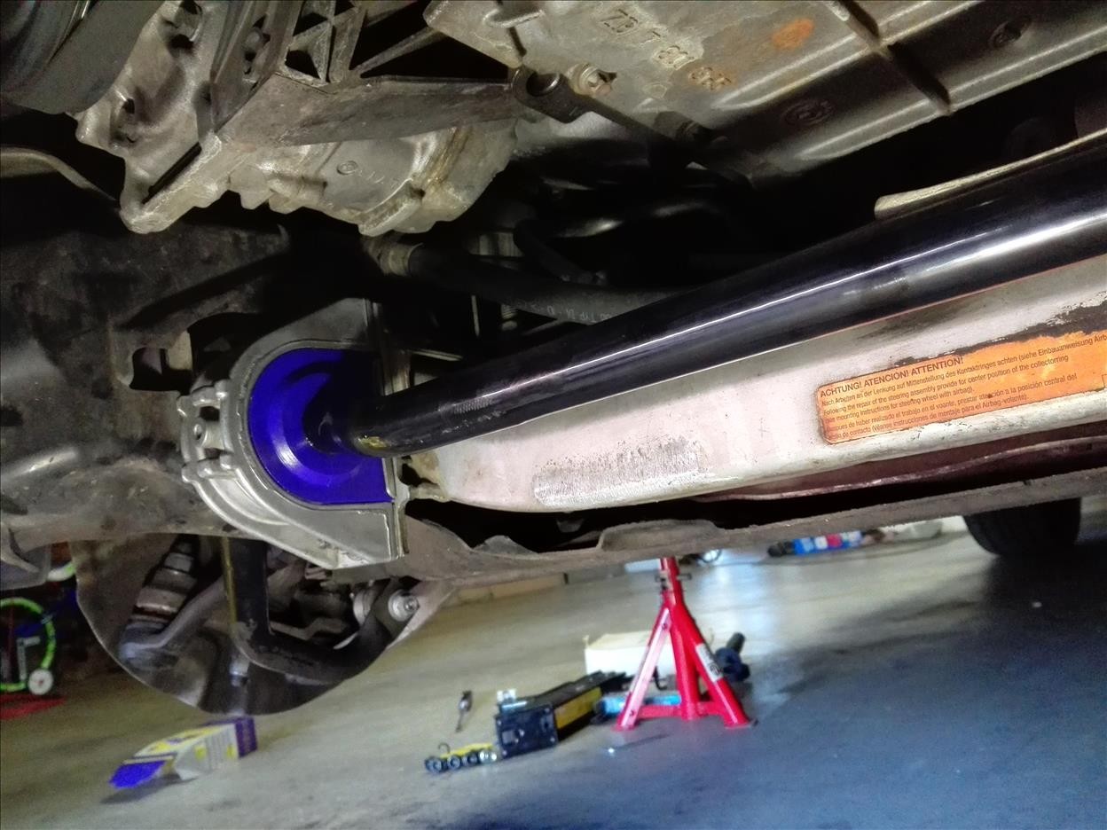

Cleaned up the ARB and greased the bush using the powerflex supplied stuff
ARB fitted back

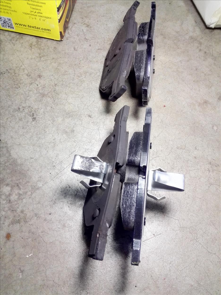

Rears pads, old vs new

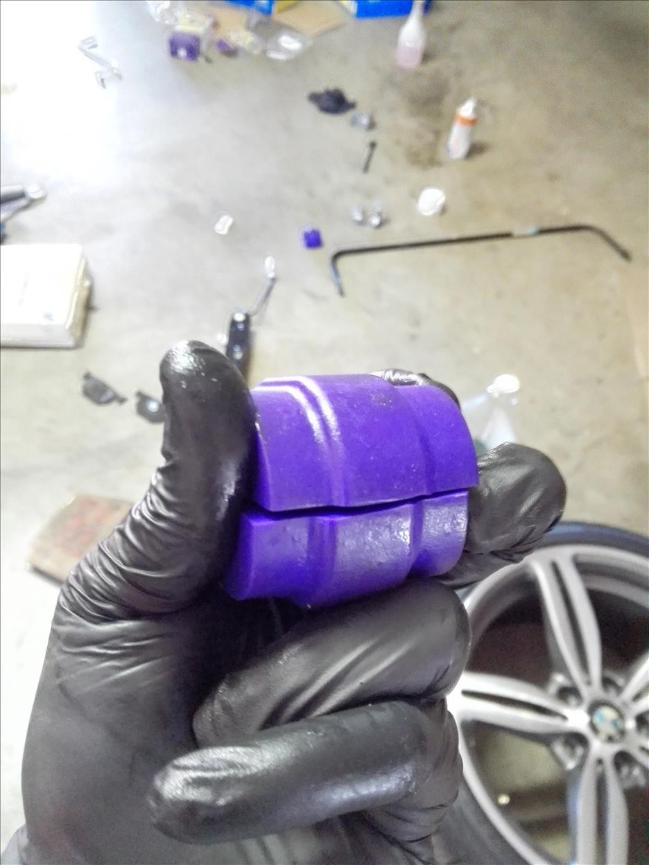

Old Bush flex
New bush flex
ARB cleaned, New bushes in.
