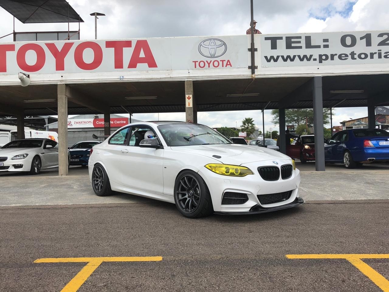

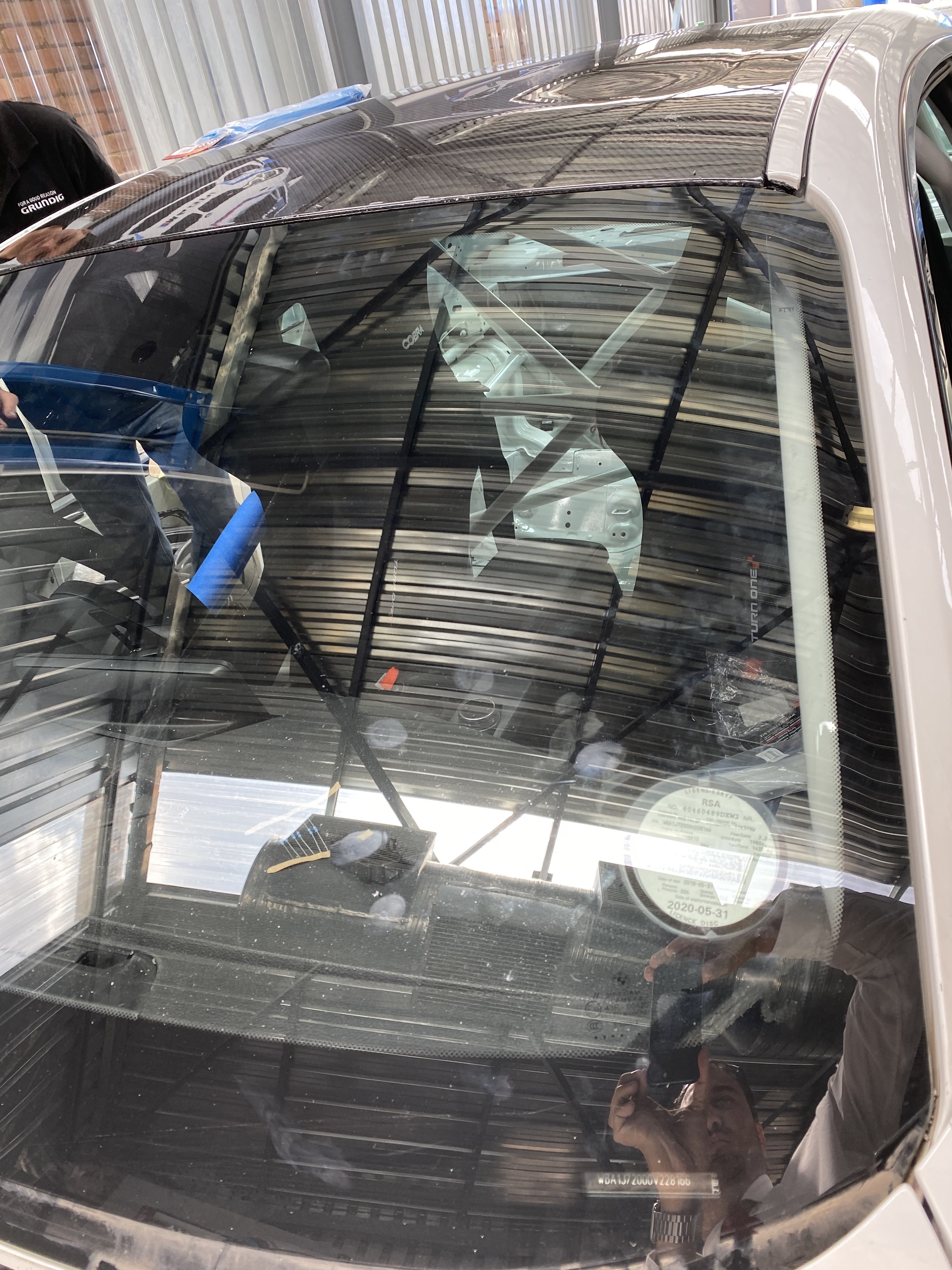

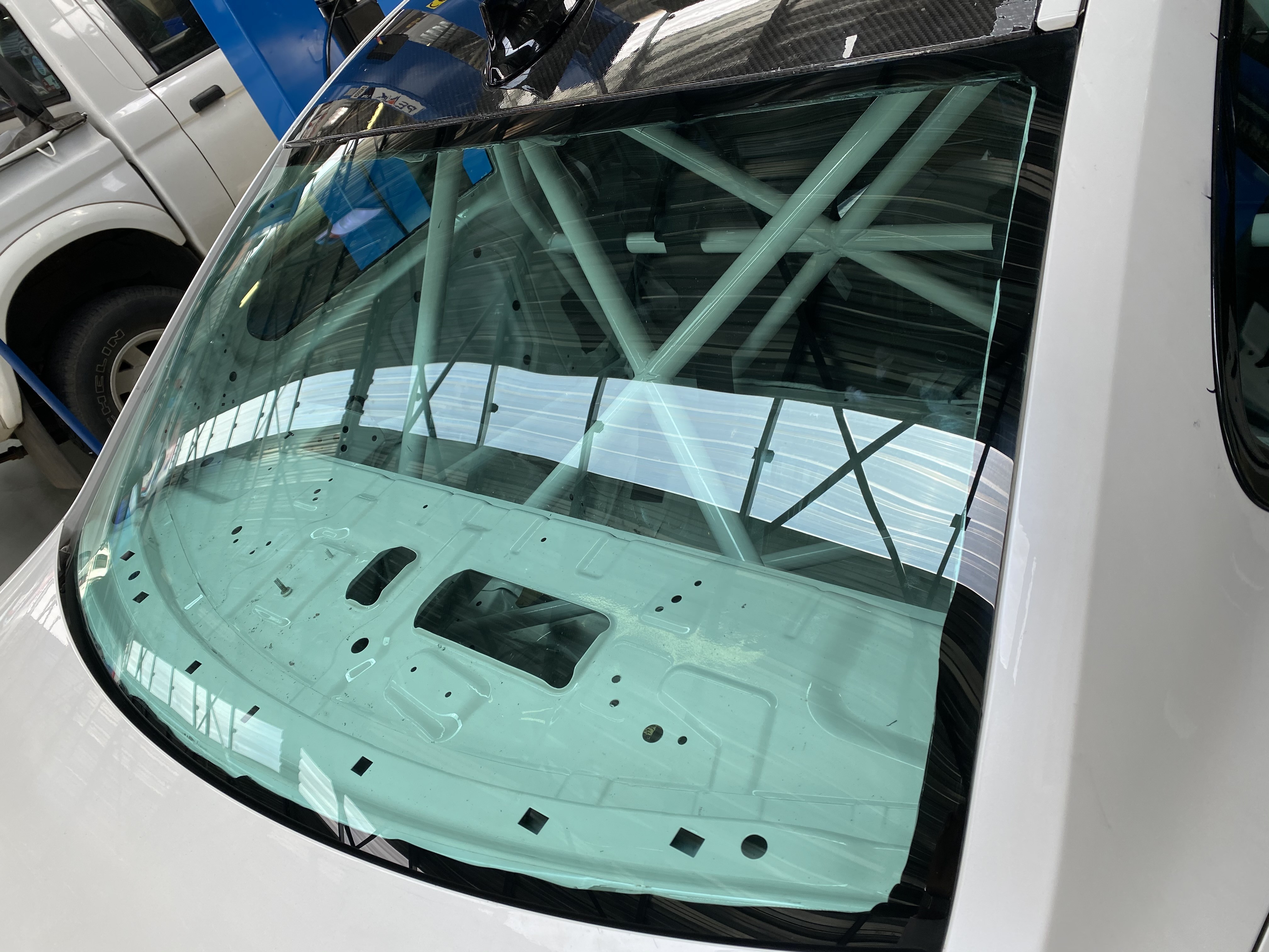

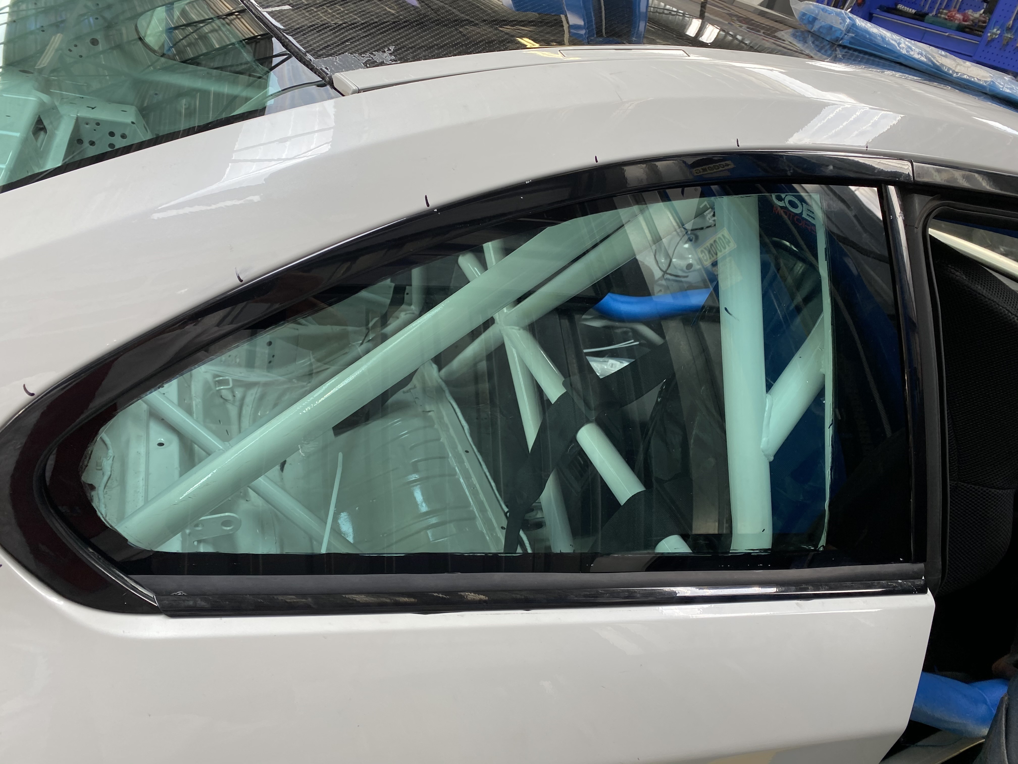

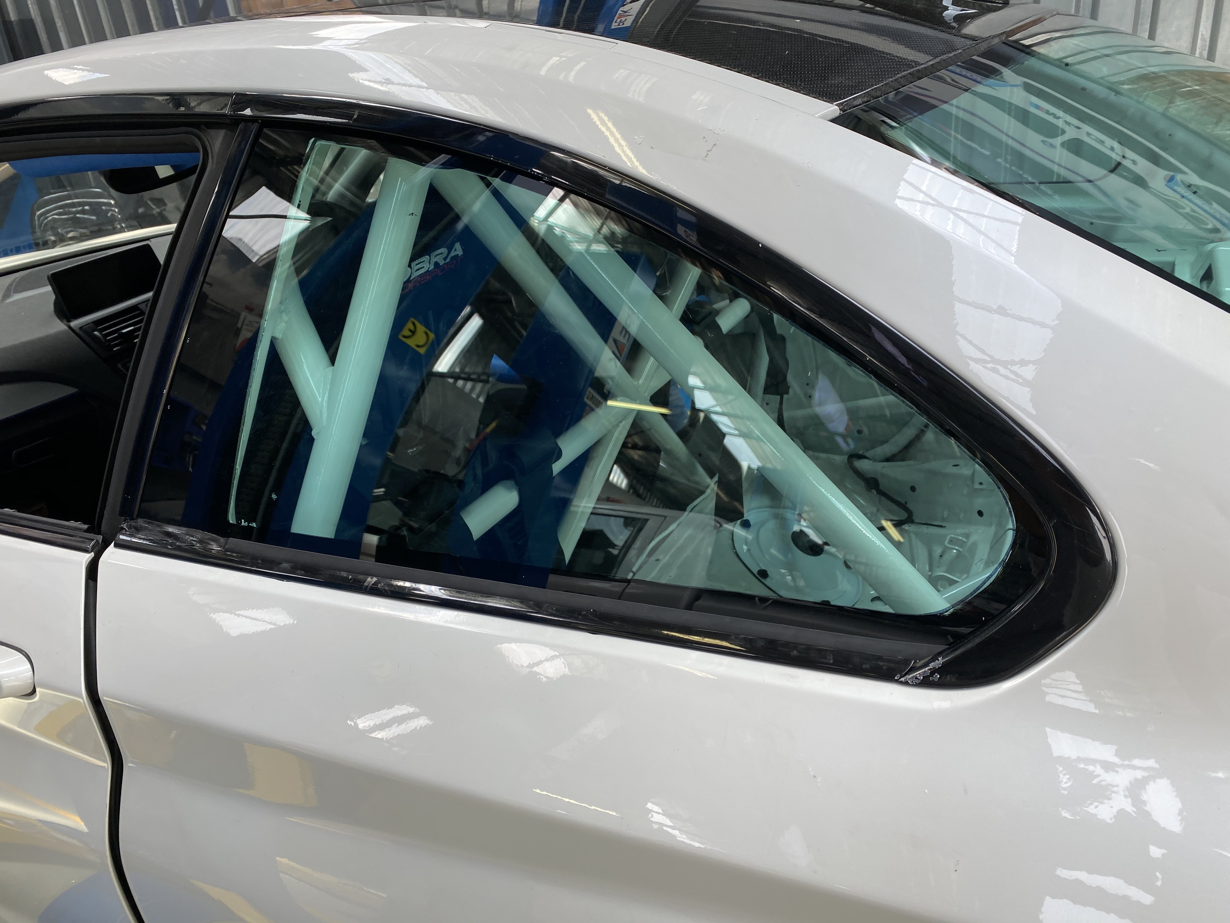

Roof was in and secure then we refitted the windscreen and replaced the rear and rear side windows with aircraft lexan.

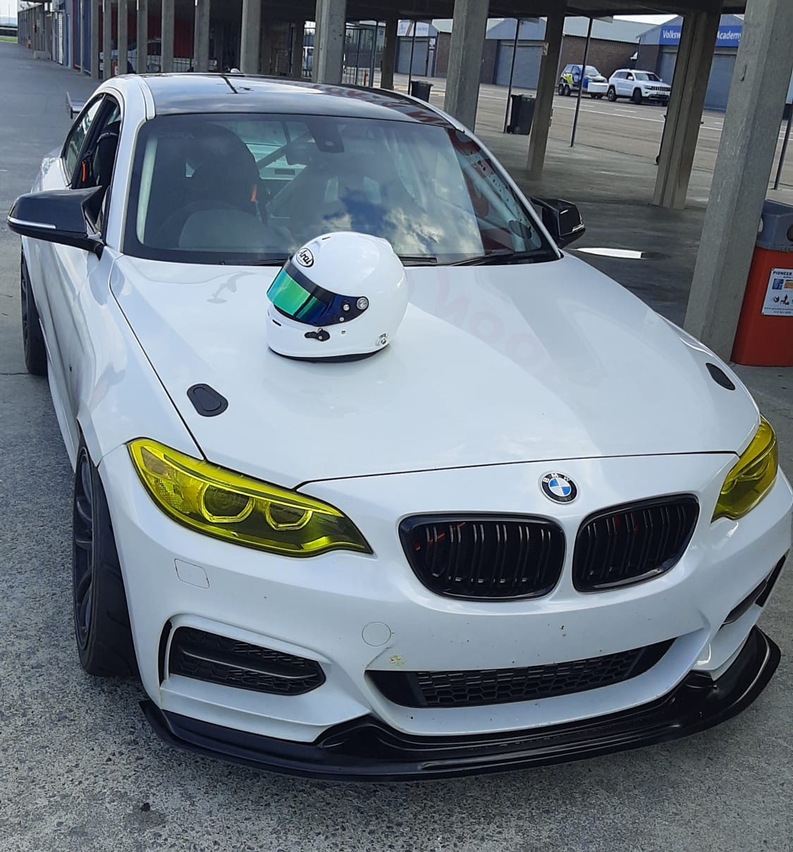

Front Splitter we made and fitted, Extends all the way back to the gearbox,
You can hang off it- so definitely is functional.
Will take pics once its on and we remove the protective film.
We chose I-Bond its a aluminium and polyethlyene composite thats light and rigid!
I can't believe the pace at which you're getting this done! One question: did you drape-form the rear lexan windscreen, or just pull it into profile using the fasteners? I haven't done my rear screen yet until I'm happy I can get it done cleanly...
Kotters
The windows were vacuum formed using the original glass and are a direct fit.

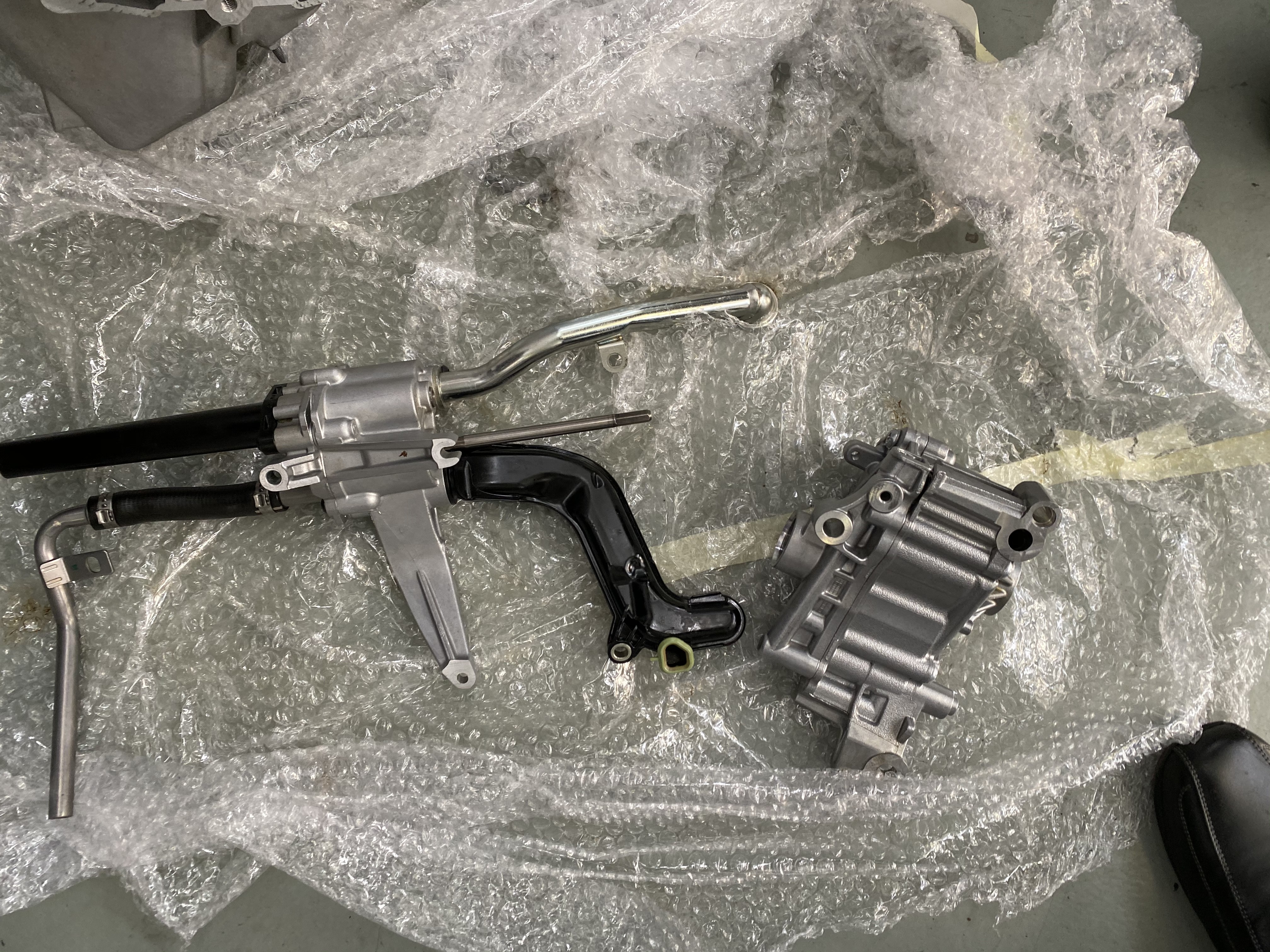

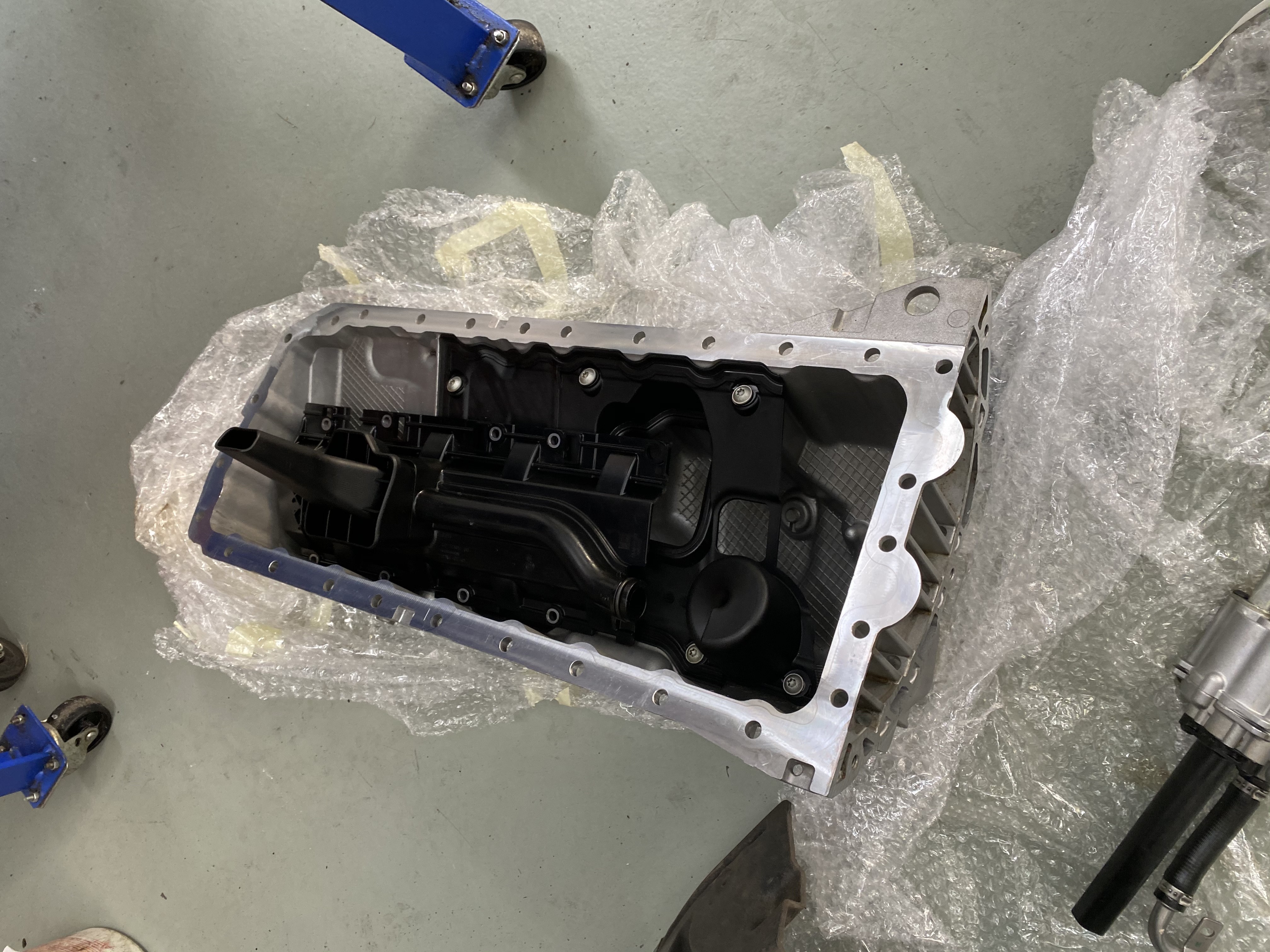

We managed to source a M4 Sump, oil pump and pickup for next to nothing.
This will go in next week and will solve the oil surge the std N55 is known for.

We fitted the M4 sump and the oil pickup... had a few spacing issues for the return pipes for the turbos, but we sorted that pretty quickly.

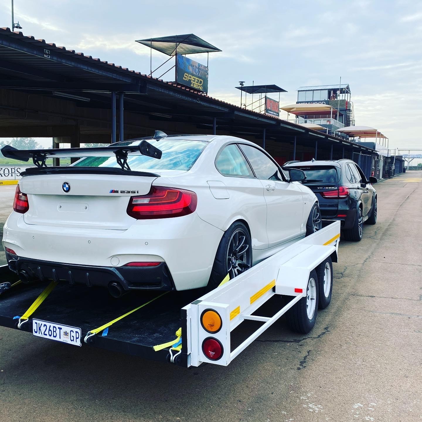

So it was on track... and its fast but there are issues.
Temps sky rocket when the water/meth runs out
the water/meth tank is 4 litres and lasts 5 laps
suspension needs lots of setup time
brakes are iffy- we can not bleed them properly. We used ista and by hand and there is still a soft pedal.
But it ran a 11 at Zwartkops on its first outing so we not far off.
When we get the big brakes and the LSD times will drop massively.
