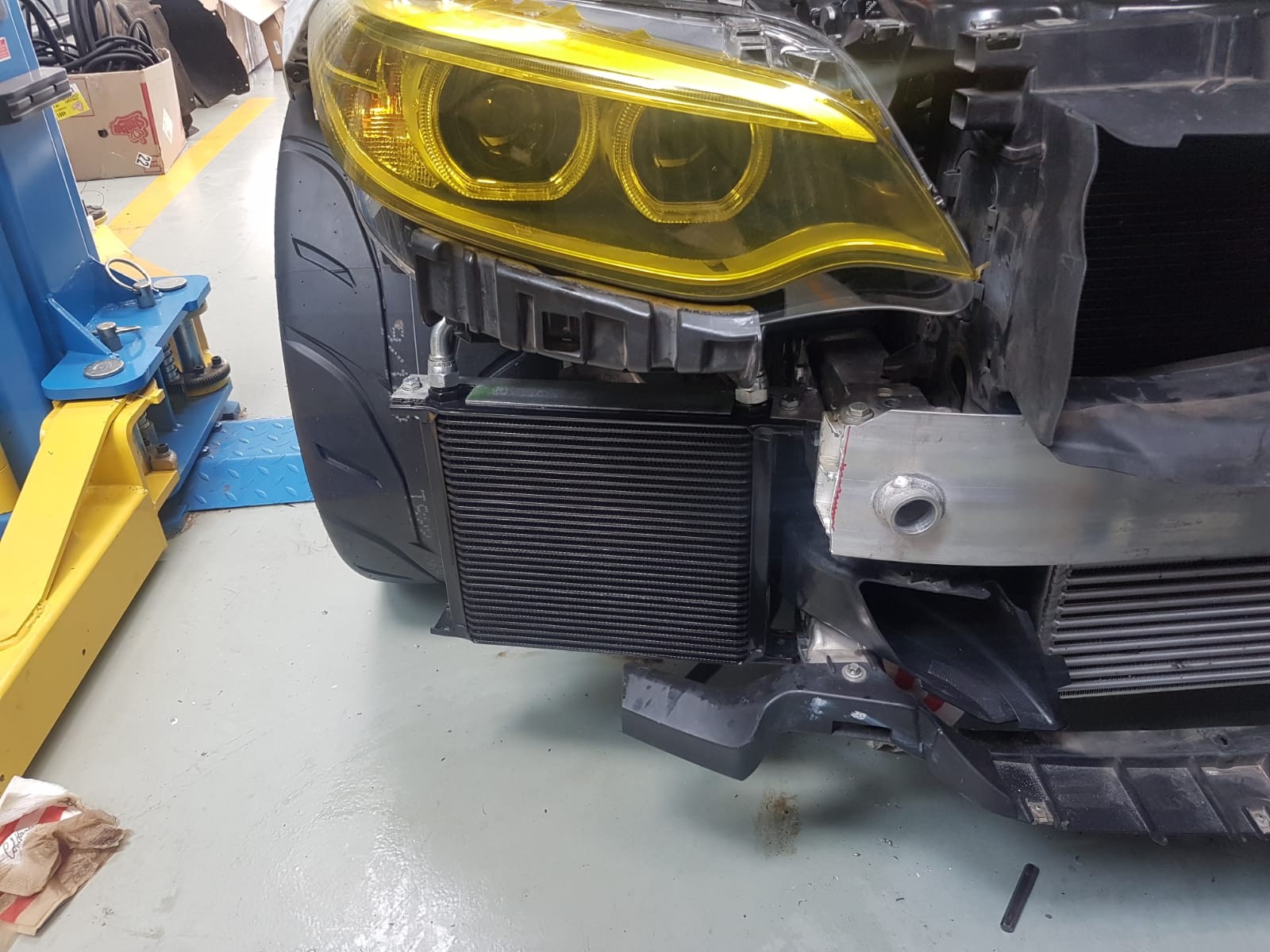

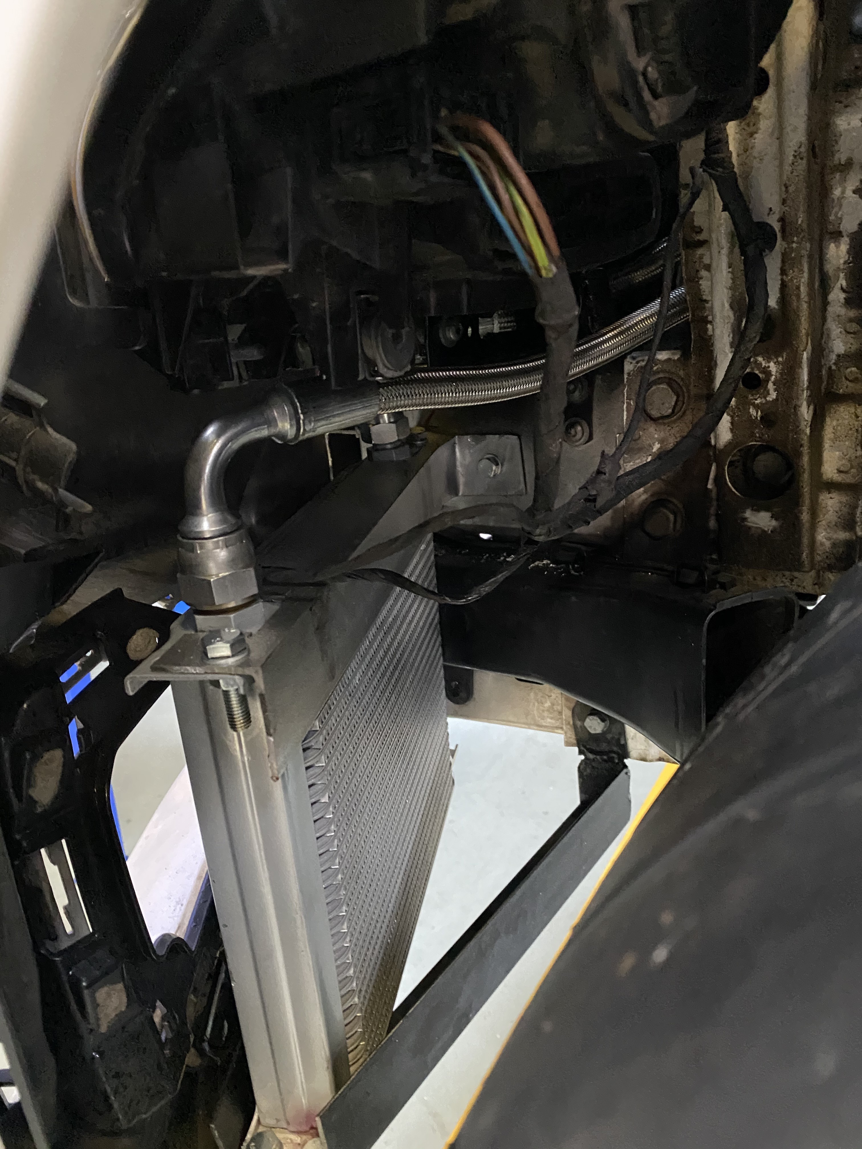

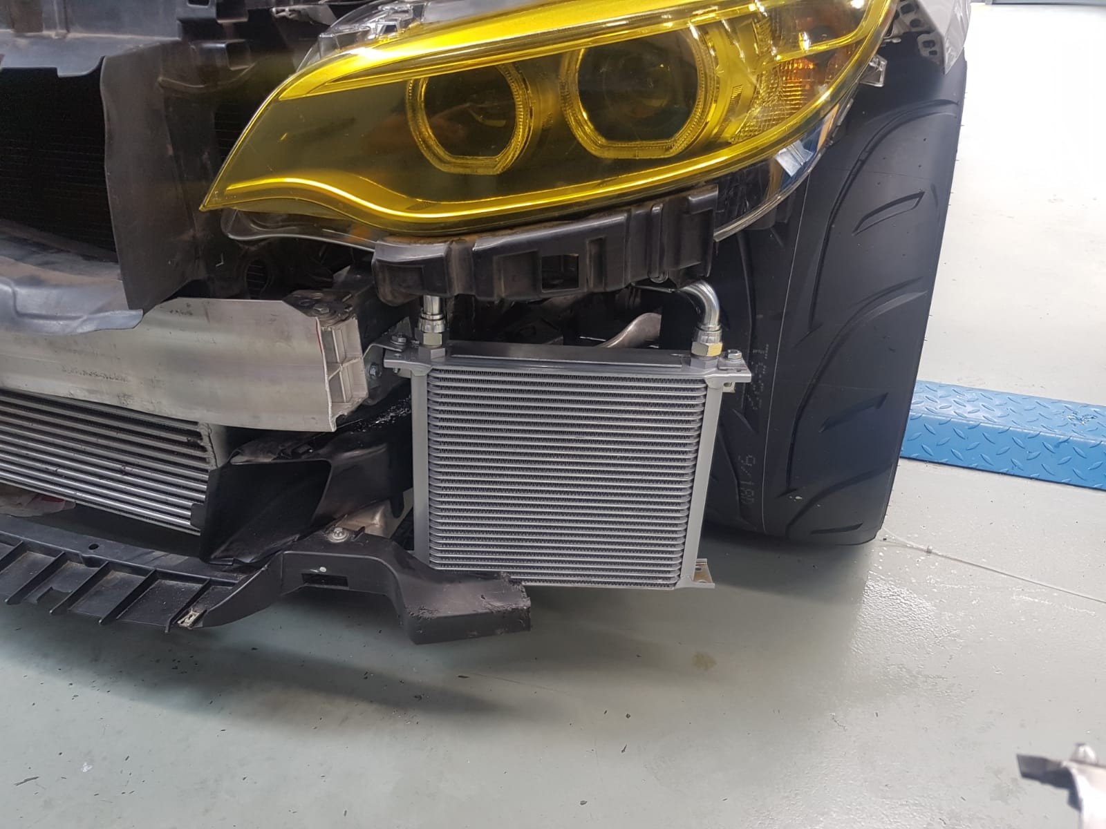

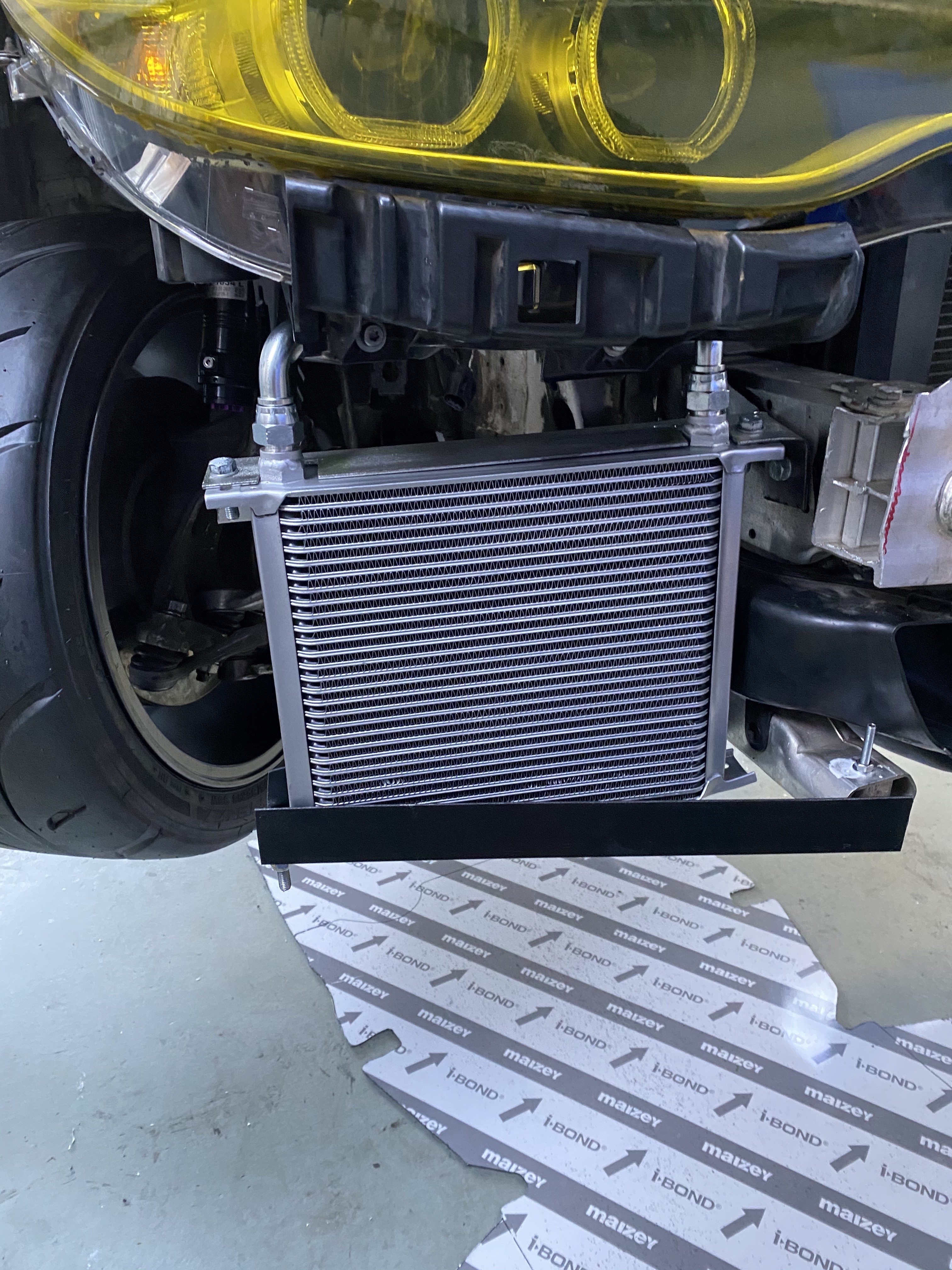

We sorted out all the cooling that we think we will need,
Engine oil and Gearbox oil coolers fitted.
bumper put back on.

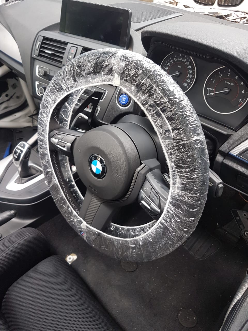

Then we fitted the M Performance V2 steering wheel with display
All wired and up and working

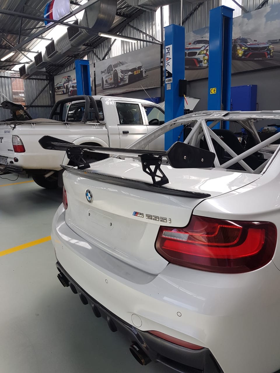

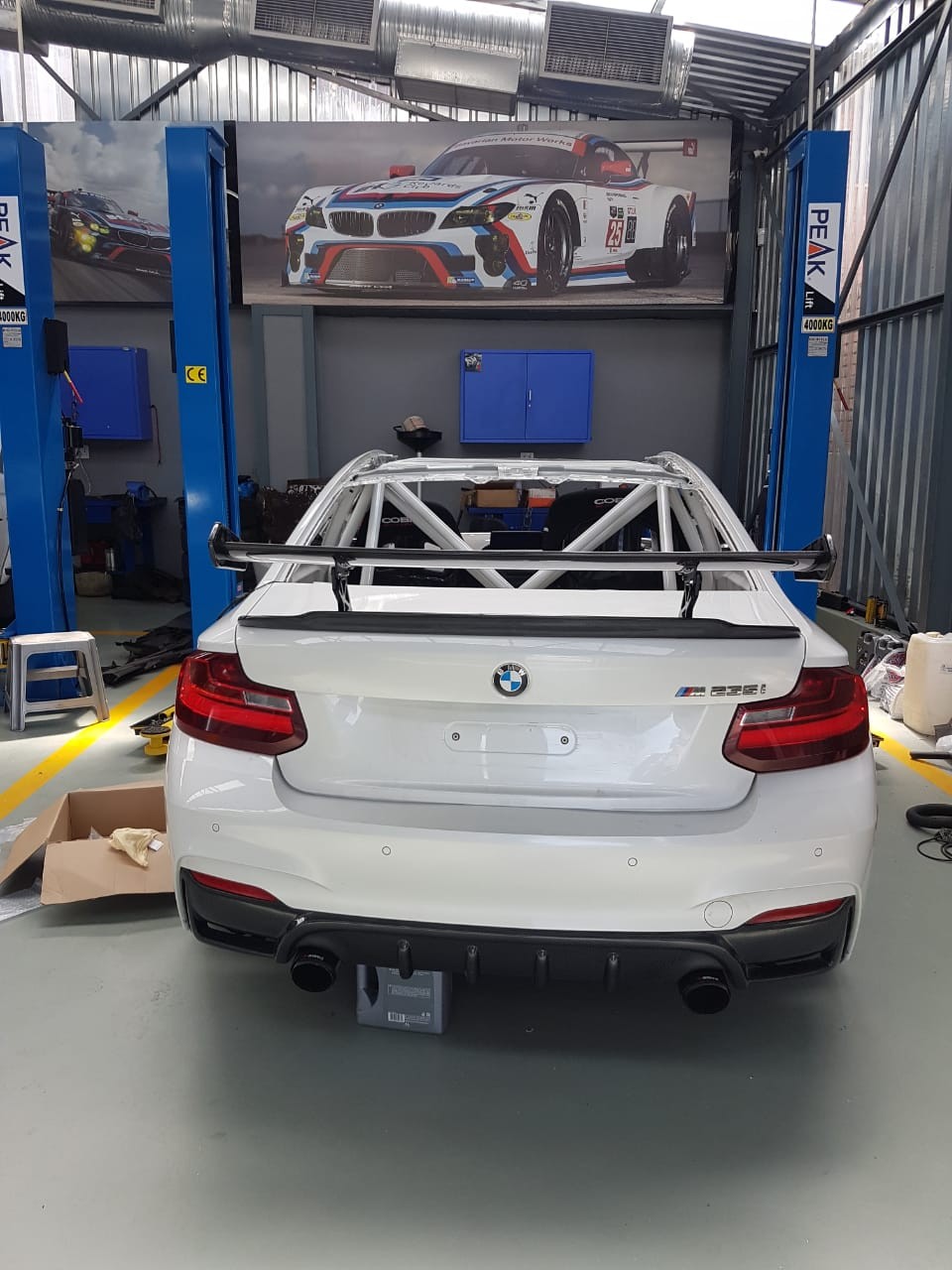

Finally the M4 GTS spoiler,
we debating removing the carbon lip but its on with SIKAFLEX and risk damaging the paint so for now it stays as we running out of time

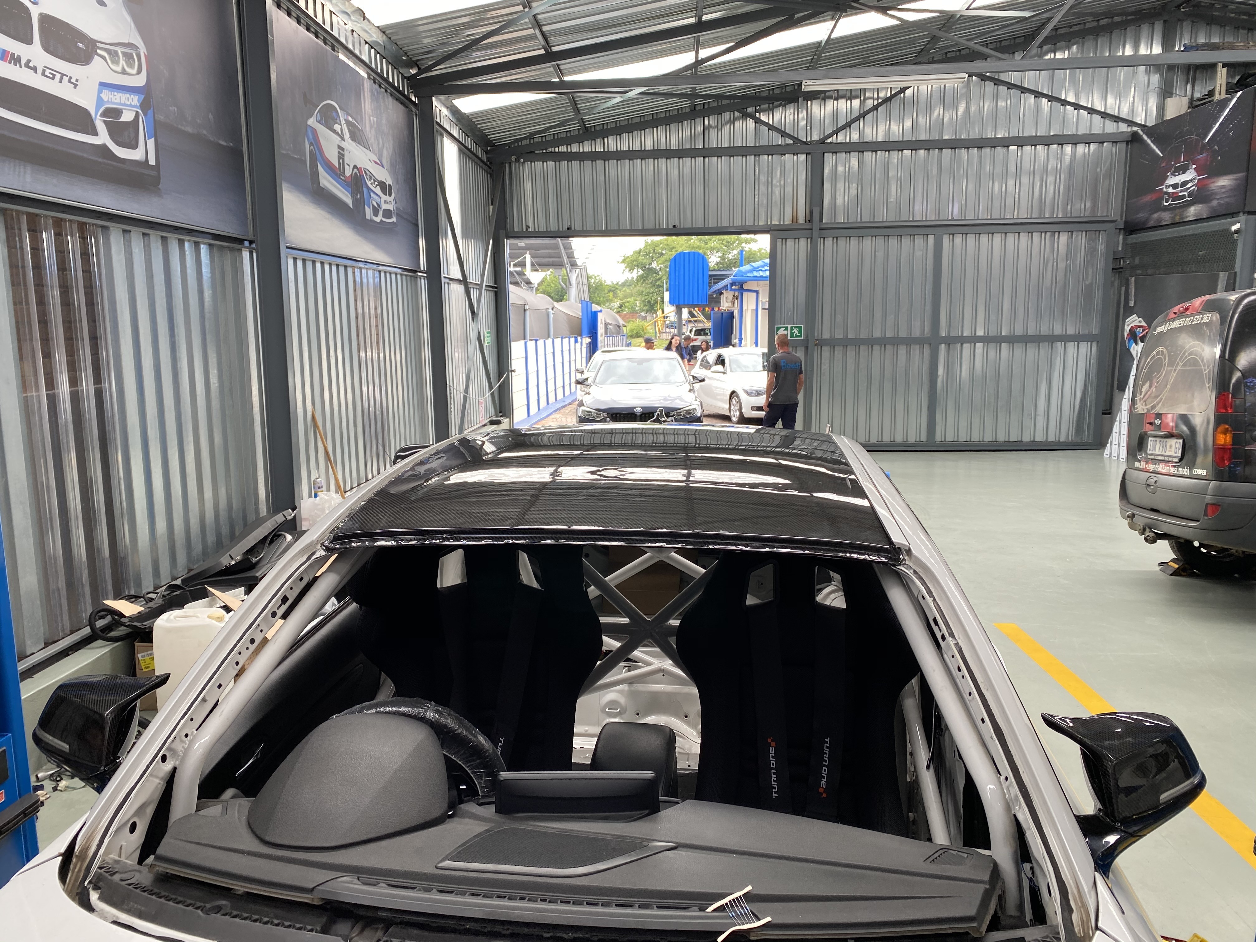

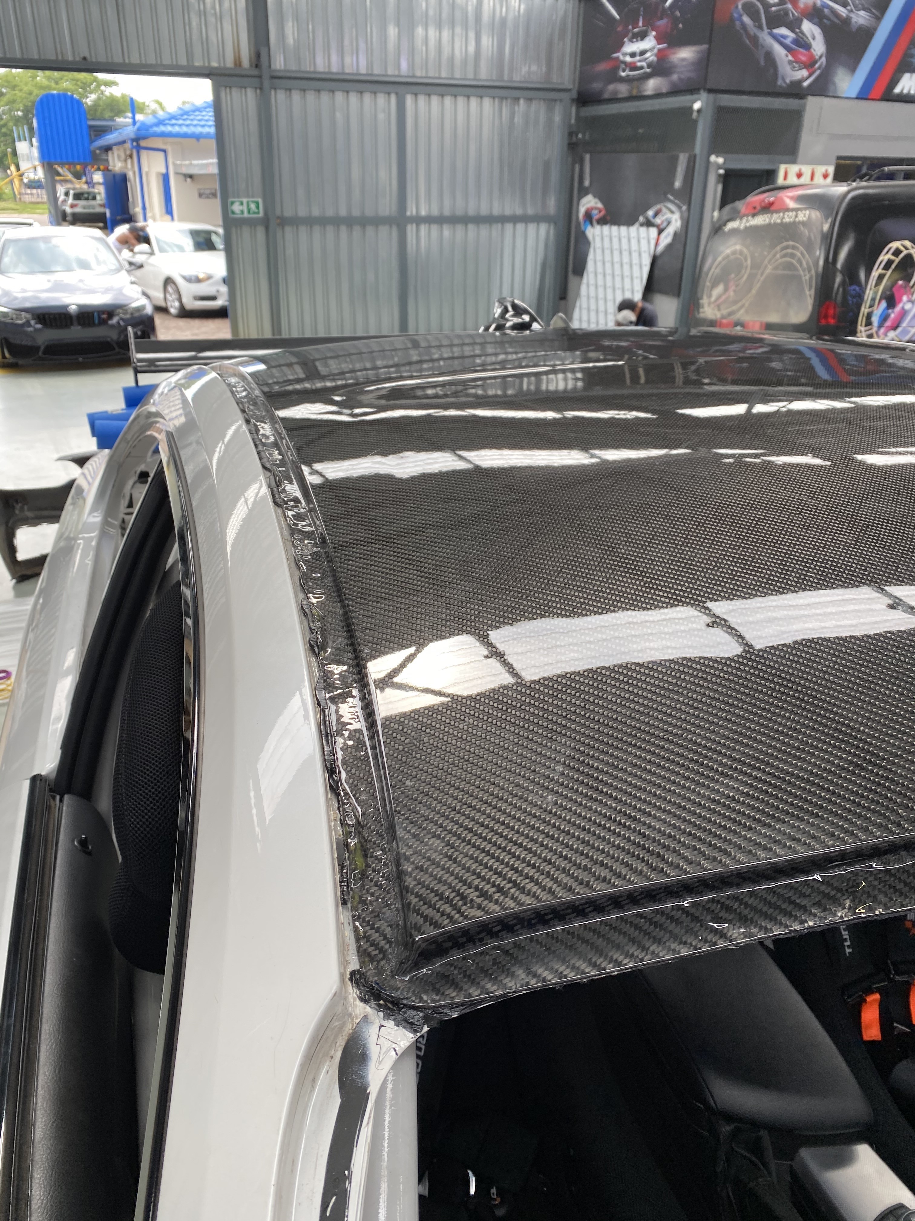

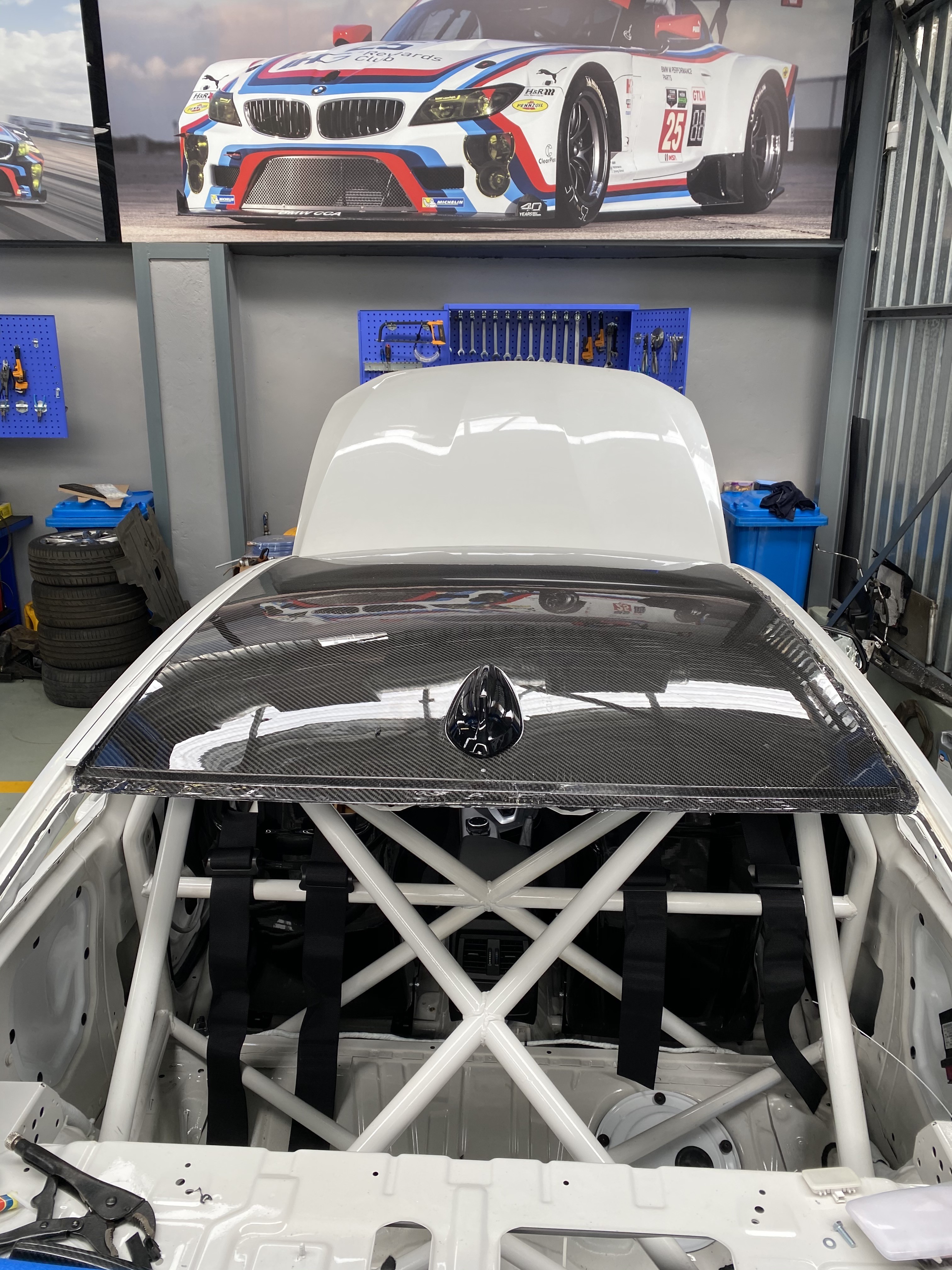

First up... The roof!
Its beautiful... custom made by FSU Developments
Carbon with a Kevlar inner layer

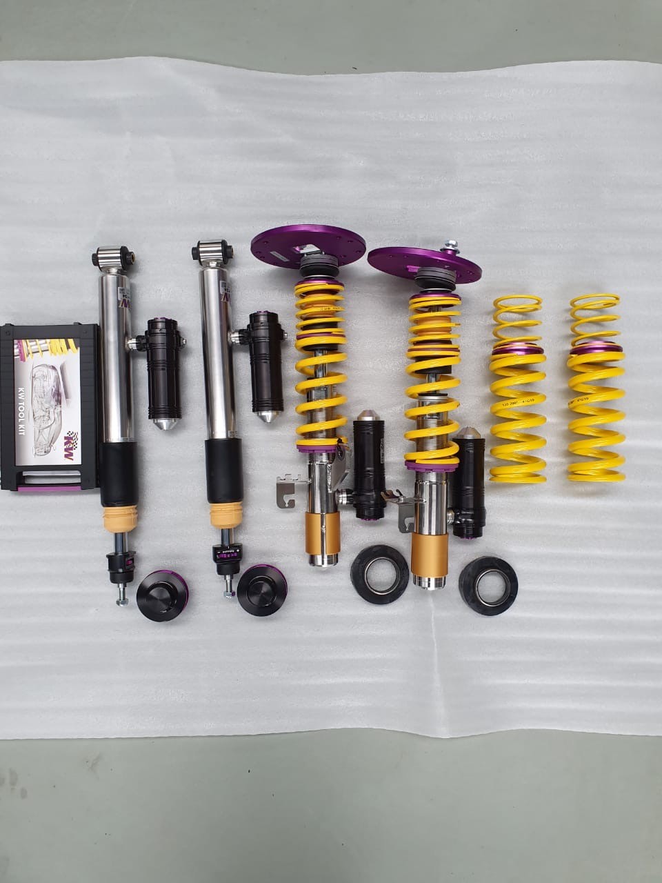

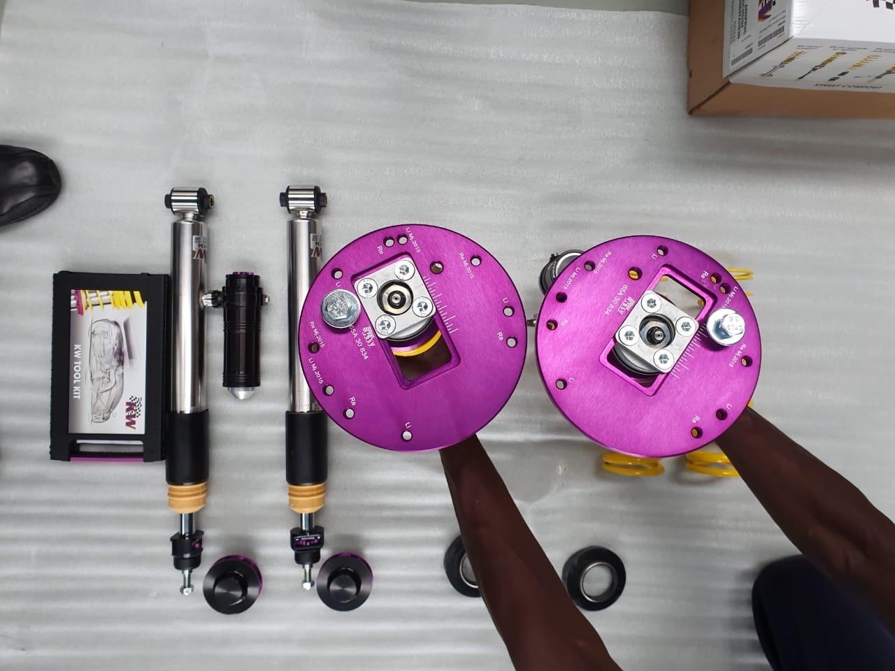

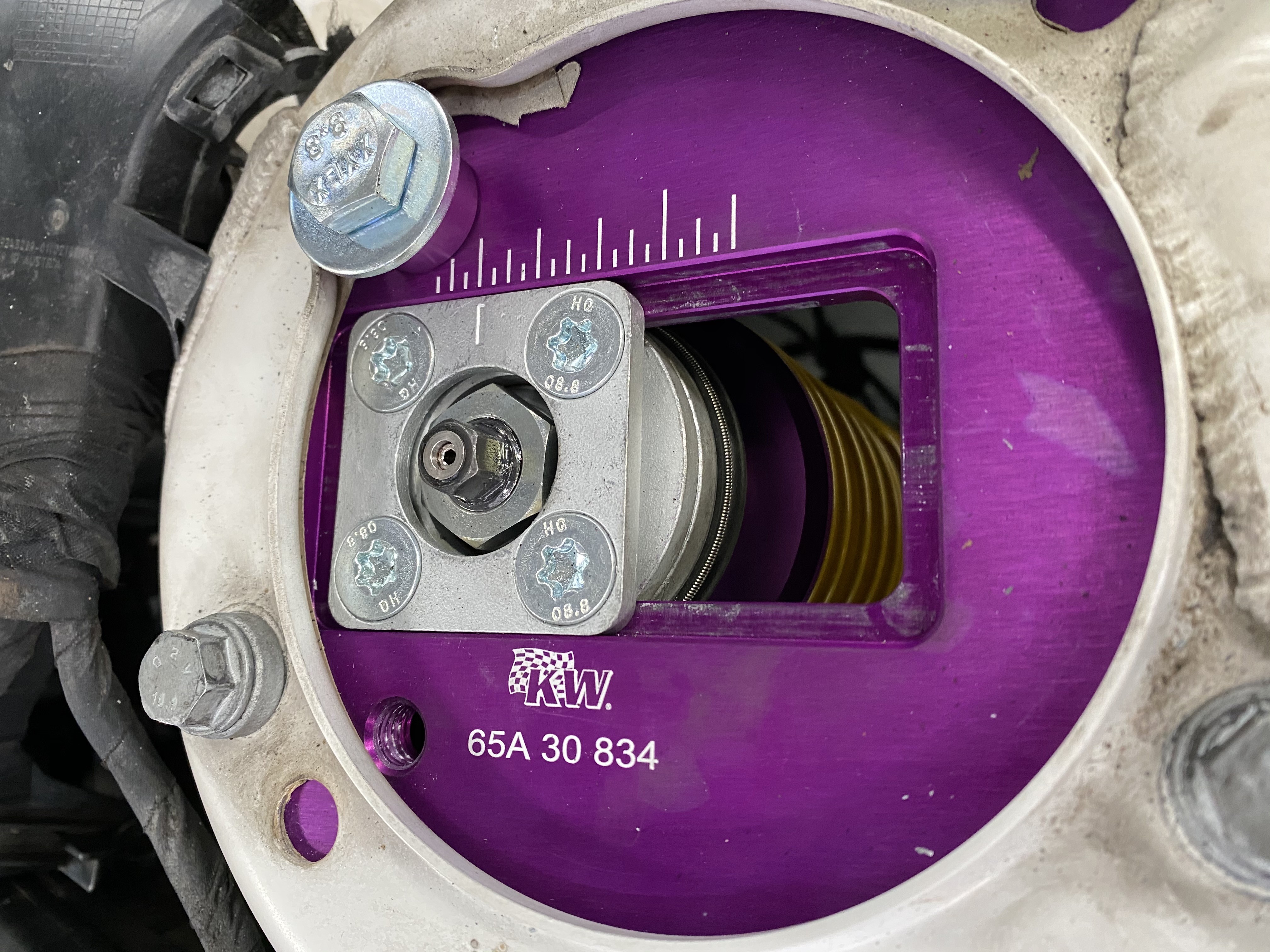

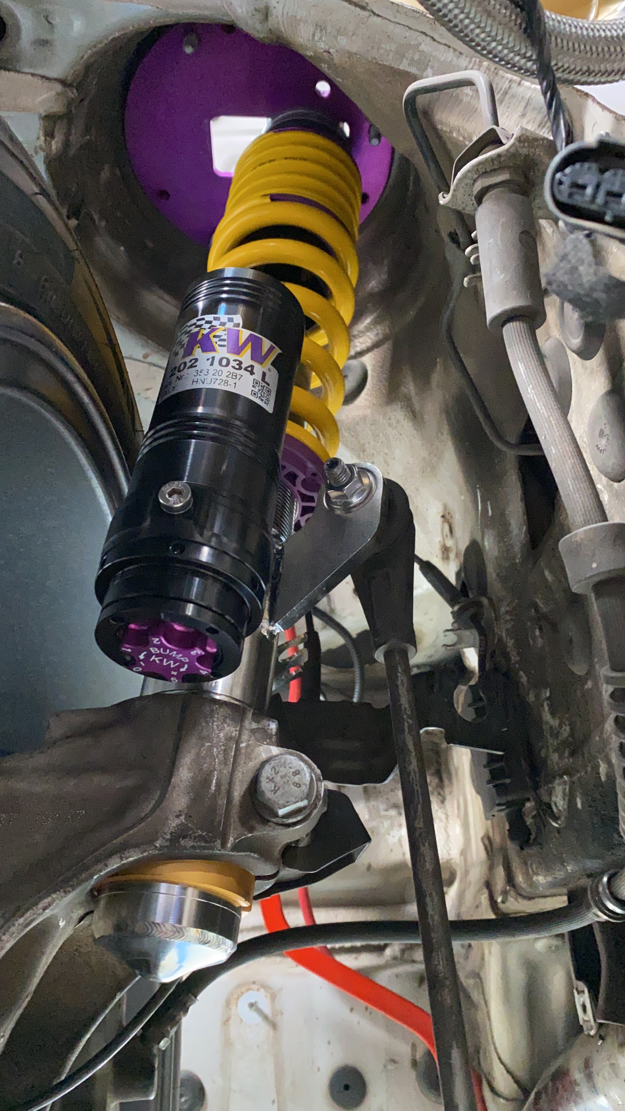

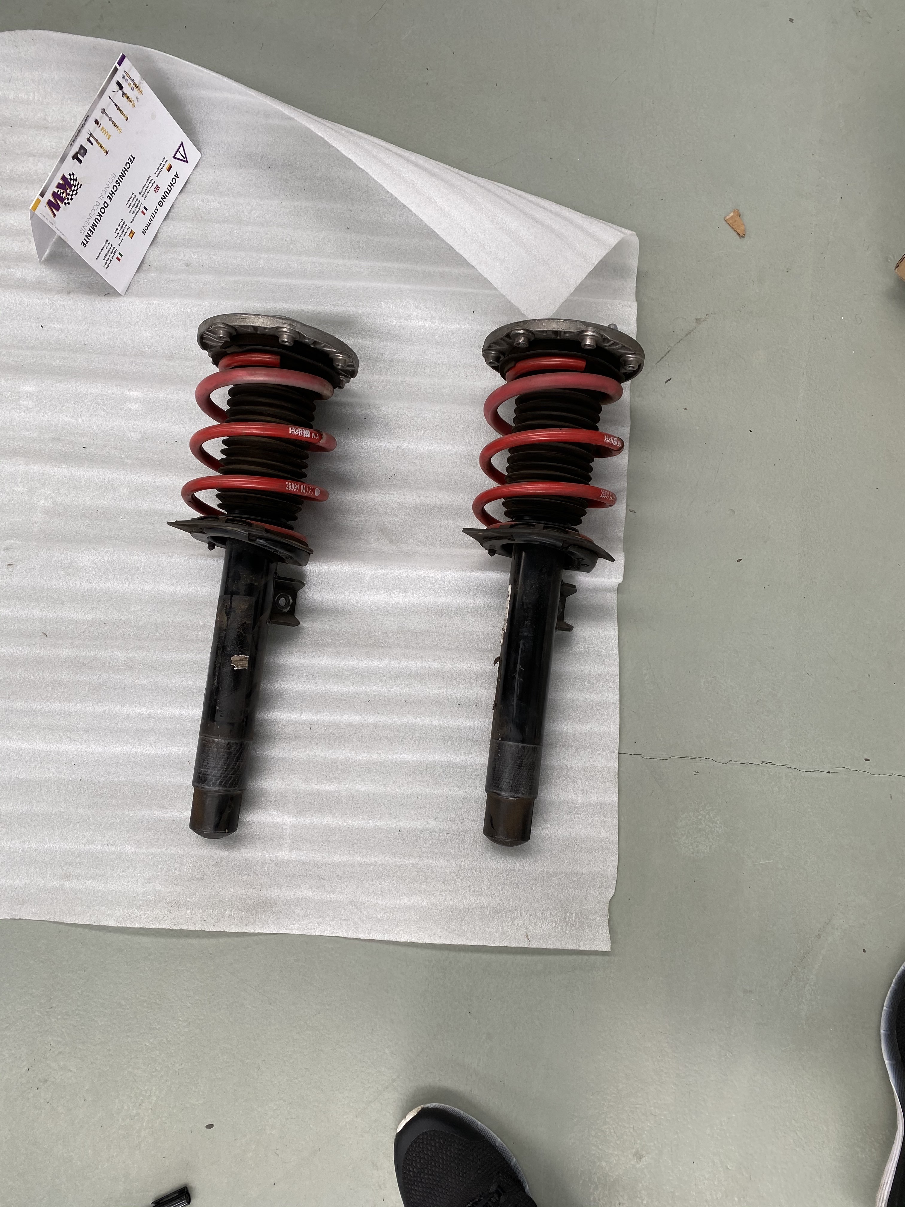

Next up was the KW Clubsport suspension
Old stuff out-
New stuff in-

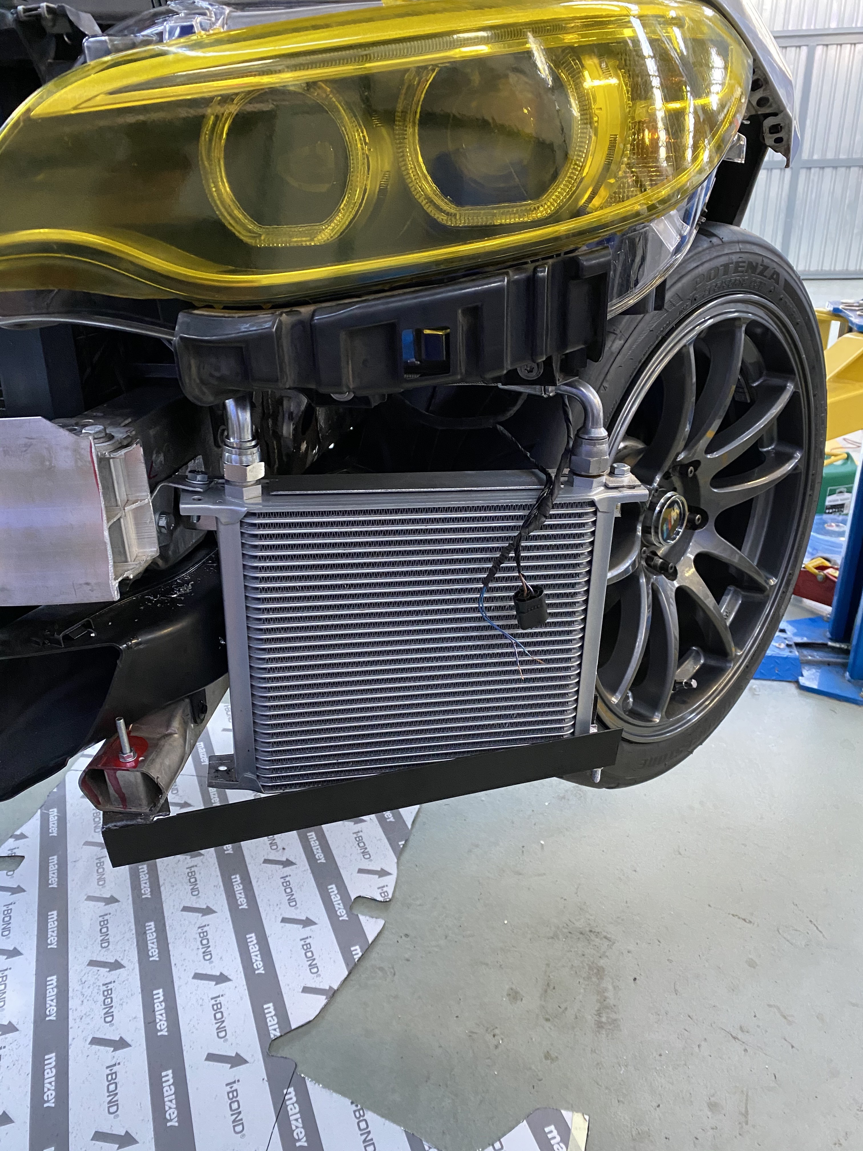

Then we sorted the cooling piping out...
One for gearbox and one for oil.
Oil cooler is 130% bigger and the gearbox cooler is 200% bigger

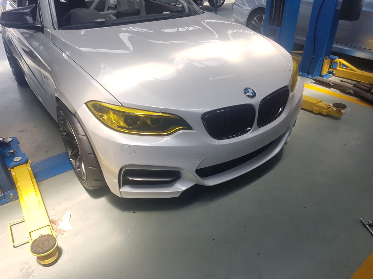

Next up: custom made a front splitter... liberal use of expanding foam to seal gaps and improve aero, it will be cleaned and painted

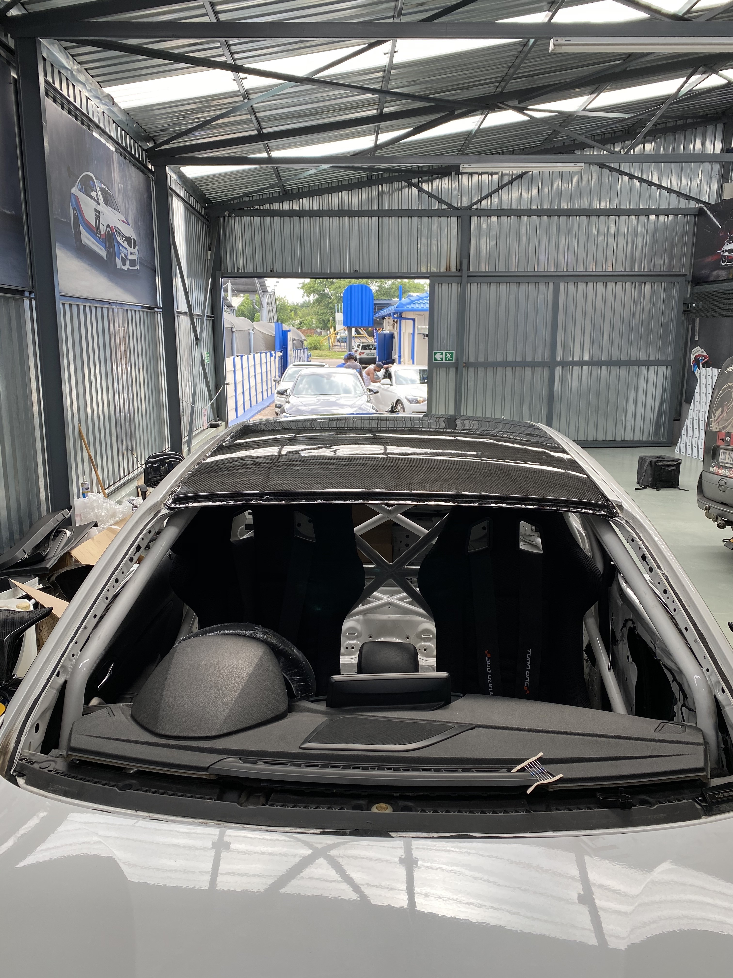

Roof was in and secure then we refitted the windscreen and replaced the rear and rear side windows with aircraft lexan.
Front Splitter we made and fitted, Extends all the way back to the gearbox,
You can hang off it- so definitely is functional.
Will take pics once its on and we remove the protective film.
We chose I-Bond its a aluminium and polyethlyene composite thats light and rigid!
