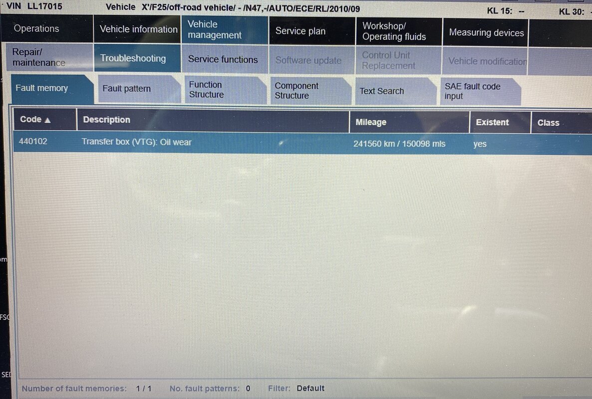

Not issues so far. Only on Ista , code comes up as oil wear.
The TC was not damaged.

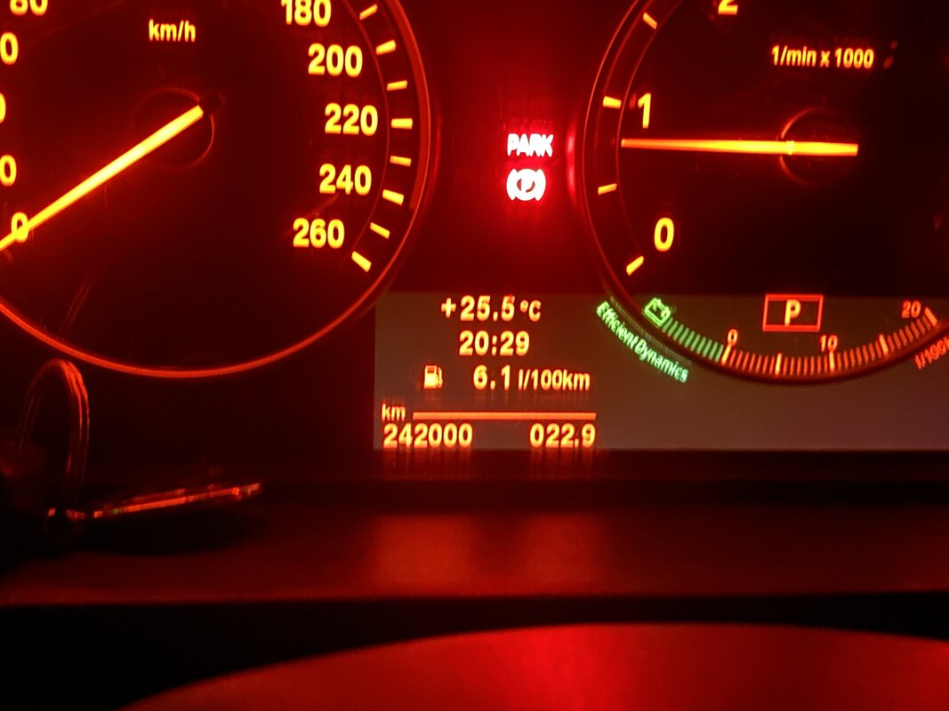

My one did not break off. I think the 2nd owner removed it cos he did not have matching tires. Now too,my two front tires and rear have different tire ware. On the road still drives well, even in wet weather on the N3 at higher speeds(+120) still sticks
242000kms still runs smooth.
It’s like having a s drive F25

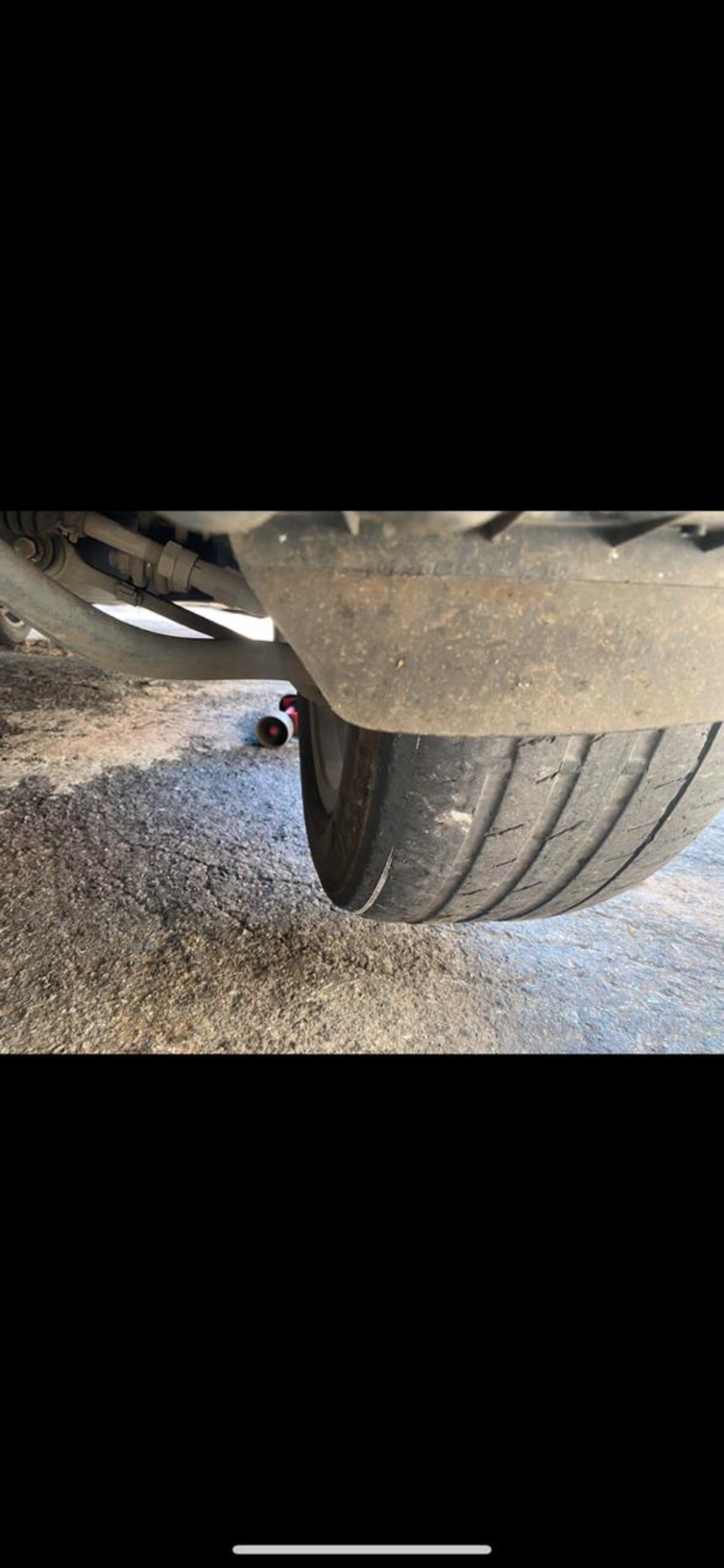

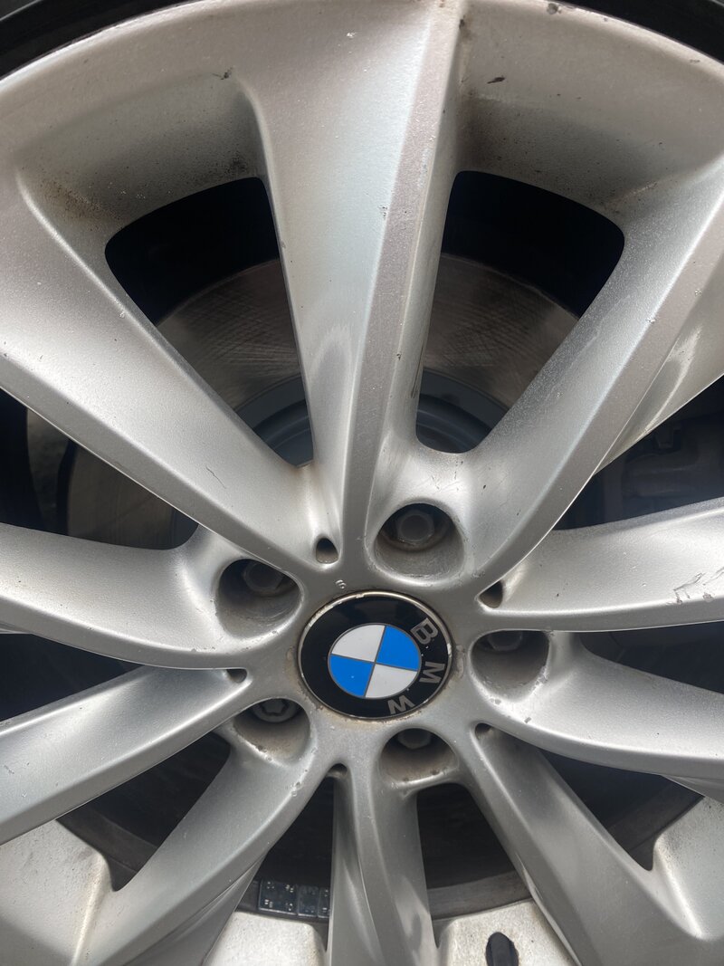

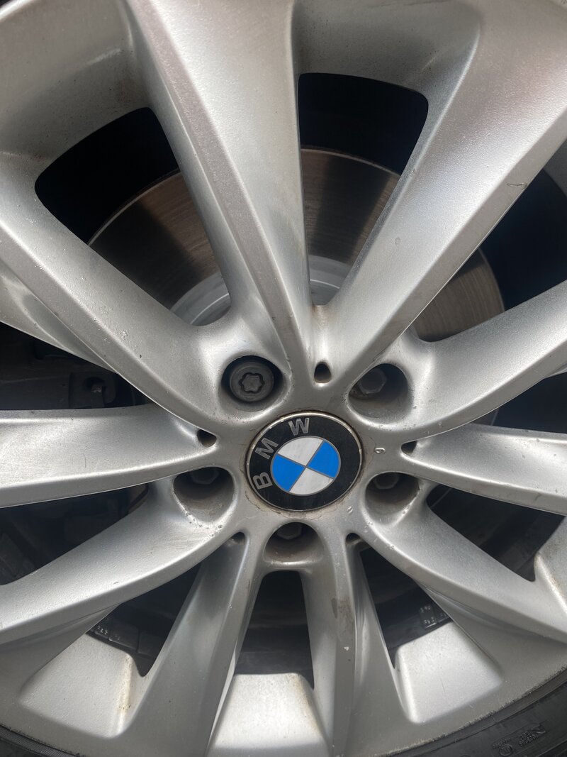

Out of interest, was the wear on the front on the inside of the tire and do you have a shudder at the rear when turning at low speeds, especially on smooth surfaces like shopping centre parking lots?

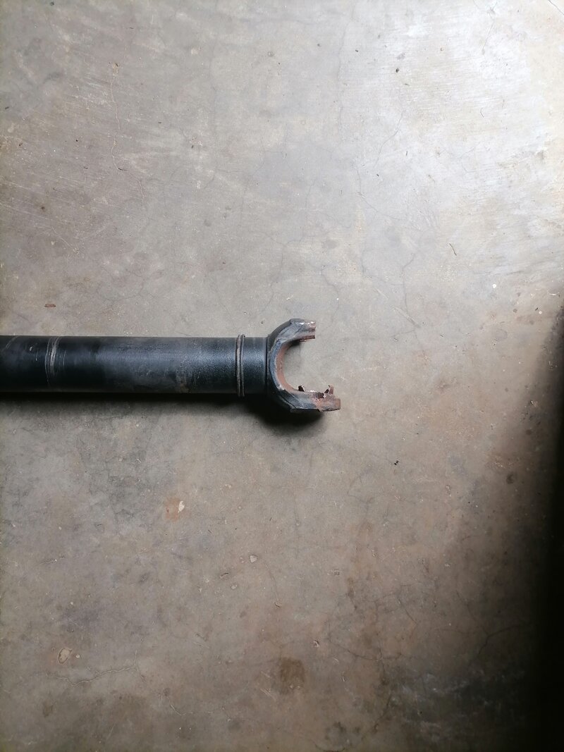

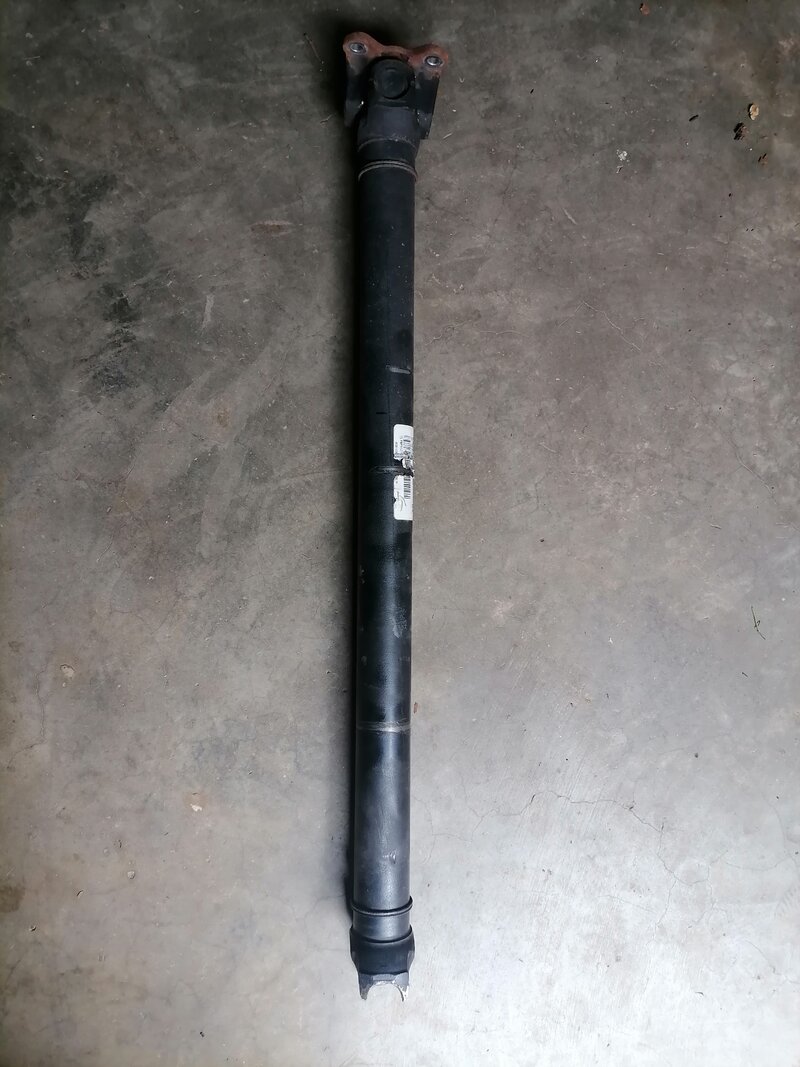

Attached is the prop and the clock. Reading around it looks as though it was time for replacing. There is a tell, when rust forms on the ends of the shaft. Apparently this is an x drive thing. Mine just failed outright, no vibrations or sounds prior.

Yes I did have tire ware on the inner fronts. But I travel a lot up country kzn, and the back roads , pot holes bumps etc, so my alignment did go off very little. Yet I do my alignment every 8-10k when I do my oil service.
Vehicle has no shuddering at any speed, or braking hard. Or at low speed on bends and taking turns.
Your prop definitely broke cos of rust.

That tread wear is a natural to the x3 I believe, I had the same with regular alignment also. Rotating the wheels every year is what I do now on the advice I received from my local HI Q.
It is interesting that you don't have low speed turning shudder at the rear. The fact that you are running different treads and don't have is probably due to being RWD only.

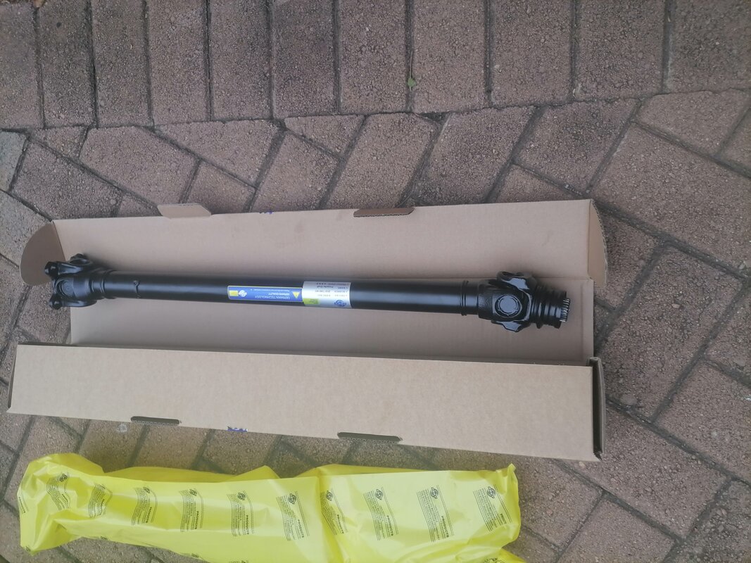

I have purchased a new propshaft now, R2950 at Beeline Spares, hoping to get it fitted in the new year when our machie gets back from leave.

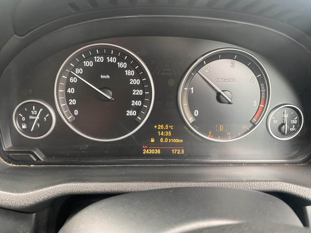

Been a while since I gave an update on my F25. 243000kms and still going strong.

FILV
Is your cluster suffering from Jaundice? 😕
LOL this seems to be common on thsee clusters. The F10 i just bought has the same issue. I cant find any info on the overseas forums regarding it. Im guessing the led wears out and turns yellow?
