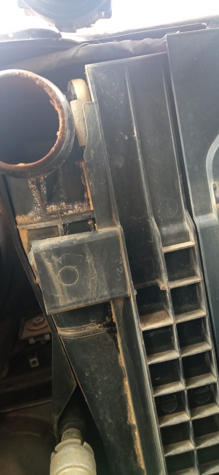

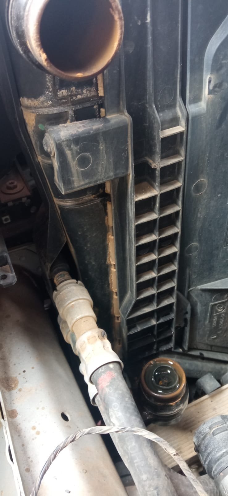

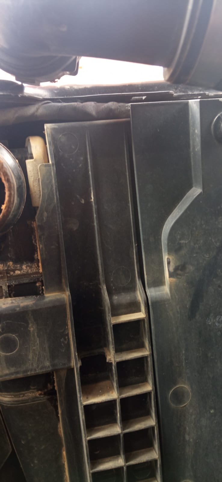

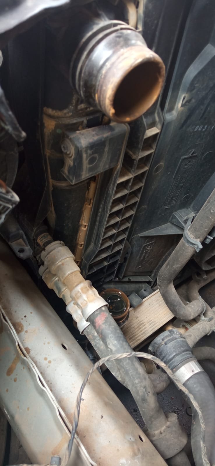

Attached some pics after removal, I will rather wait for the pros to come and confirm what I am looking at

From experience, if you want to replace select items, this is what I do.
1. Expansion tank = must with oem. If you dont know the car history, replace it. Lasts about 20-40k km, random.
2. Thermostat = is expensive and usually fail open, so your engine will never get to temperature and with the temp gauge hack this you can wait till failure. So I usually skip this
3. Waterpump. When this fail, engine overheat super fast. Not so costly so definitely replace.
4. Pipes are easy to spot. Generally the top pipes wear out much quicker as they carry the hot coolant. lower pipe/hose last much longer. I would do lover if you replace radiator.
5. Radiator, Id be surprised if this is leaking, but if it is it is generally a slow leak so I would only replace if it is leaking
For slow leaks, usually cheap or free to get a pressure test done at any shop
G10
Going to do all of these except thermostat unless mech says it is faulty.
Looks like the ET was replaced before, the one I pulled out is a Febi
