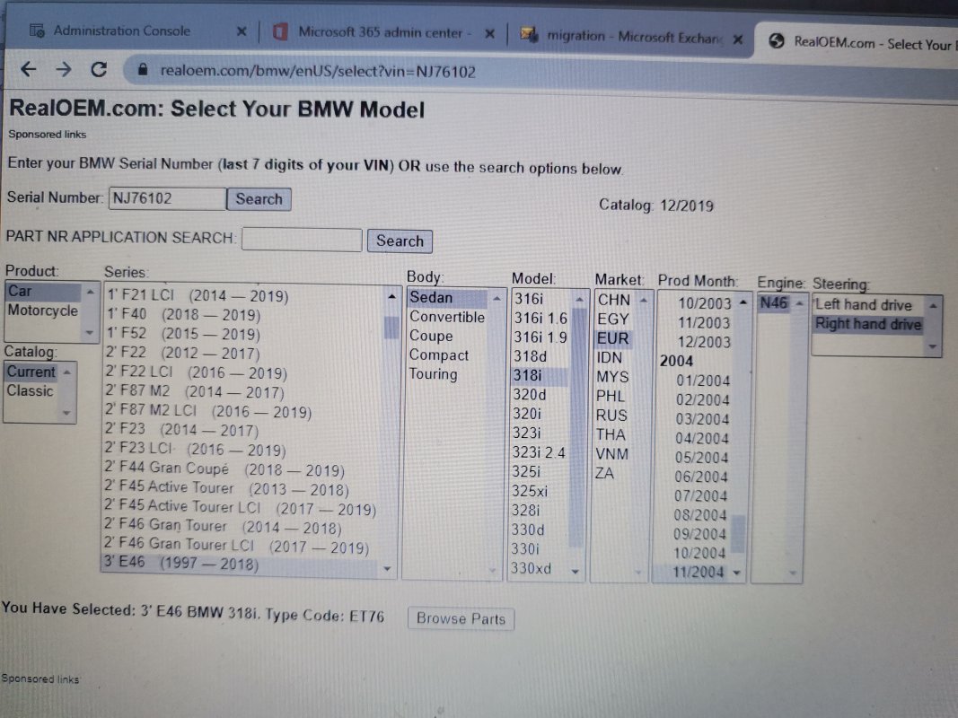

Just Won this 2004 318i E46, with the N46 engine in it, on Auction yesterday.
build date is 11/2004 but pretty base model
Its a clean vehicle With some rust on the front left an right pillars

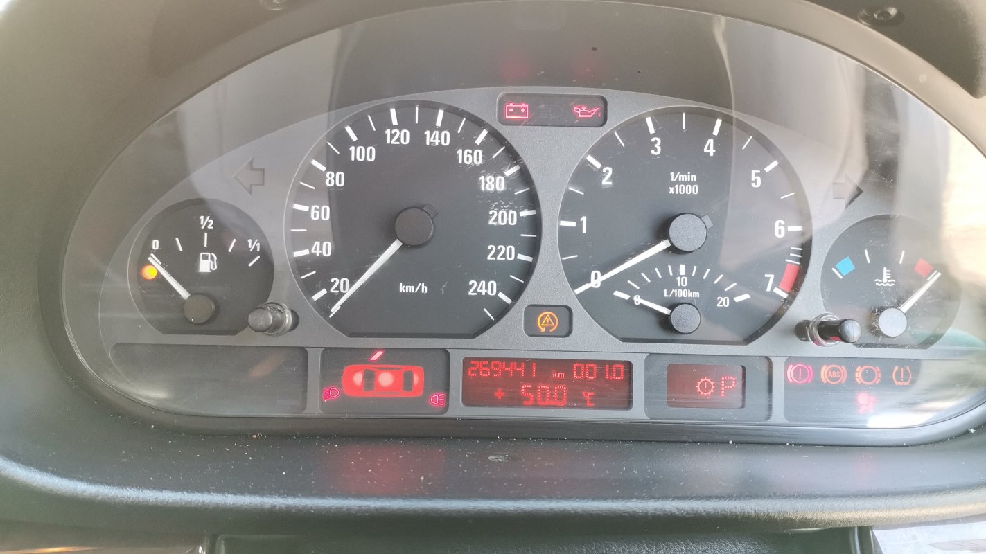

When i collected the car, Noticed few issues.
1. There was no brakes (very very very little)
2. the Rev Counter did not work
3. at Cold start, the Temp Gauge would Max out in the Red (no overheating light at all)
4. Battery light is on, Abs, traction, Brake ware lights are all on.( Christmas tree )
I managed to drive it home but the Brakes Locked up on me.
Pulled Fuse 61 in fuse box and the Brakes freed up and Drove home without brakes binding

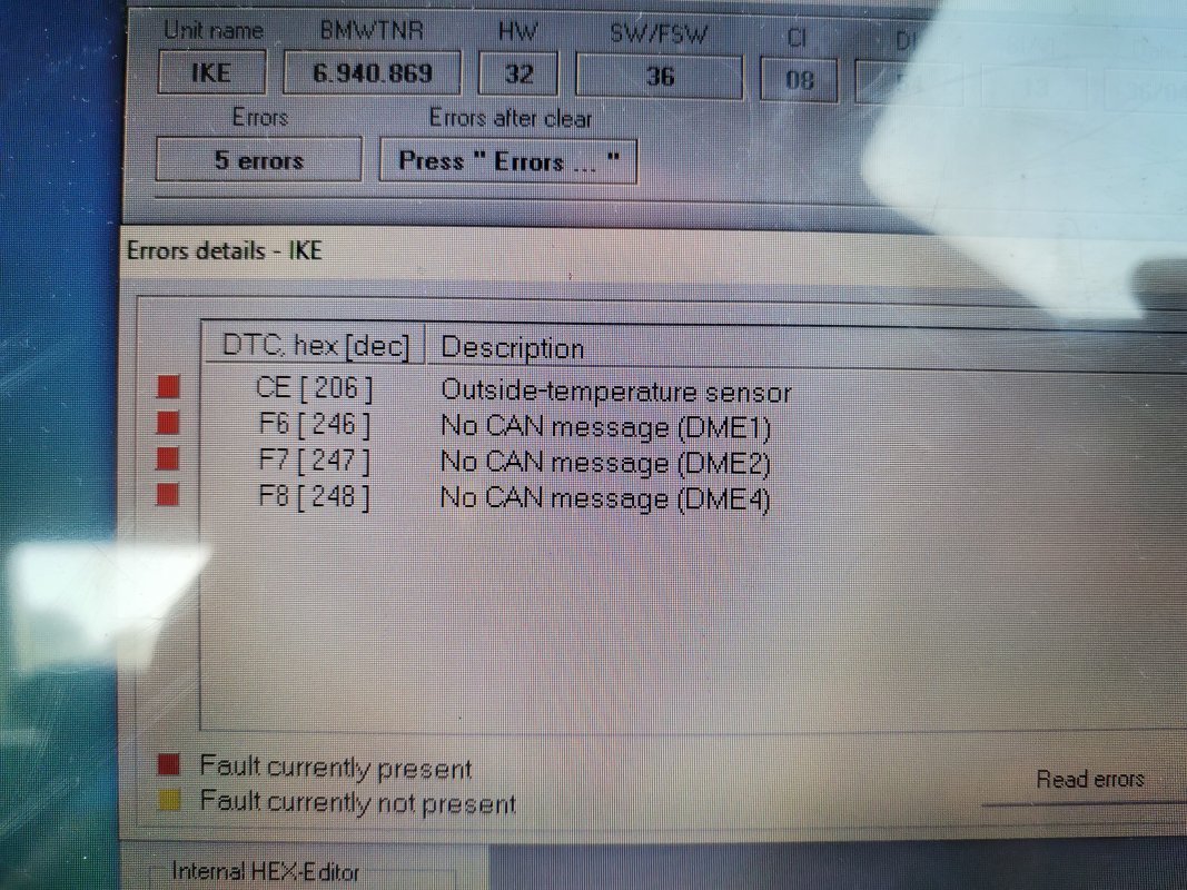

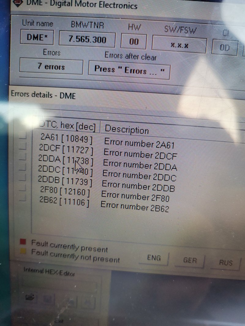

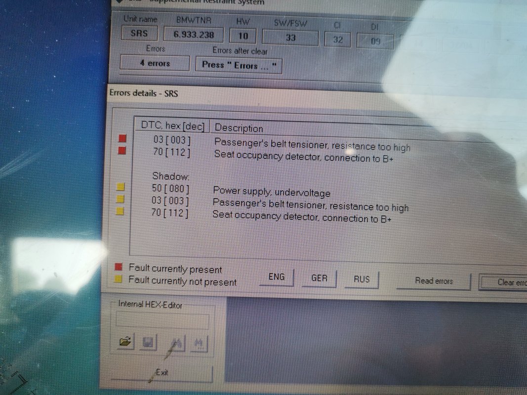

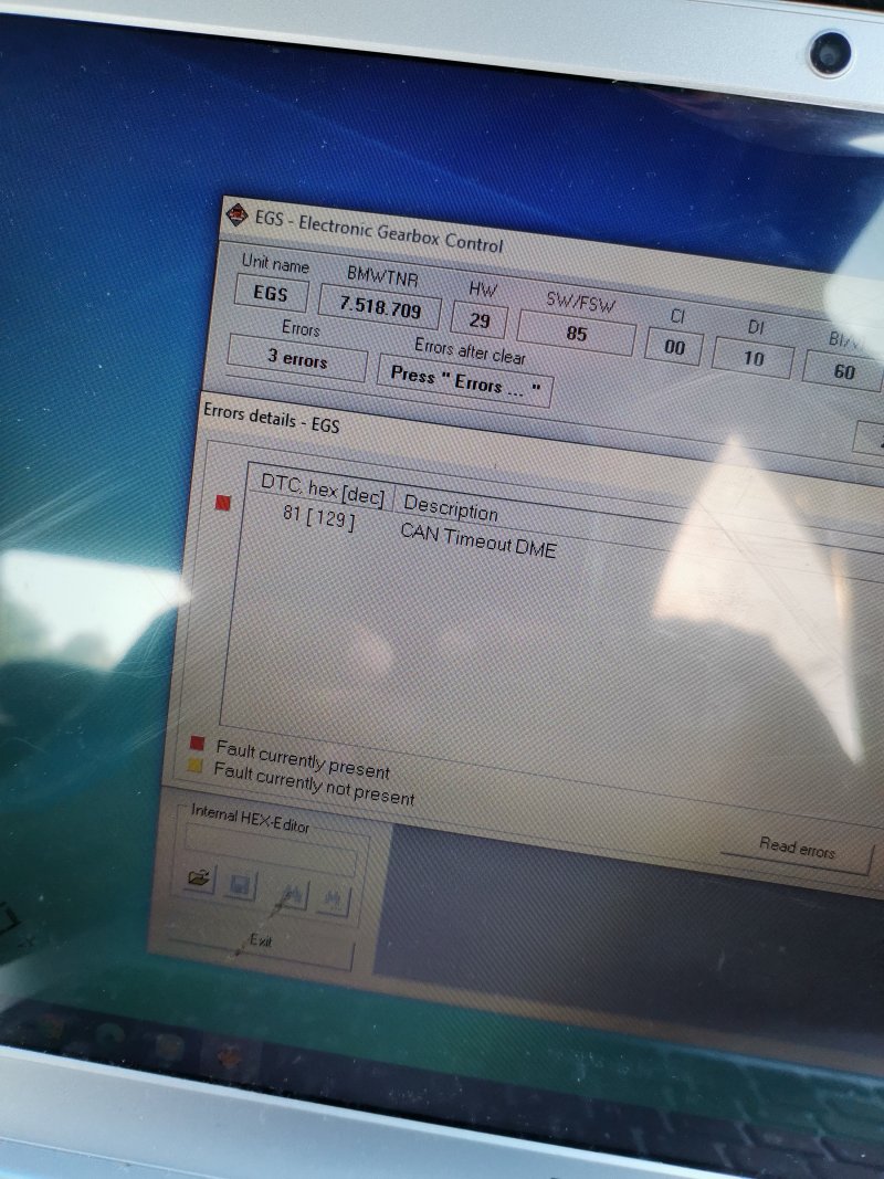

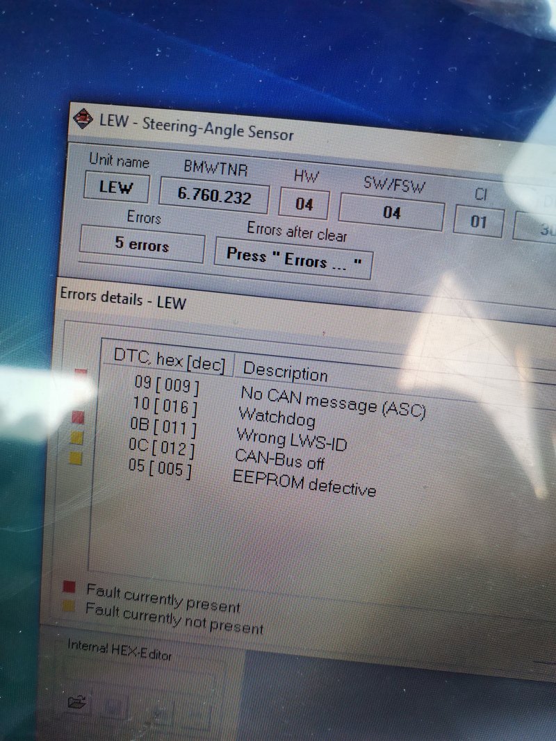

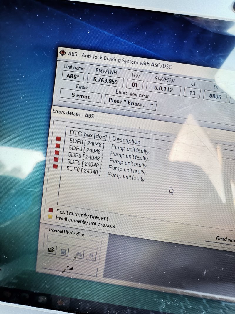

Scanned the car with PA Soft when i got home and Weird errors i have never encountered before
DME is the strangest:
Here is the rest:
I have done the cluster test = PASSED
Removed/Checked the 3 fuses for Cluster = Not Blown

My Suspicions for faulty parts are:
1. ABS Module
2. ECU since PA Soft ONLY shows the VIN and kms on the Vehichle Identification screen before the scanning
- and because of the weird Errors

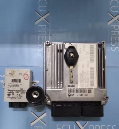

So i pulled the ECU from the car and This is what i found :| :
Cars vin:
ECU's Vin:
So im thinking its a "FLASH" issue or Its not flashed at all?
Strange how the car starts up and runs fine other than the cluster losing its mind and ABS not working
Could this ECU issue be the reason the ABS is not working too??
