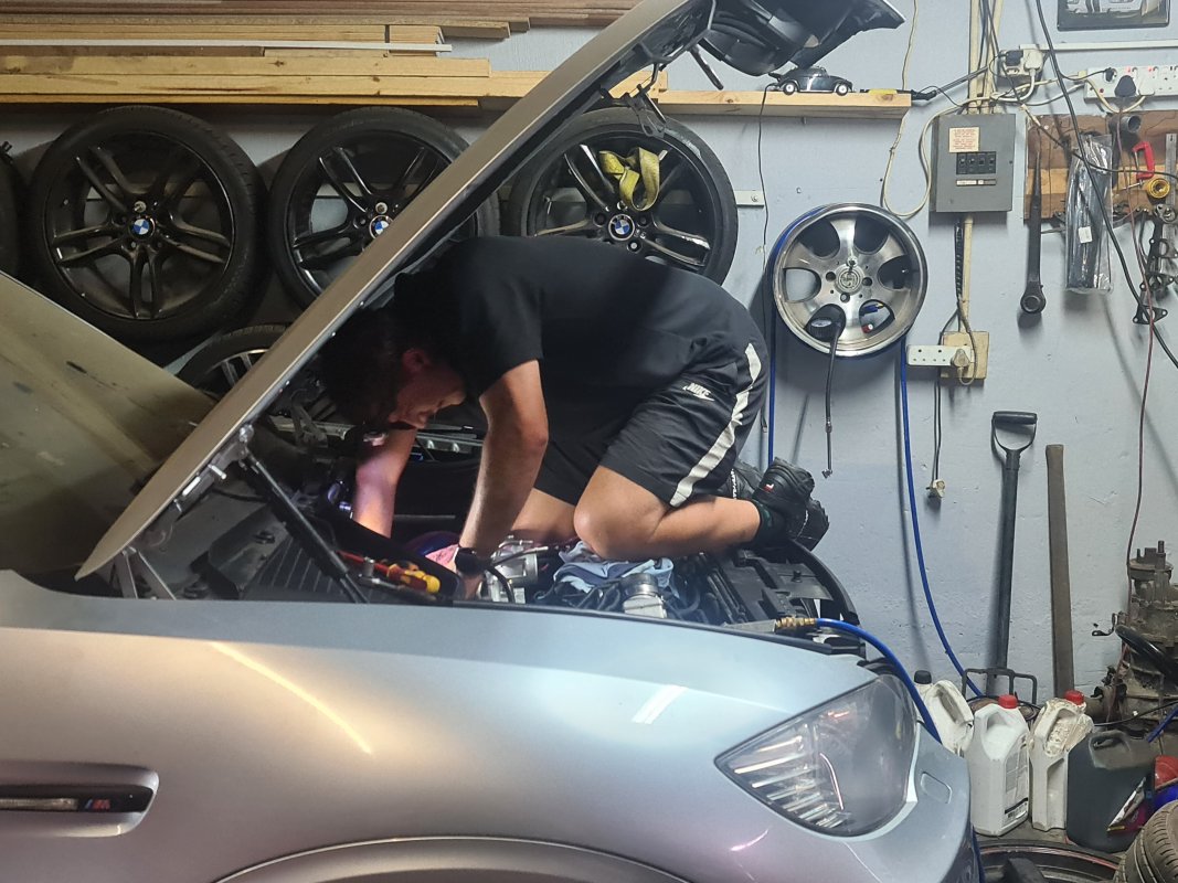

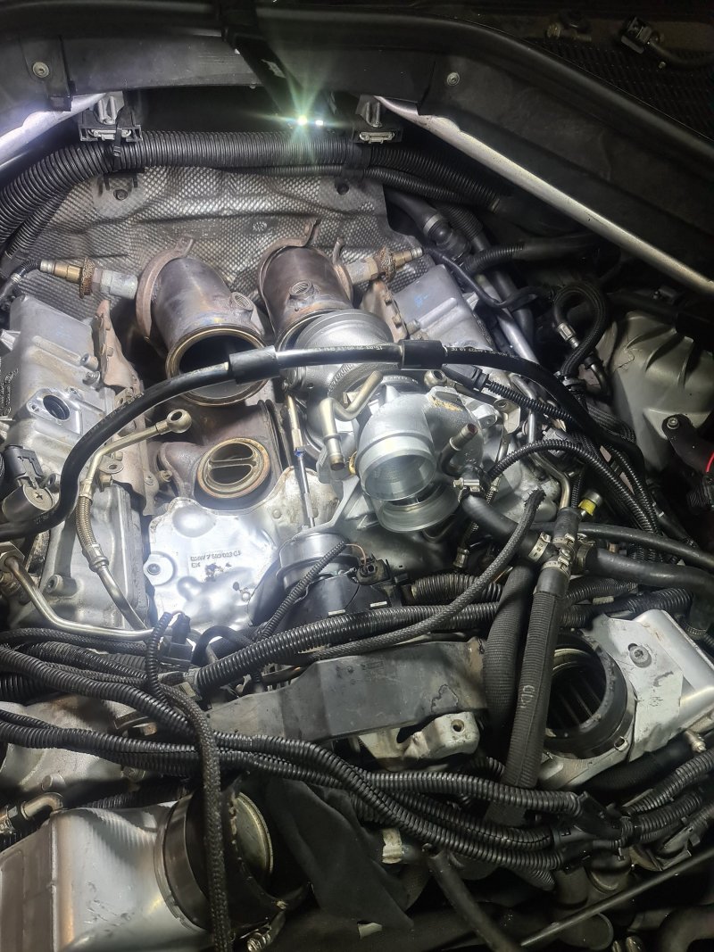

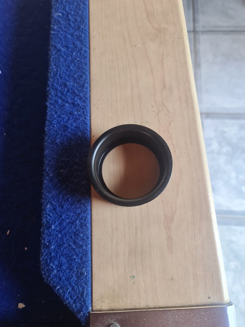

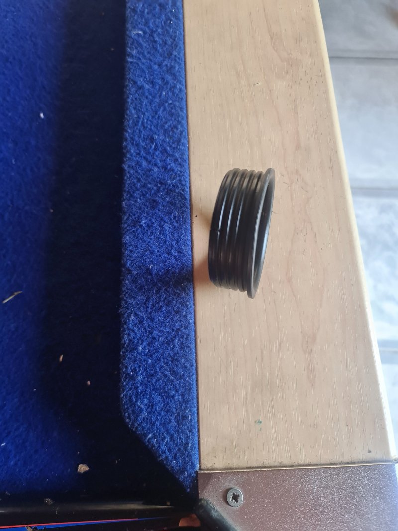

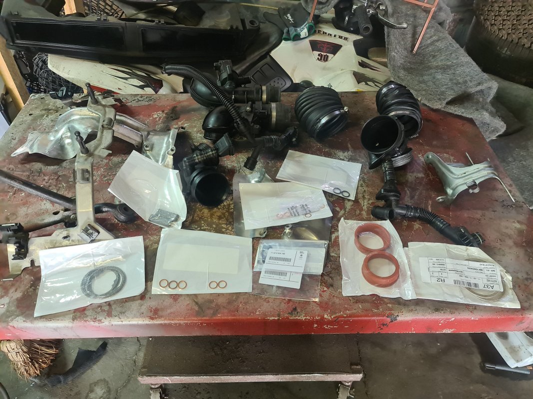

So the weekend was quite busy on The X, the second snail took a bit longer to get aligned and bolted on, space was very constraint. On a very positive note, the smoking issue is gone. FASTEC did a very good job on my snails. Main reason for the failure of the RHS turbo was the intake pipe rubber. They were hard and not sealing so dirt went through the turbo's. The blades on the rotors , could see they were "sandblasted" These rubbers is quite expensive and i would not have known this if i did not work on the car myself. Something to keep an eye on on other BMW models.
