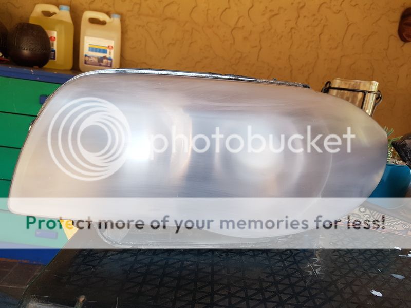

I sanded badly scratched lenses back, this was rather nerve wrecking as I have not done this before, but Youtube will teach you anything...
I used 400 -> 800 and then 1000 grit wet sandpaper.
Then it received its first coat of clear. This is before the paint settled.
I used Rustolium 2x clear, Its UV resistant and non-yellowing.
But more of this later...

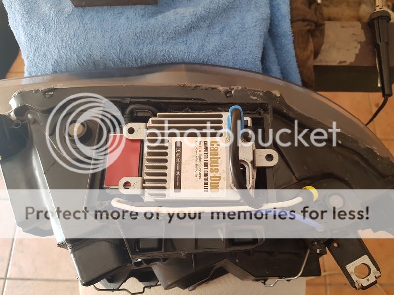

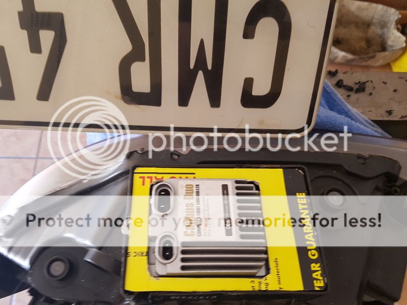

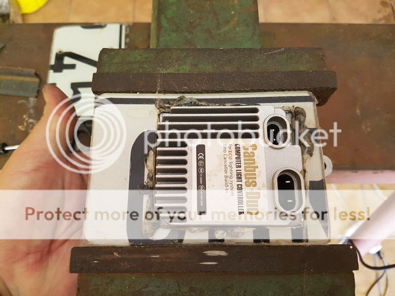

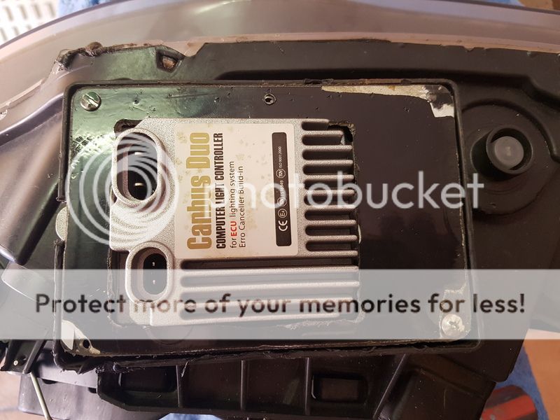

Then I moved to fitting the HID kit, as I was still waiting on my LED's to get from the Germiston Hub to Boksburg.

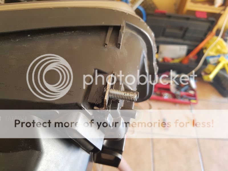

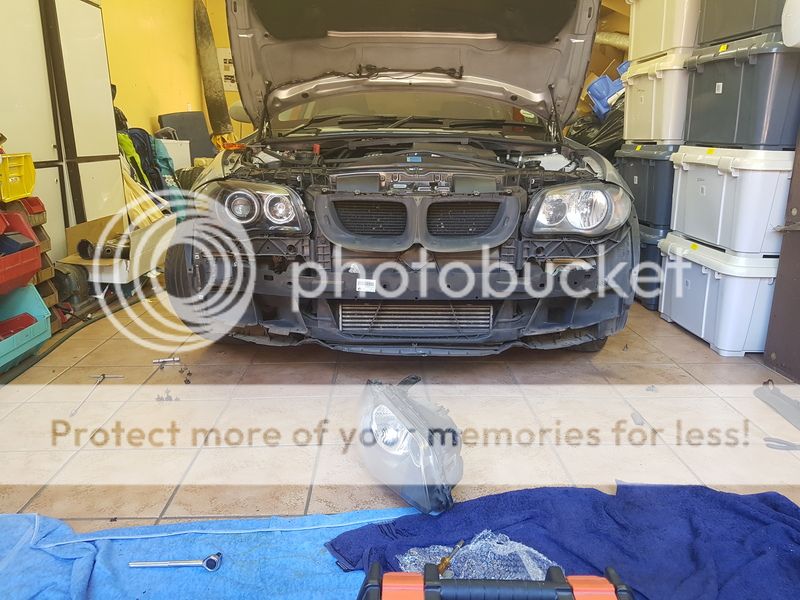

I decided to try and fit them in the recess under the lights and this was my process.

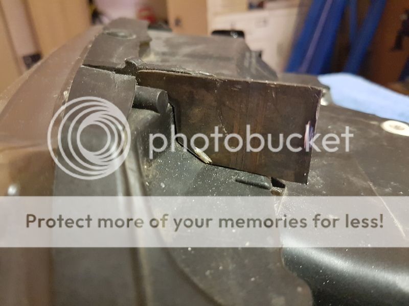

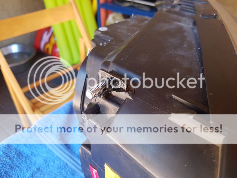

Also the 2 top brackets of the left side light was broken off.
Made new brackets and they fitted nicely.

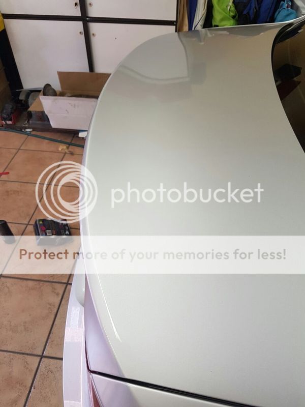

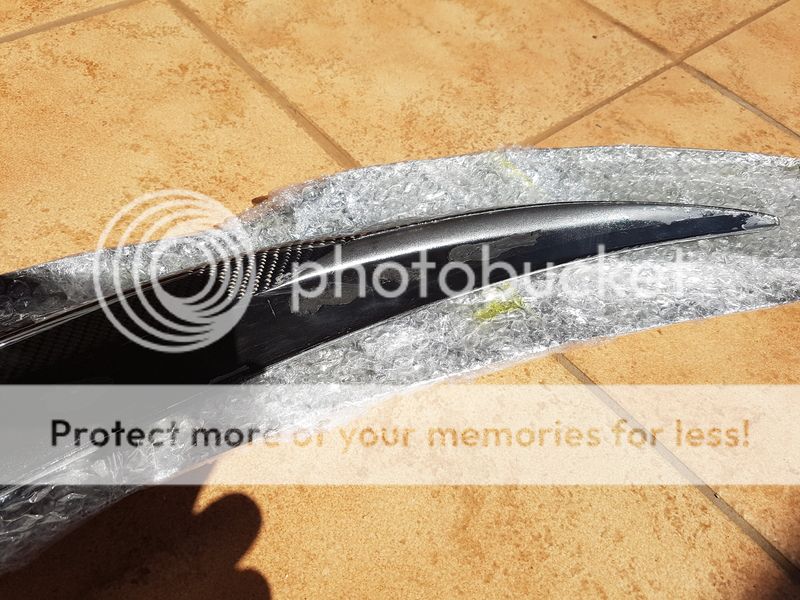

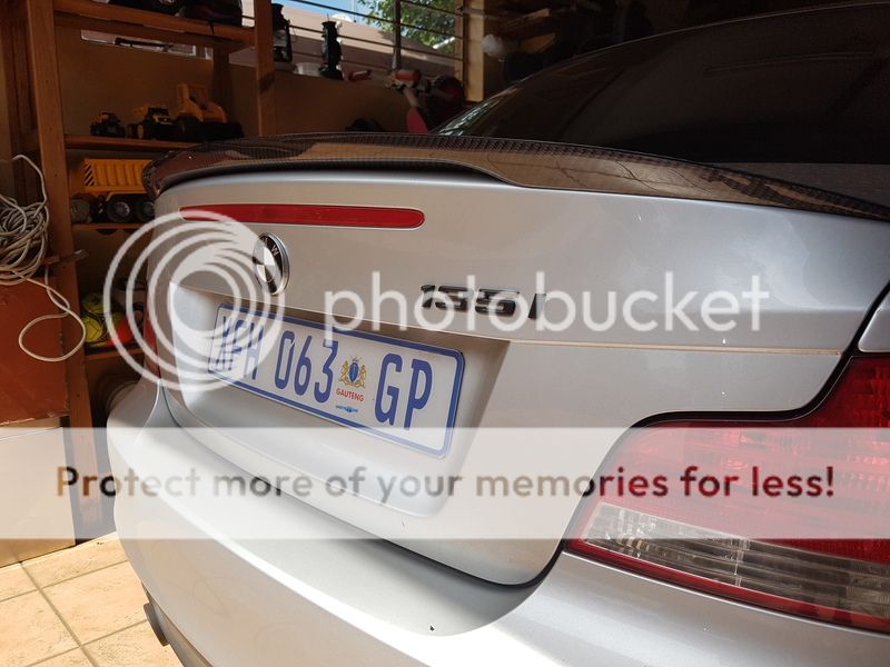

And then this arrived!

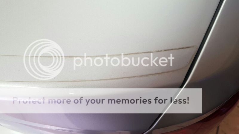

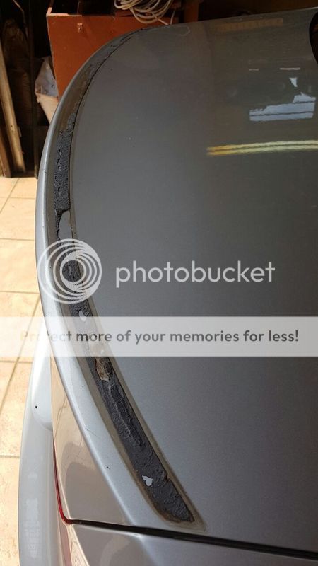

I immediately removed the old wing and man, what a mission.
And after removing all the old tape I was left with this...
Luckily some ScratchX sorted it out quickly.
Then it came to this!
I love it...

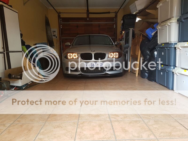

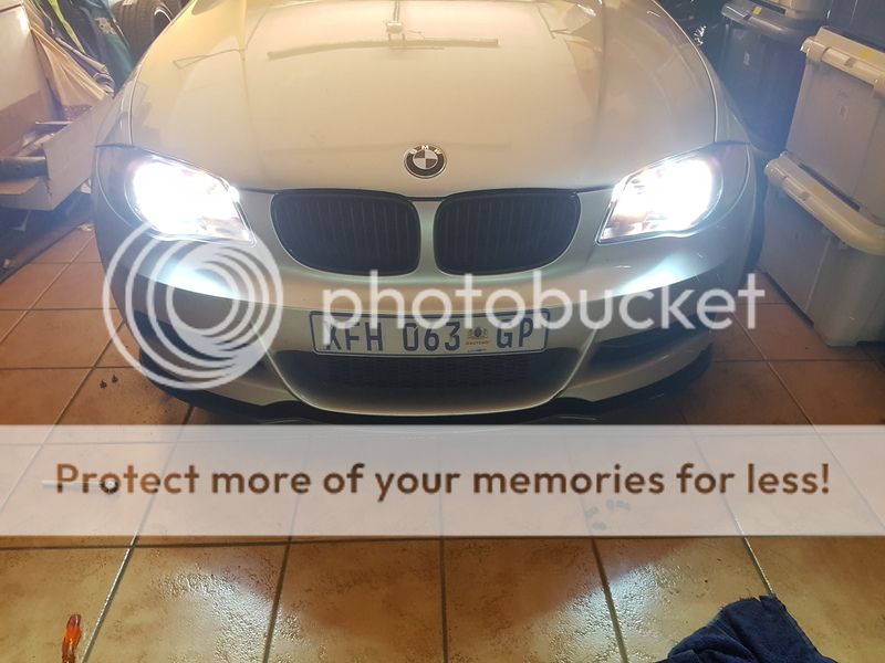

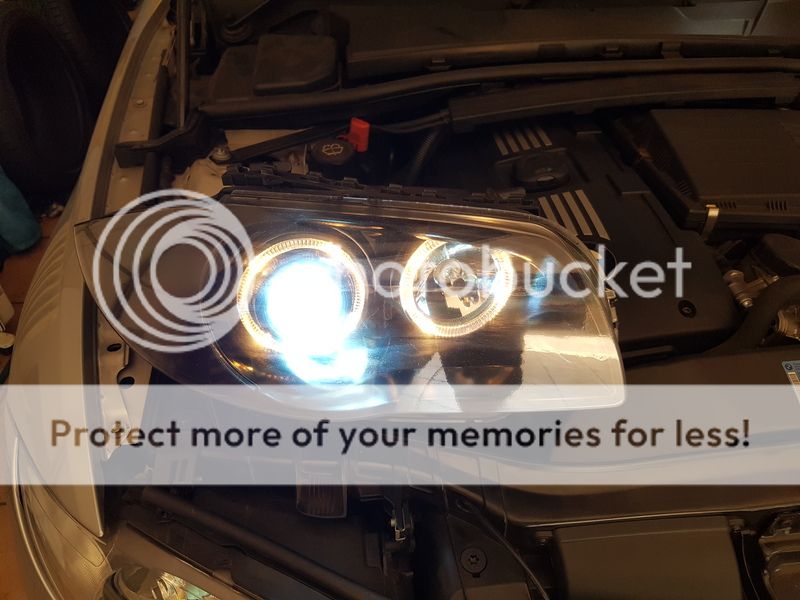

Then I just checked the function of the HID's and the Canbus cancelin.
Man I hate those Yellow rings.

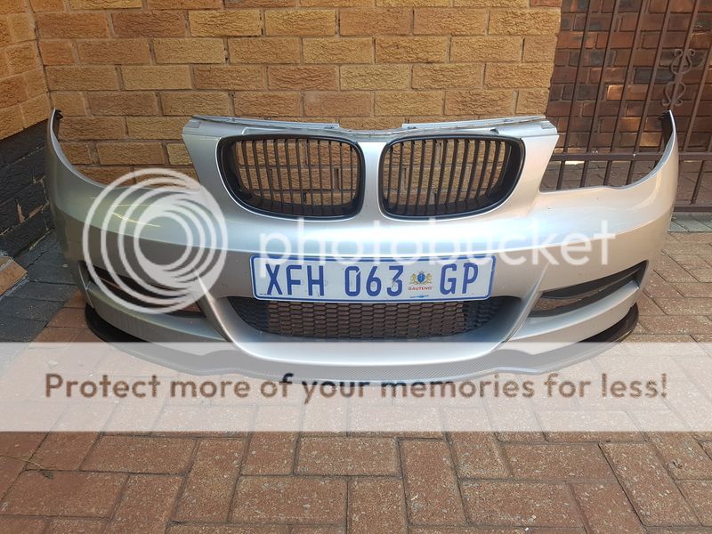

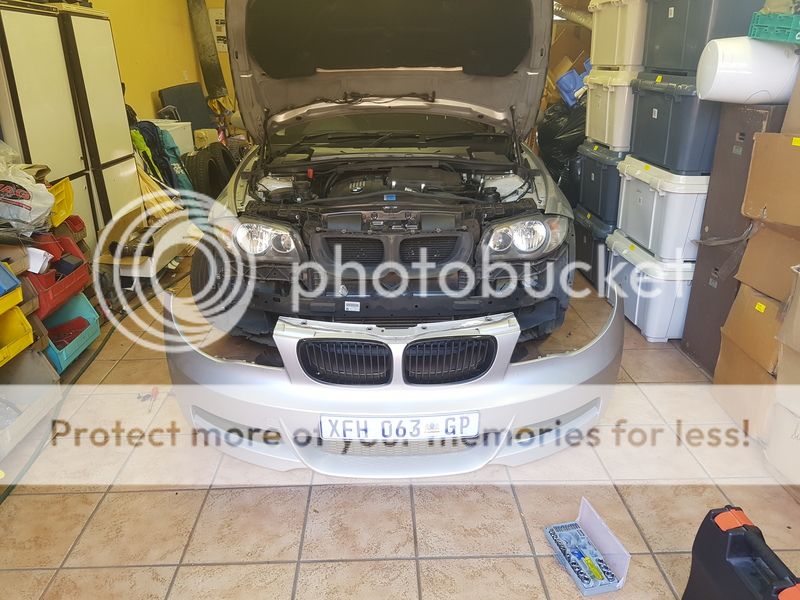

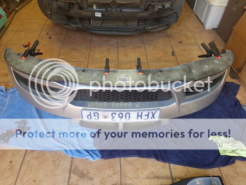

I also received something else in the post, but I was going to wait to fit it as the bumper needed to come off. And I really did not want to take it off again later to fit the headlights once I got the LED's for the rings...
But the next morning...
And then...
And then...

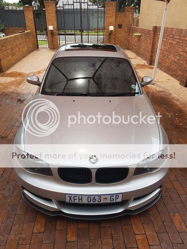

I love this Kerscher lip, it has always been my favourite.

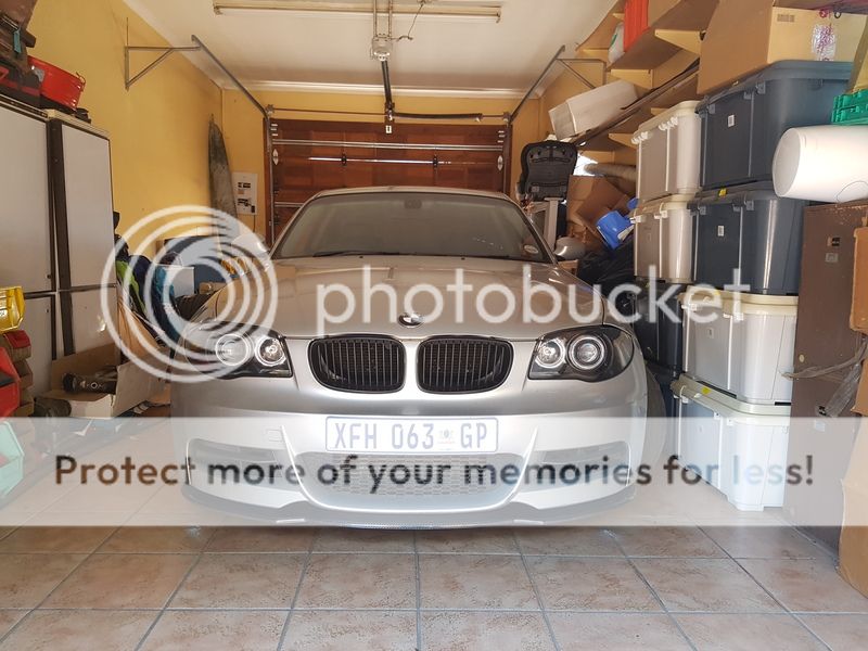

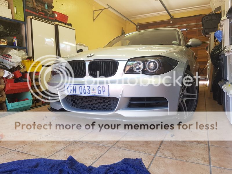

Then I thought, I will just have a look what the headlights are going to look like...
Mmmmmm!

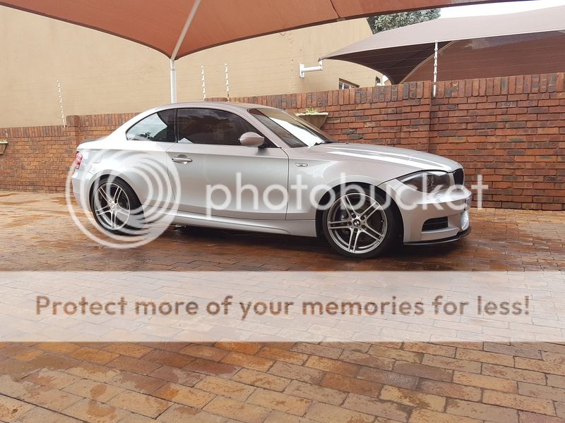

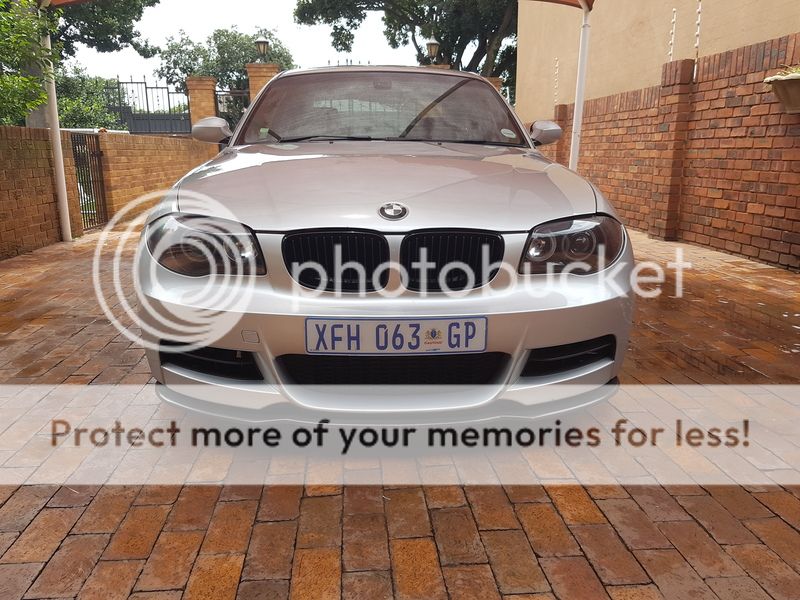

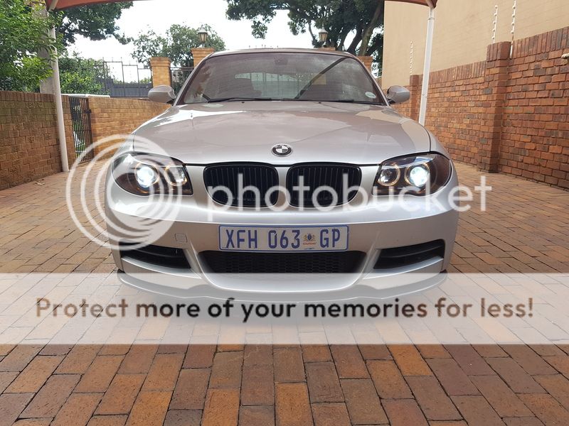

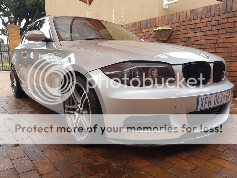

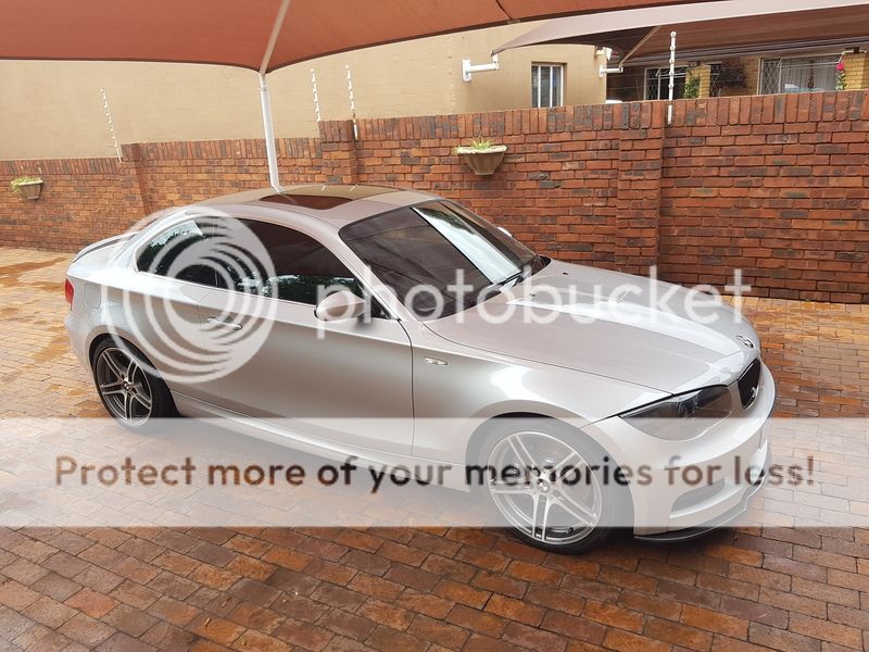

And here are some pics of the completed (for now) fitment.
I will get some proper pics once the car is clean and the rings are white.
