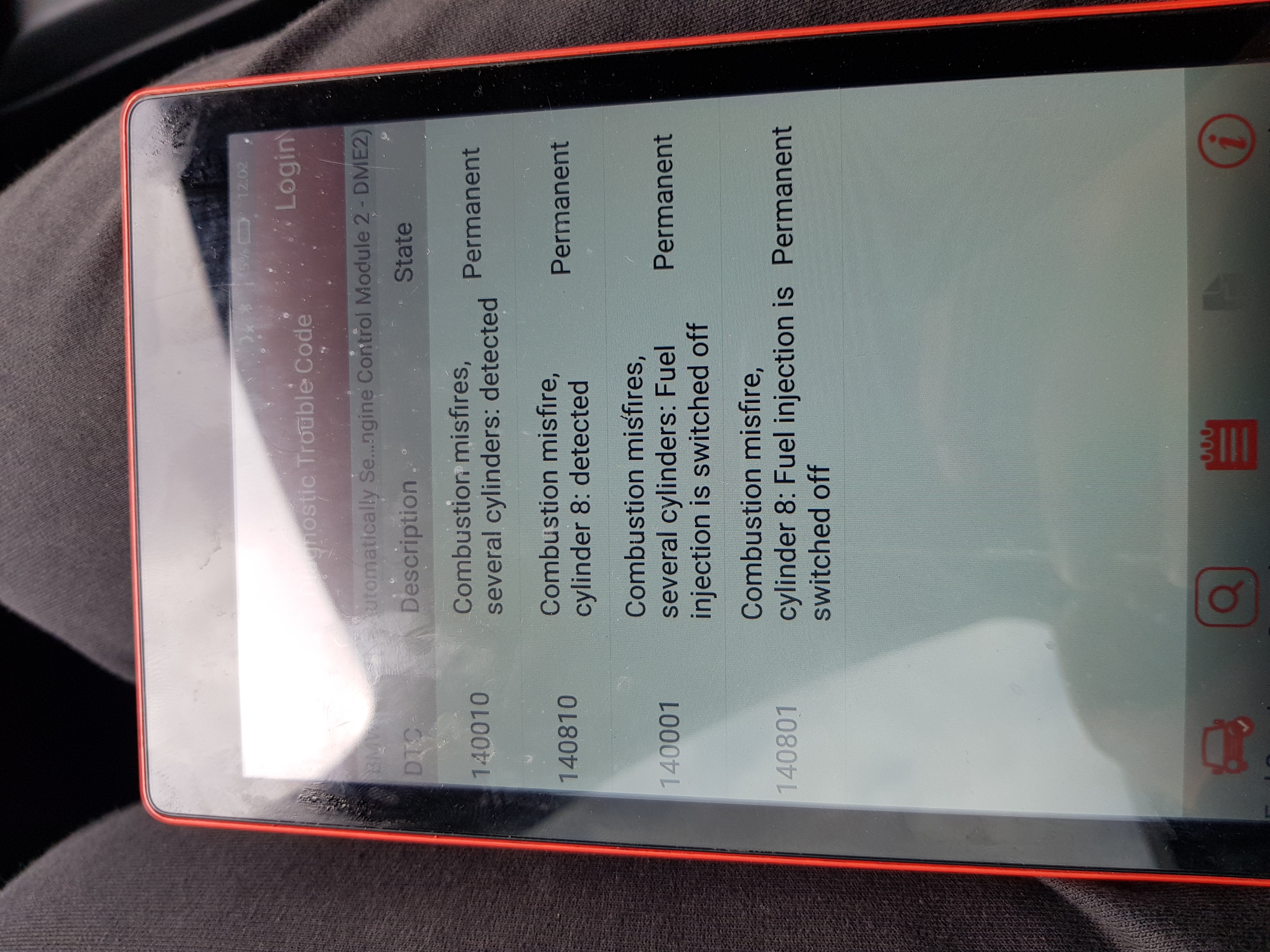

Hi Guys, I hope someone can assist. So my F10 M5 picked up an issue where it would misfire in one cylinder (number 8) at high boost at around 6200rpm in 3rd/4th gear WOT pulls. Initially thought it would be the usual diagnosis, plugs, coils, then the injector. After changing the plugs and coils, the issue persisted. My next move was to have a mechanic switch the injectors on cylinder 8 and cylinder 5. During this time a member here helped me notice that the car was under boosting on bank 2 on the JB4. After the injectors were swapped over, I thought I would just remove the JB4 and hopefully be able to start diagnosing the boost issue, however the car started behaving horribly and would fish bite and give the DTMAL as soon as you went near half throttle in any gear at low rpms. I found out that the injectors had to be recoded if they were switched and just asked the mechanic to switch it back to how it initially was however this made the problem even greater. Is there anyway I can diagnose this and sort the issue out?
