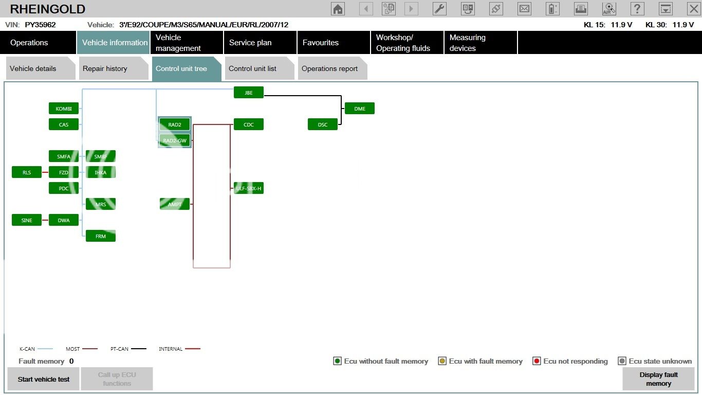

Finally, it's all working and neatened up. USB, iPod, BT, all working like a charm.
Green is for Go!
This wasn't easy and like I said elsewhere, I'm still not happy that I've got the process down 100% as it's still a little hit and miss. The big issue comes from the fact that software later than 2010 is a problem, as it battled to differentiate between The older HU's and the newer ones that has BT and USB built in. I have to basically jippo the software a little and then write a blank .man file to the Rad2 unit so it can pull the correct configs from the VO stored in the CAS. Interestingly, not even Ista/P gets this right so you have to resort to NCS to get it done.
To top it all, I even tried recoding the whole car using Ista/P and it promptly went and deleted all the steering angle adaptations (it does warn you though). It wasn't just good enough relearning the steering angle values, I had to relearn the DSC sensor values as well for it to come right.
Also, I've changed the VIN on the Mulf/Combox so that it doesn't show the donor car's VIN when it's pairing phones. Silly, I know, but I wanted it perfect. After a lot of searching, I figured out a way to do this using Tool32 and the ULF2.prg job. Thing is, you can't do this with a DCan cable as the Mulf sits on the Most bus, so you'll need an ICOM to do this.
So there you go, success. In hindsight it's a good thing that I battle like this as I always learn new things about the cars. It's just frustrating to battle with things that you've done before many times.
