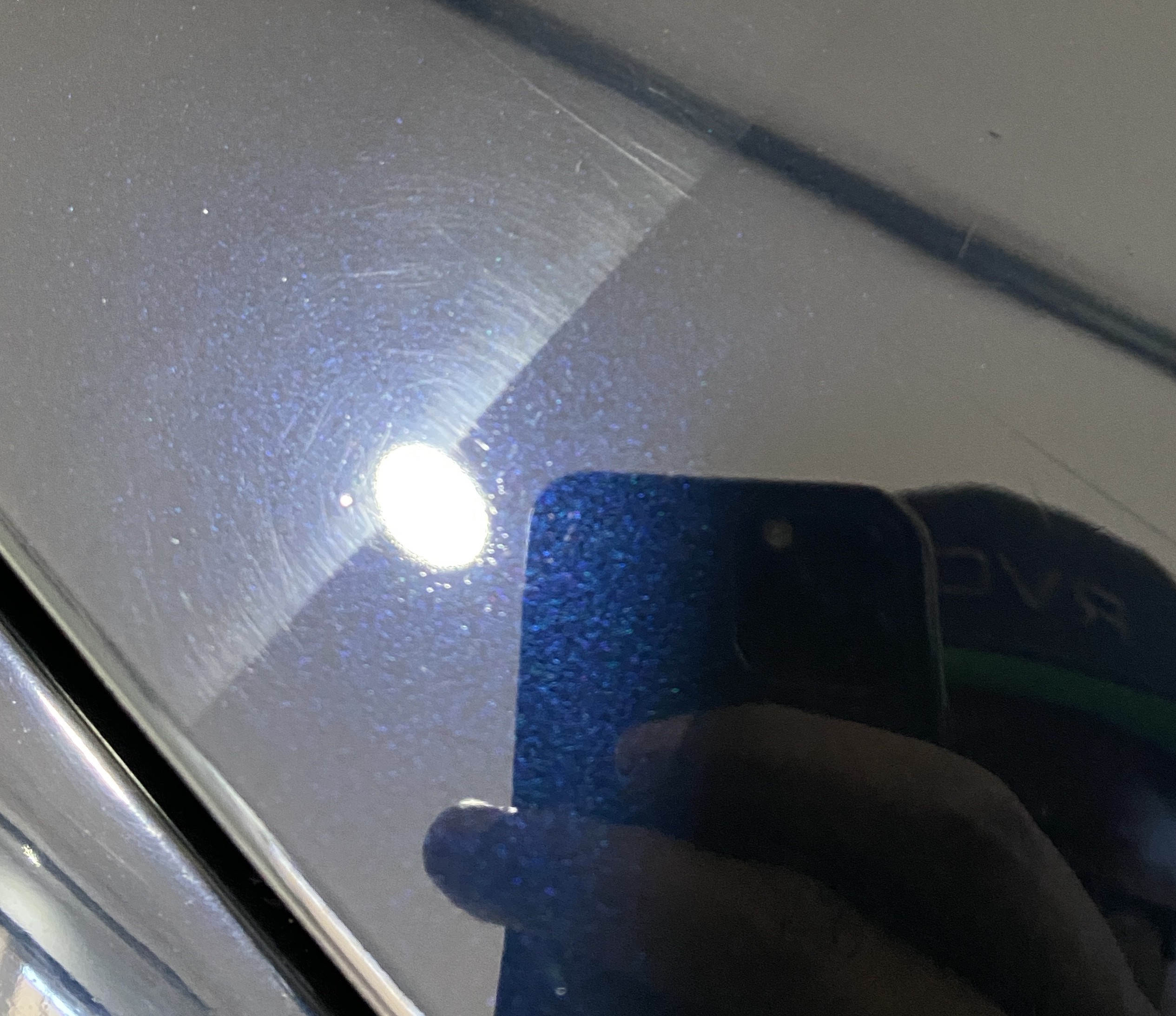

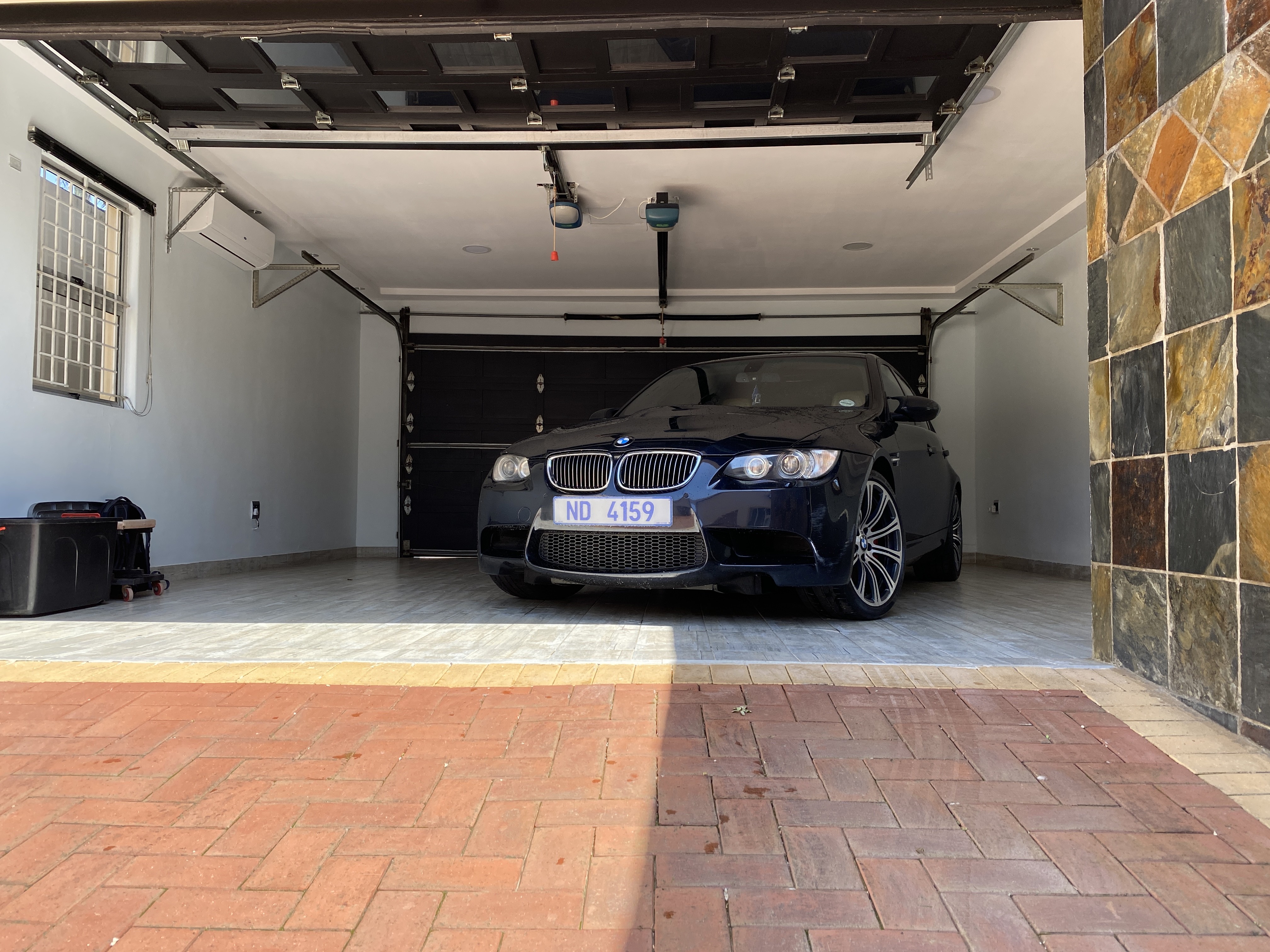

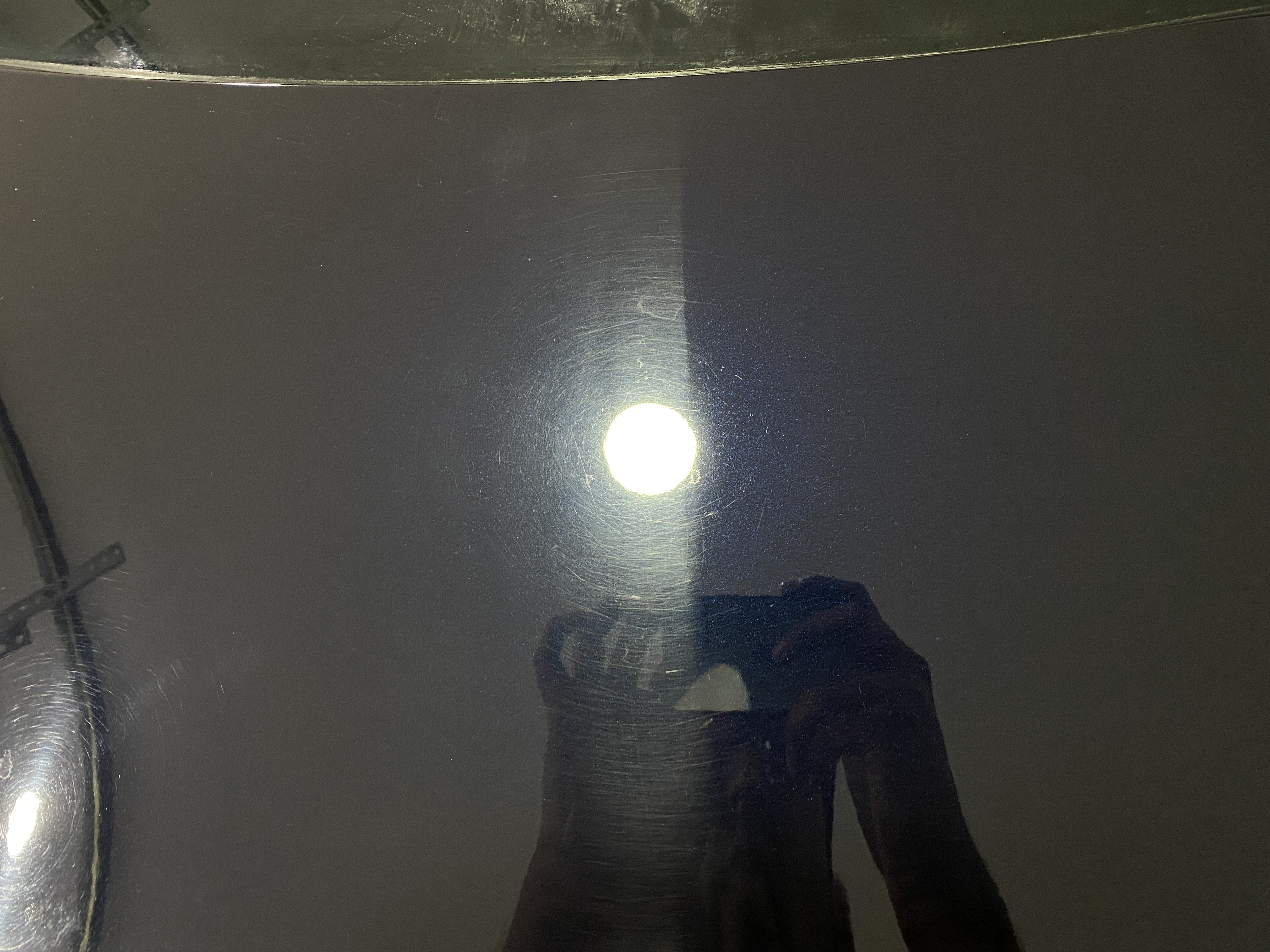

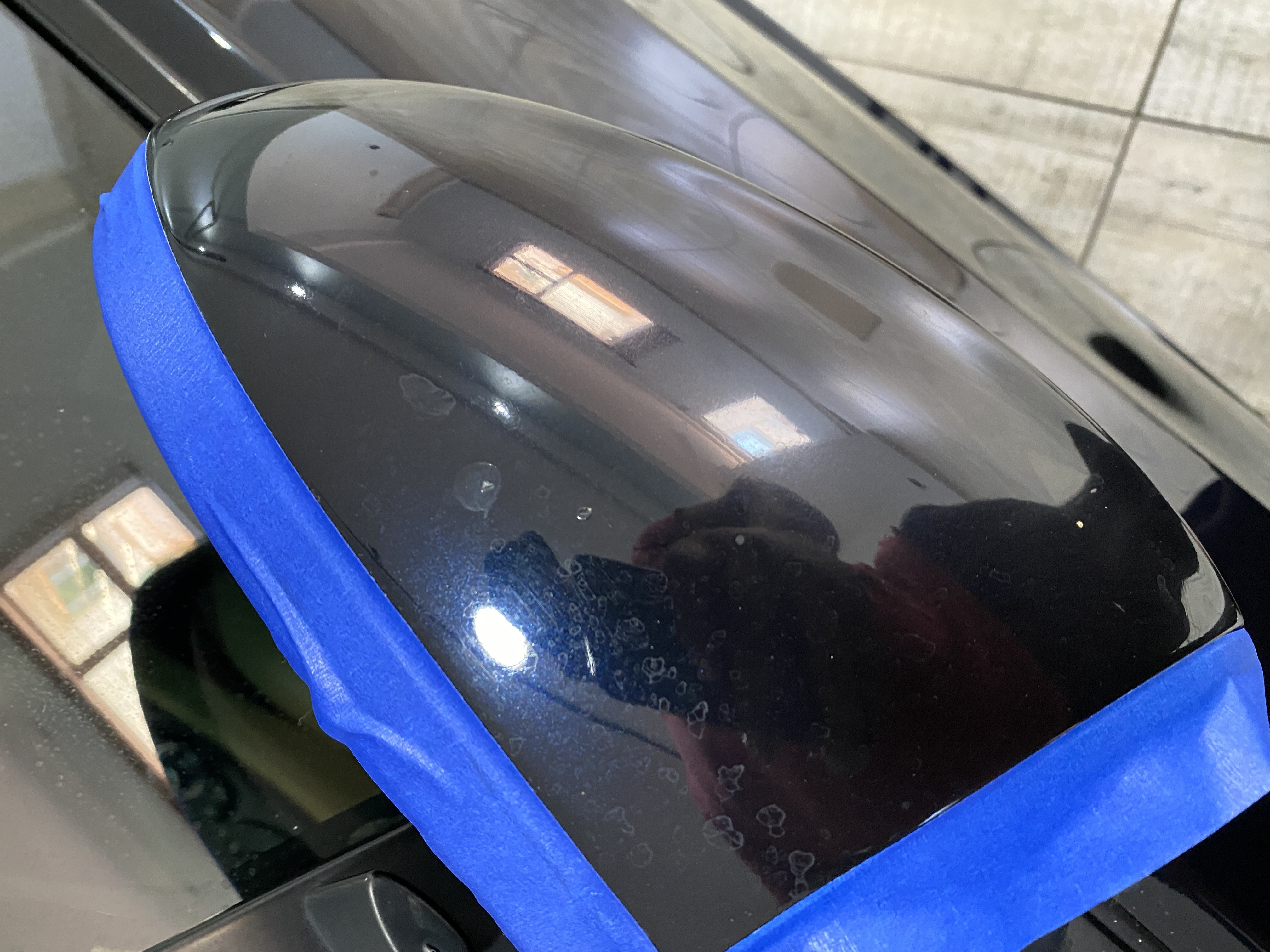

So a major issue with the car (for me) since I took ownership was the condition of the paintwork, there were signs of total neglect and bad washing techniques... But nothing that could not be rescued.
The paintwork was fully decontaminated before pulling the car into the garage to begin the surgery

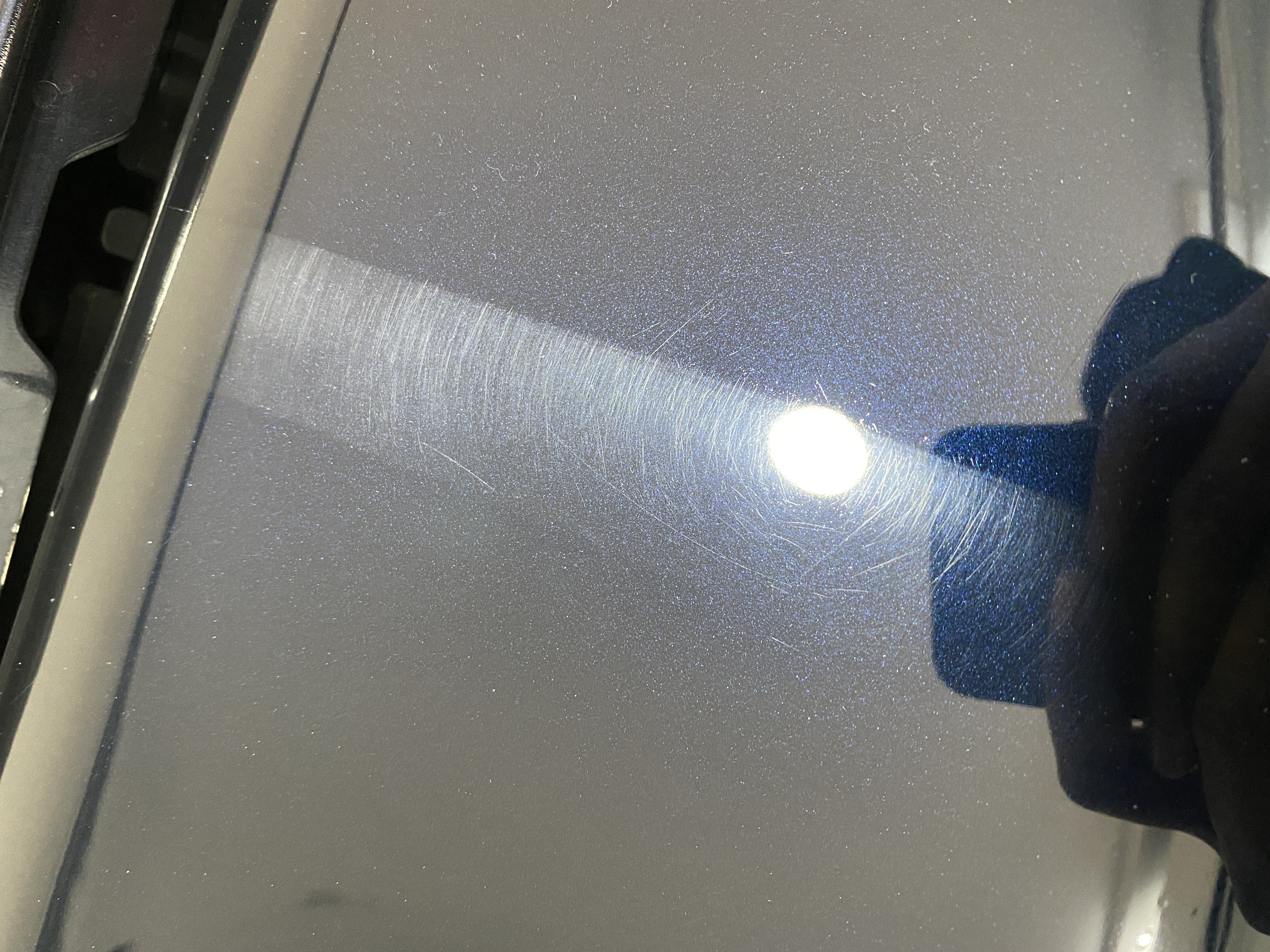

When tackling machine polsihing of any kind, the most important step is to know what you are working with, and what you would like to achieve. In this case I was working with extremely soft JB paint, and the desired result was minor paint correction and clear coat preservation.

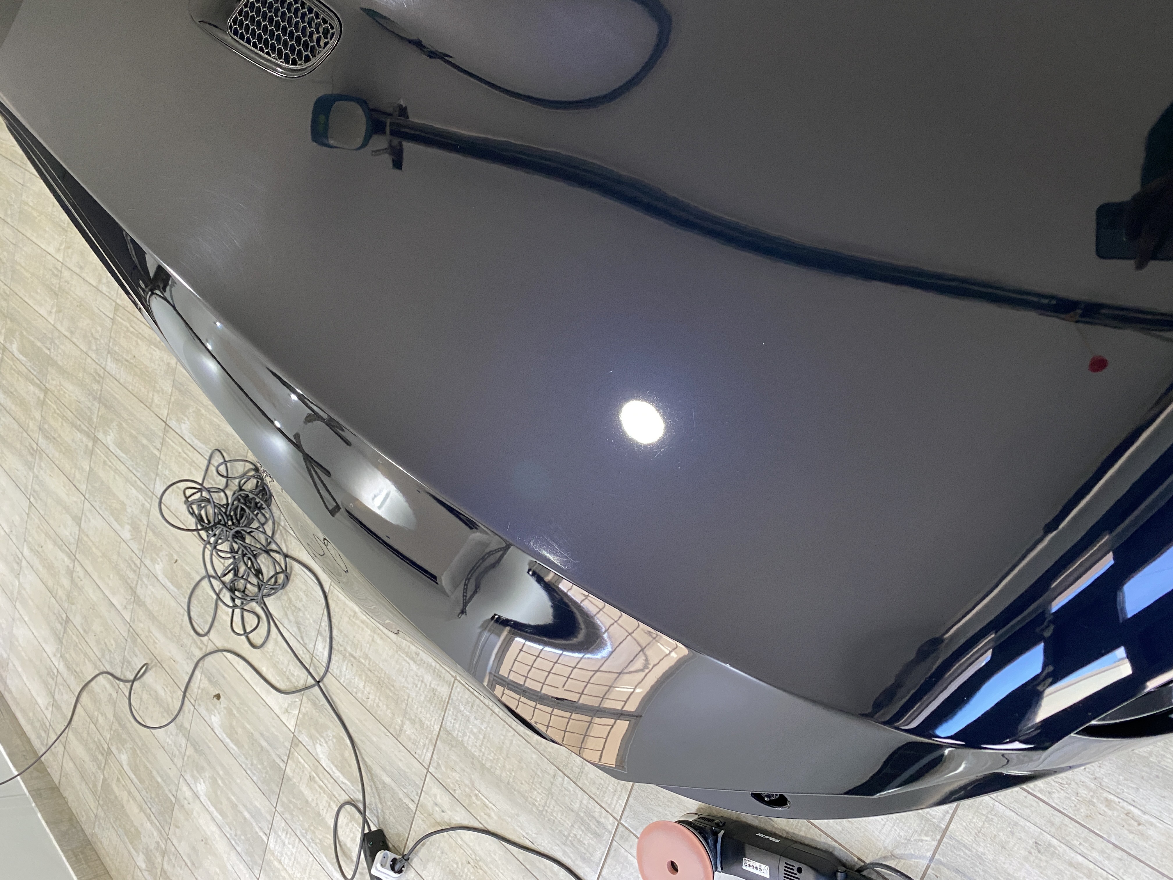

With this in mind, I reached for my Rupes LHR 15 MK2, CarPro finishing pads and 3D HD speed, which is an all-in-one product. I knew there would still be deeper defects left behind, but I chose to preserve as much clear coat as possible while still achieving a good finish and a car that presents well.
I ran a small test spot which confirmed my product choice was right on the money!

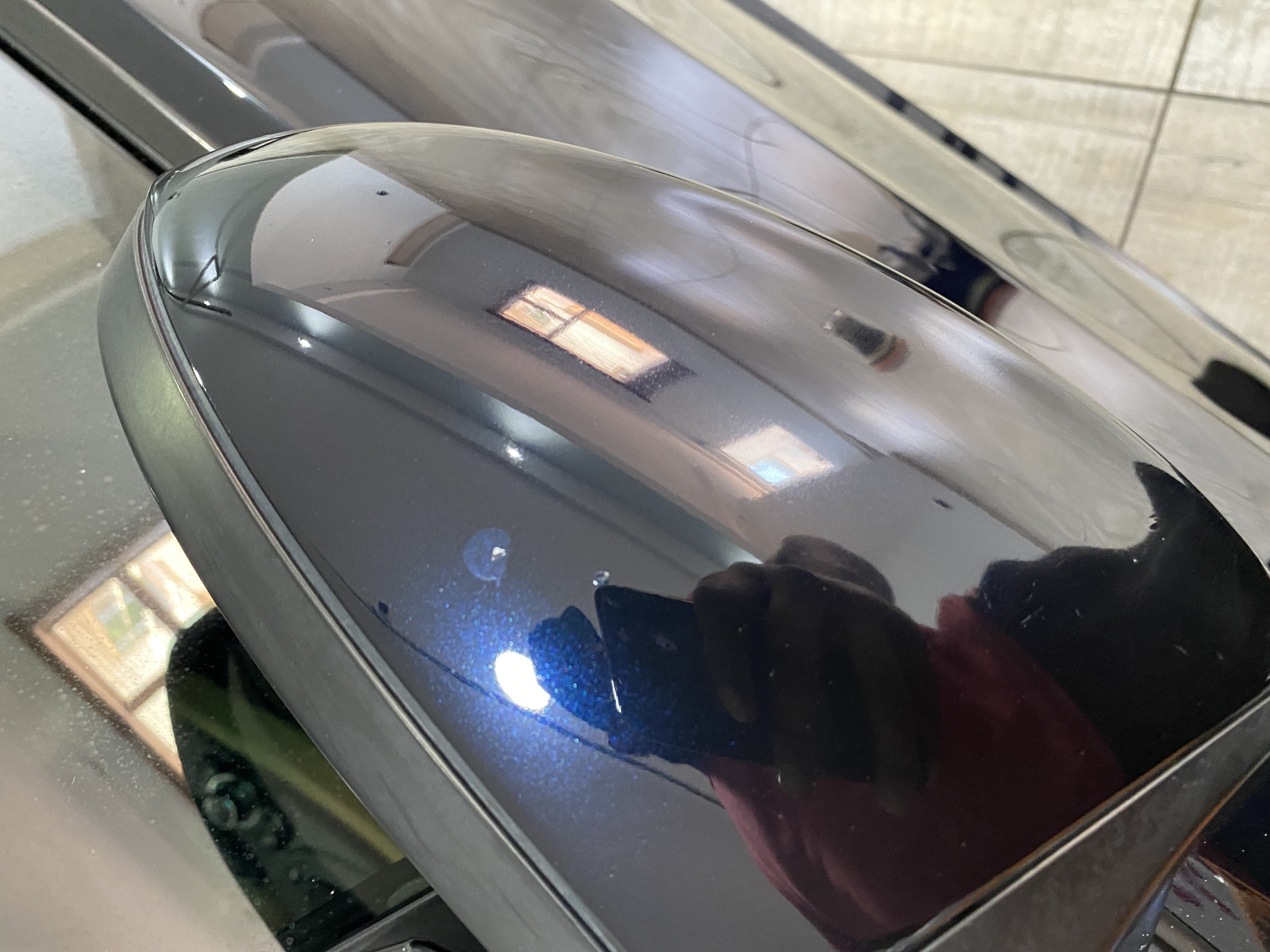

From here, I worked one panel at a time until I reached the desired finish

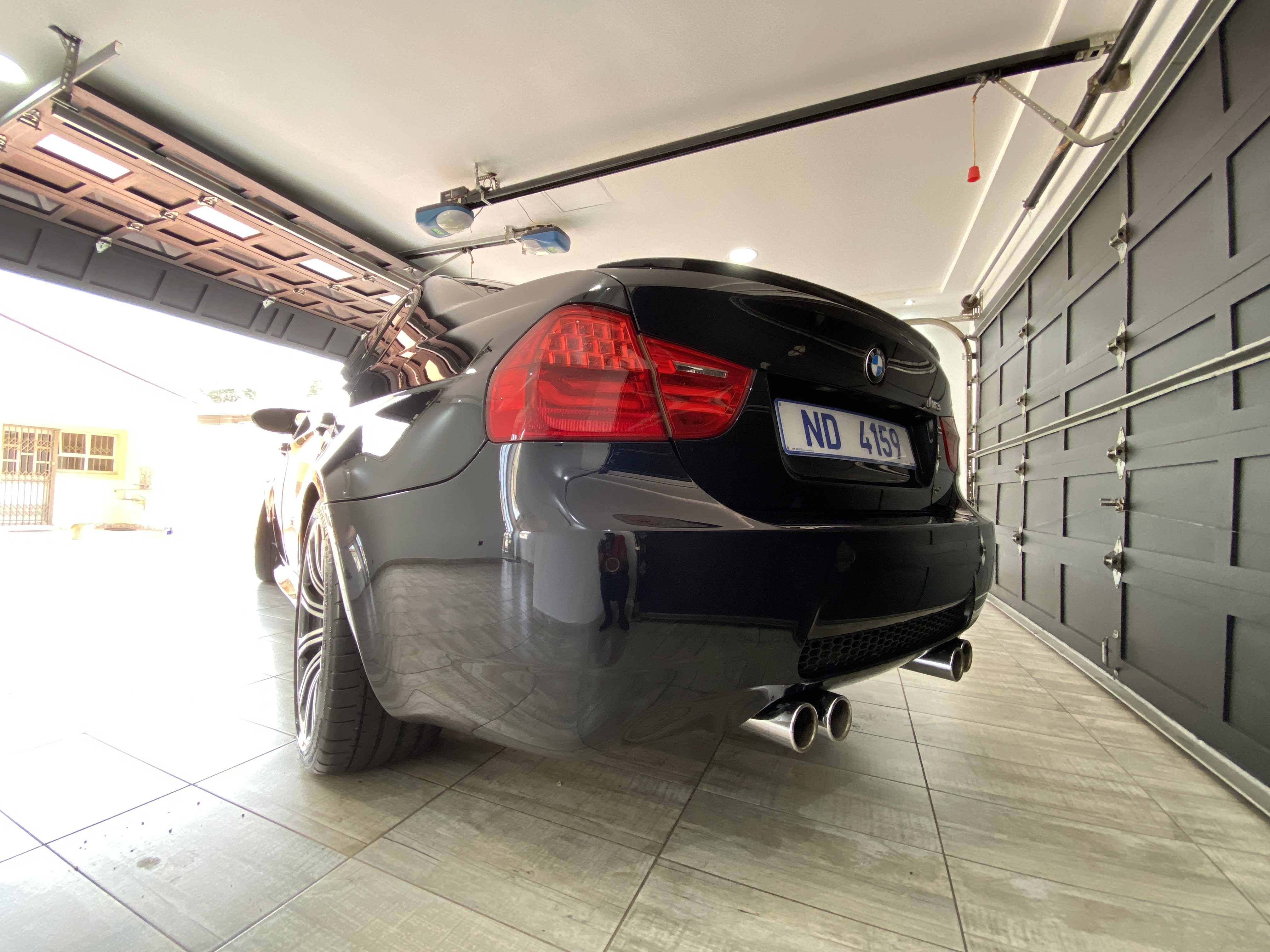

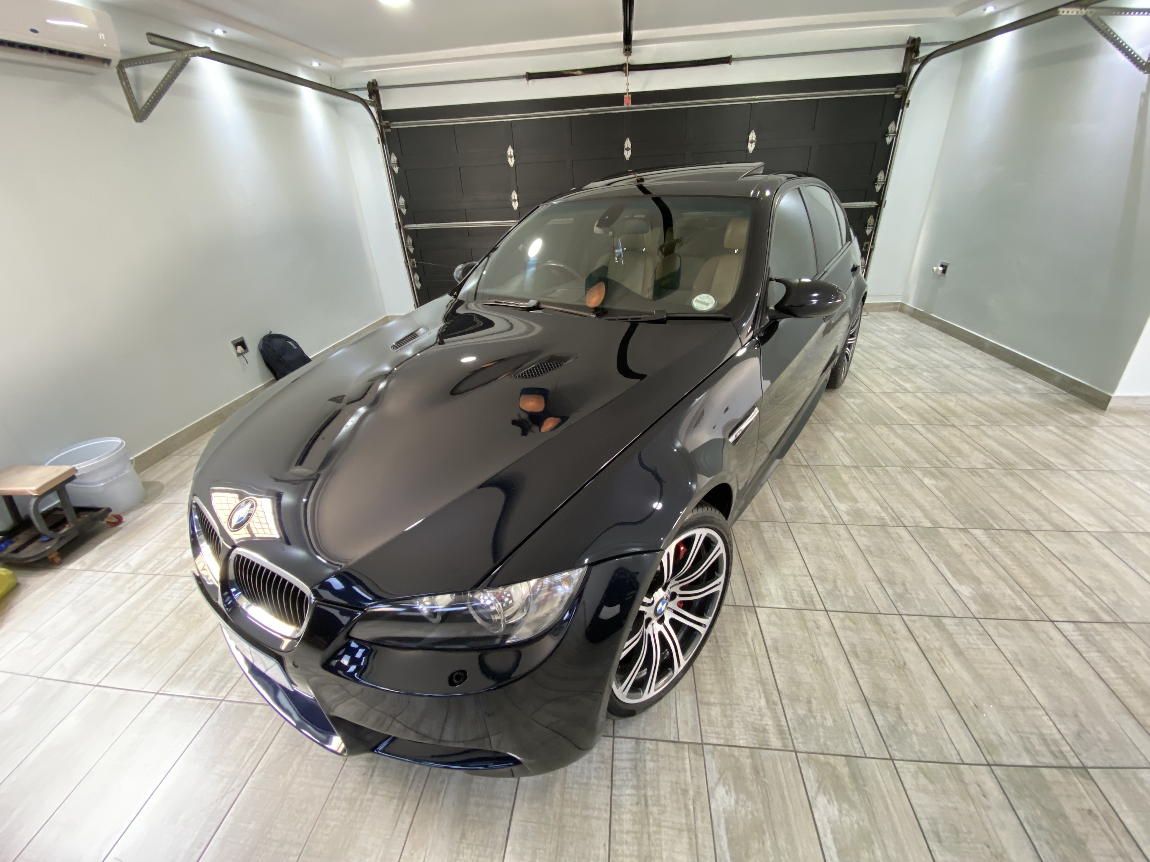

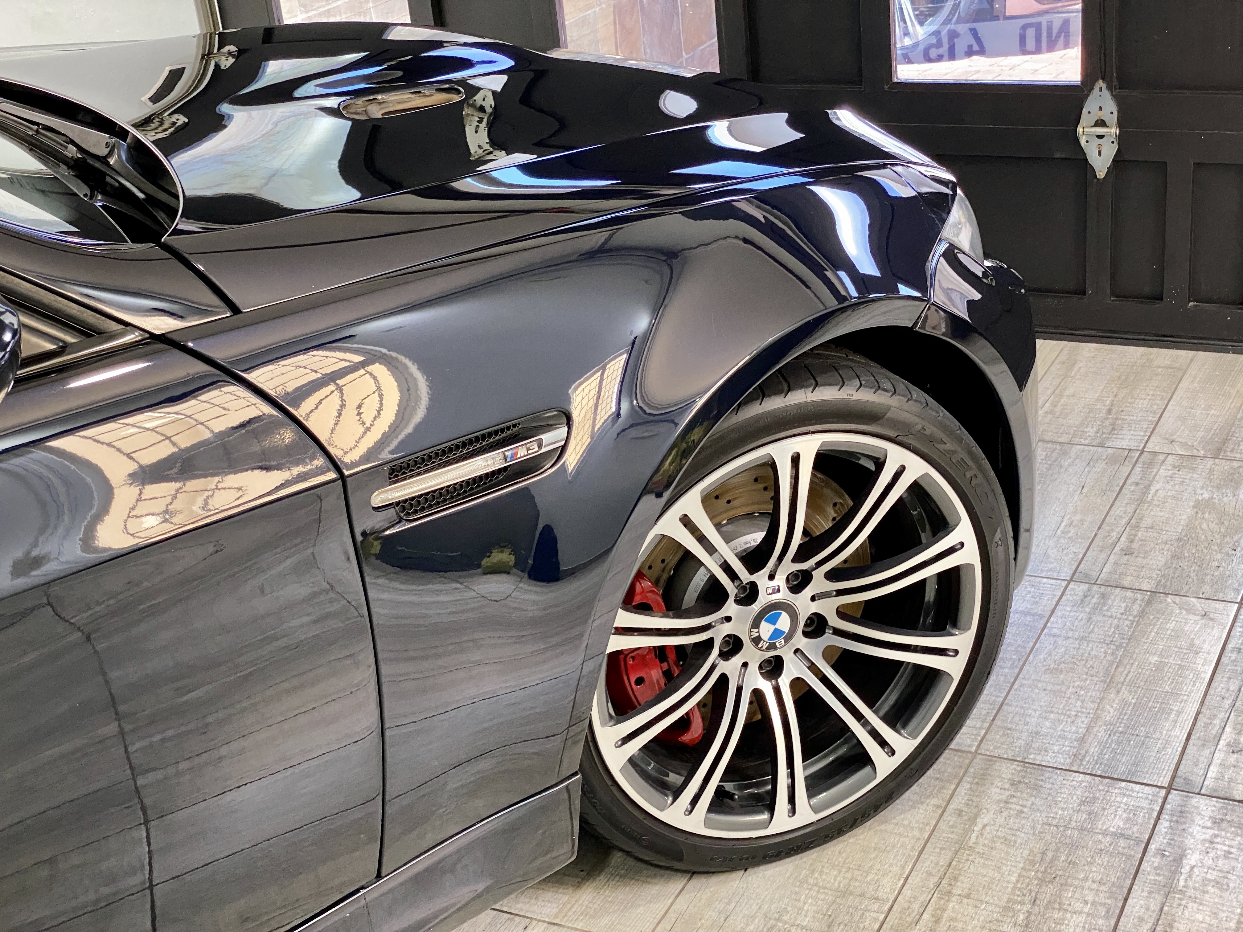

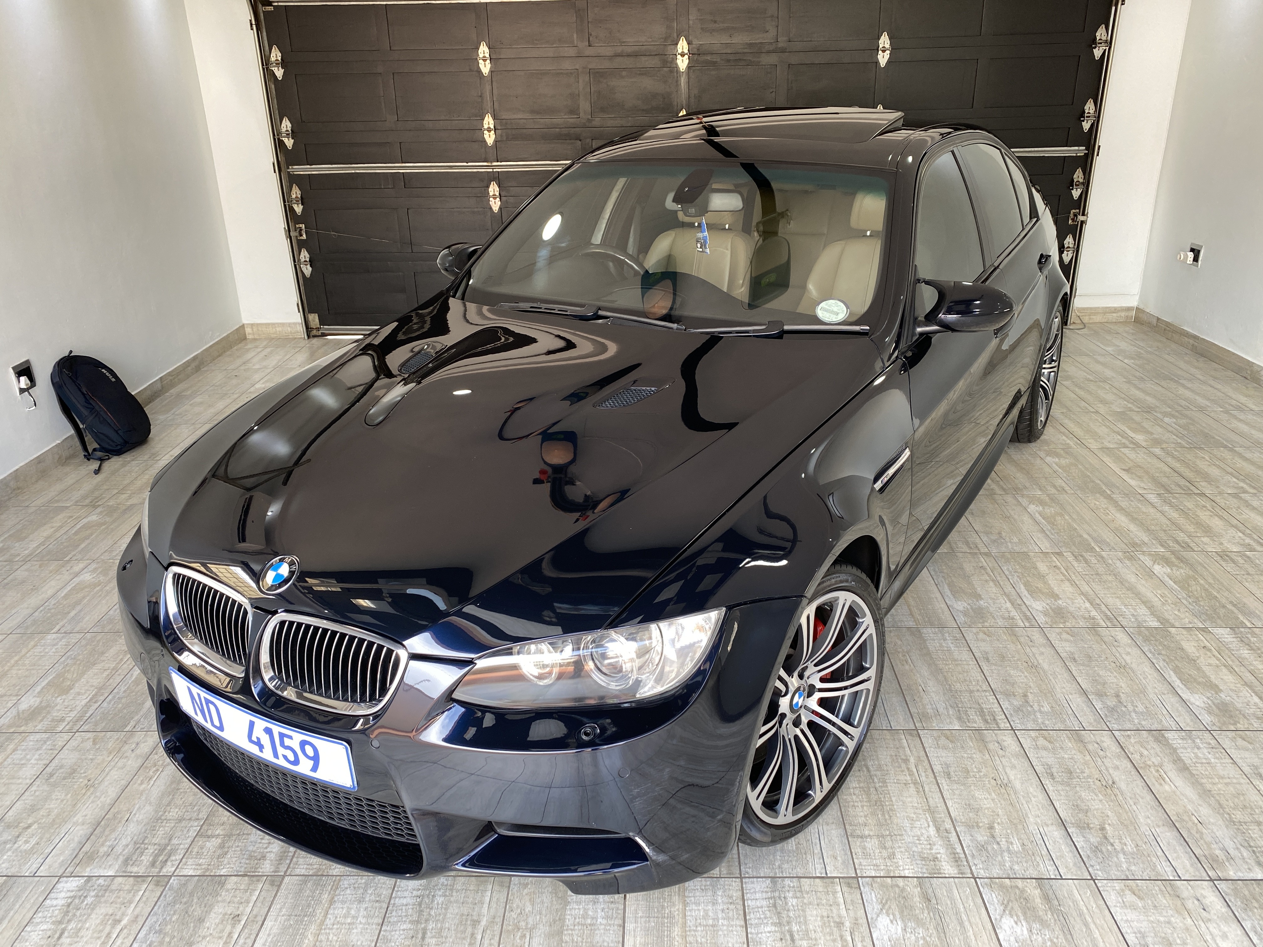

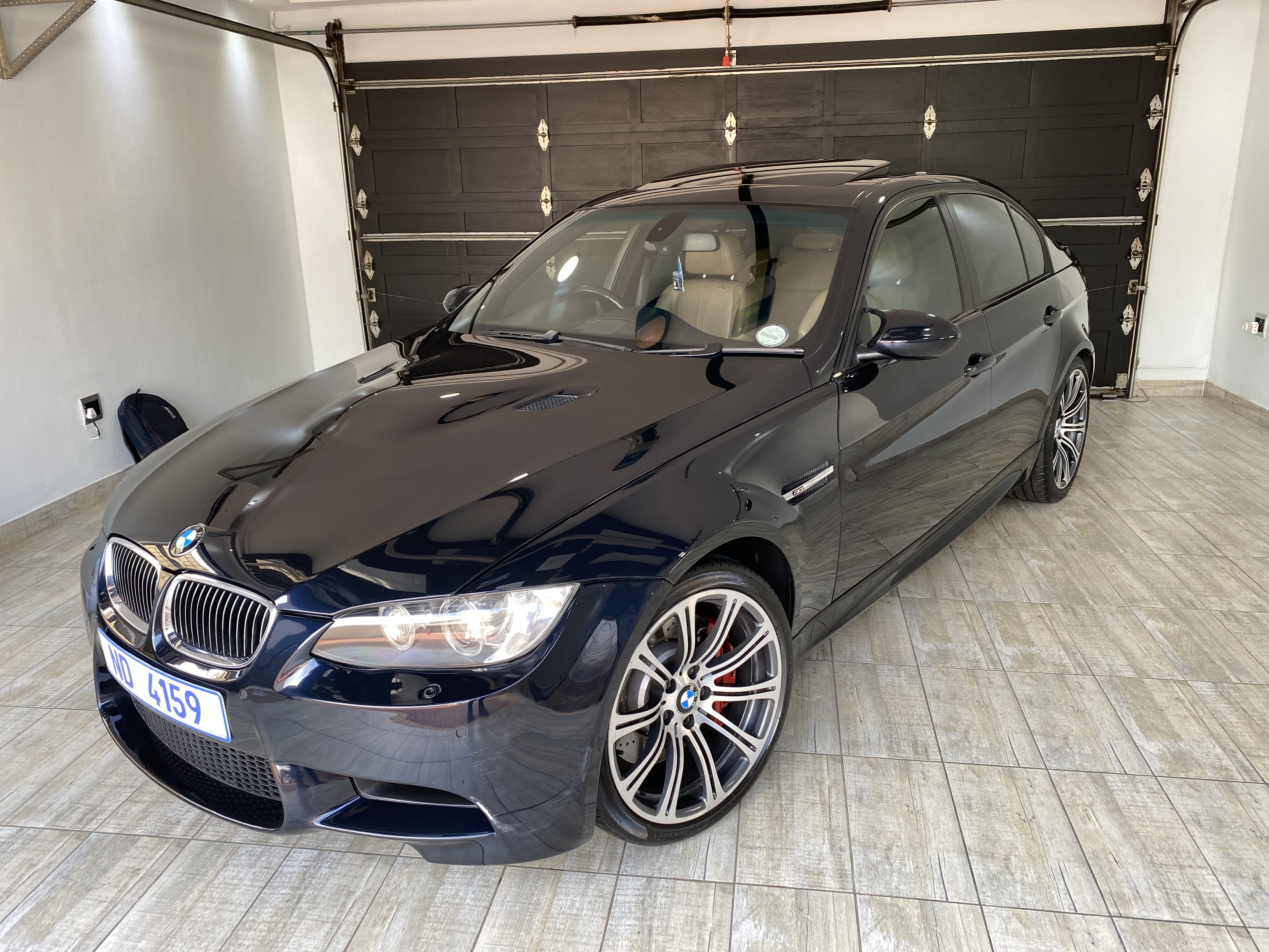

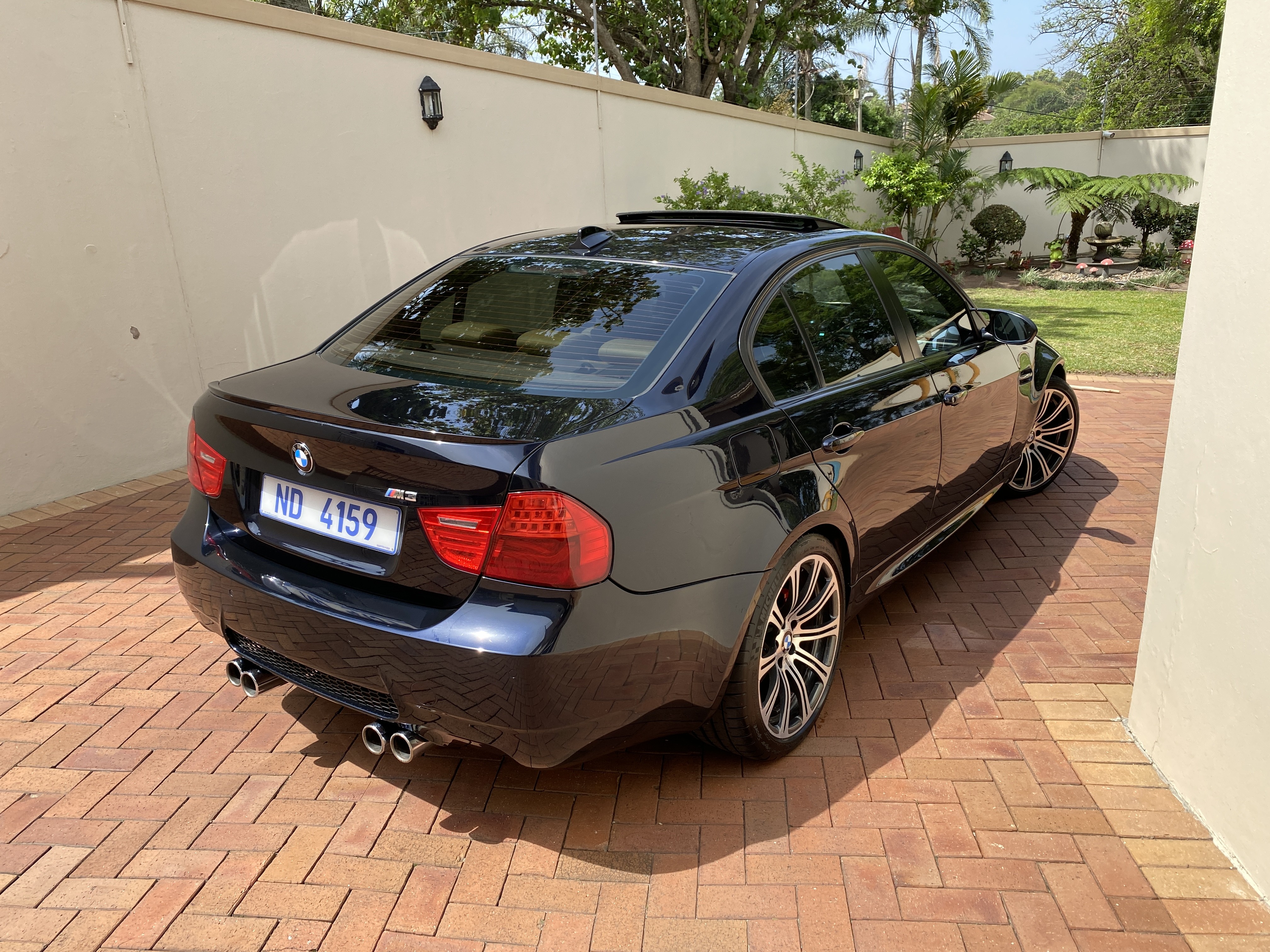

It was after this that I had a new appreciation for Jerez Black! Amazing colour when the clear coat is well taken care of! The paint started coming alive..
And finally some after shots
