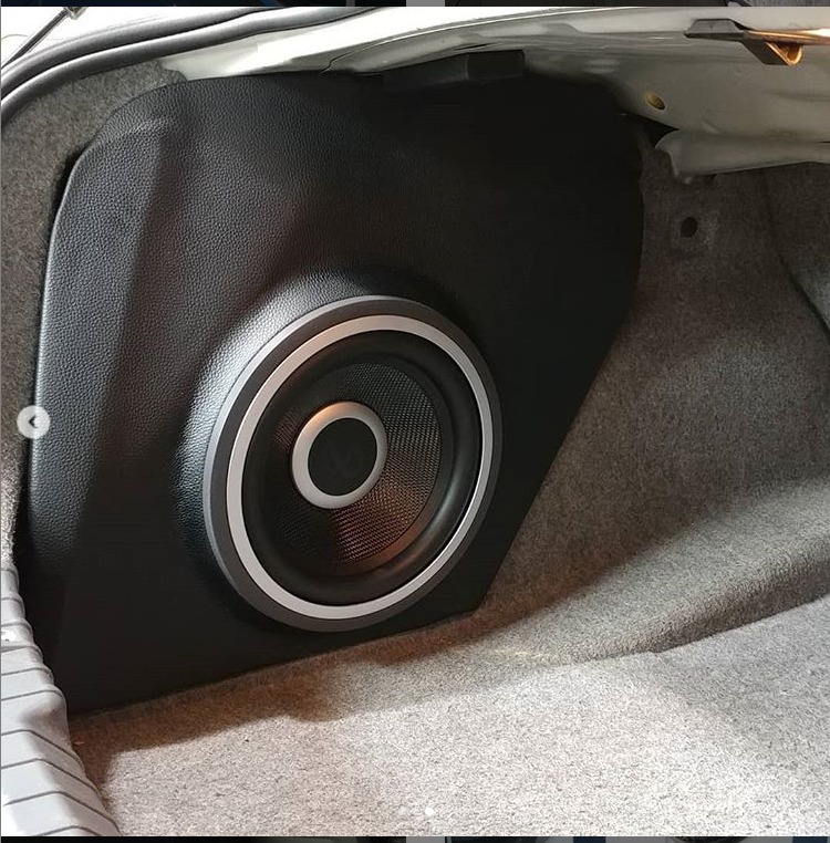

Mind sending me pics of the work he had done on your car? Just wanna get some ideas. Already know the amp Im gonna go with (Gladen RC 150c5) and for the sub Im thinking of a SQX08. Just want installation ideas now
FILV
I cant believe it, but i found a pic from deep in my archives.
I wanted quality over quantity, so i went for 10 inch Infinity sub , and Razeen made me a custom sub enclosure so i could still have most of the boot for long distance trips when the entire boot was needed.
I dont have pics of how back of the seat where you need to cut looked, but it was barely noticeable.
The amp was fitted under the floor board of the boot.
