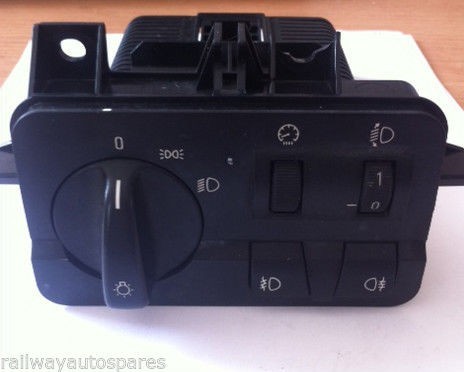

Look at the switch on the right. Does your car not have a switch which resembles this? Should be near the steering wheel
Hi Donovan,
No it has the one i have attached, Also has normal halogen lights
Donovan2412
That switch with the one and the zero adjusts the height of the headlights.
Park you car facing a wall and check.
Oh yes it does but even after adjustment, they will still be too high. I am guessin probably the headligh were once taken out and not replaced properly. I will have to check later on today
