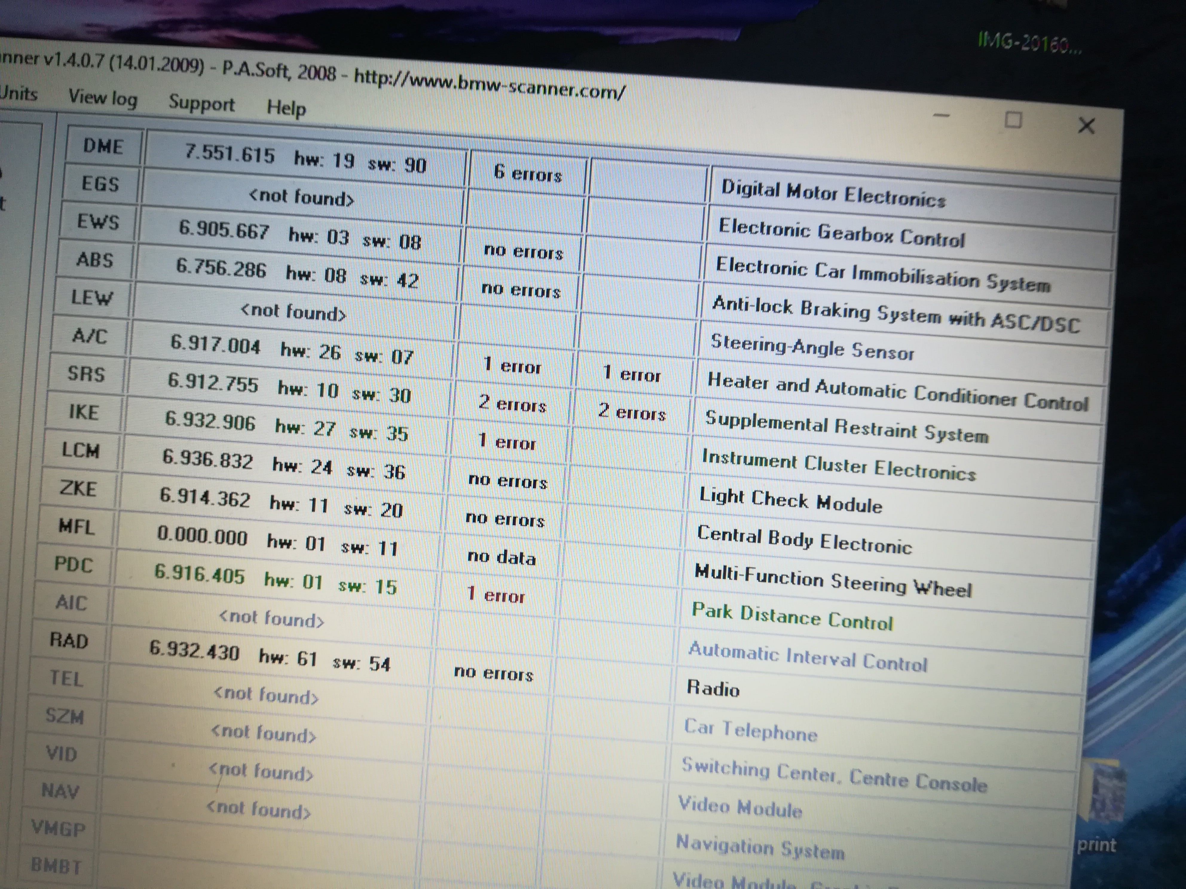

Have anyone experienced your E46 Cluster Malfunctioning???
Example, As some of you know, the Only Light on my cluster is the "handbrake", "Low Brake fluid" Light thats on
Previously i thought it was the ASC/DSC incompatibility where ECU is coded for DSC and car has ASC.
So i scanned my car last night to clear the Airbag Errors and Funny enough, there is NO Errors for ABS system or anything else that can relate to that light...
Brakes are all new
Brake sensors are all new
Fluid is at MAX level
Handbrake is Correctly set
Handbrake switch was replaced.
So all i can think of now is the Cluster is maybe Messed up that keeps this light activated???
Ignore the DME Errors. There are NO Current Errors. the ones listed are Shadow errors which i cannot clear
