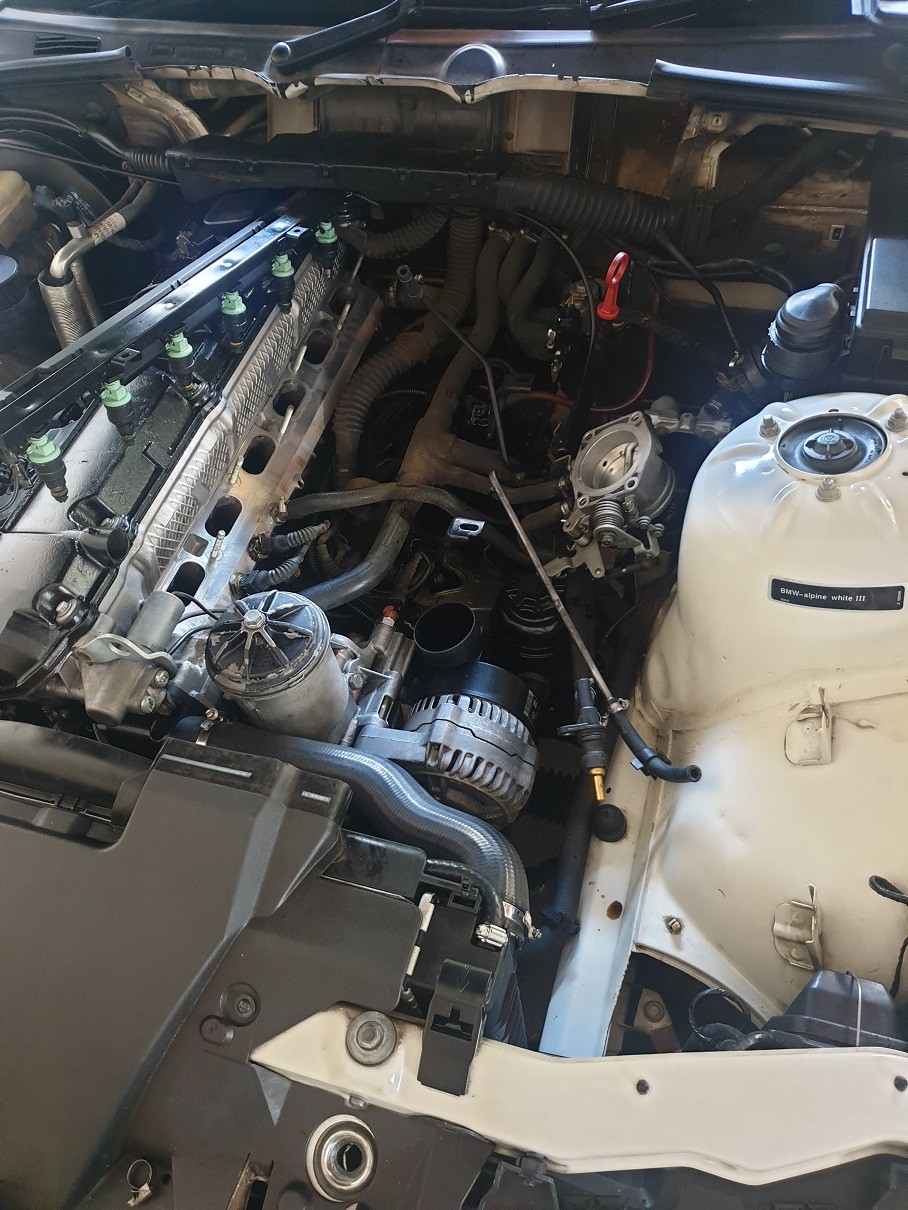

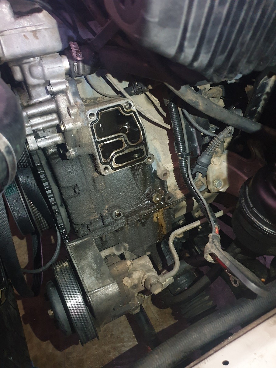

After we completed that there was still an oil leak.
So we decided to do the oil filter housing gasket.
Now this is where i hit a dead end and basically the car is now not running.

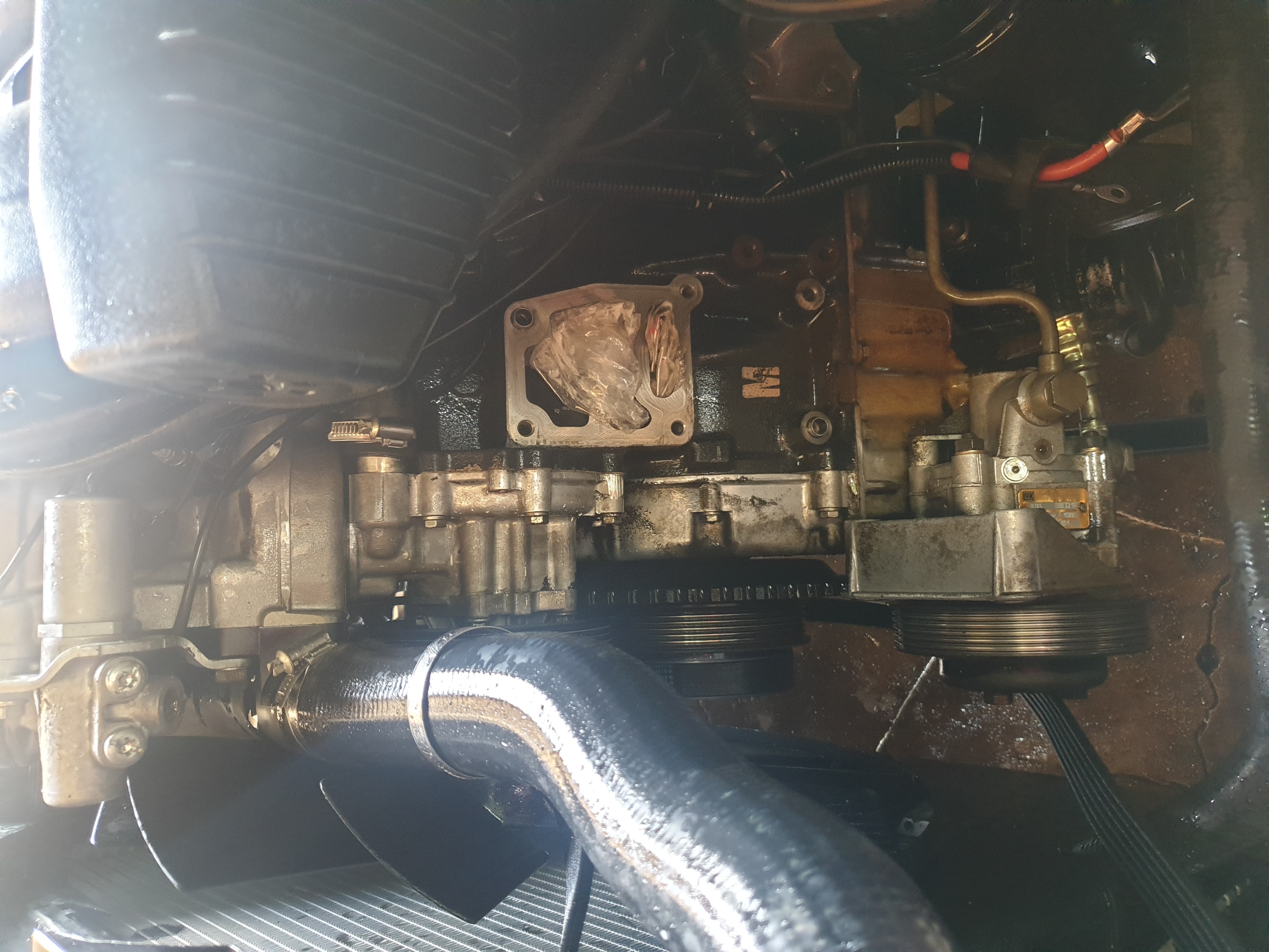

Before:
After a clean:

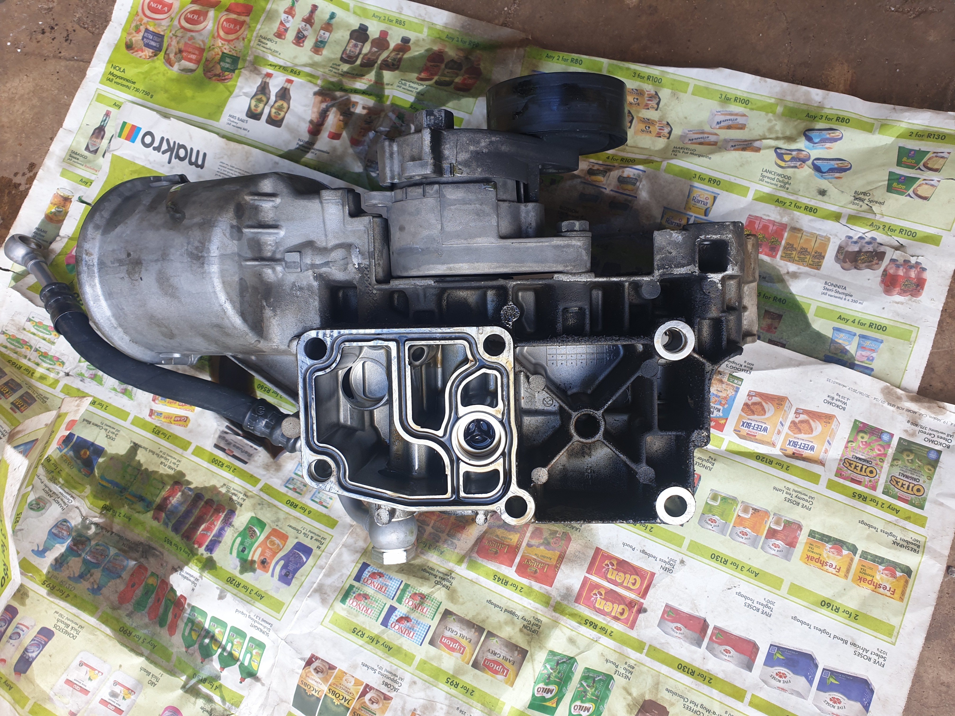

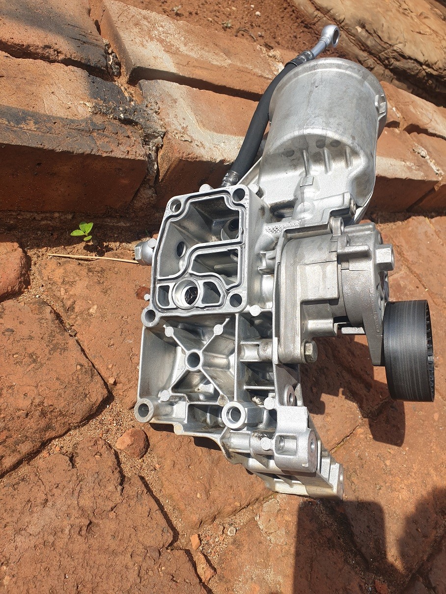

Oil Filter housing before:
Oil Filter housing After:
Now the problem starts.
I was getting a low pressure engine warning light when the car was at idle.
It started doing this after we put in new oil. 10w40
i put in a new pressure switch
Changed the oil filter 3 times.
The old oil was very thick and black when we drained it.
So im assuming there was very thick oil in there to mask an oil pressure issue.
After doing the Oil Filter housing gasket i now have no oil pressure at all.
We took the housing of Nikhils e36 which we know was working but we still sitting with the same issue.
at this point, our backs where dead....we where tired....we just could not think of what the issue might be or even attempt at opening up everything again.
The car is now at my mechanic to drop the sump and have a look if there is any engine damage due to the oil pressure and possibly tell us if the oil pump is now dead.
We was not in the mood to drop the sump while working on the floor.
Dropping the sump is abit of a mission lol.
So now i wait to hear what the problem is.
