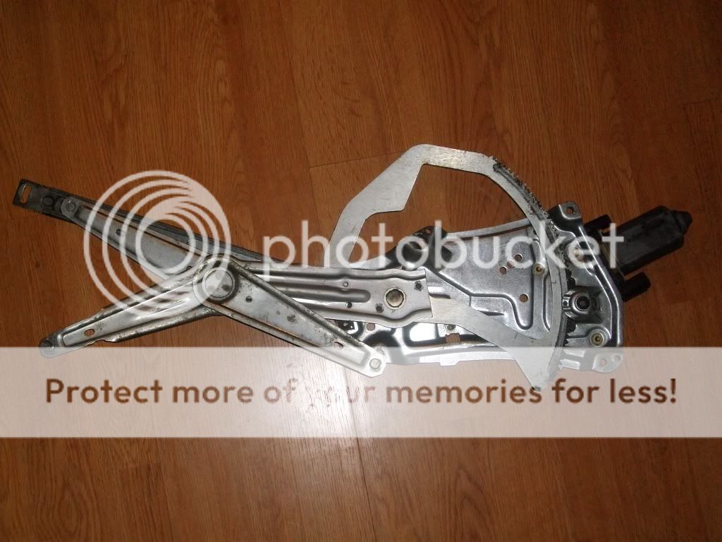

On the regulator - in other words, the scissor-type mechanism that opens and closes to raise / drop the window... either it's broken one of the nylon fasteners that holds the mechanism's symmetry (and thus guides a straight vertical path), or the window's come loose from one of the holders.
Strip off the door card, and operate the window - you should see quite clearly where things are going awry... replace the nylon fastener in the joint, or cable-tie things together as a temporary fix - otherwise, replace the whole regulator unit with one from a scrapyard - or Goldwagen might have new ones, dunno.
Oh, and dependent on where it went wonky, it may have broken a little metal shaft connecting two of the arms... A pop rivet with a bit of grease afterwards will work a charm if that's the case.
Here's what it looks like:
