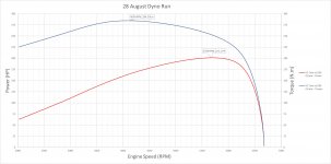

So we went to the dyno on Friday...
Still struggling with some small amounts of reported knock and the ignition advance being pulled back a few degrees. Will try to get this ironed out when I write the next tune for the car.
Here's what we ended up with:
Peak Power: 201.1 HP at 5700 RPM
Peak Torque: 284.5 Nm at 4090 RPM
