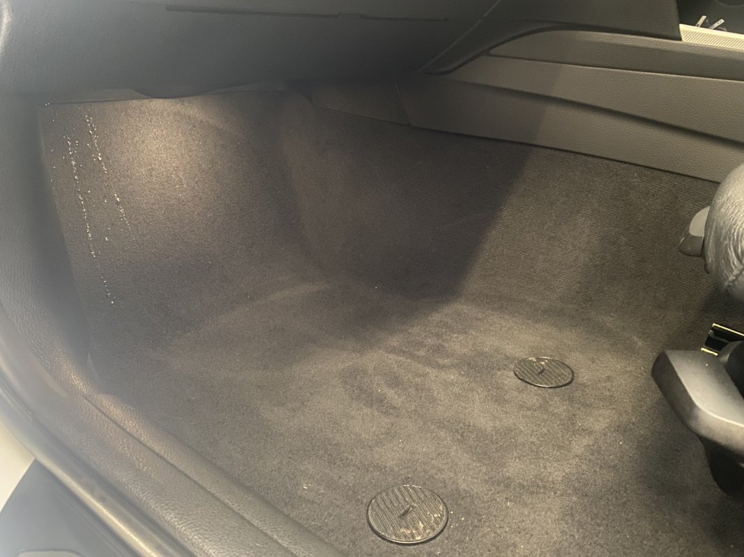

Hey all, I've got a pretty bizarre problem with my F30 330d. I've got water leaking into the passenger footwell, but it does not seem to be directly correlated with rain or the car being washed. Last week Thursday the car was washed and it was pulled 10 meters into the garage. On Monday everything was well - no smells inside. It didn't rain on Monday and the car didn't come anywhere near water.
On Tuesday however (yesterday) when I got into the car the smell of wet carpet immediately hit me. I felt around the carpets and the passenger side footwell was soaked. What's even weirder is that the vertical carpet at the bottom of the footwell (the part that covers the firewall) and the vertical carpet next to the transmission tunnel is also soaked in places.
So I put some fans in the car overnight and managed to dry the carpets I would say 80%. However, when I stopped at the office this morning the carpets were soaked again and I can see where the water droplets was running down in the footwell at the firewall. Again, no rain and no water close to the car.

Doubt that it's condensation, the carpet is completely soaked. As if someone had dumped a glass of water in the footwell. There is definitely no residue and I just had a taste of the water, I don't taste anything funny. But I don't regularly taste my car's coolant so I can't say if it would taste any different :ROFLMAO:
I just took this photo. You can see the water running down the carpet. The carpet right at the curve of the firewall/footwell is soaked. The carpet where the frame rail of the seat ends next to the transmission tunnel is also wet (you can see it looks a little bit darker).

So I took my car to Ross Duncan last week to fix this. It took them all day to diagnose, but the problem turned out to be the AC water drain. They cleaned it out with a compressor and the problem was fixed. I had no idea the AC generated that amount of water!
