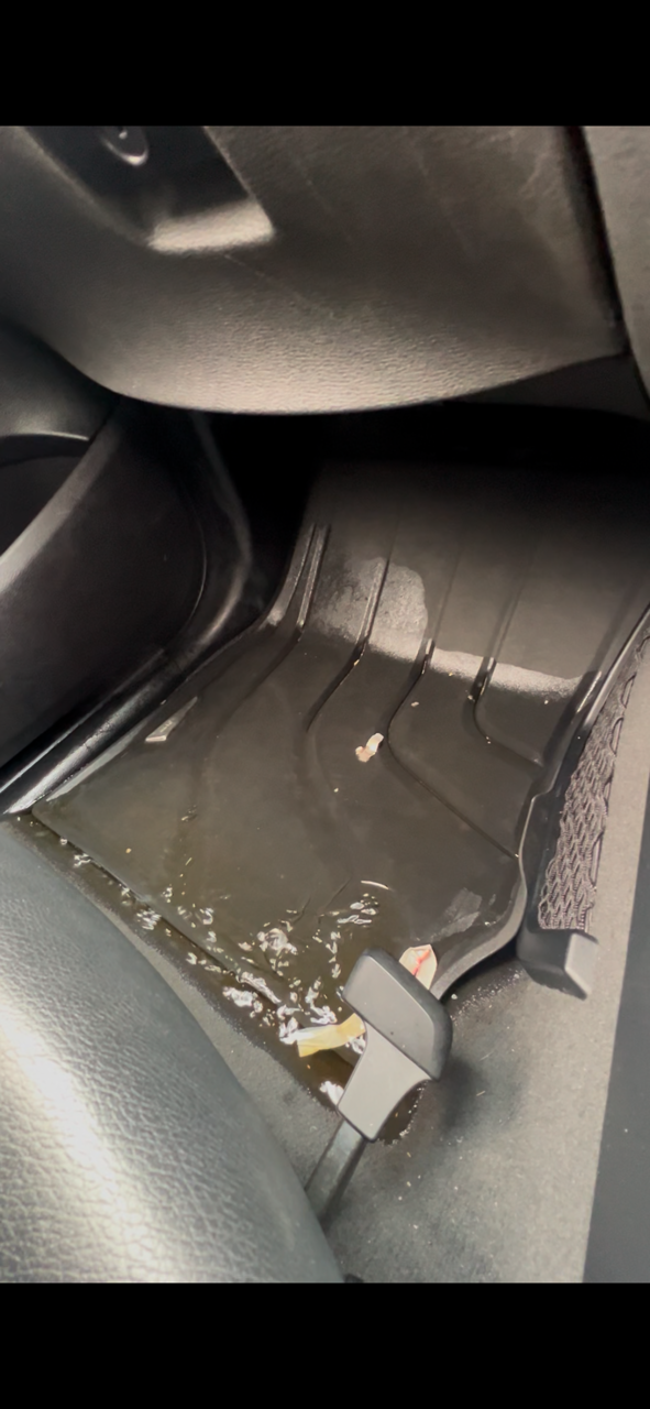

Hoping to be pointed in the right direction. I’m having an issue with My 2011, f25 X3 20.d, in November last year I got in and found almost 10cm of water sloshing around the passenger footwell.
Got it all out, absorbed it with about 270m’s of paper toweling as a short term fix till me independent techie could see to it. It went to him, he cleared the sunroof drain and the aircon fan which were blocked. The subsequent issue was the foam under the mat (between the car and the mat) was still soaked and basically the entire carpet needs to be removed along with the centre console & the dash aswell as the seats to get all the carpet out to dry. Underneath
The larger issue of that with all this rain today I get in the car and there’s 1cm of water in the corner of the passenger footwell.
My independent techie (who’s been servicing and repairing my BM’s since 2016 isn’t available for at least 6-8 weeks) and I can’t wait and allow water to run into the car for that long.
Can anyone recommend me bmw specialist in Joburg that might be able to help? (Recommended with experience)
I’m looking at the BM guy in wynberg (does anyone have any experience with them?) (https://www.thebmguy.co.za)
My other option is to take it to BMW itself but I don’t think I have enough Vaseline for that
Does anyone have any idea what this could be?
Is it possible the windscreen rubber needs to be replaced and this is where the water is coming in from? (I can see a 5mm gap between the rubber and glass)
Advice/ recommendations appreciated

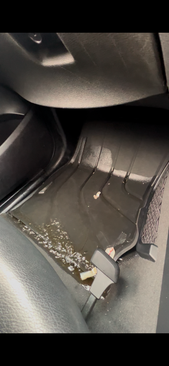

JoziNick
Thanks all, Clint wasn’t able to assist, it’s going to a bmw approved repairer (that has experience removing carpet and seats etc) they reckon it could be the trays in the honey. They’re going to fault find and sort the problem and then address the under carpet (the top of the carpet is completely dry)
Here are some screenshots from the video I took when it initially happened in November last year)…perhaps my portuguese arithmetic was off (always either divide by 2 or multiply by 2)…3cm seems more realistic
