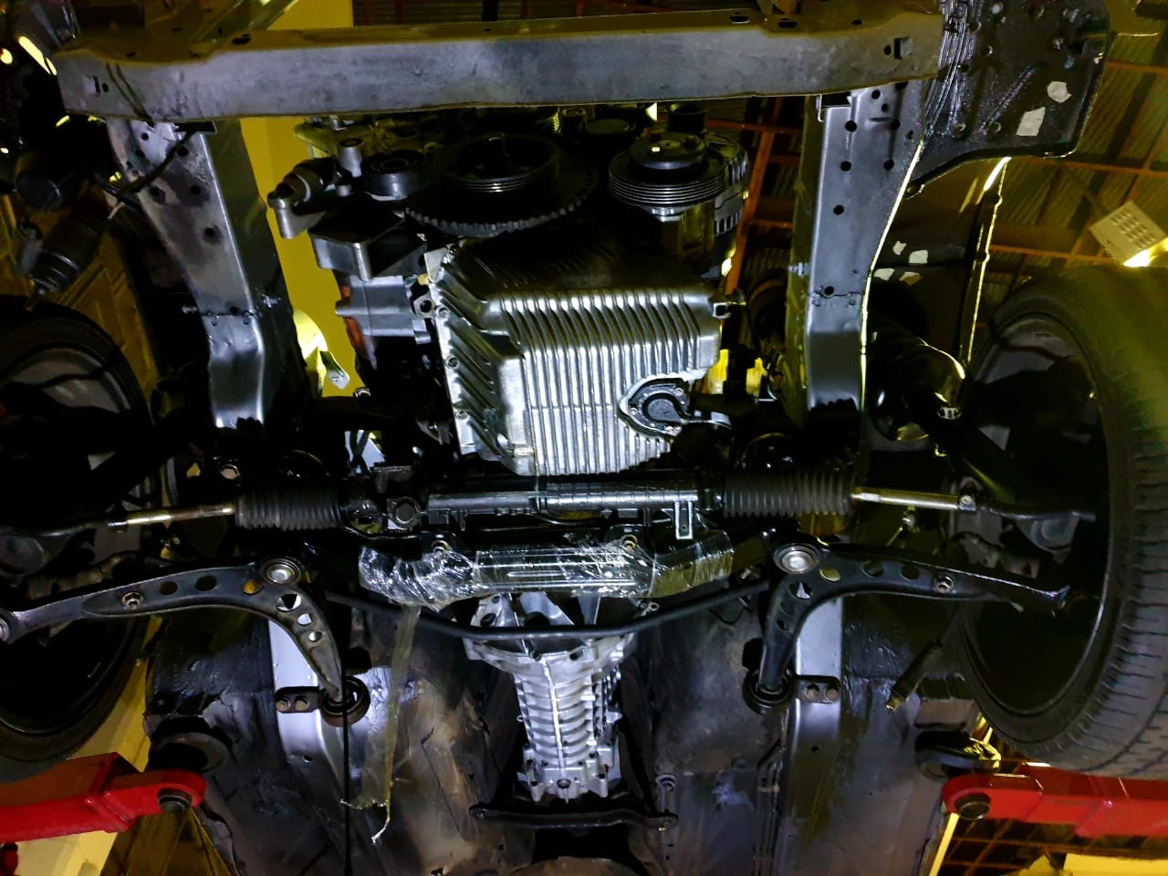

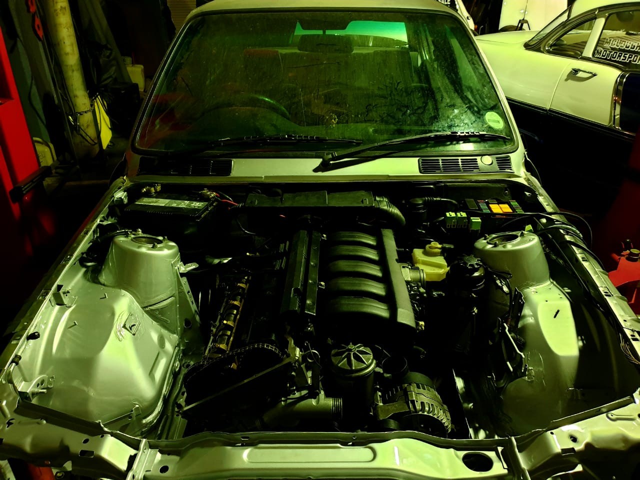

Engine and gearbox installed. The exhaust branches was modified and installed.Made to fit with existing dual 50mm system. The engine wiring harness was completely redone and installed. Setup looks amazing oem plus. Running the original BMW ecu for now.The cooling system is in with electric fan. Gearbox linkages were modified. Steering column modified to clear branches.
1st dry start test was last week and started on the turn.
I started her up today an man does she sound great. Lol loud enough to scare the vrrphah's away:roflol:

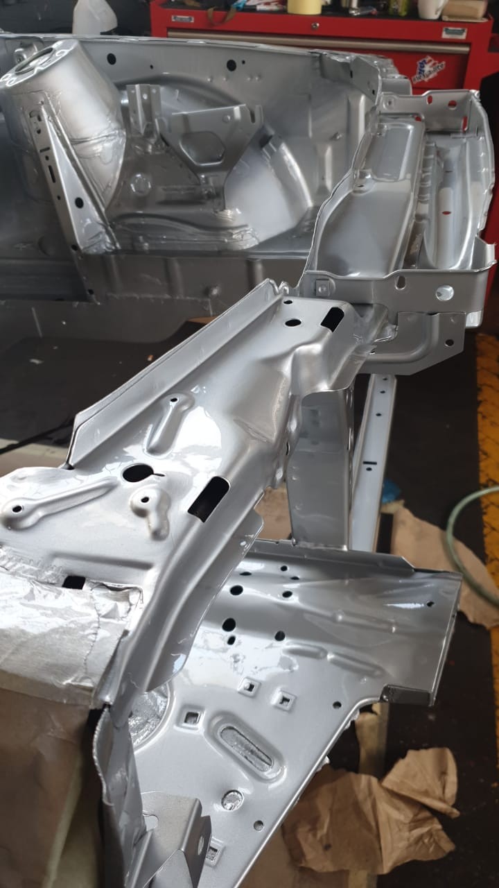

Body panels and bumpers came out great. Ready to be installed today as well after the car gets a good clean.

That undercarriage shot is just porn! Love me some clean car parts! :inlove:
