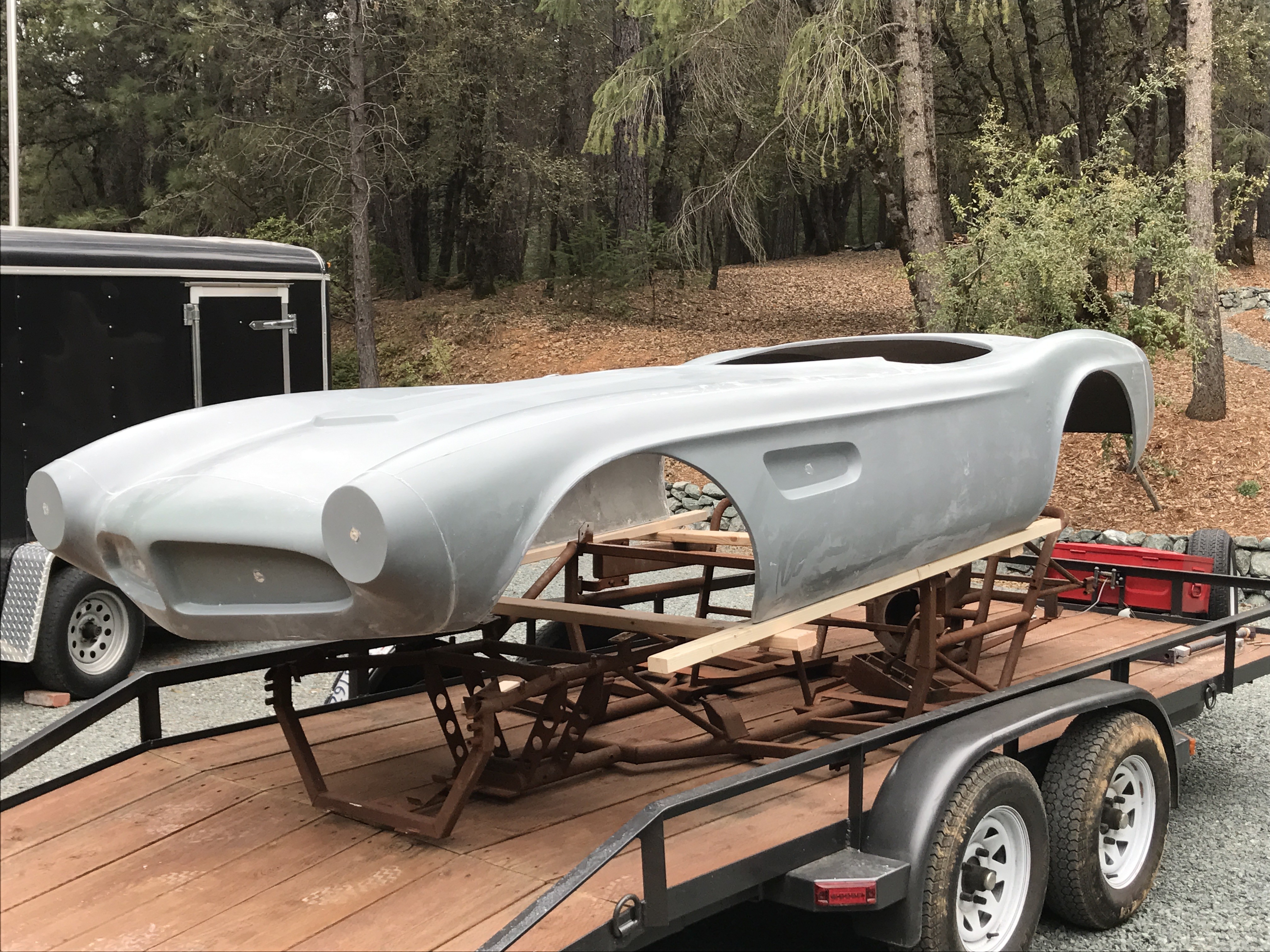

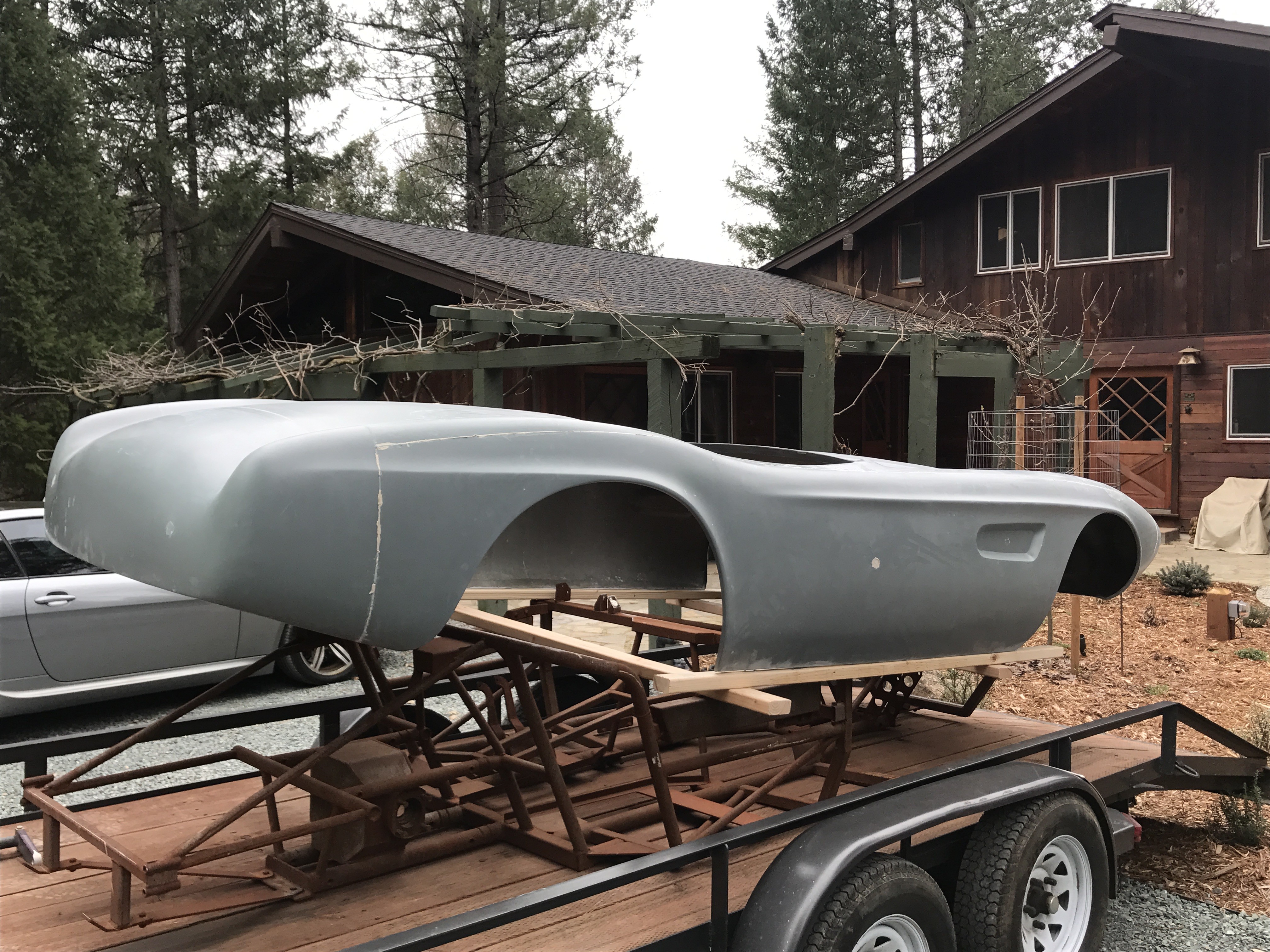

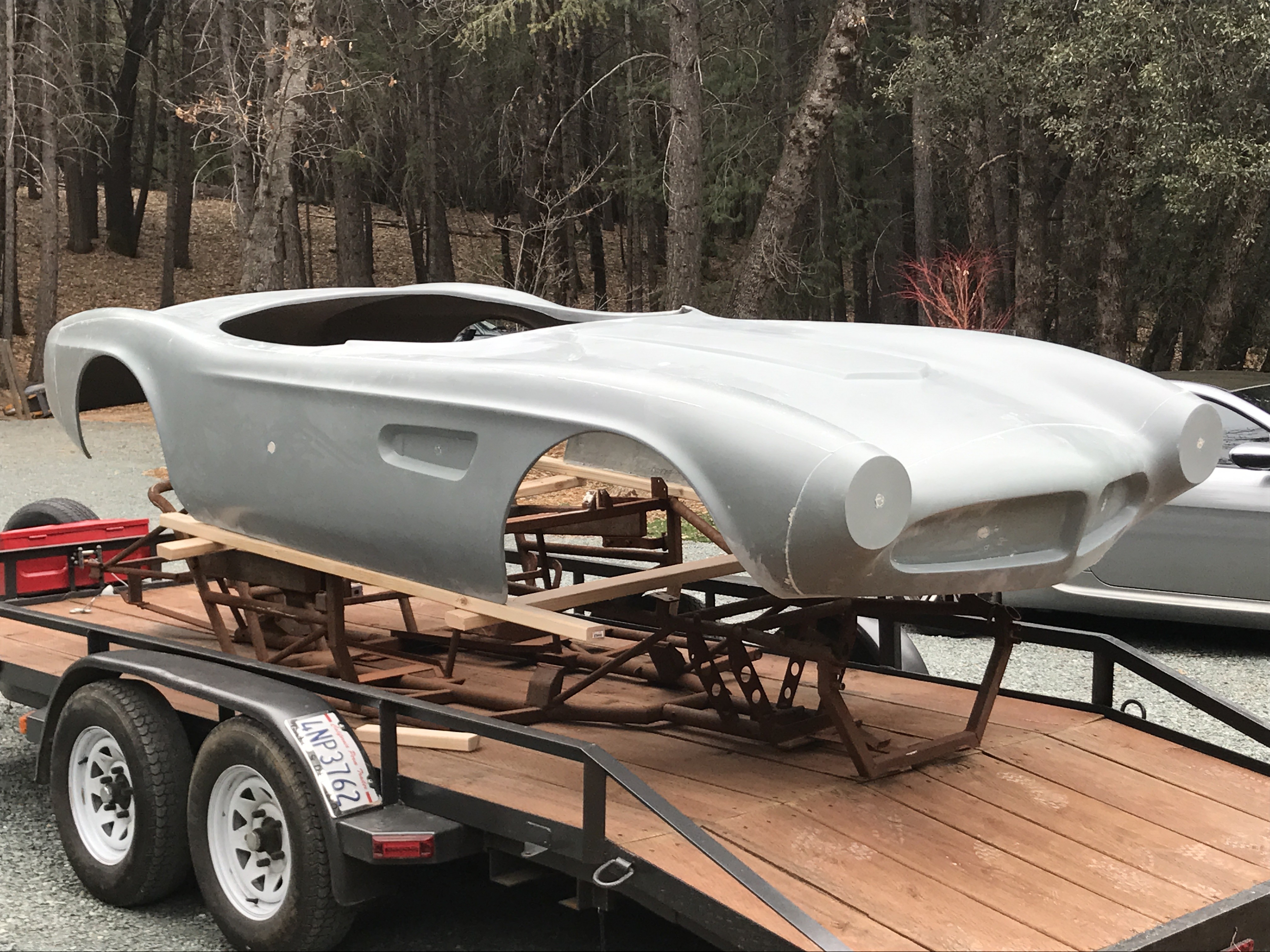

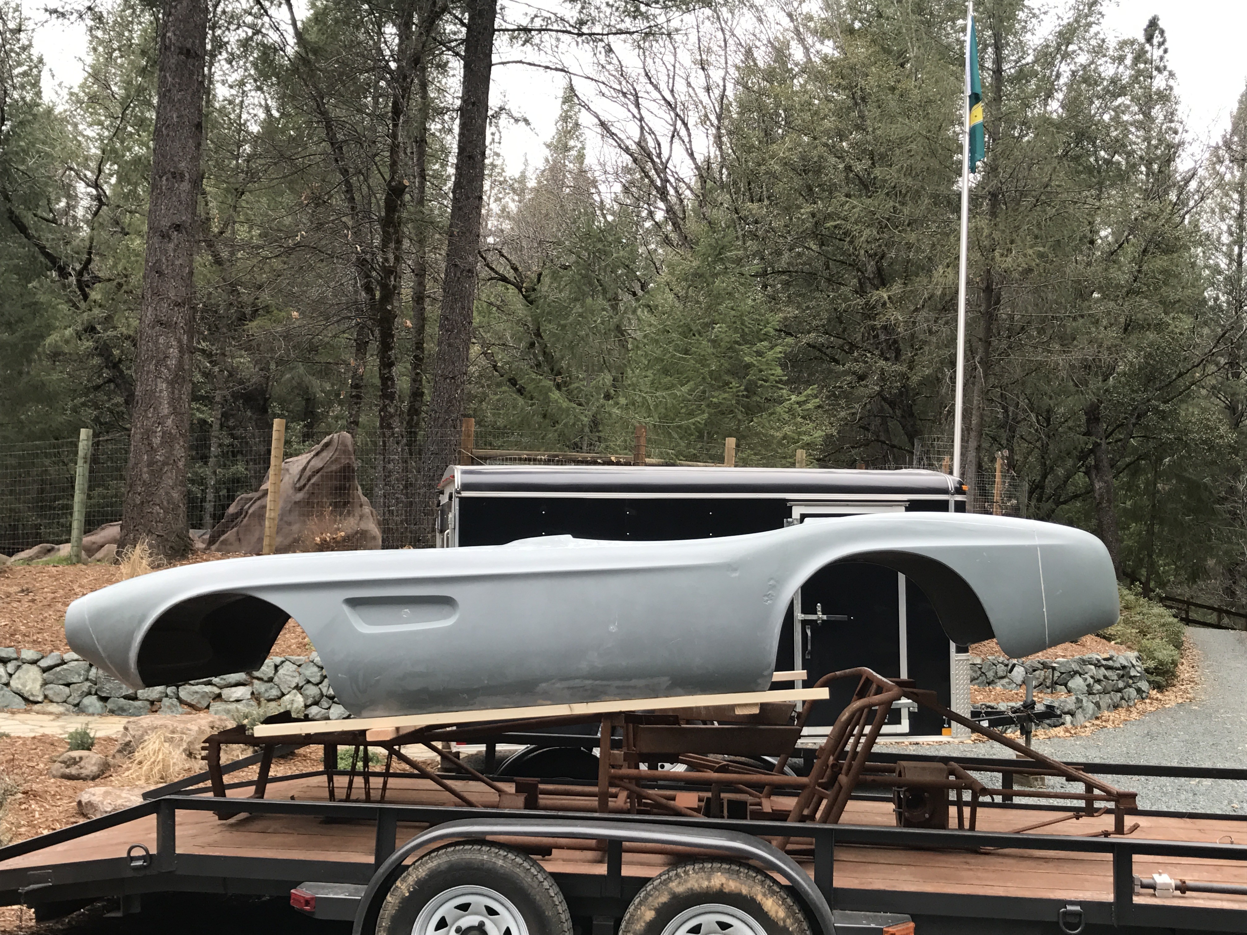

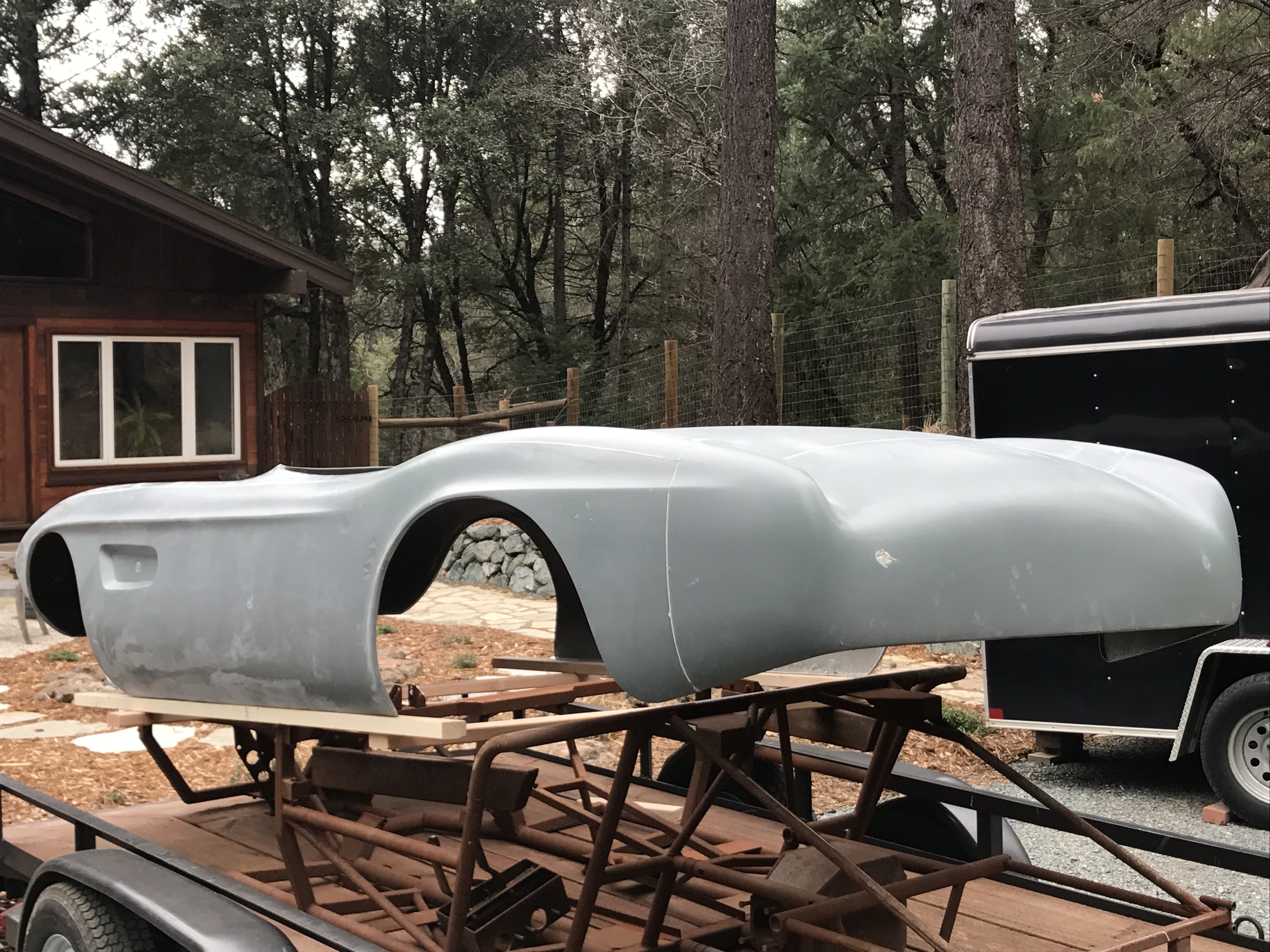

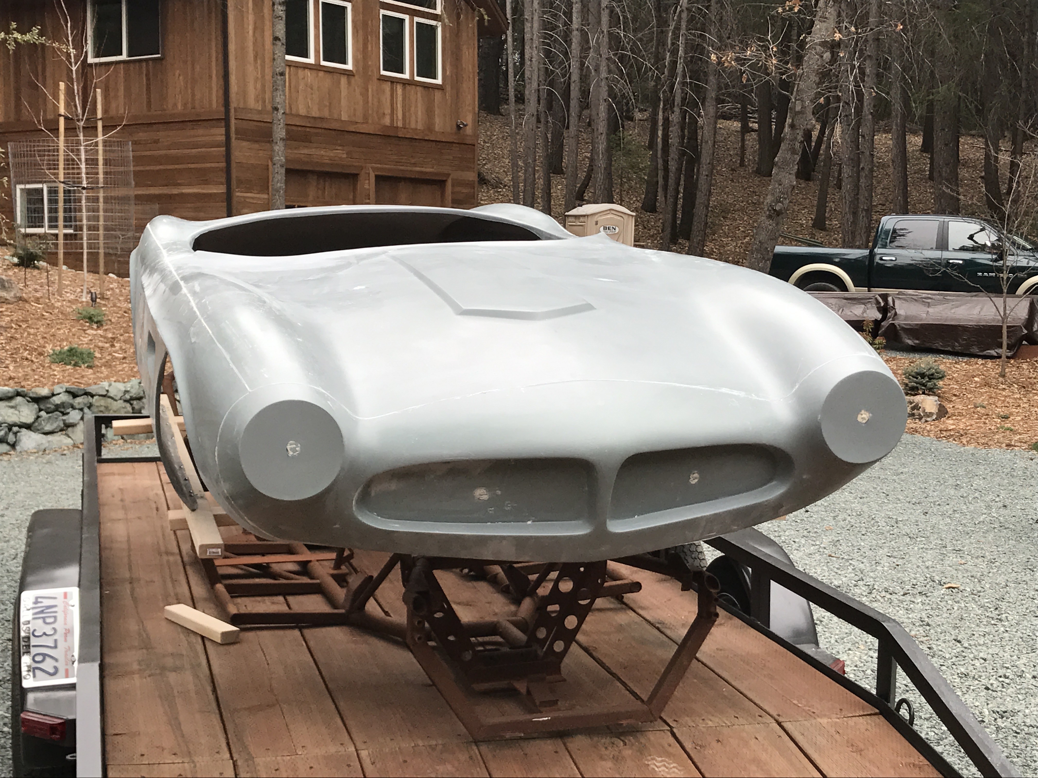

Just thought I'd share. I bought the mold that was listed for sale here and had a body made. I still have lots of work to do but I think the body came out really good and I'm pretty excited about it. It's sitting on top of a cobra replica chassis that I'm thinking of using, but will have to lengthen by 6". Let me know what you think.

I have not received a PM from tvellrath85 so I just emailed him.  Hopeful his email address is still active and he replies.  You’ll have to significantly shorten a 502 chassis to fit a 507 body.  502 wheelbases range from 112-115 inches vs. 97.6 for the 507.  If you have a 502 chassis it is very valuable.  You’d be better off having a custom tube chassis built for a 507 replica.
