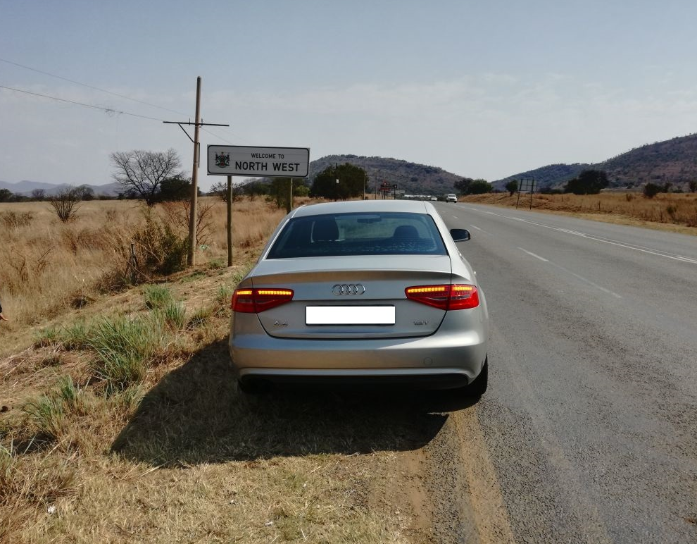

Is there anything sadder than an AUDI on a flat bed... sigh :blueCry:
The Audi decided to eat its own water pump. In usual warranty claims fashion, M-Sure started throwing me from pillar to post in an effort I assume to not pay out.
3 days later and many many phone calls after they finally opened the wallet to the tune of R16k for a water pump, front timing cover and crank case breather valve. (not bad)
