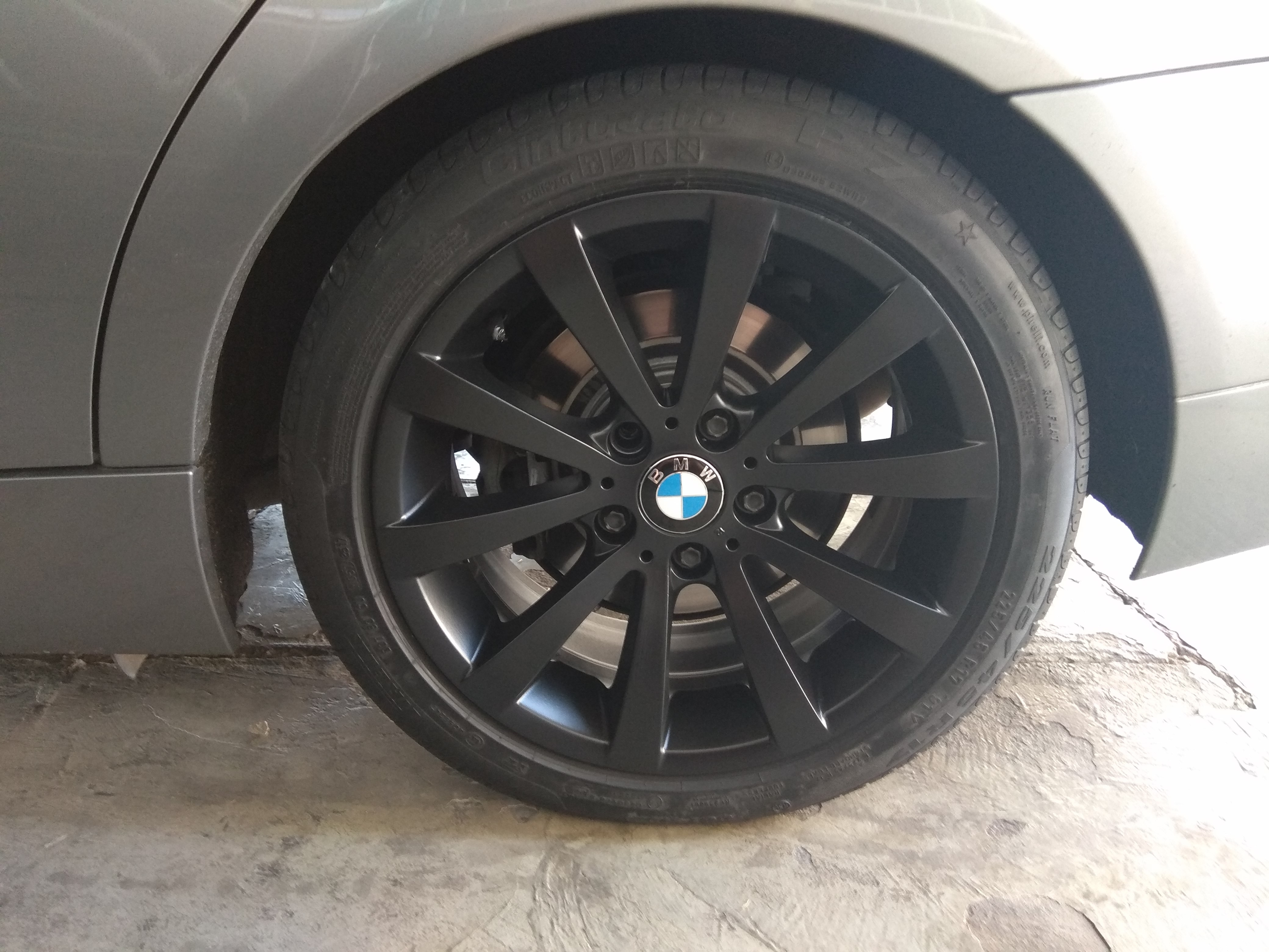

Started yesterday, cleaned up my fogs, sanded them down and clear coated them, also painted the covers next to them, and added that silver piece. I like the silver, seems a bit more detailed.

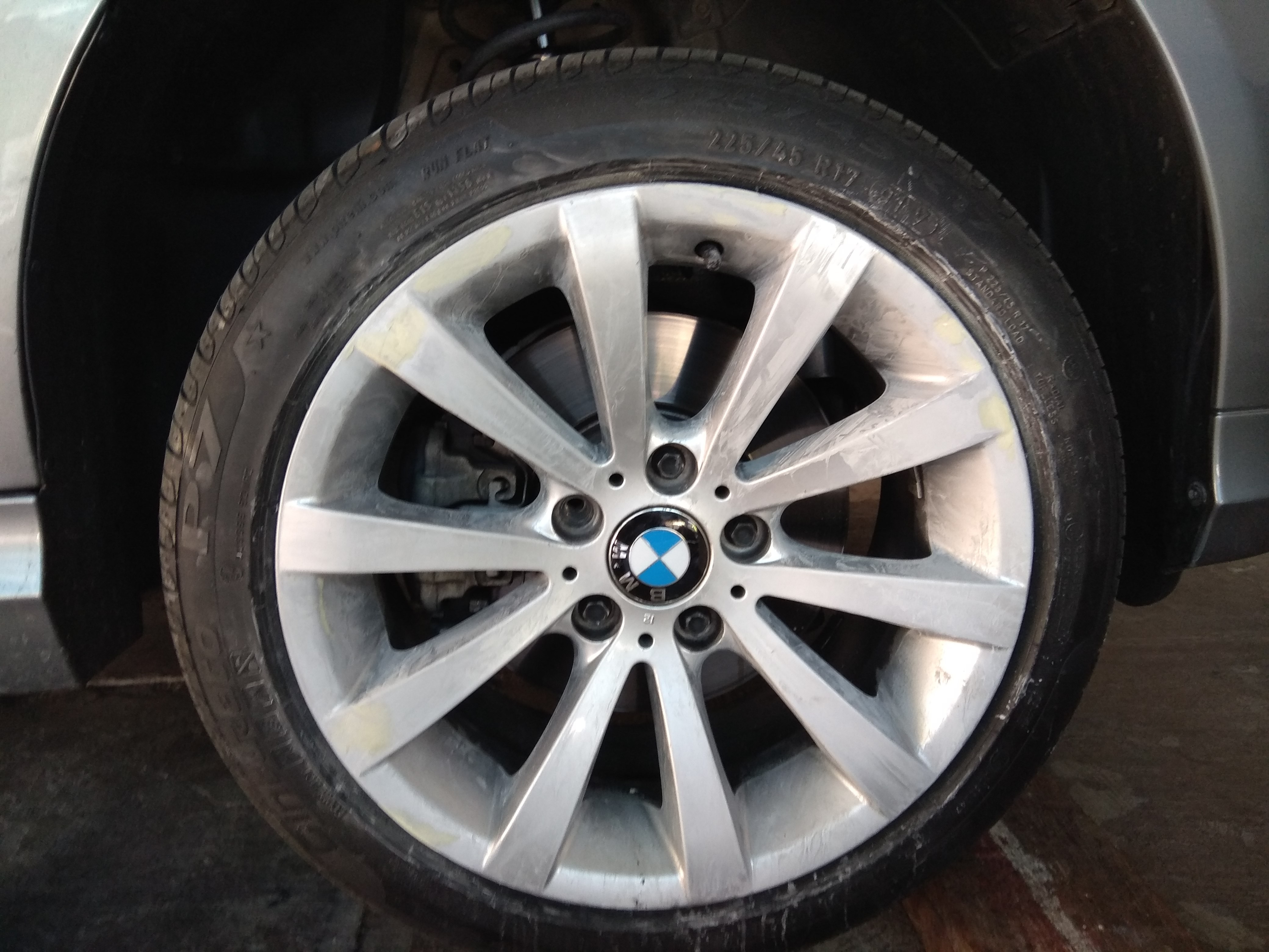

As I've started I couldn't keep myself still so I decided to start work on my mags. I don't have a start picture unfortunately as I was too excited to start.
Scratches and road rash patched up,
A bit of a wet sand.
Finally time to paint. I know I'm not a professional but it's good enough for me. So here goes
After all that I'm pretty happy with the outcome.

Please share some more detail on your wheel paint job? What products did you use? How many layers etc?
Howzit tman,
Thanks for the reply.
Apologies for the delay.
As I've mentioned before. Wasn't really planning on doing something like that this weekend but yeah.
I'm not a professional either so I'm probably going to get flack from a few guys. I've done it before to a few cars and it held up damn well in my opinion so I don't see any issues.
Here's my take.
1) clean the rims properly, I used some clean green as a first step, and then a nice rough sponge with dishwashing liquid and warm water to get the rest of the tar and brake dust off the face and inside of the rim. Also dishwashing liquid with a nice hard brush to do the joint where the Tyre meets the rim.
2) using some nice rough 40 grit sandpaper, just roughen up the damaged areas and get all loose paint off, I used the 40 grit at the back as well because my rims weren't very smooth to begin with(previous repair, not by me) .
3) I used microlite filler to patch up the damage but whatever works best for you. I've just always been a fan of the microlite filler. Dries hard in like 5 mins so work quick.
4) sand the filler down just enough to flatten it and blend it, preferably use some 220 grit with a small flat piece of wood inside( wrap the piece of wood like a present).
5) then I did a wet sand with 400 grit sandpaper, and also 800 grit. I was told the 800 isn't really necessary, but I wanted a propper nice flat look.
6) next up annother wash, I used a microfiber cloth and a spray bottle with dishwashing liquid and water mix. Probably used about 2 teaspoons to 500ml warm water. Just spray and wipe. Then rinse with a hose.
7) leave to dry in the sun, make sure to turn the wheels around now and then.
8) apply masking tape to the Tyre try to get the tape in the join as far as possible, or if you want the easy way out, get some cheap playing cards from a China shop or something. Works a damn treat! Just push the cards in the join and you should be golden. I got lazy by the 2nd wheel and decided to just put the Tyre on a newspaper and tape it to the cards while rolling it. Works quite well and enables you to spray both sides at the same time. Sorry o don't have a picture, but it worked well and a bit hard to explain.
9) wipe down with thinners, I used lab alcohol because it's all I had as I forgot to get thinners:hammerhead:
10) I just used Rust-Oleum painters touch. A bit pricey but the R50 tins from makro don't last in my opinion. Used Rust-Oleum on my polo about 4 years ago, and sold it with that exactly the same, no chips, scratches or peeling.
11) first coat nice and light, almost like you are trying to make it dirty, not even enough to cover the rim. Do the back first, then the front/face of the rim. Give it 5 mins and do the next coat. Do the corners first then the straights.
12) I don't know if it actually does anything but between coats I like going with a heat gun on max, about 30cm away and just moving it around over the wet paint.
13) I did 6 coats of color, and 4 coats of clear that feels decent to me but use your own mind and decide if you are happy with the finish and color.
14) after about 2 hours I put my wheels back but be careful as the paint only reaches propper hardness after about 24 hours. Also remember that if your rims are unpainted at the back where the rim mates to the brake disk/drum don't paint it as you have the risk then of your wheel coming loose if the paint we're to melt.
I'm going to leave it about a week and then wash, but after 12 hours it's ok to use a damp cloth to clean the overspray of the clear coat off( might look like white dust) comes off easy. After the damp cloth just coat with some wax just to seal it. Or use a clay bar first if you feel energetic.
That's pretty much it. 4 cans of color and 3 cans of clear. As mentioned, not a professional, but it's worked well enough for me in the past.
Thanks guys. Have a great night!

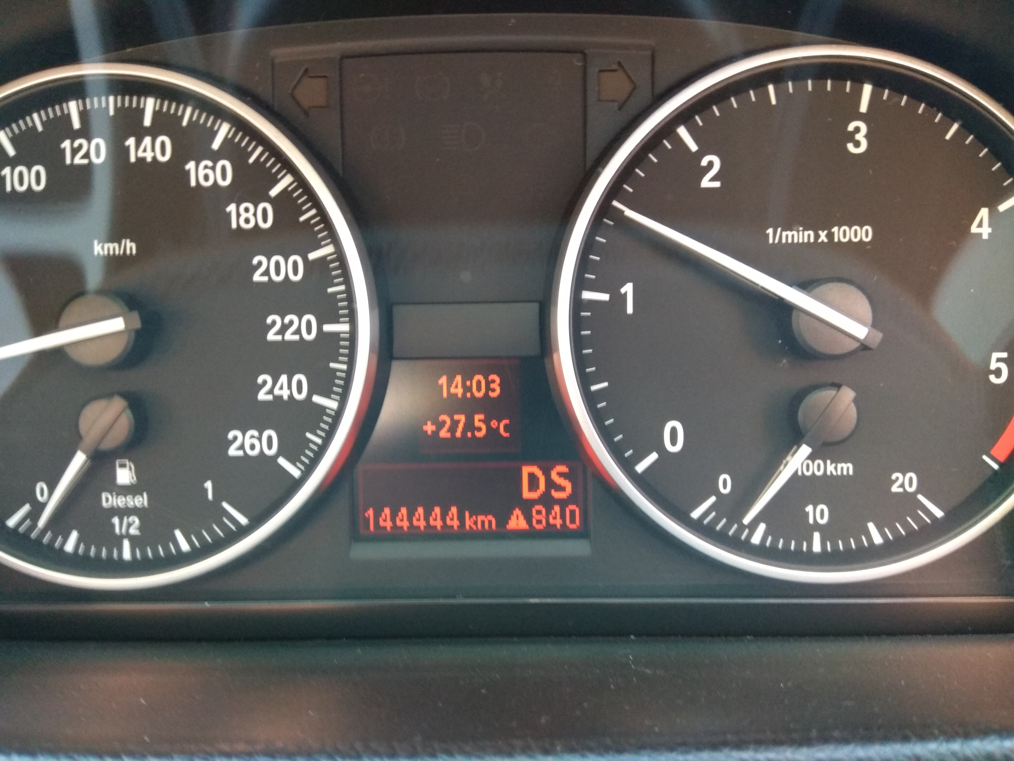

Love it or not, she's still pretty stock after a year and 6 months of ownership she has been great! One or 2 little niggles but more than that just smooth running.
Reached a Small milestone in May. . .

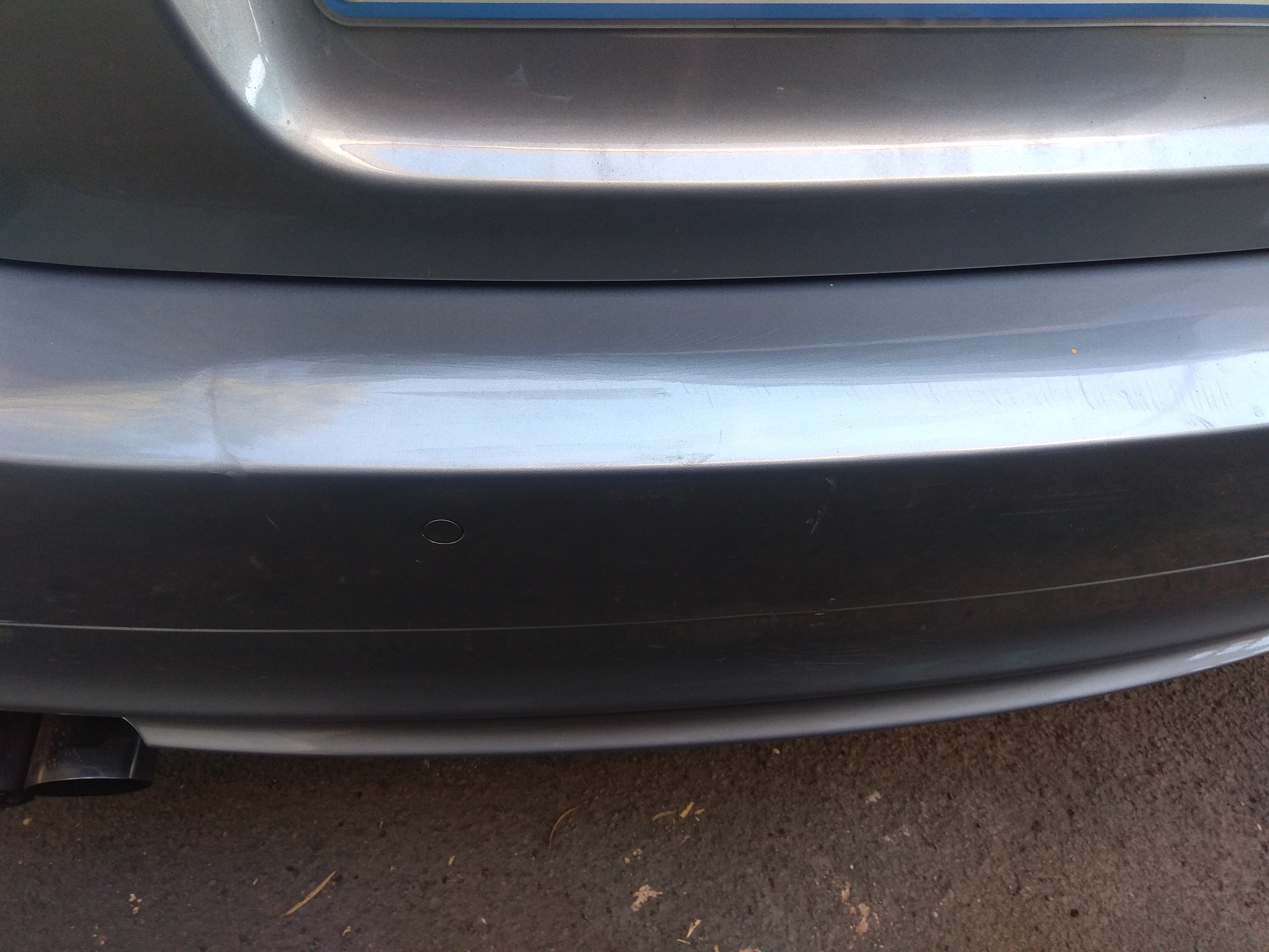

Little bumper bash a few days ago. Lady thought I was going to drive infront of a speeding incoming car. . . Nuff said, damage not too bad but it's the principle.
And finally after a wash, polish and wash.
